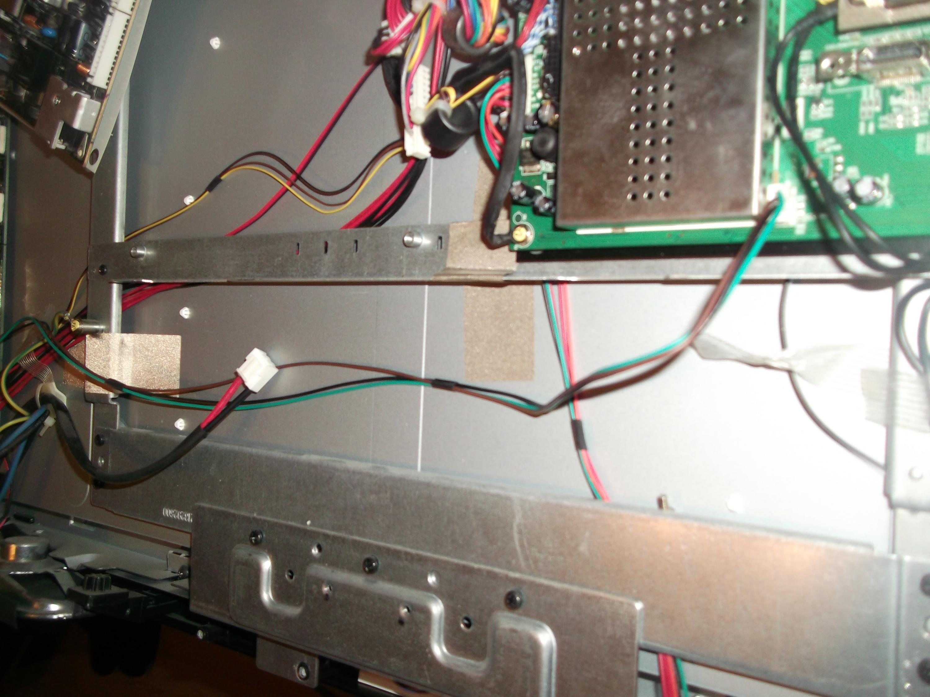

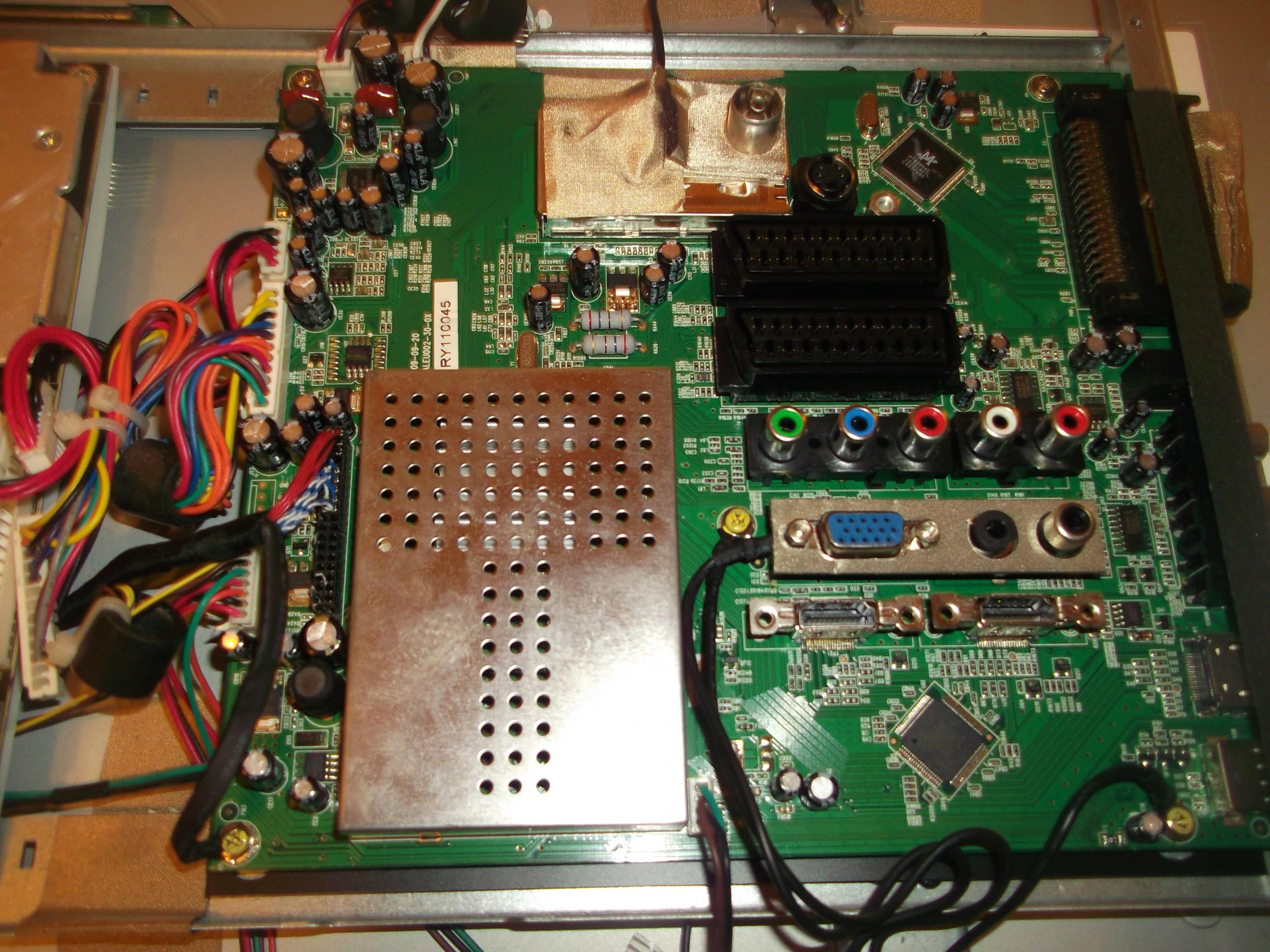

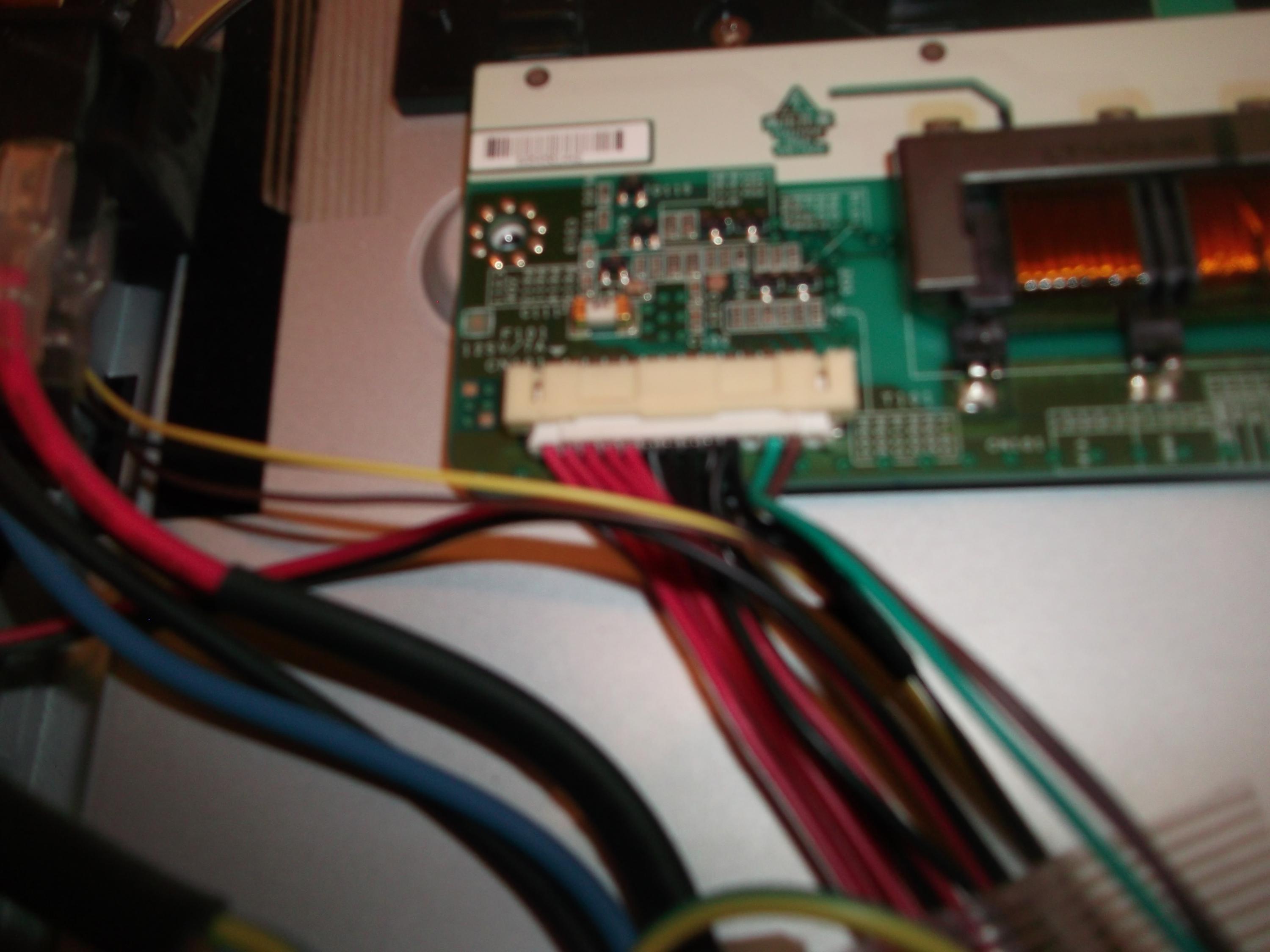

heres my logic 32 inch tv it has developed a fault were when you go to switch it on it flickers on for a second then goes back to standby you can just see the logik logo for a split second before it turns off so I have had alook for any bad caps on any of the boards and they all look good so then I thorght well I will try an eliminate each board by unpluging it and see if the if it will stay on ano it sounds abit stupid but this is what I got theres a 3pin plug which comes from the inverter board to the picture board when I unplug it the tv will stay on but with no picture or sound and when this is plugged back in the tv goes into standby so I don't think its the power supply because the tv stays on wen I unplug that3 pin plug but im pretty much stuck with it at the moment I wil upload some pics of the boards for you to see and see what yous think

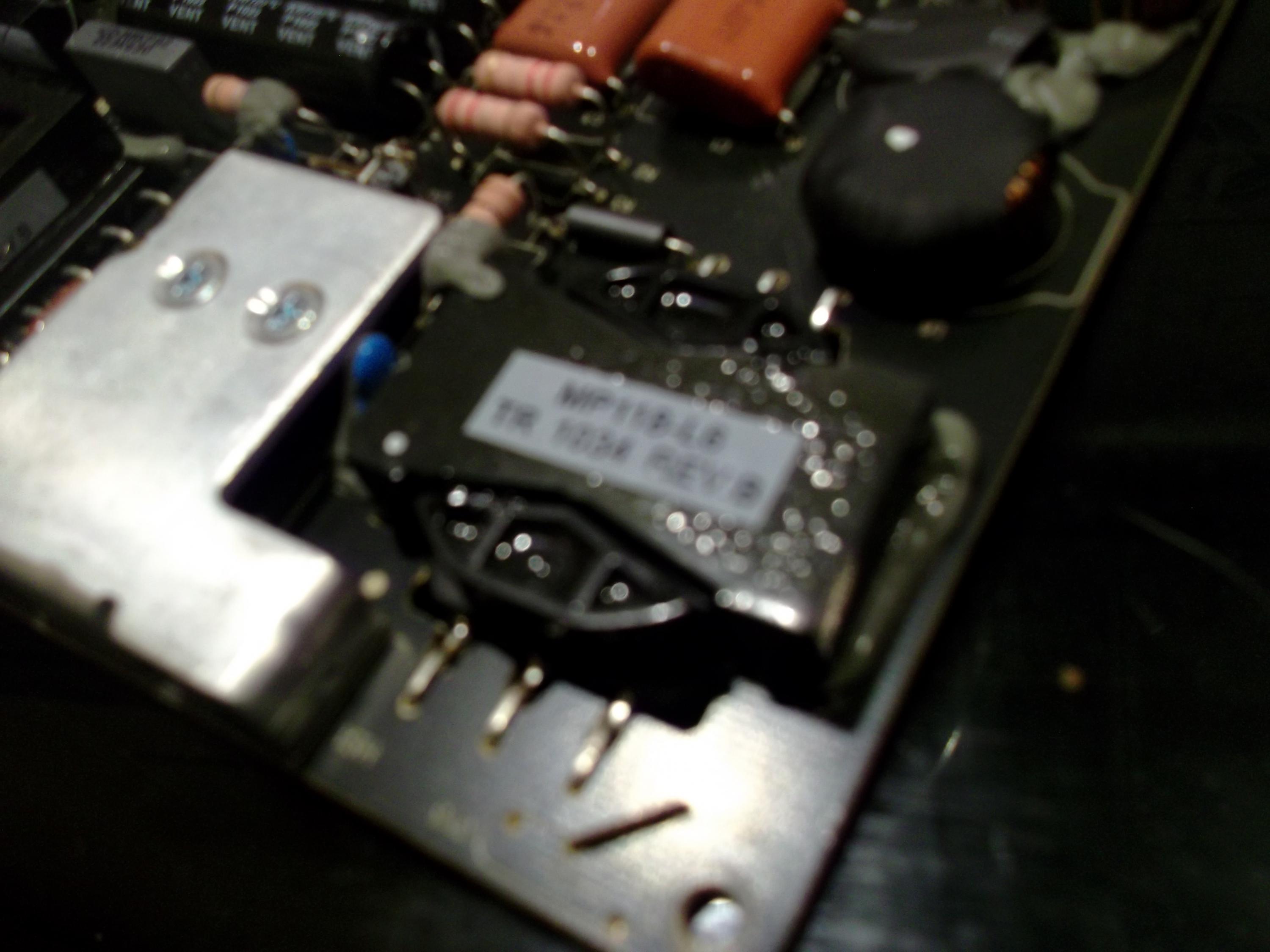

does anyone know what this black component is on the psu board and does anyone know how to test it becacue this is the only thing on all the boards that look like it got hot but I wanna be able to test it before I replace itAttached Filesif you find these attachements useful please consider making a small donation to the site
Re: logik 32 inch LC32DIGB20
That black component is the PFC choke, probably not going to cause your fault.
Do you have a digital multimeter to make measurements?Please do not PM me with questions! Questions via PM will not be answered. Post on the forums instead!

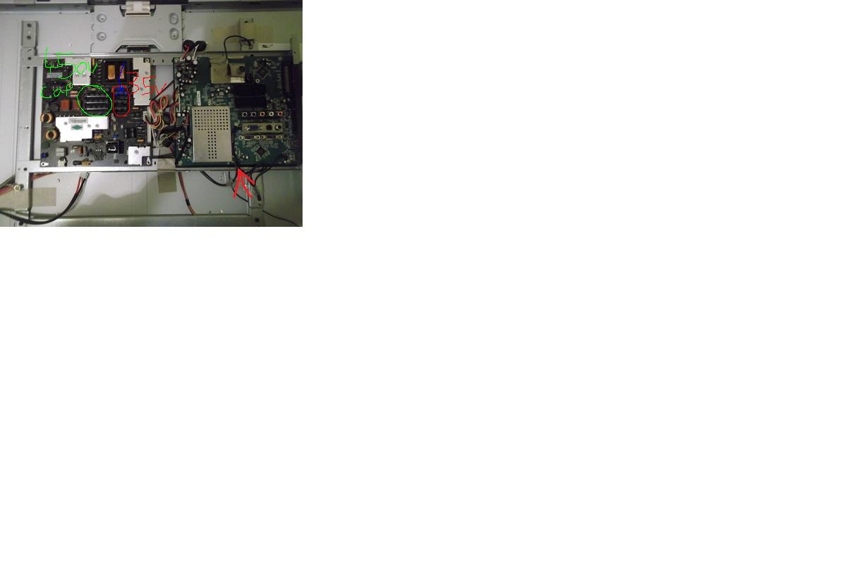

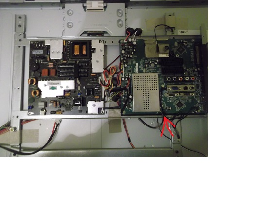

hi tom 66 i have had abit of luck put the power board back in the tv and tryed switching it on and it came on plugged the arial in and all seem fine then after about 5 min it turned itself off again so i got the multimeter and started checking the caps on the power supply and theres 3 x 450v caps which are reading 250v and then there 3 x 35v caps which two of them are reading 24v and the other the one mark with blue only had 11v do you think this is why or do you think it may be something else ?Attached Filesif you find these attachements useful please consider making a small donation to the site
I can't see anything in that image: it's too small.

Do any of the capacitors look swollen? At one end there is usually a stamped cross or y to give them a failure point. This end should be flattened. Are they all flat or are some rounded or bulging? Can you take a picture in focus of the power supply board and the inverter board?Comment

OK, there's a good chance it is a backlight fault. Unfortunately your pictures are too small for me to see all the parts in the TV - you must upload big clear images.Please do not PM me with questions! Questions via PM will not be answered. Post on the forums instead!
For service manual, schematic, boardview (board view), datasheet, cad - use our search.Comment
i dont have another camera sorry and its like somthngs over heating or gettin to hot because it turns on and stays on for like 5 min and the time gets shorter everytime i try and turn it on to were it just turns on and flickers and turns off but if you think its a baclight fault could i unplug the inverter board and see if the tv will stay on for longer than 5 min with this unpluged what do you thinkComment
