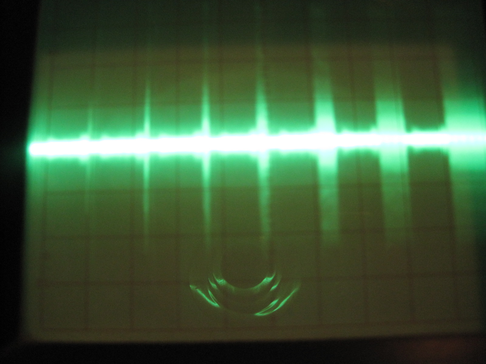

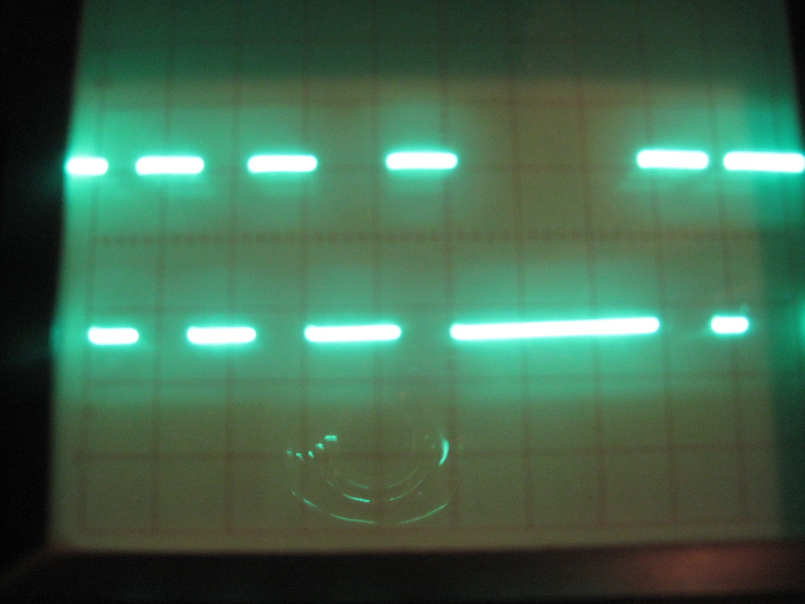

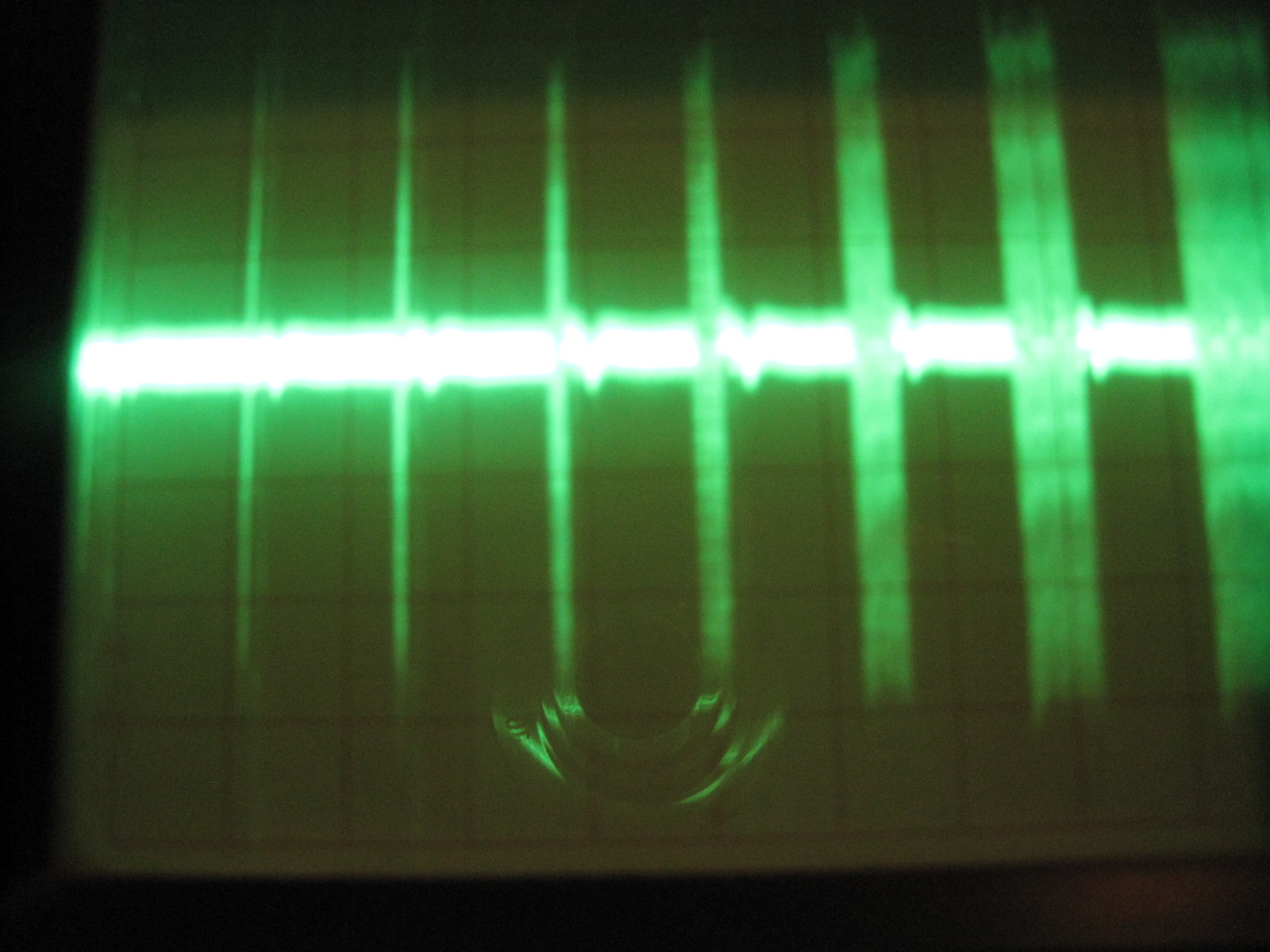

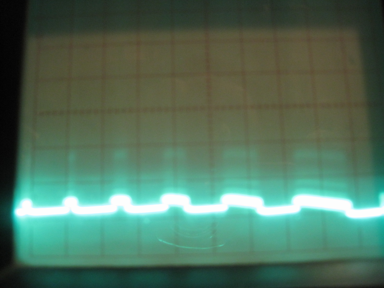

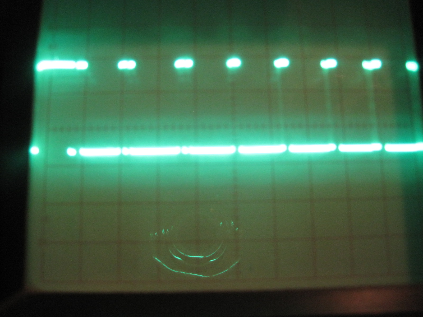

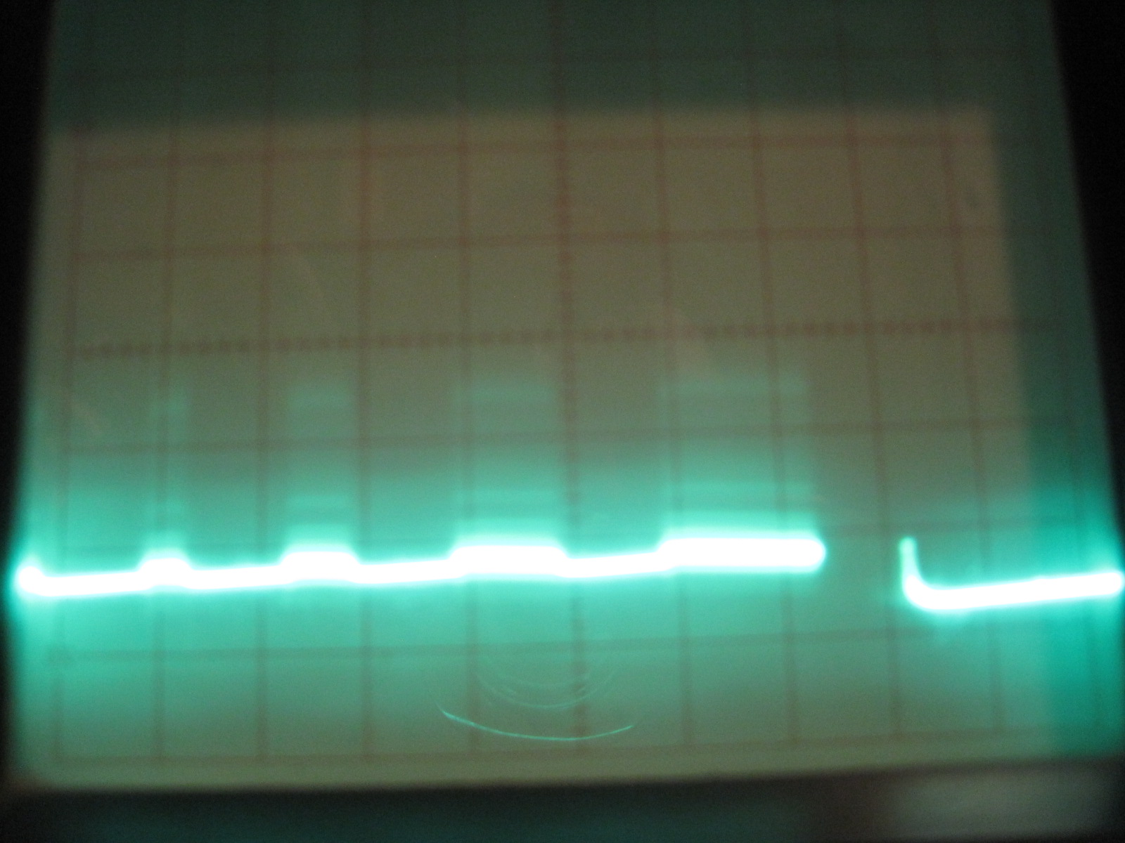

    Re: Toshiba 42HP66 No Video Has Sound

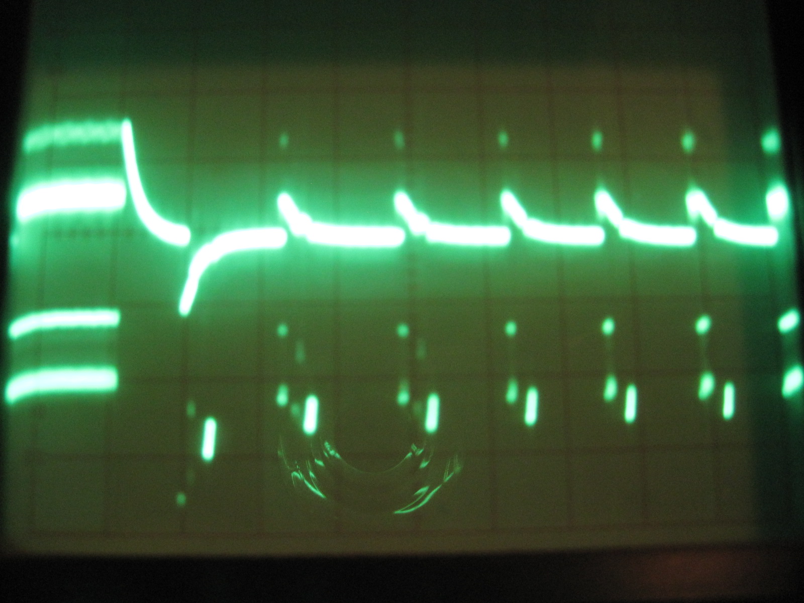

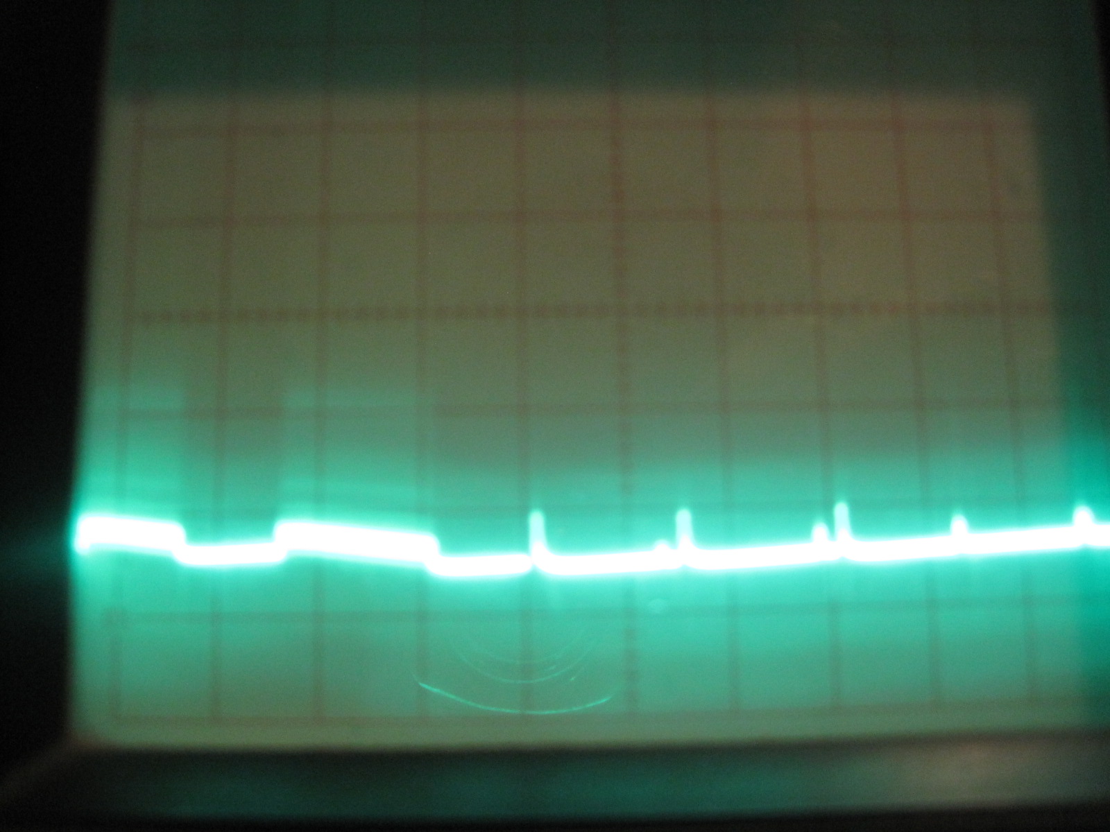

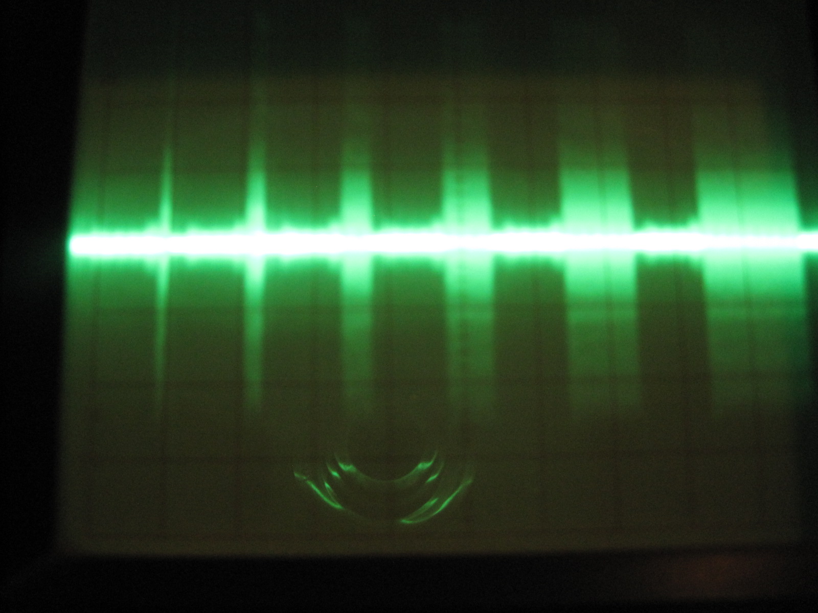

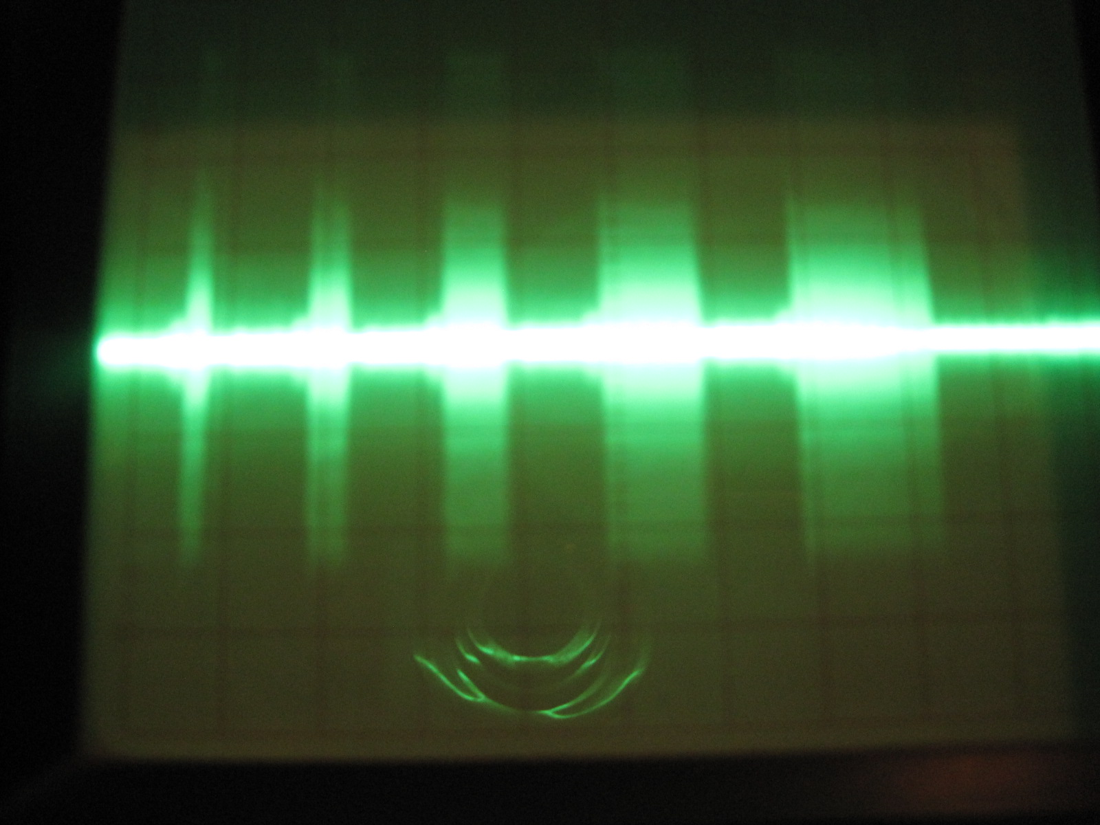

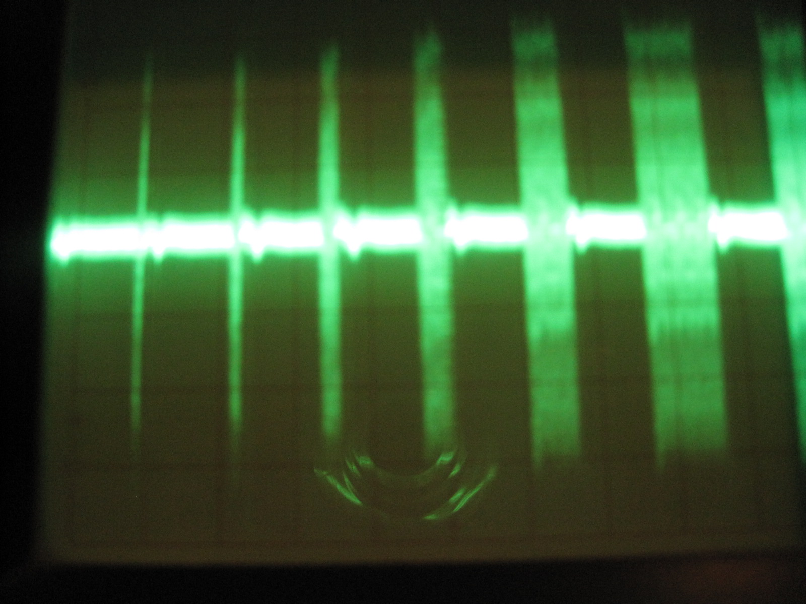

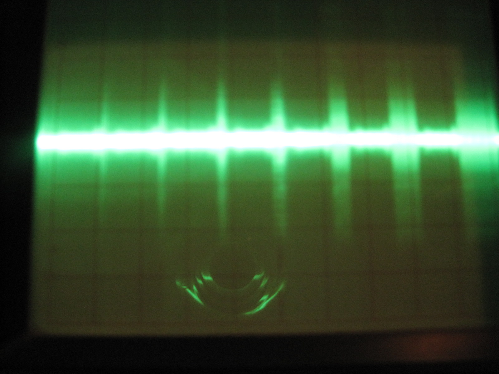

    For a Logic Board the signals sure seem illogical
    From wire #1 - #12
    #1 20mV/Div 1mS/Div 1Xprobe
    #2 20mS/Div " "
    #3 2V/Div " "
    #4 2V/Div " "
    #5 20mV/Div " "
    #6 .2V/Div " "
    #7 20mV/Div " "
    #8 .2V/Div " "
    #9 .2V/Div " "
    #10 20mV/Div " "
    #11 50mV/Div " "
    #12 50mV/Div " "
        I don't think these LG's support self test mode without an expensive jig. I'm not sure, though.
        Your control board is sending out the correct signals, so the fault -must- be on the Z-sustain somewhere.
