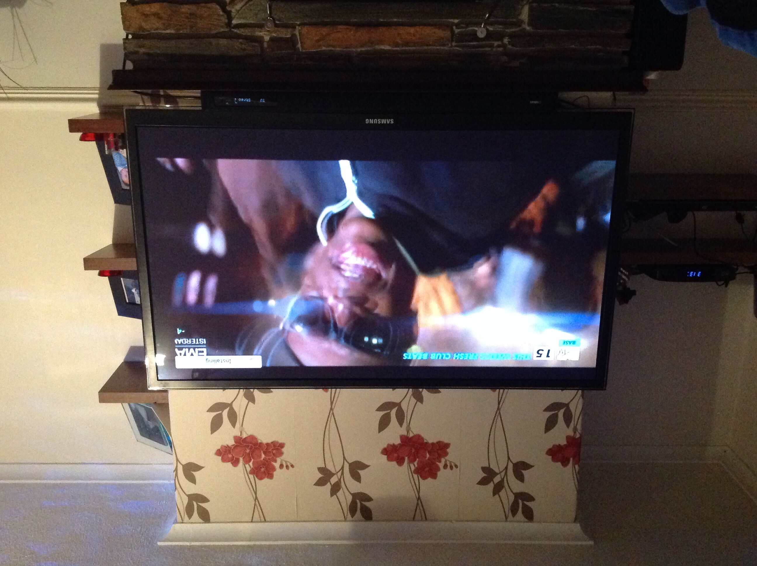

          Ohhhhhh pretty.
          Screen boots up and scrolls through white, red, blue and some other colours.
          Led 2000 flashes the same.
          Repaired: LG50PQ6000
          • Baileybum1234
            • Sep 2012
            • 245
            Re: Samsung ps59d6900dk
            So have I fault found down to the main board and it's power rails?
              Just the main board, common fault on these. Swap main board really only option.
                  Picked one up. 42.99 delivered and tested. Daim electronics. Will let you know how it goes. Cheers for your help Tom.
                        Tooooo late put it in any it works. Just running it up for a bit!
