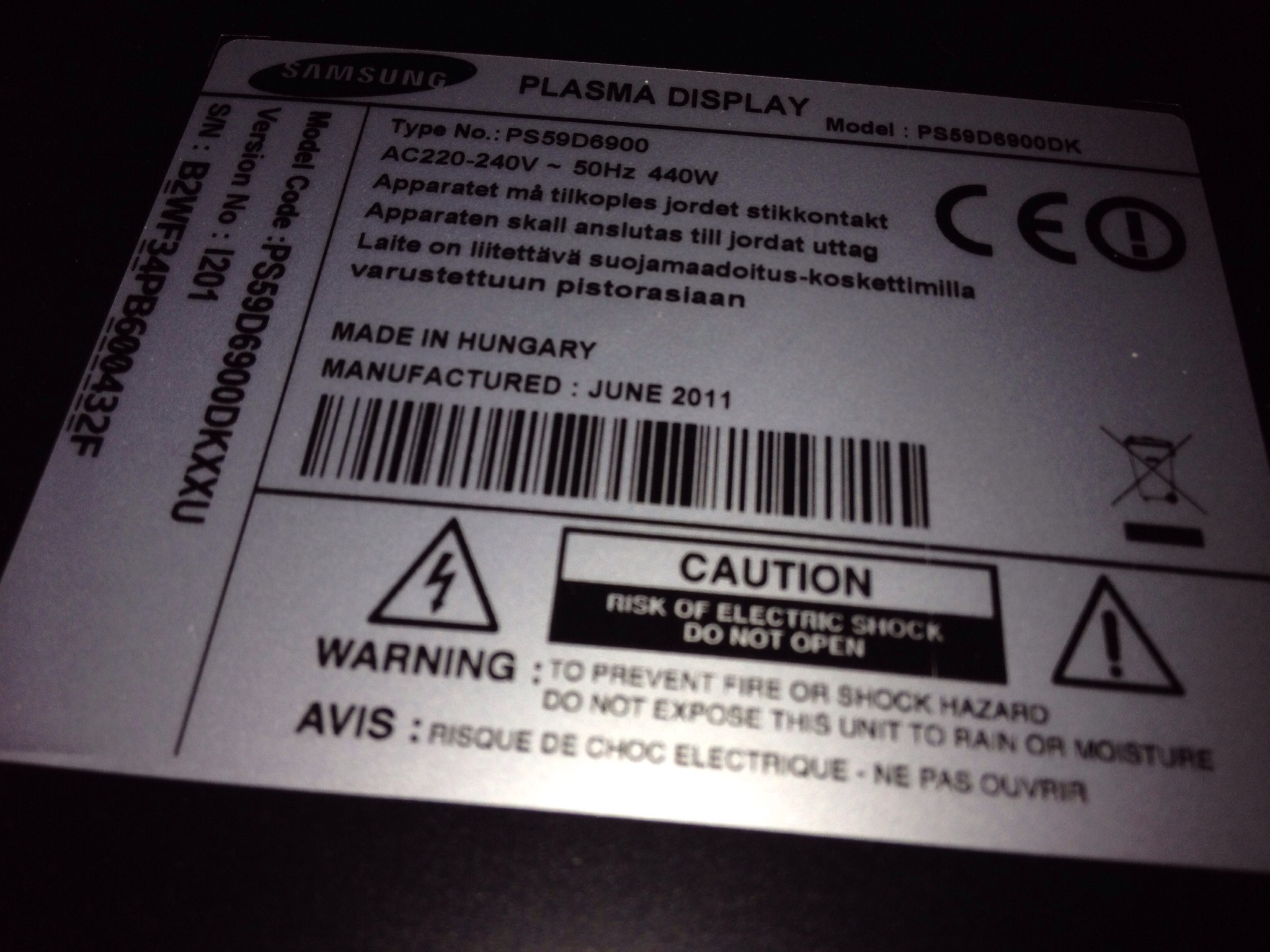

        Re: Samsung ps59d6900dk
        Just including a pic of the serial number before I get stuck in.
        Any more tips on similar models or designs?
        Cheers gents!

          It's a 2011 panel, my bet would be cracked screen or bad panel before anything else. Plug 'er in and see what happens...

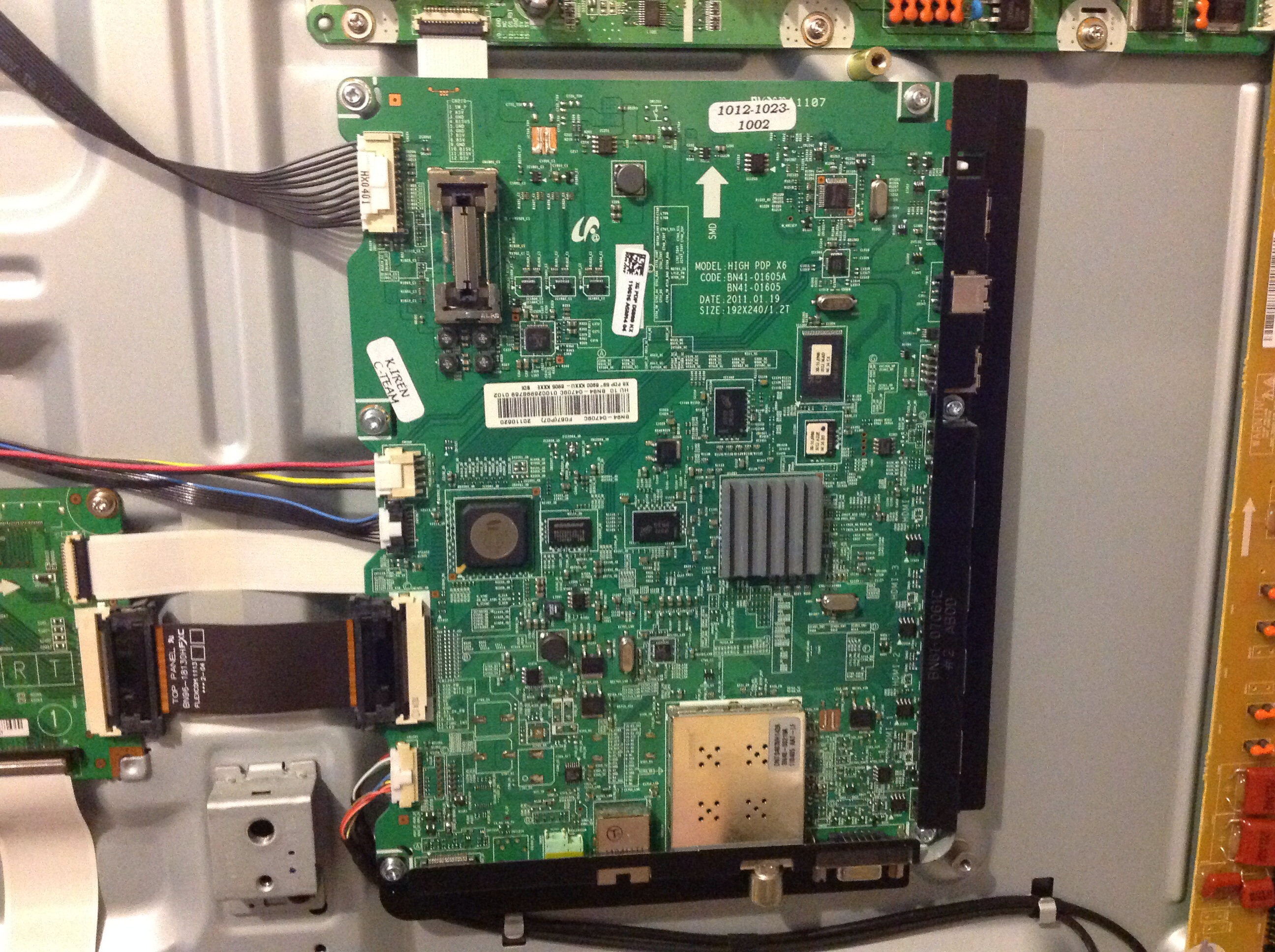

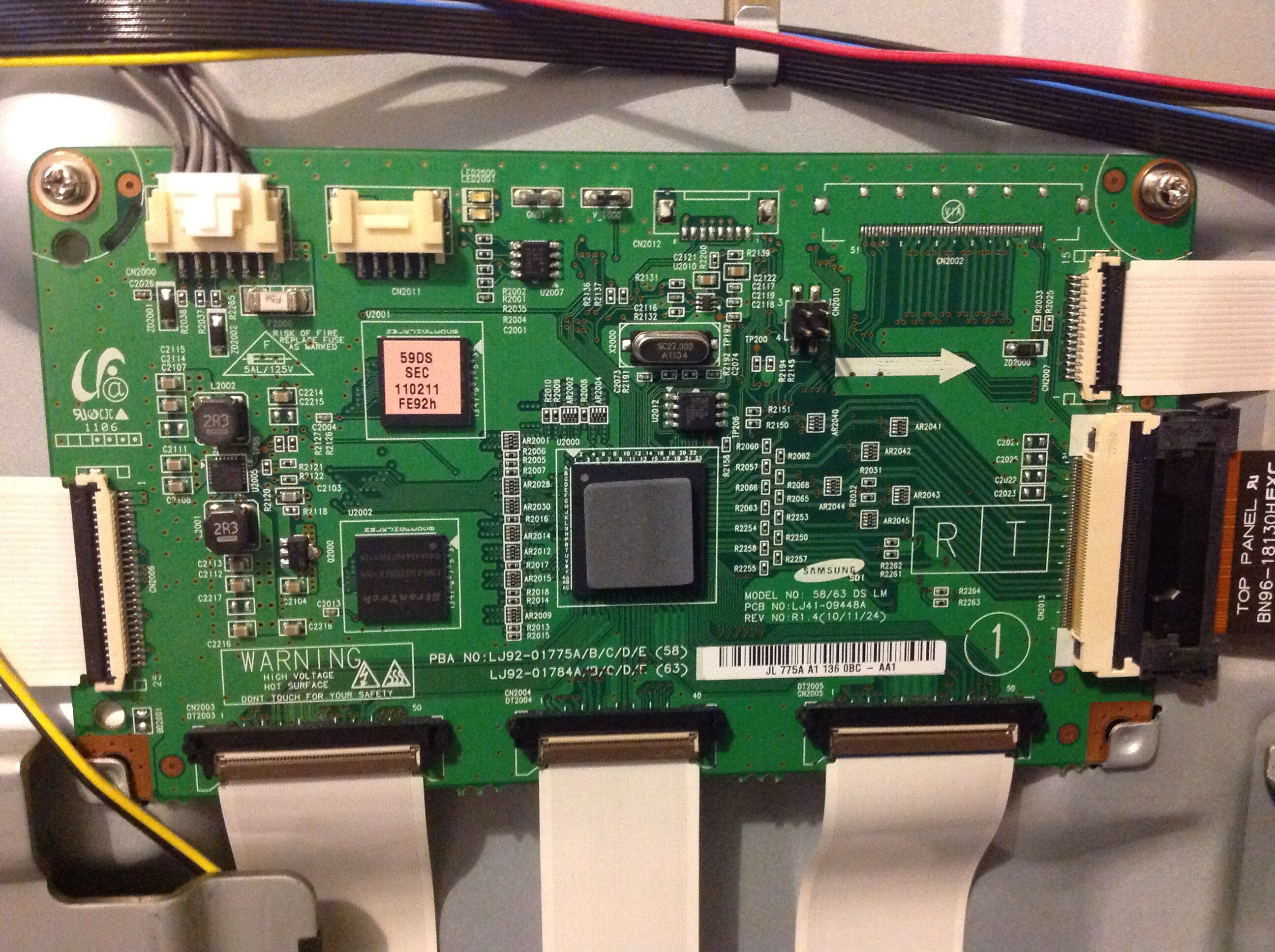

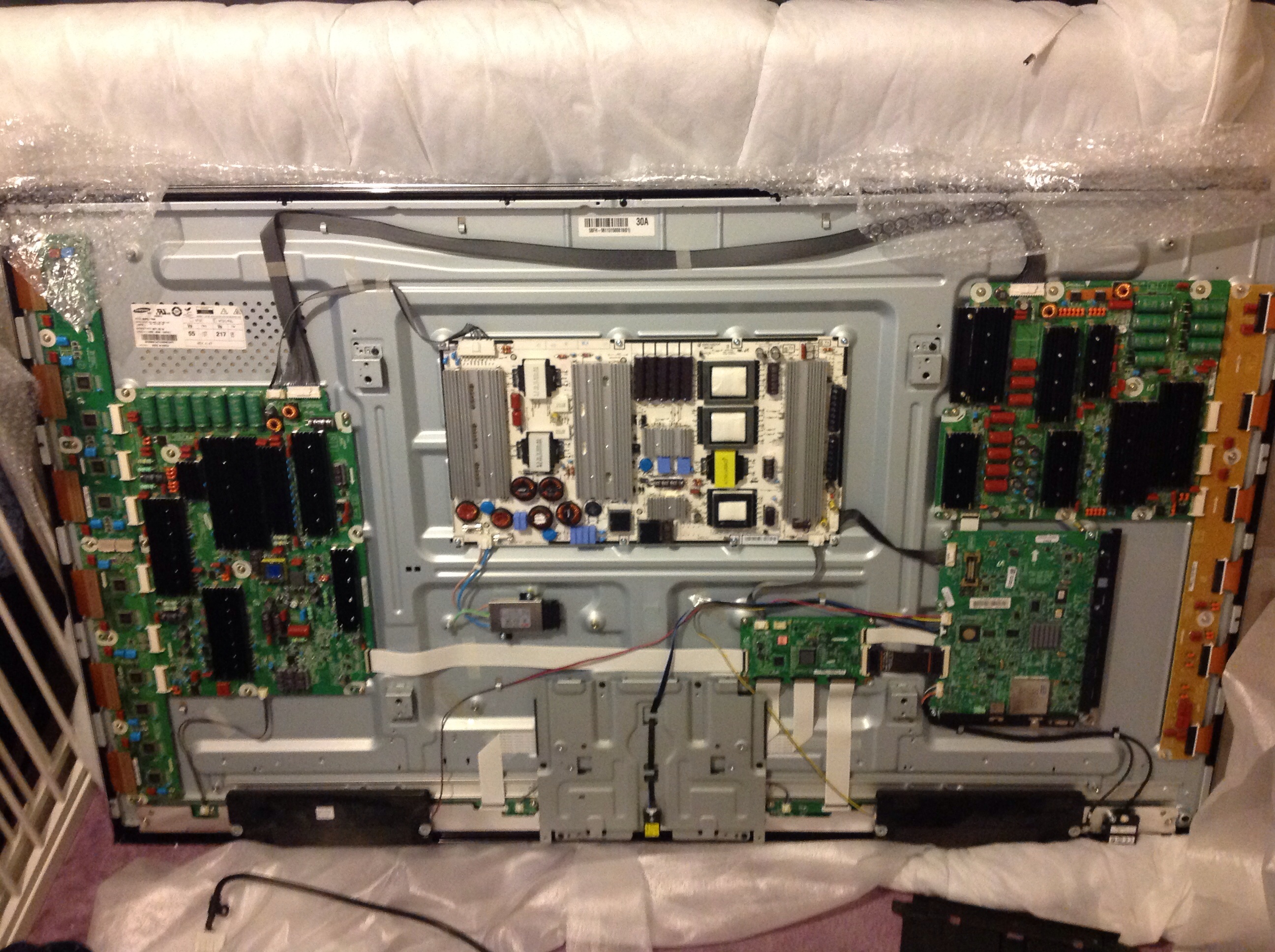

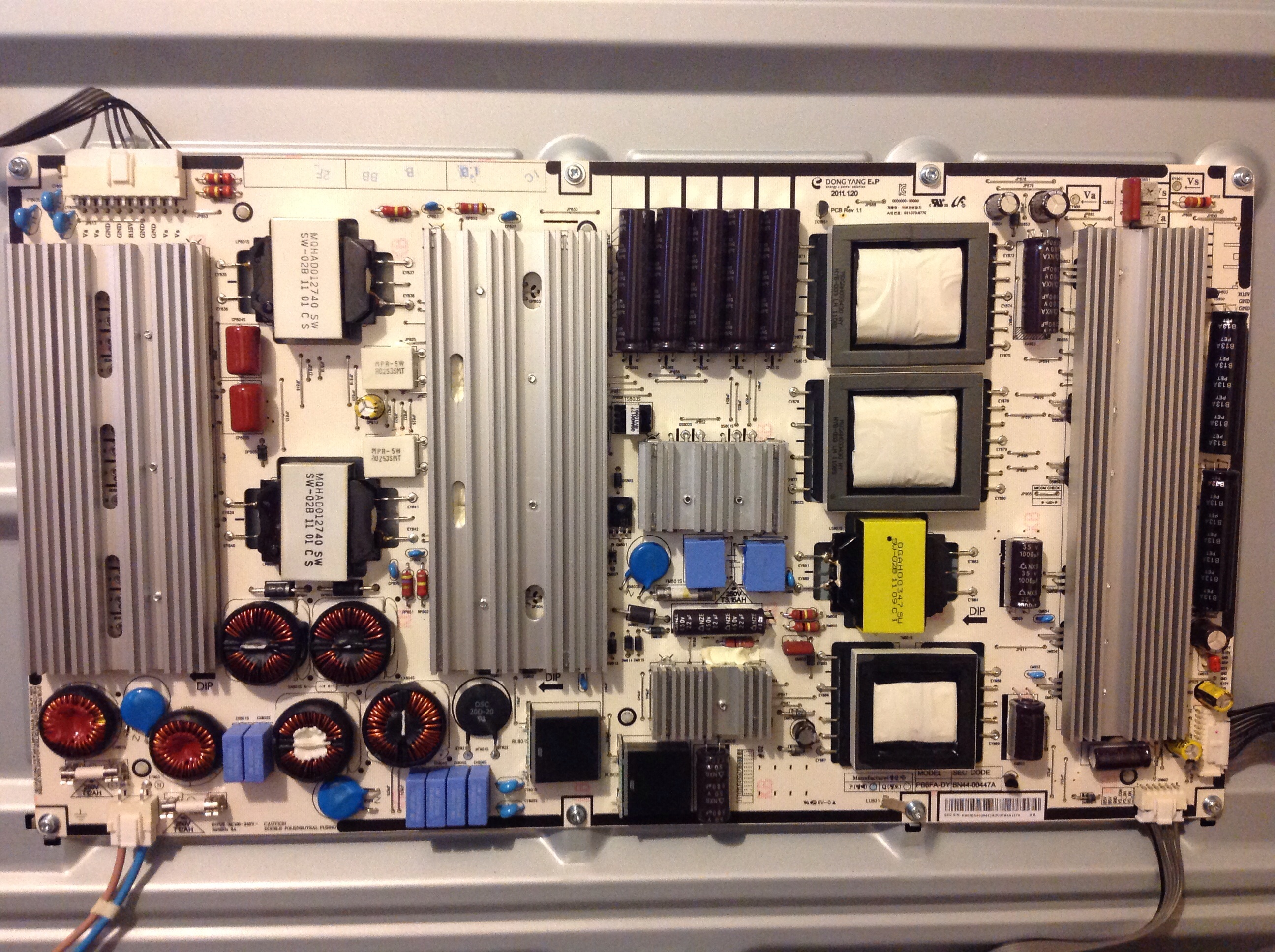

                  OK, open it up and get some pictures.

                    Funny you say that!
                    Repaired: LG50PQ6000

                        Appears I can only load one pic at a time from the ipad.
                        • Baileybum1234
                          • Sep 2012
                          • 245
                          This thing is mahosive!
                            Check if indicator on control board
                            https://www.badcaps.net/forum/attach...2&d=1383495320
                            flashes approx once a second or approx once every 5 seconds.
                              Yes led 2000 flashes once a second. Led 2001 doesn't.
                              Heard relays click on power up with remote
                              Screen flash
                              Y main makes a funny noise.
                                      So is the lvds cable the one that goes to the main board (black cable).
                                      Is this the test that should display the test patern?
                                        Yes, and yes.
