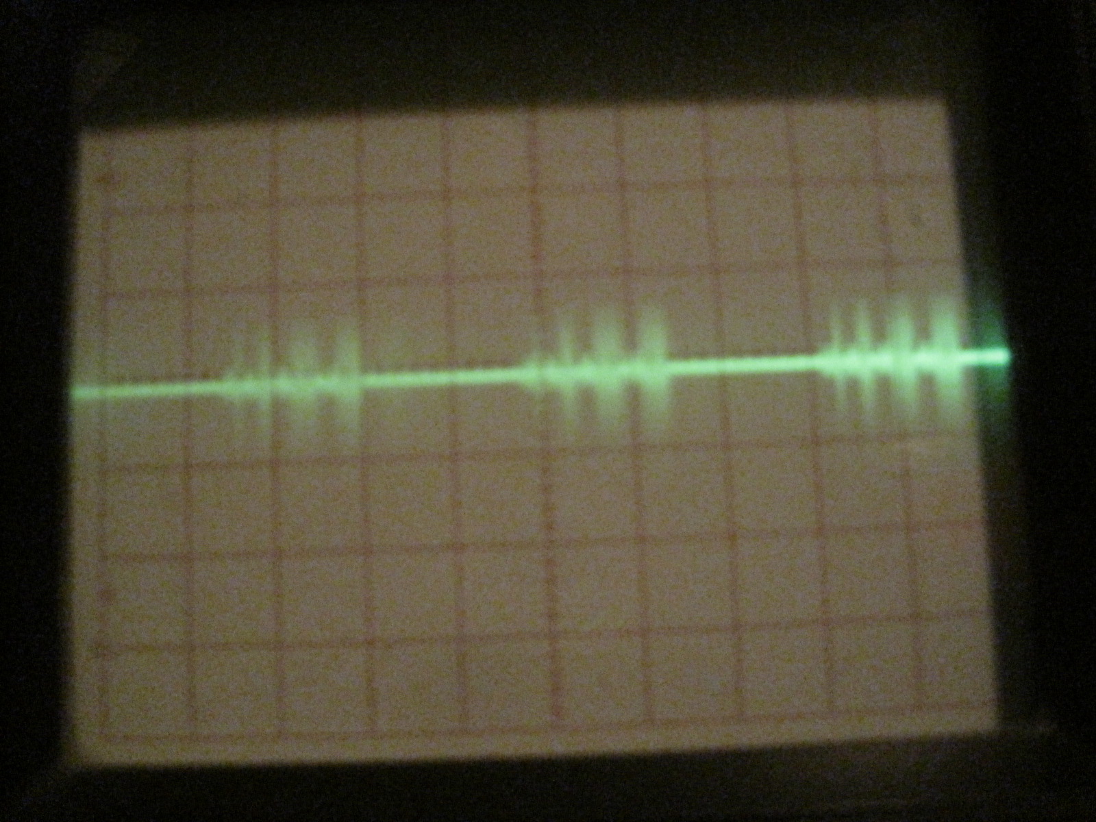

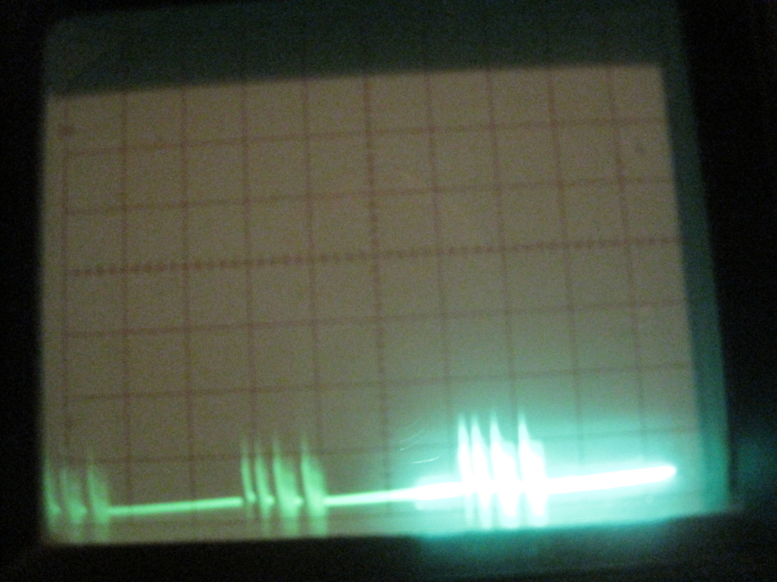

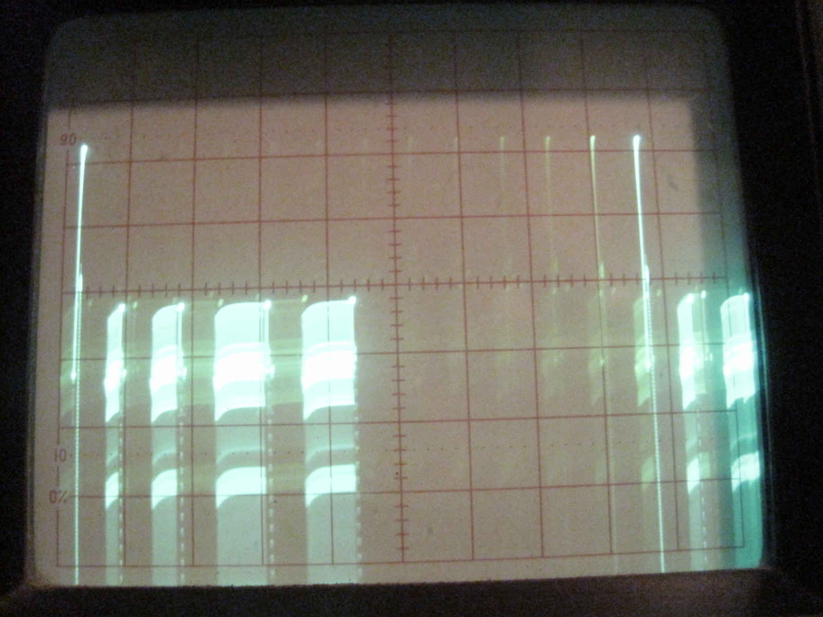

    Yup. Boards are labeled X-SUS & Y-SUS. On the XSUS, I measured where the ribbon connects to the YSUS board & at few other spots on the output side of the board (they all looked about the same). On the YSUS I measured at the TPs that I mentioned earlier, TP80, TP80E, TP85, TP85E, etc.
      Re: How to Troubleshoot a Plasma TV (p50s602) with an Oscilloscope
      Need to figure out the actual sustain board output, probably one of those wide (6+ pins) traces on buffer board. Try one or the other.
        Correction: On the XSUS, I measured where the ribbon connects to the XSUS board & at few other spots on the output side of the board (they all looked about the same).
        On the YSUS, I've tested at the YSUS to Y-buffer connection, traces leading to the ICs on the Y-buffer and where the Y-buffers connect to each other and they all produce the same wave as pictured below.

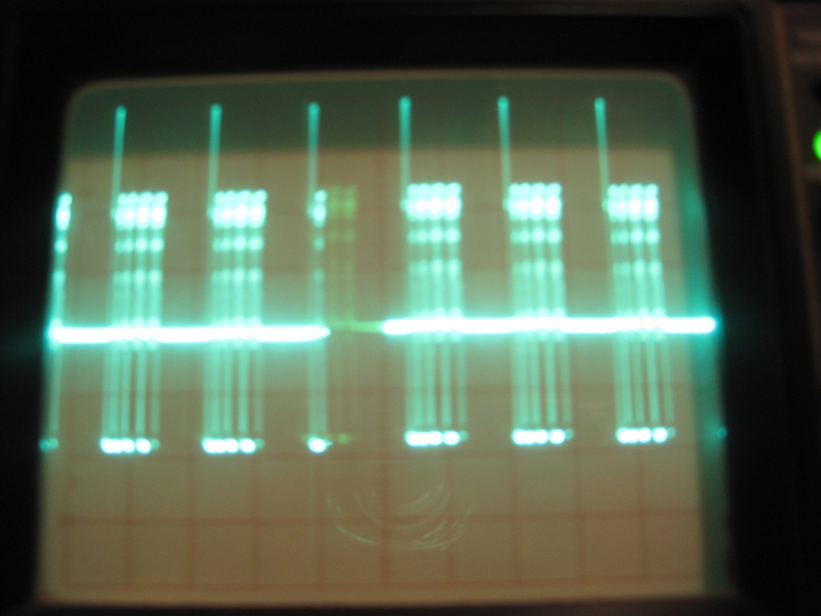

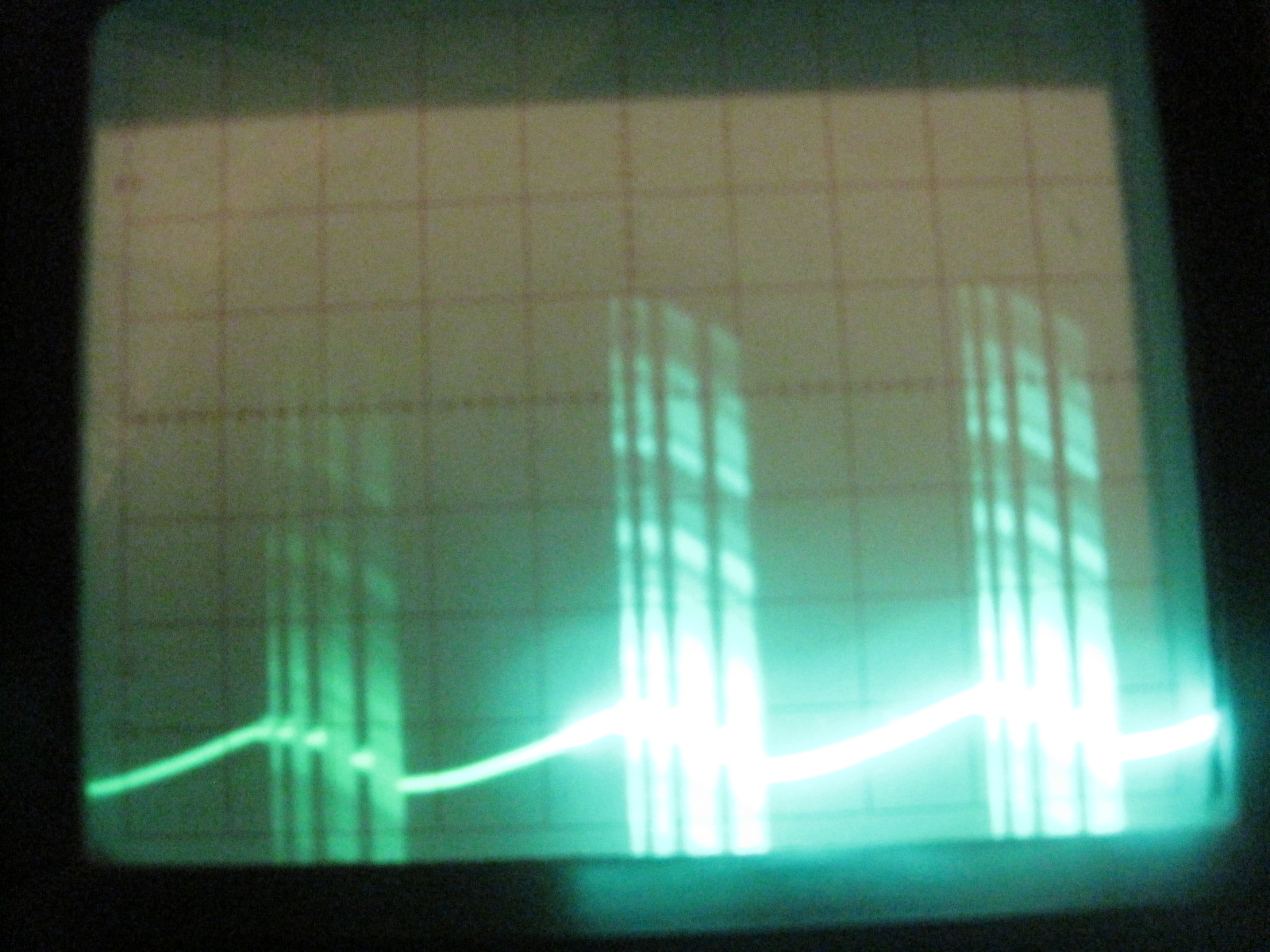

          Zoom in on that spike at the beginning of each pulse if possible and adjust the FOCUS control of the scope.

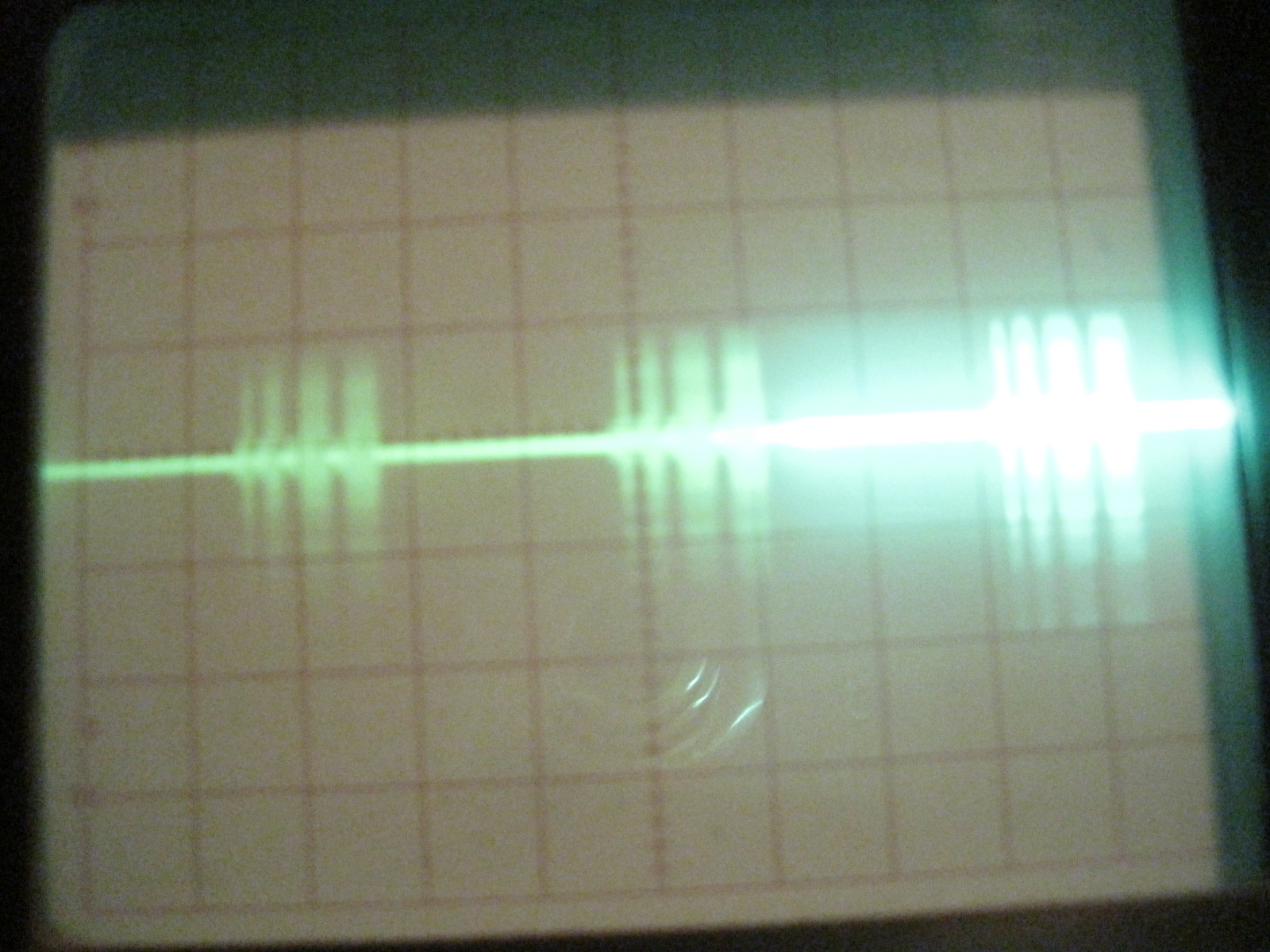

            Thank you for this invaluable hands on lesson. I lowered the TIME/DIV to 5mS and the position of the vertical scale (maybe a little too much), pulled out the vertical 5X Magnify knob and turned it down, adjusted the FOCUS and partially pushed down on the camera's button before taking the photo below.

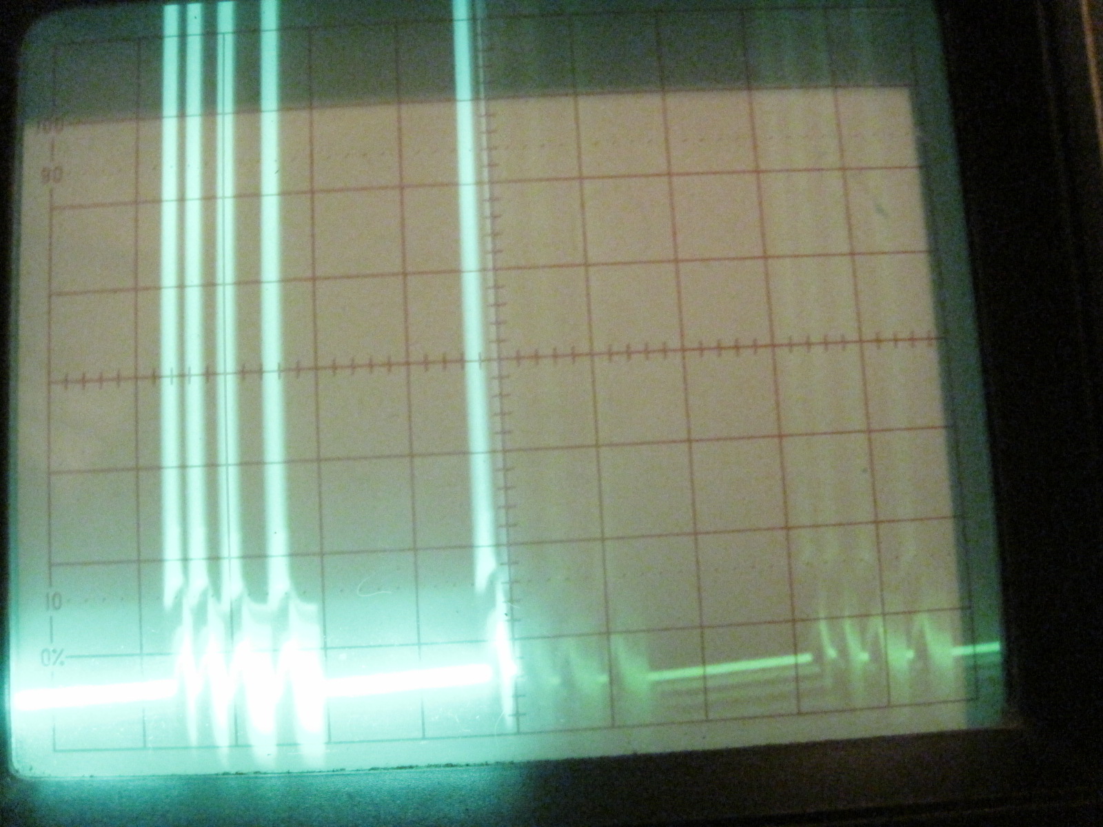

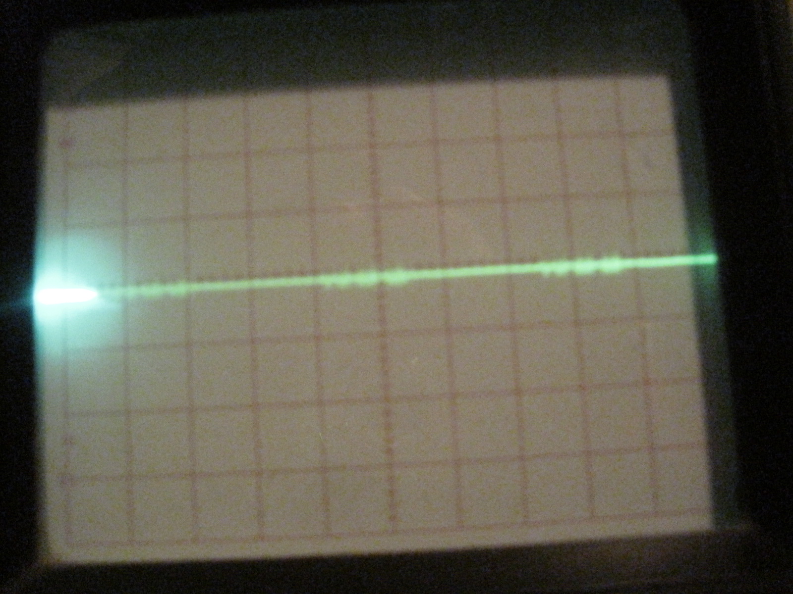

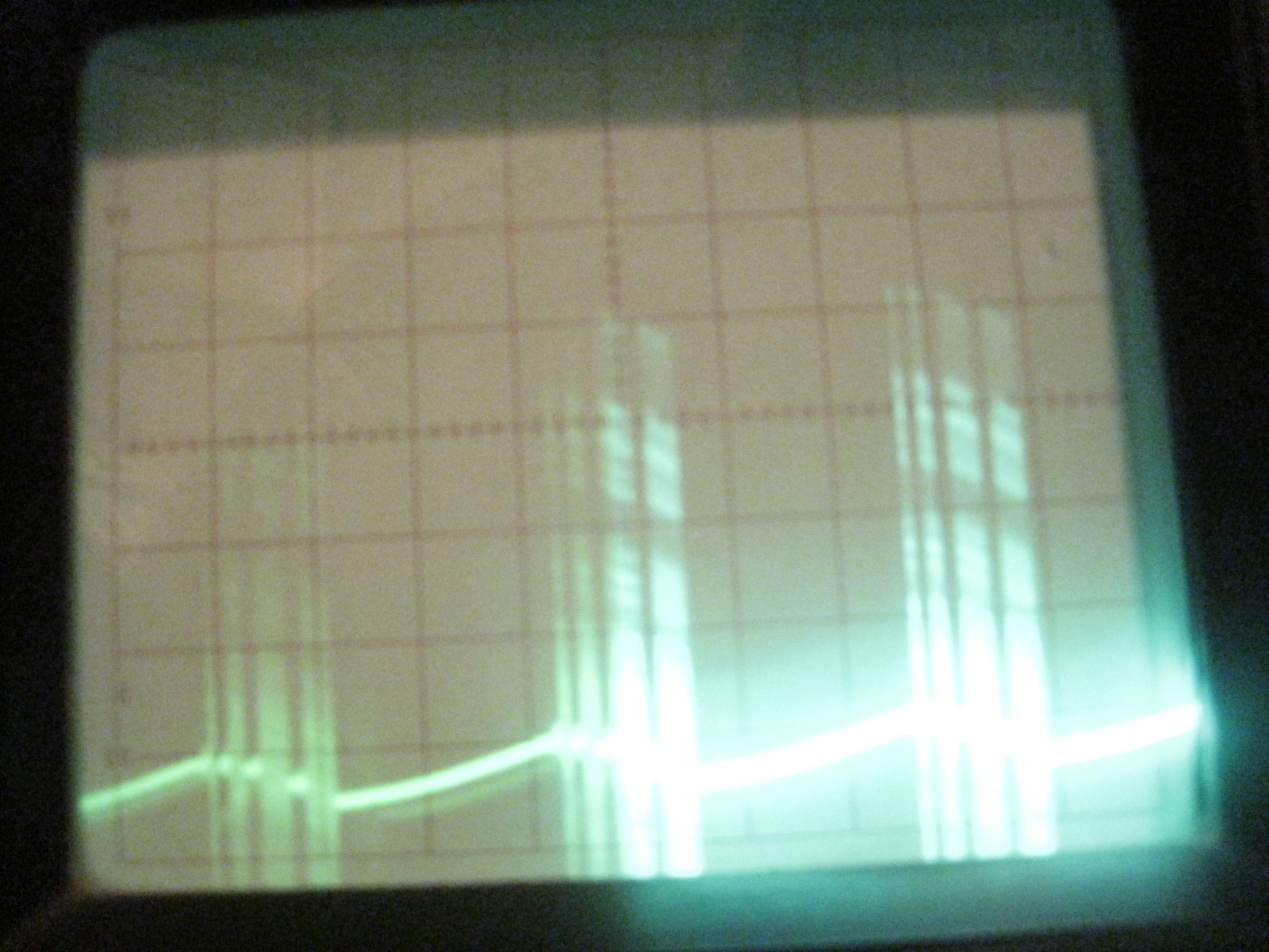

              Is it normal for the ABUS Test Point signals to vary? The YSUS and XSUS were fairly similar when testing different points but the ABUS produced a variety of signals as shown below. Both the Upper ABUS and the Lower ABUS boards had similar variations.
              Oscope Settings: 20mV/Div, 5mSecs/Div & 10X probe

                It looks to me like your SUS waveforms are both more-or-less correct; at least, the major parts are there.
                Next step, check your Va voltage is holding steady. I don't know what each of your test points on the ABUS should measure, because Hitachi provide really minimal documentation...
                  The Va signal on the oscilloscope was a DC horizontal line that jumped up and then quickly returned to where it started from. The Va reading from a DMM was 67.0V and held for a little while before slowly diminishing I guess due to the capacitors. The panel says the Va should be 66.8V.

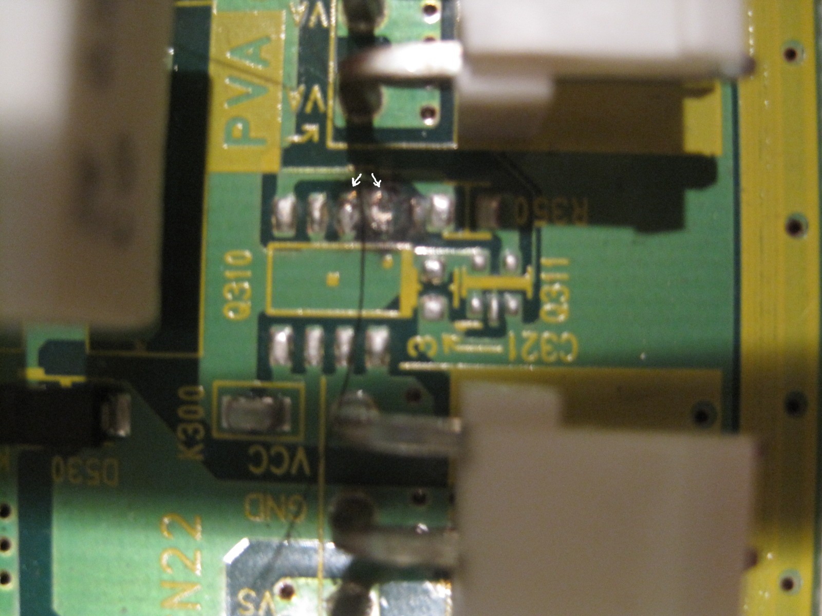

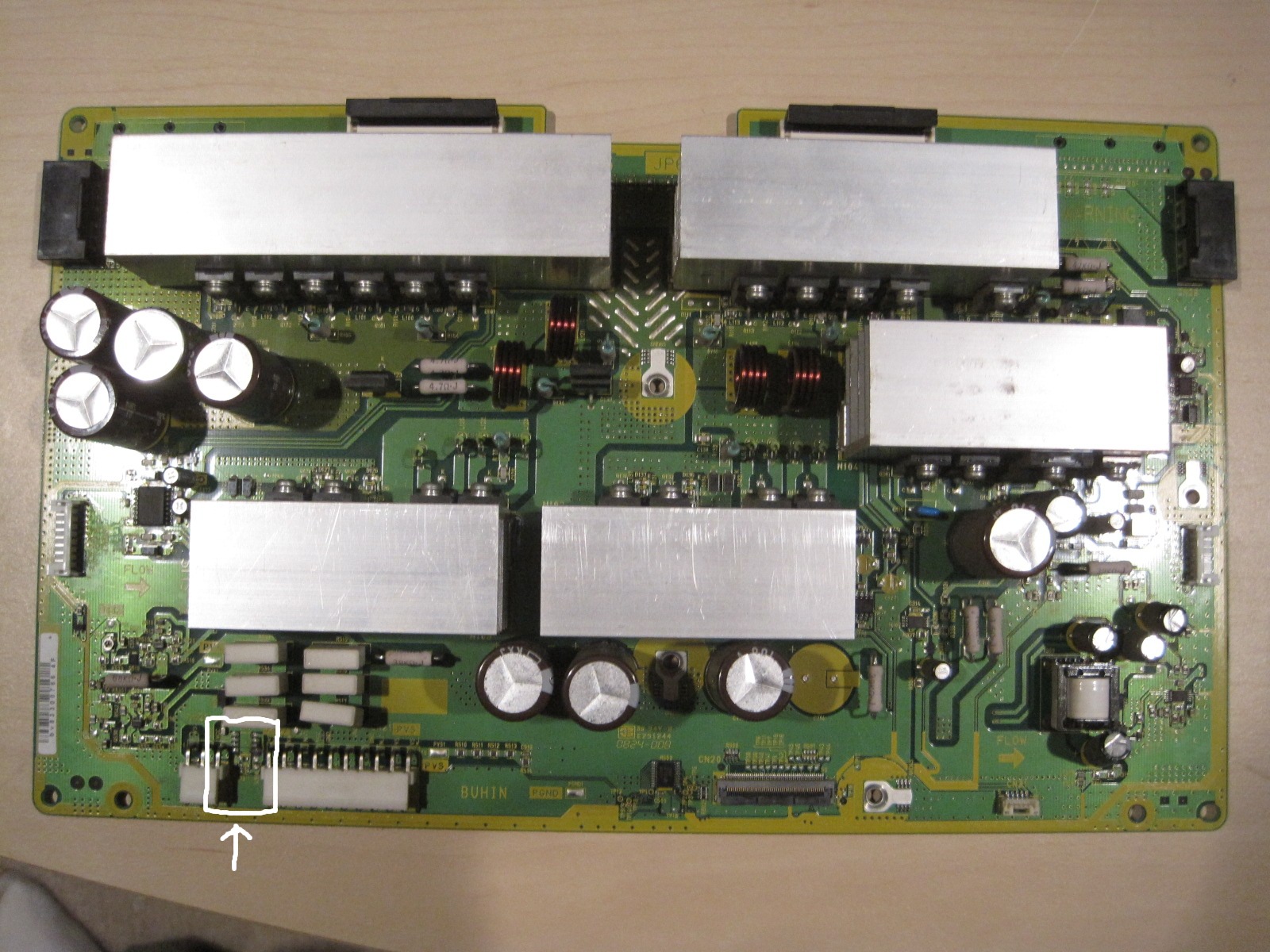

                        In any event, I'm embarrased to say it but I think I fried my XSUS while measuring the voltages on it when my hand slipped and shorted Vs to an unknown point on the XSUS. Now the blue LED is blinking 2 times (instead of 5) and when the screen briefly lights up it is noticably dimmer.
                        There are no components at the point I shorted and there is no schematic in the service manual. I think this TV may have beaten me. Below are pics of the damage.
                        Oh the agony of defeat.
