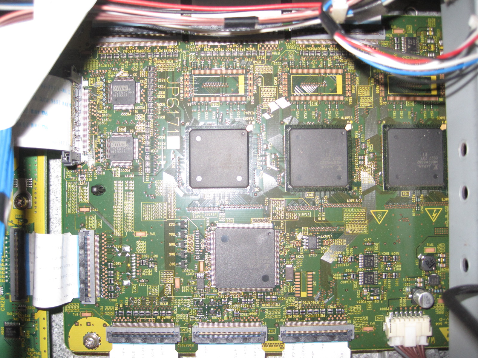

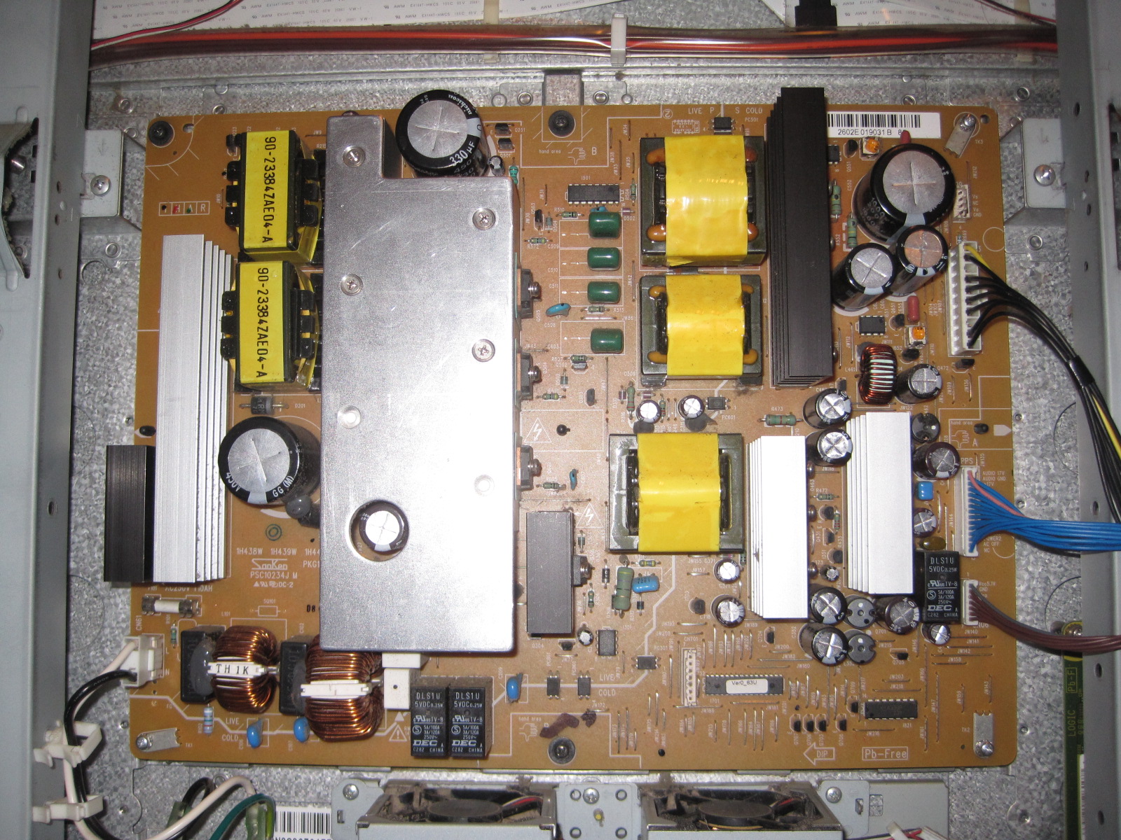

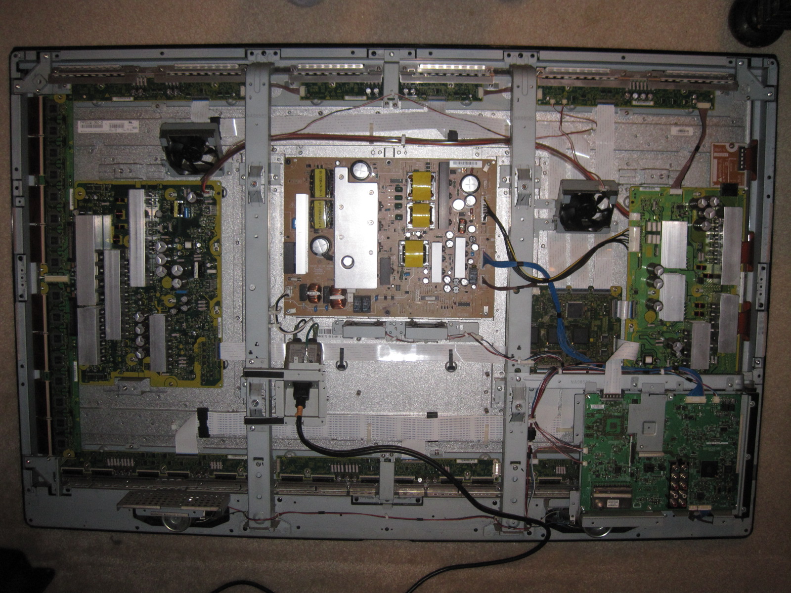

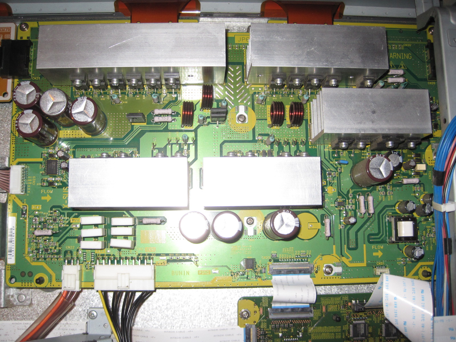

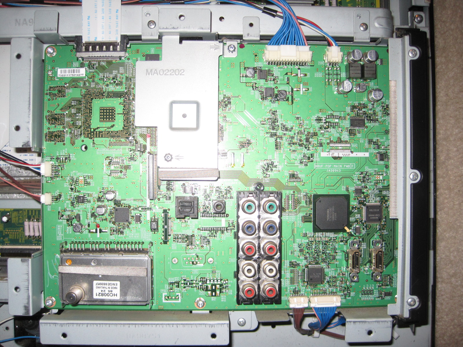

    I figured I should post some pics of the boards for reference.

      Re: How to Troubleshoot a Plasma TV (p50s602) with an Oscilloscope

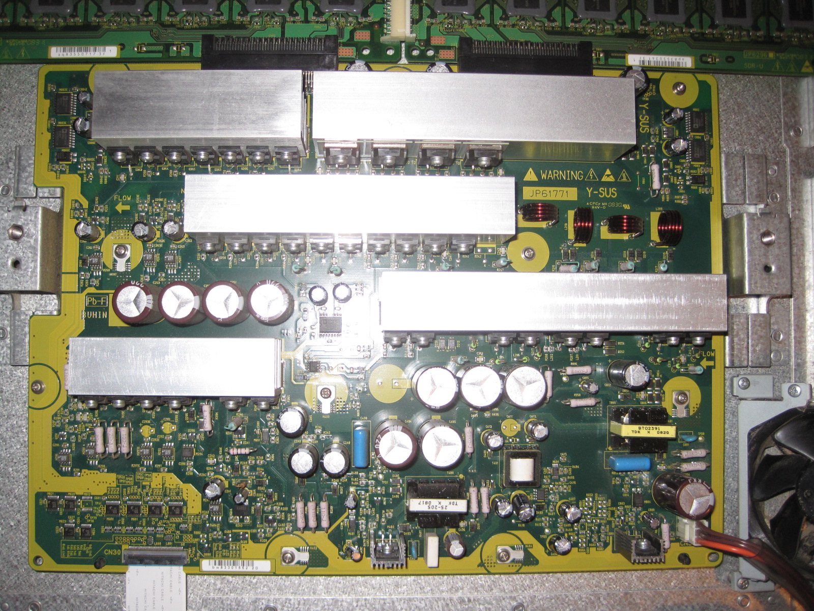

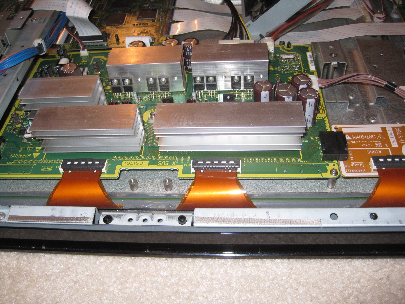

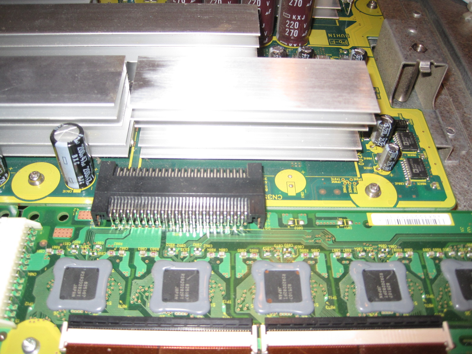

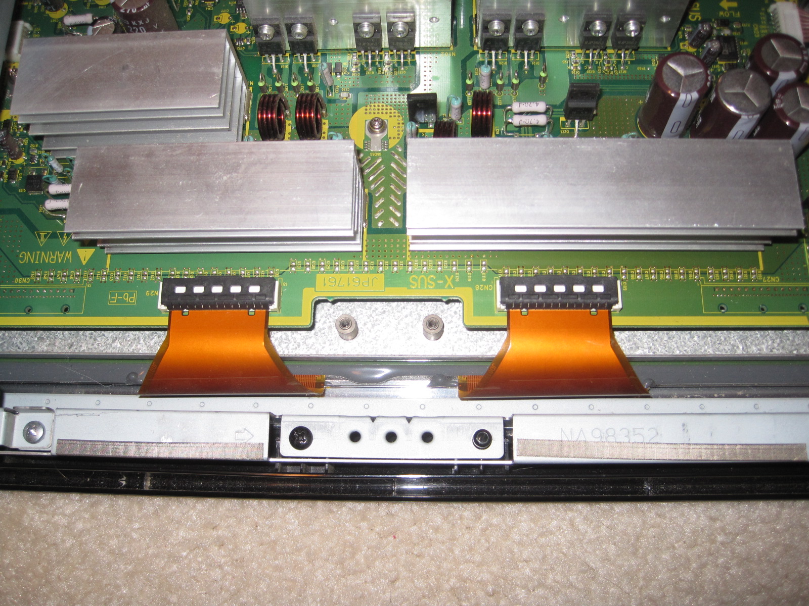

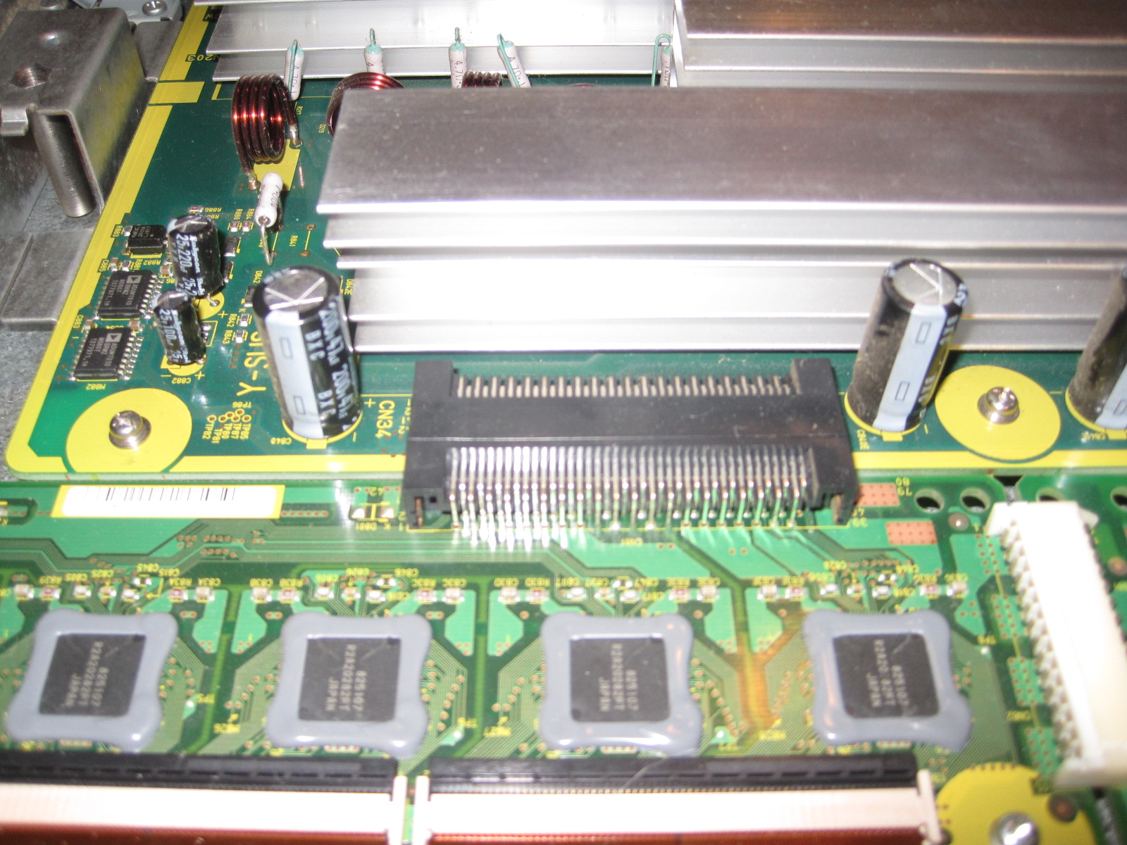

      You need to find the sustain board outputs. These are near the plasma panel ribbons, can we see a picture looking at the sustain boards from that angle?
        Gladly. First 3 photos are YSUS & last 2 are XSUS.
          I'm trying to see an obvious test point but I'm not seeing one, do you see any point marked TPnnn where nnn is some number?
            Next to the outer screws on the buffer side of the YSUS I am seeing TPnnn points.
            Right side of YSUS has TP80E, TP81E, TP82E, TP85E, TP86E & TP87E. Left side of YSUS has TP80, TP81, TP82, TP85, TP86 & TP87.
            The only TP points that I see on the XSUS are on the input side/half of the board.

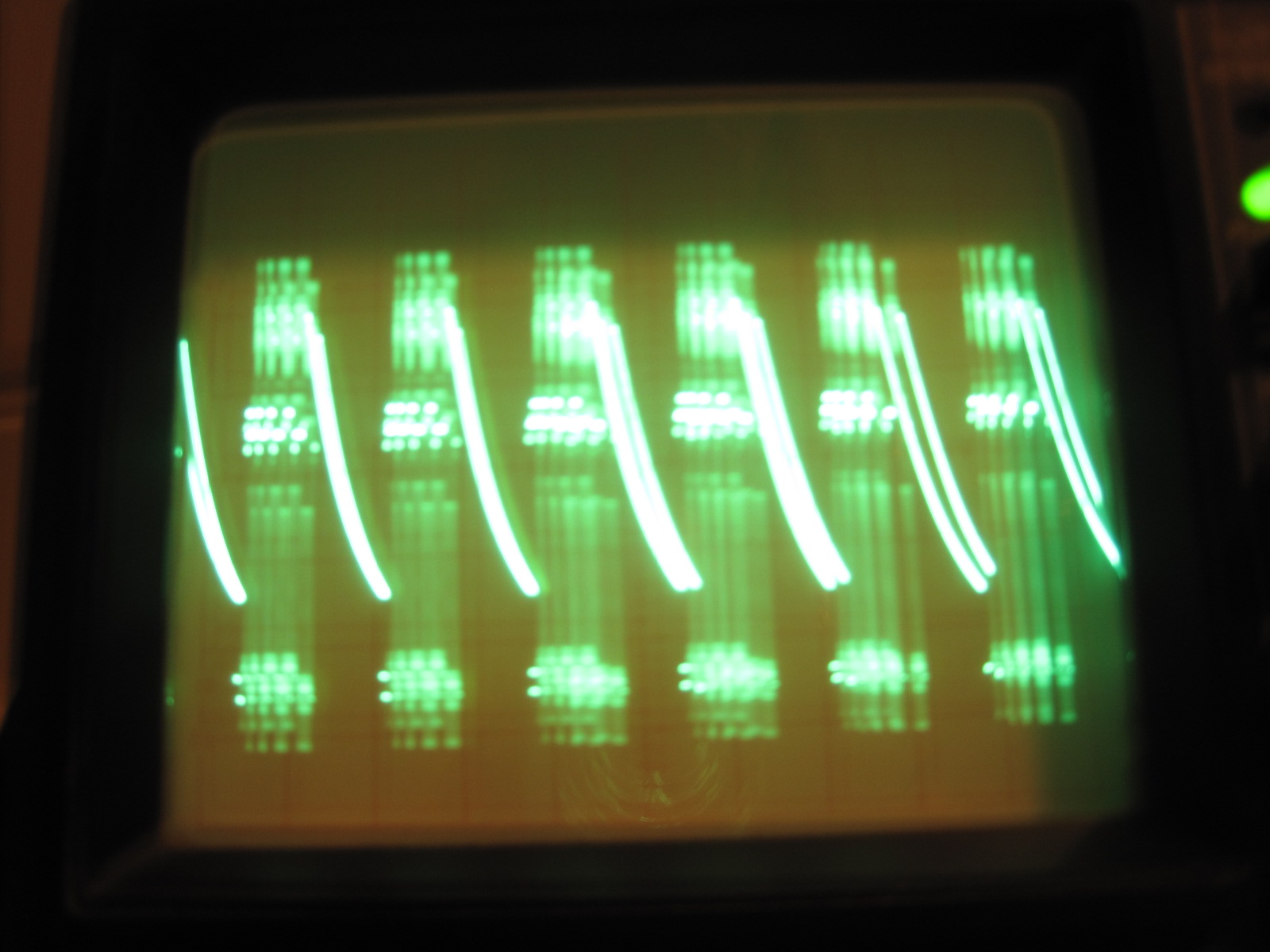

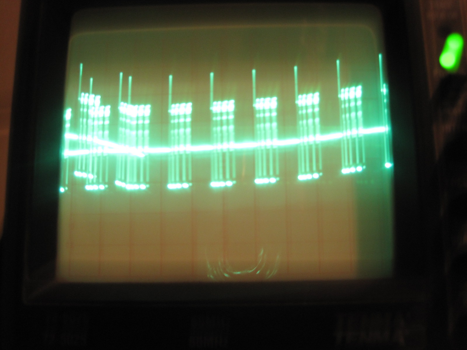

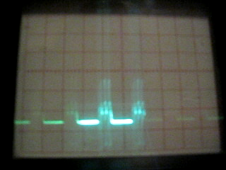

                I tested a few of the YSUS Test Points just to get familiar with the scope before I saw your post here.
                Unfortunately I don't know what the wave should look like. I was guessing I was going to see a square wave.
                I couldn't get the Trigger to make a wave on the screen.
                I don't know the frequency of the signal either & the largest division on my scope is 5V/div.
                I found one of tom66's old posts that said "With your scope, check Zsus output. 10X probe, 5V/div, 20ms/div. TV trigger works sometimes, if you have it." and I adjusted the scope to those settings and finally got something like a wave on the screen.
                I had to compress the video to upload it and took a screenshot just to give an idea of what the wave looked like. I'll post em' below along with a pic of my scope's control panel.

                    On a hitachi plasma, the sustain board outputs go both positive and negative, so you would expect a swing from about +85V to -85V (or whatever Vs is.) The TERES design kind of automatically generates a negative rail from the positive input. So I'd play around with 5V/div with a 10X probe, equivalent to 50V/div. The X-SUS (=Zsus) output is found where the plasma panel ribbons connect, on the X-SUS board.

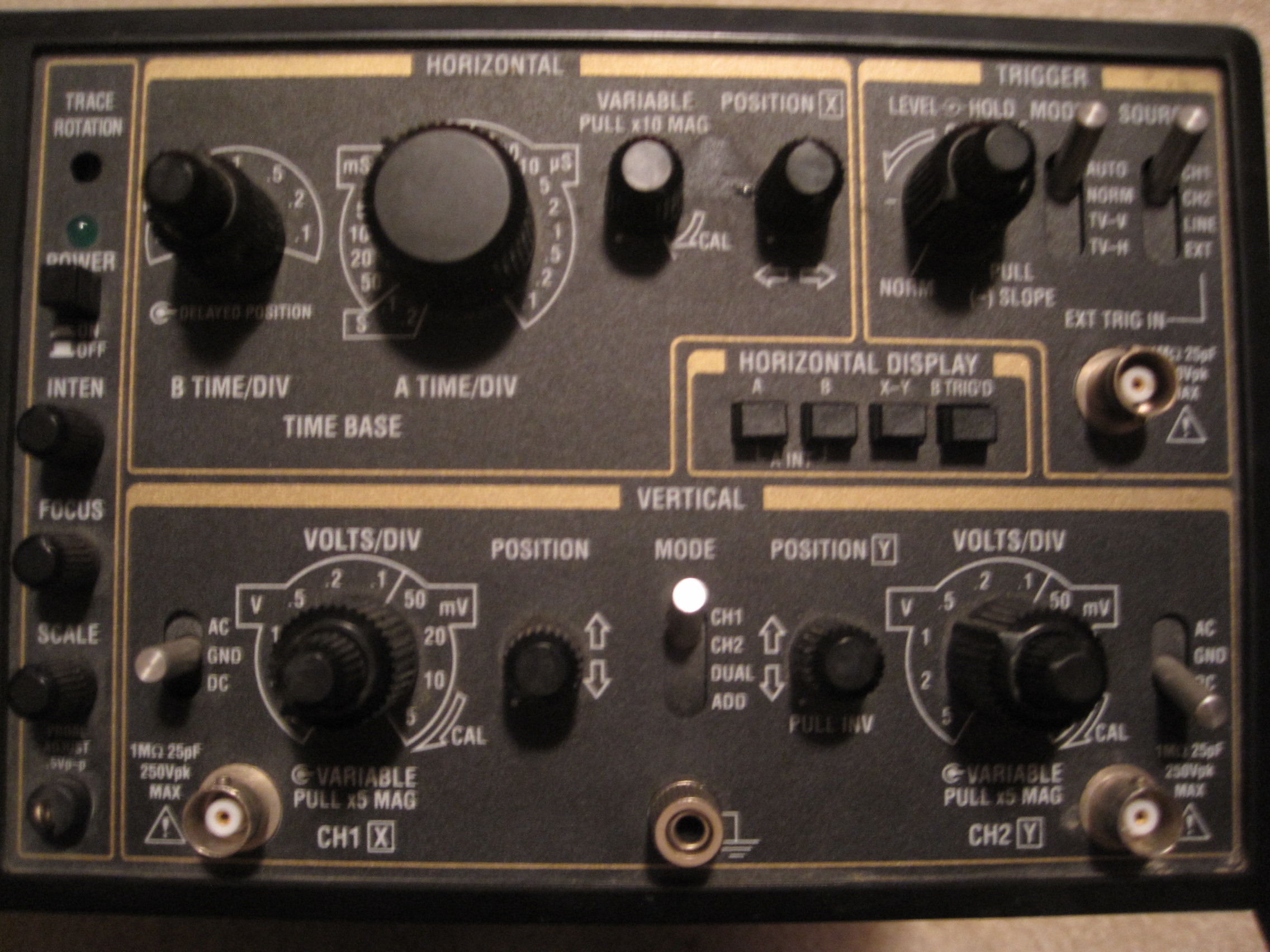

                      What brand/model scope are you using? I have both an analog 300MHz scope I use for communications equipment and a DSO (digital storage oscilloscope) that's a 100MHz that does all the fancy stuff. I may be able to help you a bit more if you advise the model of your equipment.
                      If you can't get the scope to trigger correctly, or you're in doubt at any time, the scope should have a test point right on the front of it.. most of them give you a 1Vpp square wave at 1KHz.. that will give you a chance to find and trig a waveform and play with the controls.
                        I'm still getting familiar with the controls but from the looks of things on the YSUS the signal is at 0V for x period then oscillating +yV & -yV for the same x period. Once I learn more about the controls I'll try to fill in the x & y values.
                        I can't get the Trigger to do produce anything not even when it's connected to the Probe Adj point. I think it's dead/not functioning.
                        My scope is an old Tenma 72-5025 and there doesn't seem to be any manuals around on the webz. It's an analog dual channel 60Mhz 250W max. The only hits I get with a search engine is on ones for sale.

                          The trigger control will do nothing to the wave until it goes off the screen.
                          Try this:
                          - connect probe to cal/test point.
                          - adjust controls to get clear view on screen of waveform.
                          - try adjusting the trigger level; when you go past a certain point, the wave will either disappear completely, or turn into a mess of interleaving lines.
                            I have tried seemingly every variation and combination of settings with the probe connected to the Trigger input. The only change I observe is a slight dimming of the horizontal line if I touch the probe to Probe Adj point when the Source Mode is set to Ext Trig In and in the 1X position. I get the same dimming if I touch the probe to my finger. The Line Source Mode gets no response in any situation. There is no vertical movement at all with the probe connected to the Trigger.
                            I've probed around on the XSUS and found similar waves at various points. They all (XSUS) have a similar characteristic of a falling slope after the oscillation whereas the YSUS appears to have a spike above and before the oscillation point. Below are some pics. 1st pic is XSUS, 2nd pic is YSUS.
                            I apologize for the poor picture quality. The YSUS picture falsely appears to bend.
                              You need to adjust the FOCUS control on the scope to improve the sharpness of a trace. What V/DIV are those at?
                              You only use EXT TRIG IN with the external trigger input; use CH1 trigger and CH1 for main input for now.
                                The XSUS was set at 10mS/Div & 2V/Div
                                The YSUS was set at 10mS/Div & 5V/Div
                                The measurements were taken on Ch1
                                With a DMM the XSUS measured 35V and the YSUS started at +66V then went to -140V.
                                The poor focus may have been from the camera.

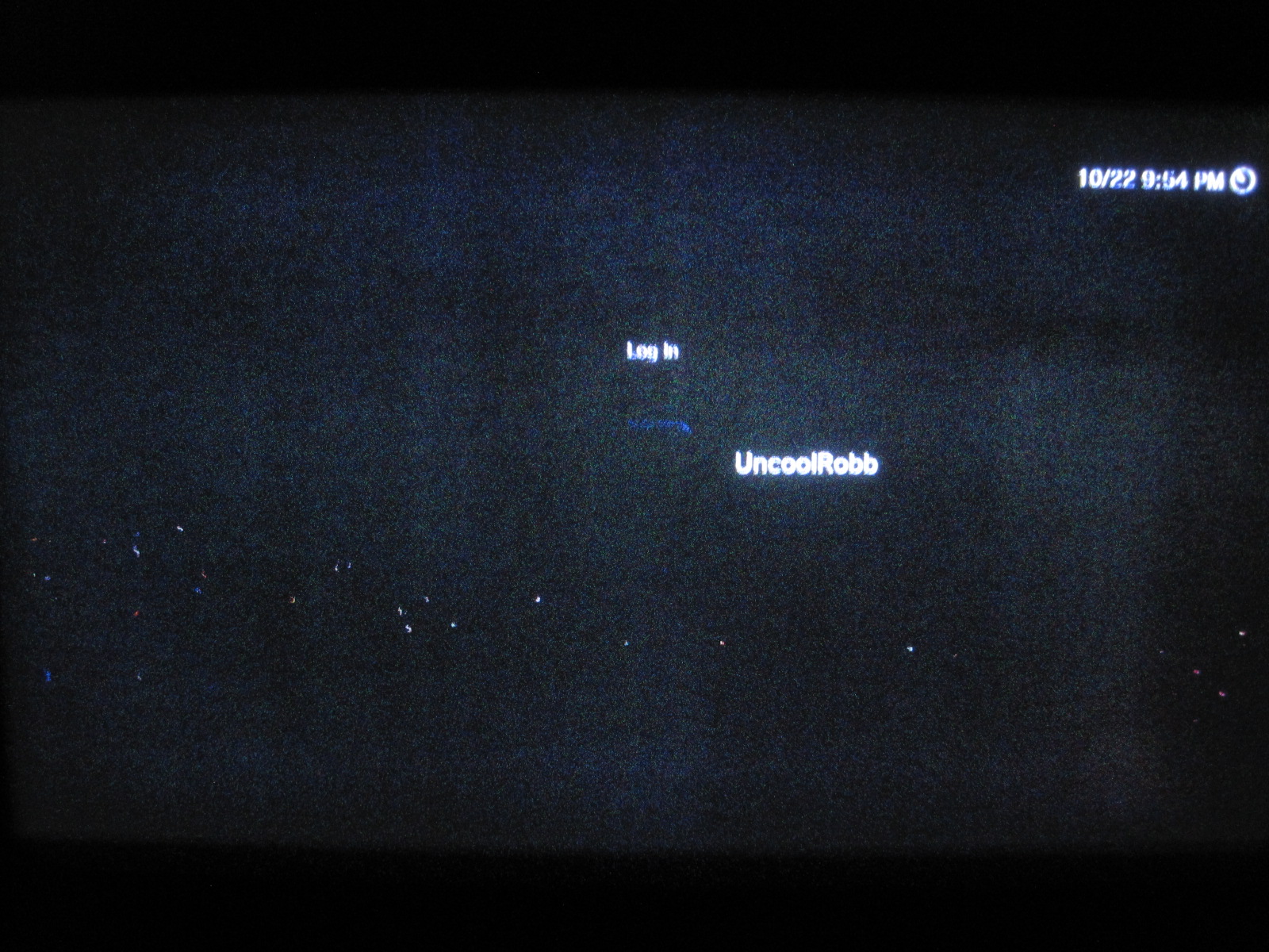

                                  The TV powers on and displays maldischarge (deepspace-like static) for 3 seconds then turns off leaving a 5 blinking LED code.

                                    Was that with a 10X probe?
                                      Yes
                                        Are you sure you got those the right way around? 1st wave looks like a bad Y-sus wave, 2nd looks like OK X-sus.
