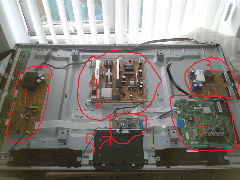

                                  Hi tom, the tv wont power up at all, when I press the on button on the front an led blinks, I think its just saying ive touched the touch sensitive button. nothing else happens. Please could you lable the circles on the pic for me just to make sure im working on the right board.
                                  1:
                                  2:
                                  3:
                                  4:
                                  5:
                                  thank you
                                    #77
                                    Re: Problem with Samsung ps43d490 PDP
                                    1 Y-main + Y-buffer
                                    2 PSU / Power board
                                    3 X-main
                                    4 Main board/video board
                                    5 Control/logic board
                                    • snipersquad100
                                      • Nov 2013
                                      • 330
                                      • uk
