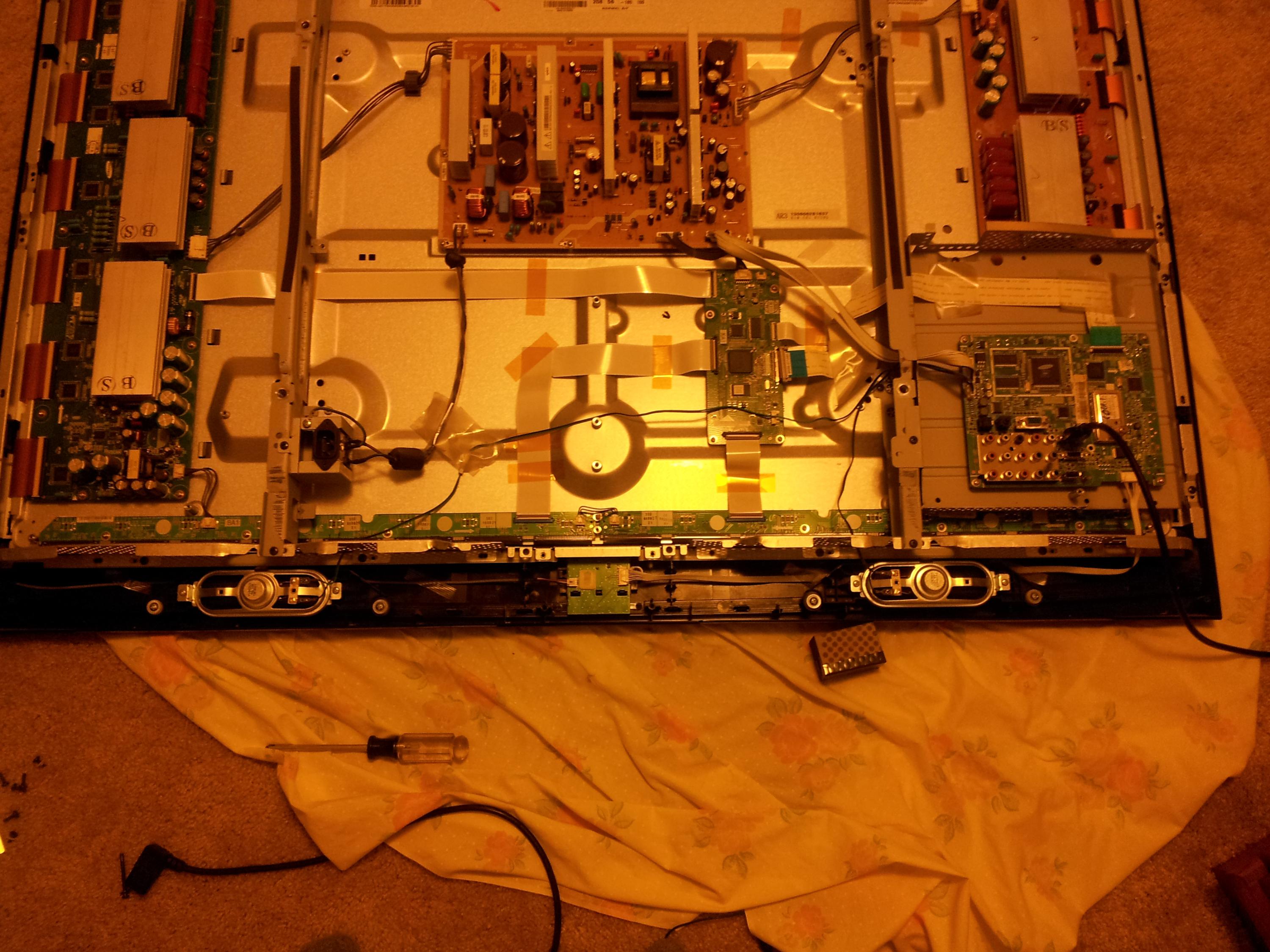

        Re: Samsung PN50A400
        In which case, most likely (though not certain) you have a logic board or Va failure on panel drivers.
        Along the bottom of the plasma panel, there are some thin boards which connect to the logic board. Can you get pictures of them? Usually, they have a fuse.

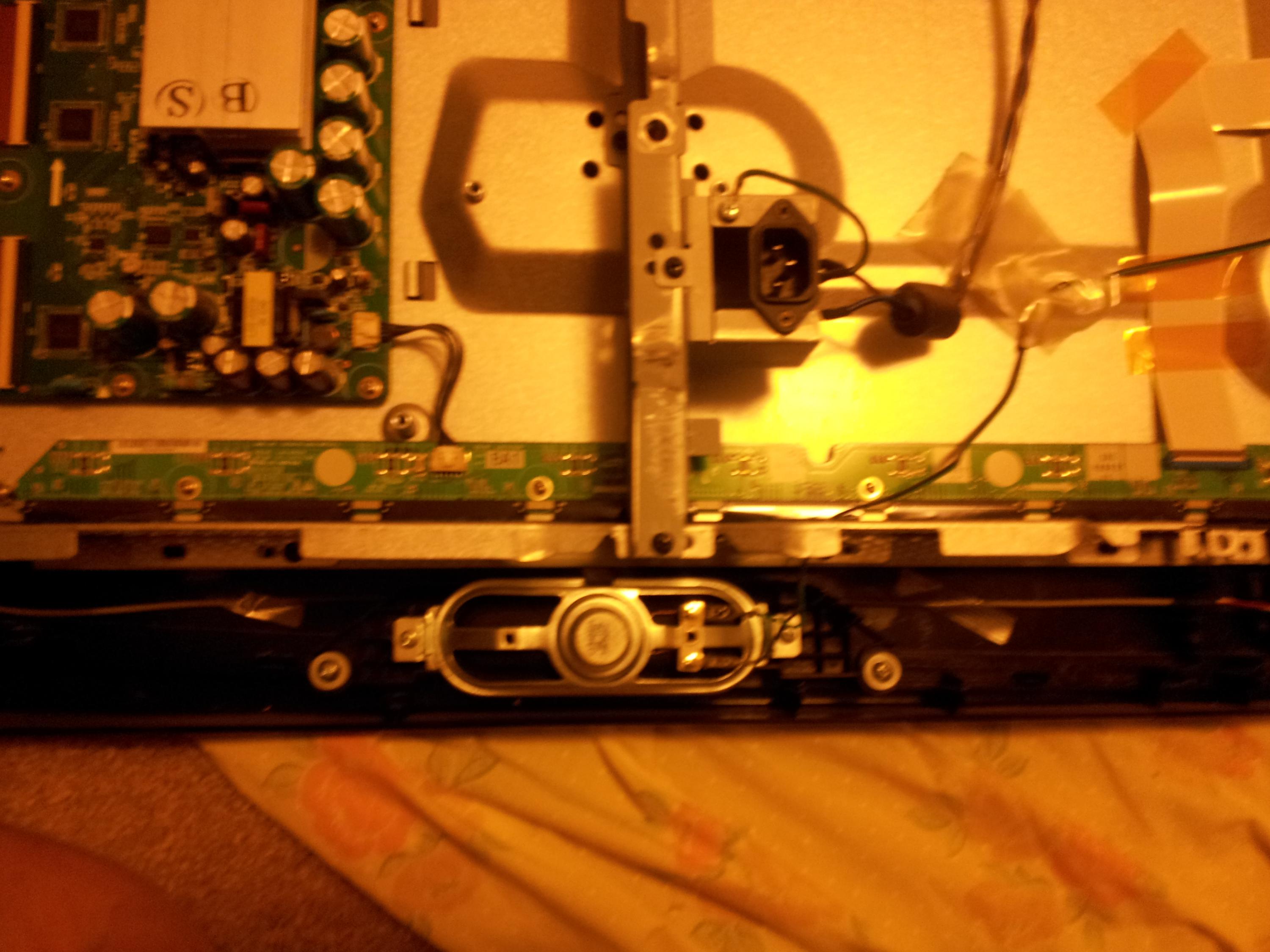

          Got the panel removed. Found the boards, did not find any fuses on them.
          I attached some pictures of the boards.

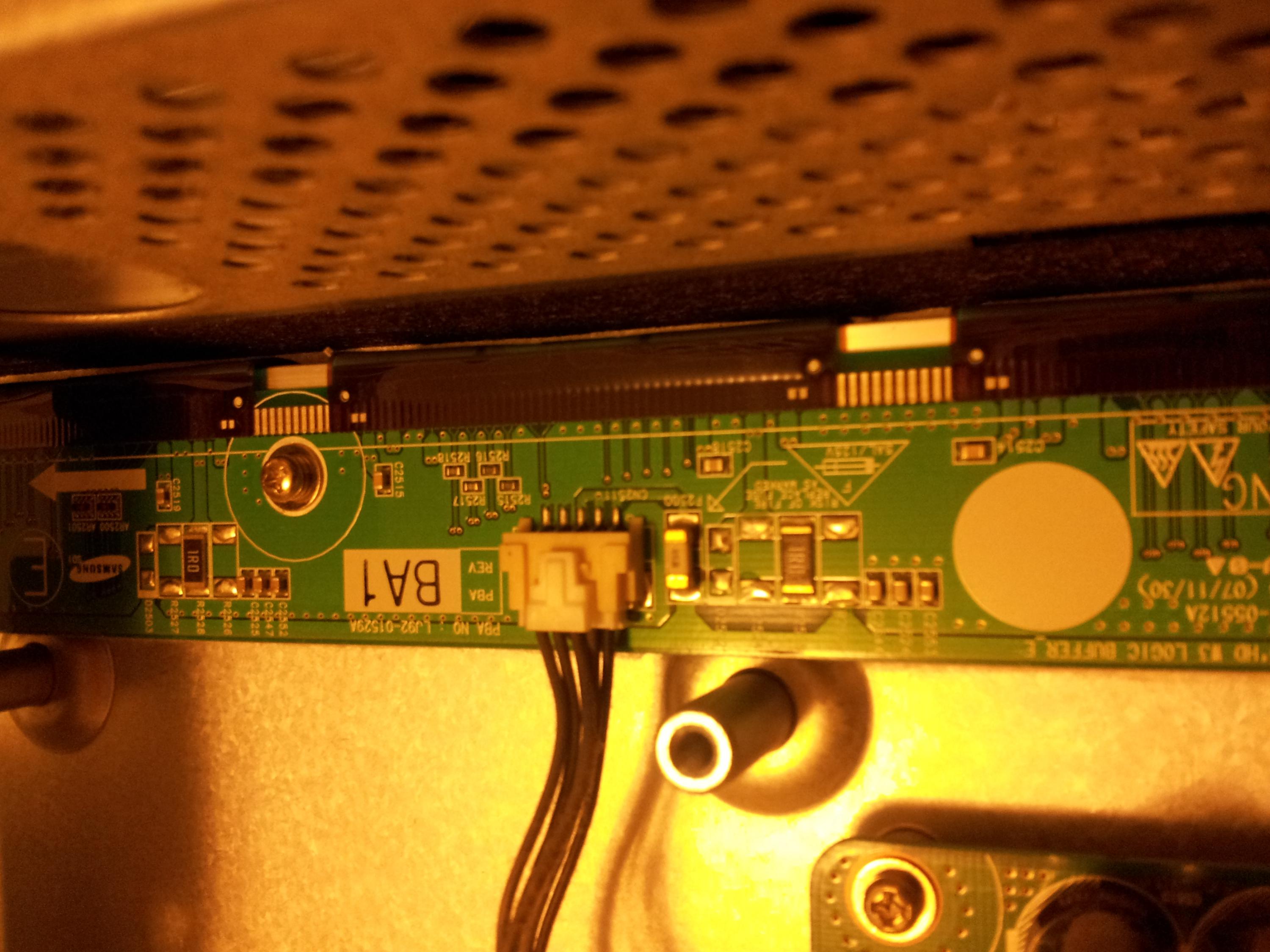

            I can see a little white surface mount fuse next to the connector coming off the Y-main, can you get a closer picture around this area? Do not unplug/replug this connector.
              It does appear to be a fuse. Good eye!
              Text notes fuse being a 5al/125v. Looks to not be burnt up.
                OK, set powered on, screen glowing, test voltage from each end of this fuse to chassis ground. Expecting around 55~60V both sides.
                    Got voltages. One side is 92v other side is 12v. The 92 side is the one that comes right off the connector from the y sus.

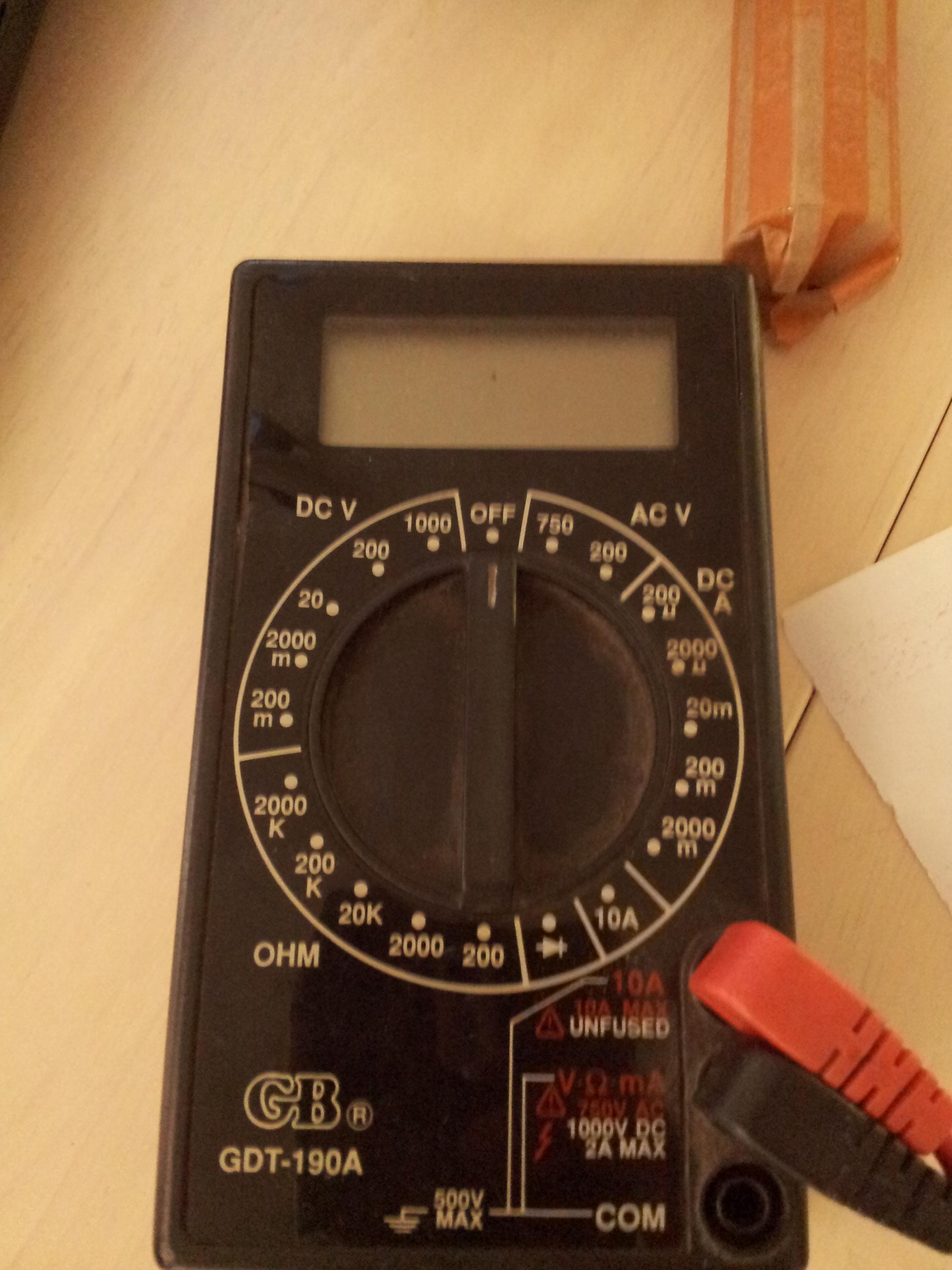

                        Set your voltmeter to the DC range, not AC. DC has a dashed bar and solid bar. AC has a squiggle like this ~.
                          Those are all DC voltages. I used the settings in the upper left corner of my dmm as pictured.
                            Just wanted to update this. After some heavy research ive found that the fuse in post 7 is a common fault with this series of TVs. Just replaced this fuse and tv is working perfectly!
                              For future info, The black lead goes to COM on your DMM.
                              Red will go to either of the top depending on the application in which it is being used.
                              This is why you were getting crazy readings
                              Not trying to knock you here but setting up a DMM is basic in electronics repair, Without it you wont get far...... So before you go jumping into another TV etc please do some basic learning on the tools you are using, difference between amps and voltage (its the Amps that will kill you) and basic troubleshooting guides. I say this as not knowing this stuff can be deadly!
