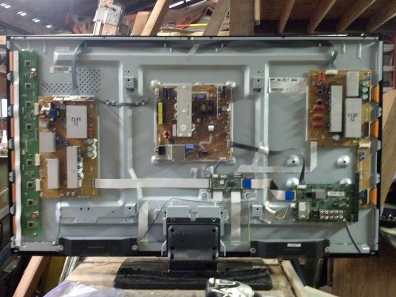

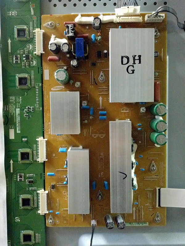

    I picked this up in a lot of tvs the other day, opened it up and everything looks ok inside, so I applied power. Set has standby and tries to turn on with a loud buzzing coming from the upper left corner ymain and buffer. I tried to power it up with the y and x disconnected and it gives me 5 blinks and a startup squeak. Next I reconnected the y and x and disconnected the y buffer board and I am getting the same startup squeak followed by 5 blinks. So my basic search for a service manual turned up nothing I dont suppose you guys have a link? Im supposing there is a jumper that needs to be placed between y and buffer like on the panasonics to isolate?
    Liberating magic smoke one part at a time
    Re: Samsung PN51D450A2D 5 blinks
    If you get buzzing check panel carefully around edges for cracks.
    Look at control board LED. Does it light for 5 seconds and go off for 2, or is it blinking approx once a second?
    No isolation jumper on these.

      You called that one right, after looking carefully there is a 1/2" crack in the screen in the upper corner where it was buzzing. Well I guess I have some boards to sell off, any tips on testing samsung buffers before selling them. Btw the control board led did come on for 5 seconds then off for two seconds.

        Samsung buffer test
        http://www.youtube.com/watch?v=51SZsfH60EY
        Most likely it is bad though, I would not risk selling it unless I was absolutely confident.
        5-2 indicates control board has shut down due to bad plasma panel, X-main or Y-main (failure in combined energy recovery circuit.) You cannot be certain the X- and Y-main are good but in most cases they are - cracked panel doesn't usually kill them. That is unless the previous owner hit the screen in frustration after it stopped working... You would need a scope to test the brief output before control shuts it down.

            Caleb. Usually in my findings is that if there is no damage to the substrate material on the screen usually buffers survive being powered up on a cracked panel. Panels where the substrate material cracked along with the glass theres a chance damage can happen to the buffer ic. But a quick ohm test should reveal that.
