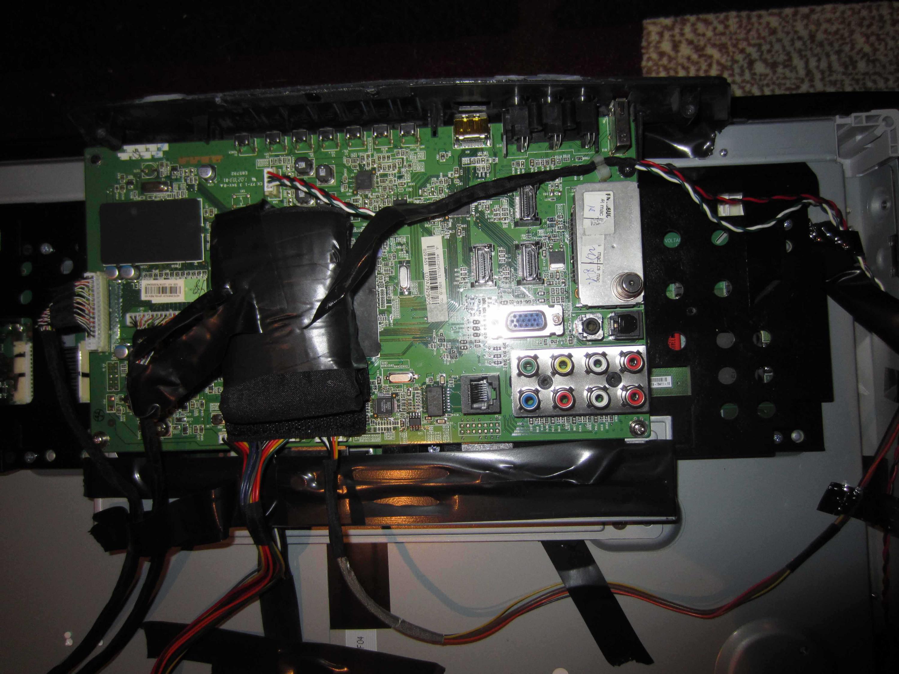

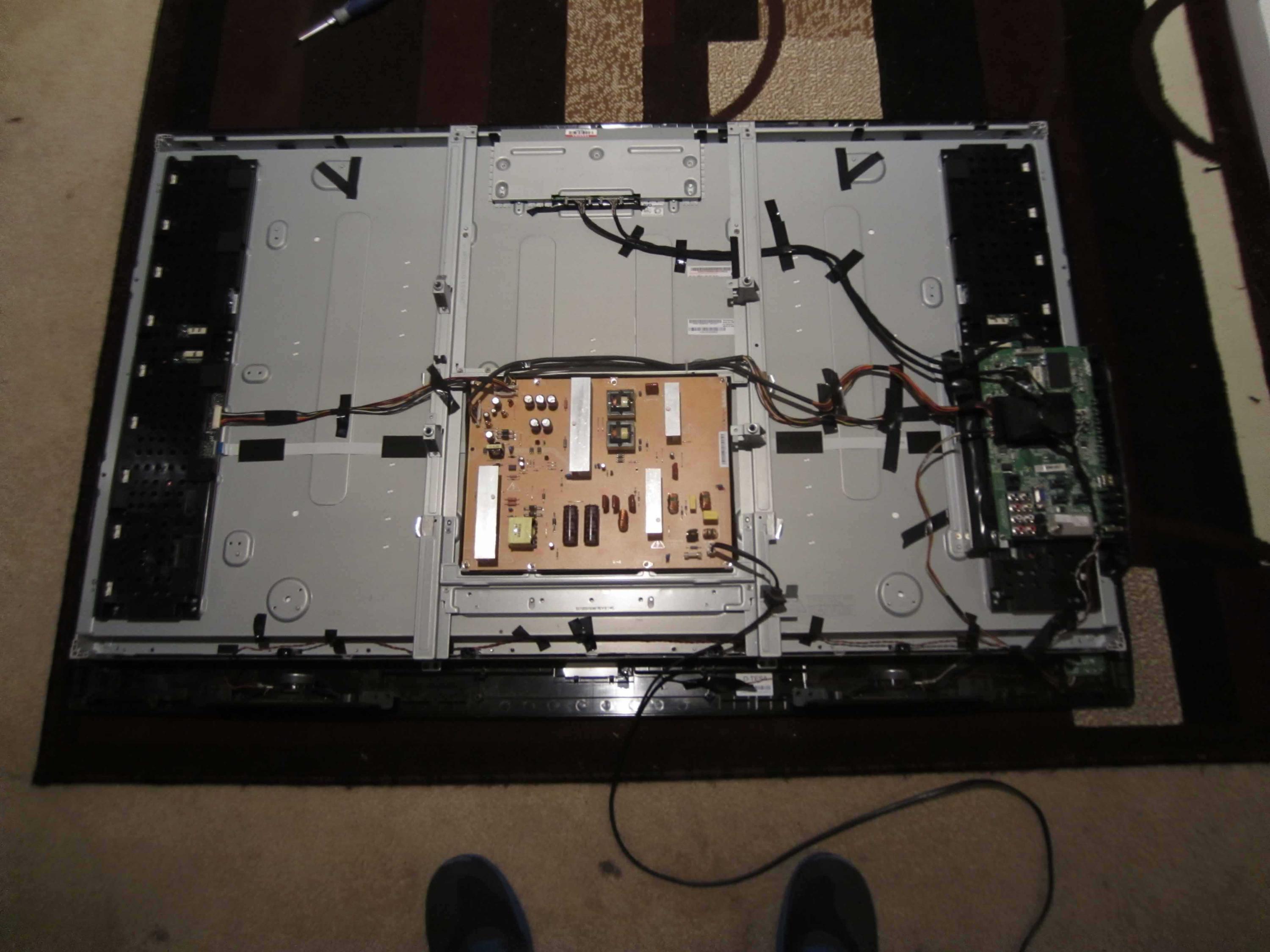

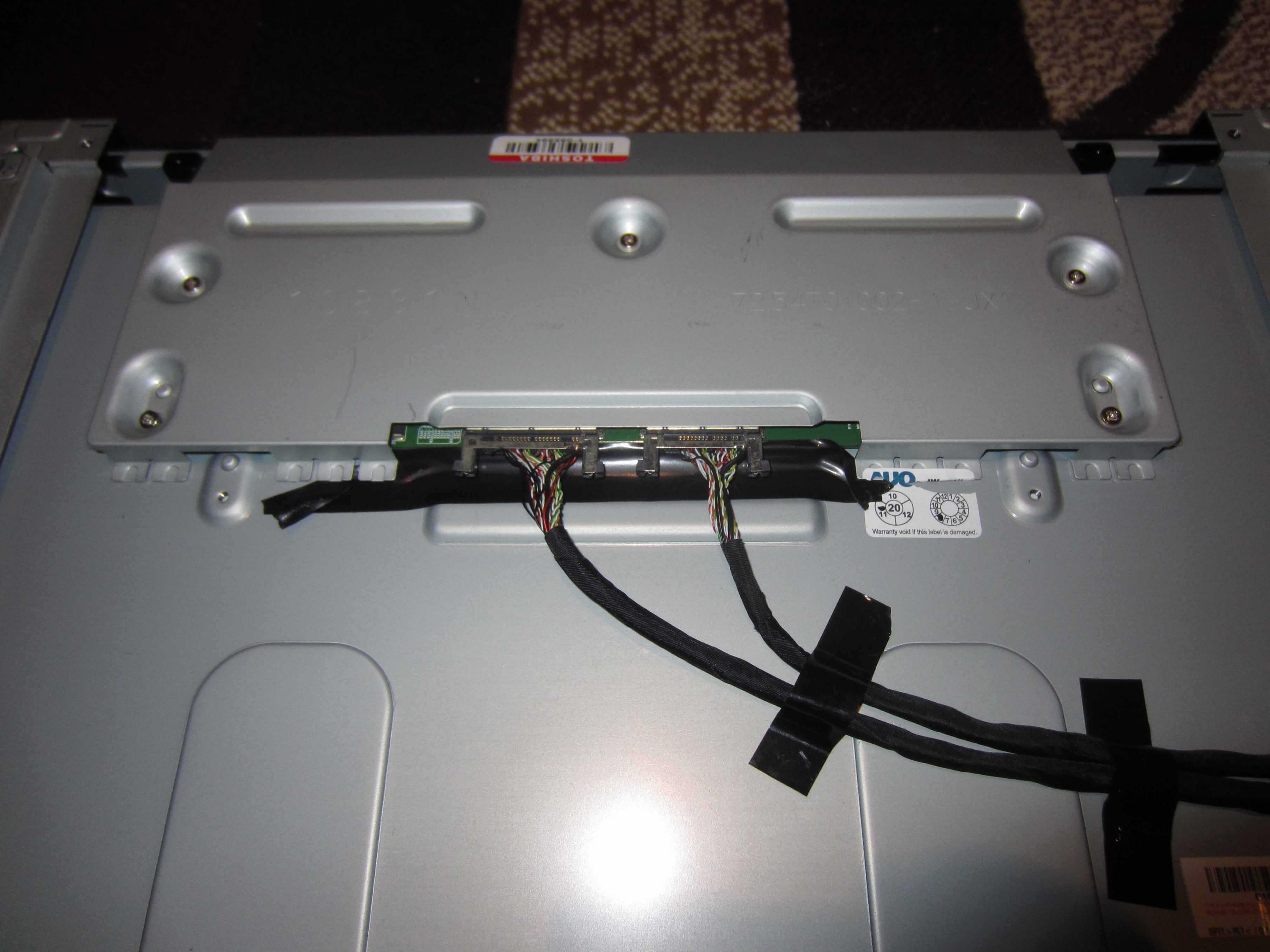

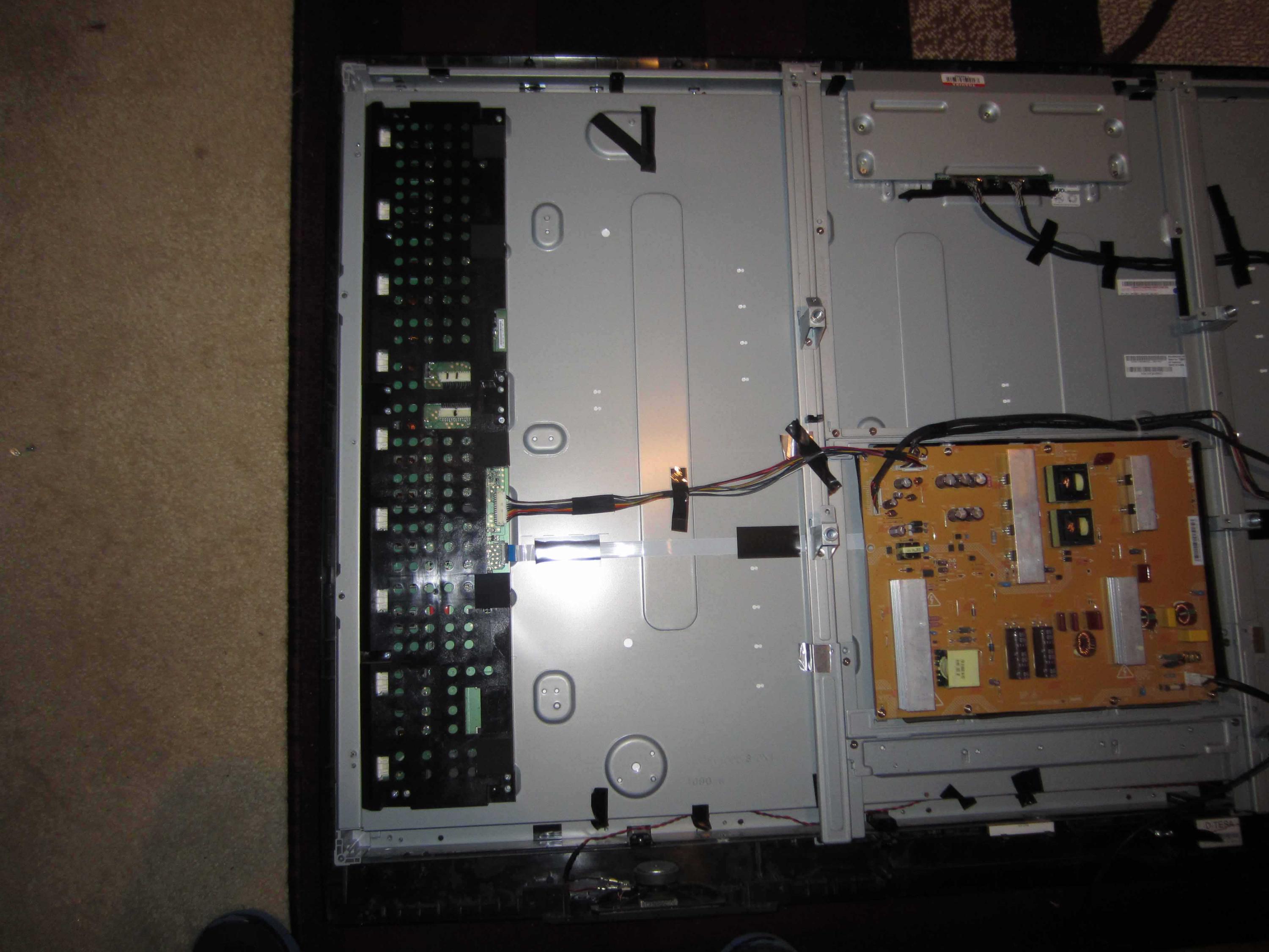

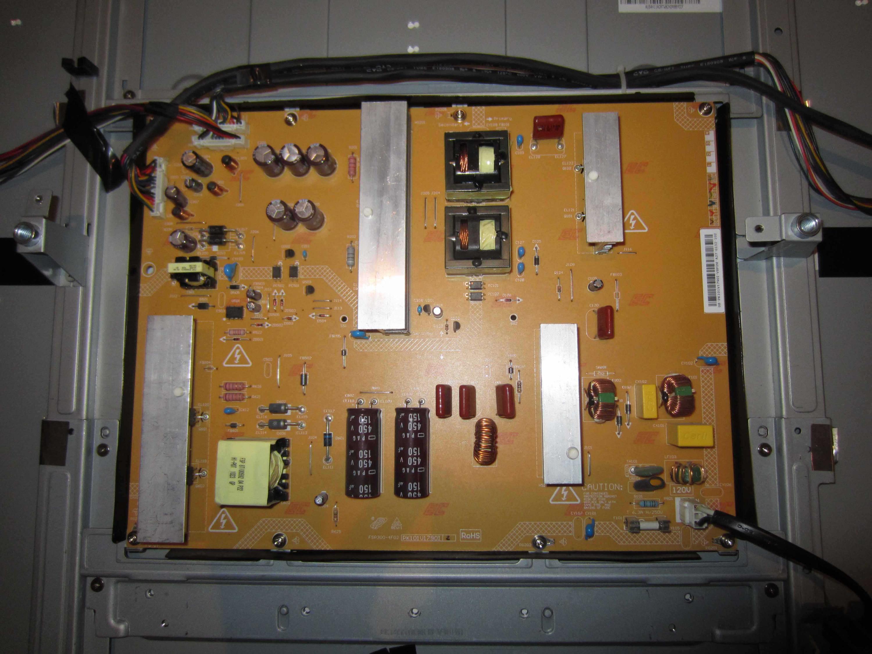

            Hello Again. I'm sorry I've haven't had the time to resolve this issue earlier. aaronwt6, i opened the back of the tv and did reseat all of the connections on the inverter board on the left side. I've attached some pictures for your reference. The inverter board i checked is to the left side. I also reseated the connections to the tcon board shown on the top part of the lcd.
            To the right of the lcd, there is also what i think looks like an inverter board underneath the main board. I have not found any diagrams online to explain what everything is, and since i'm a lcd repair amateur, i didn't know and did not check that side of the lcd (the high pitch noise comes from this area)

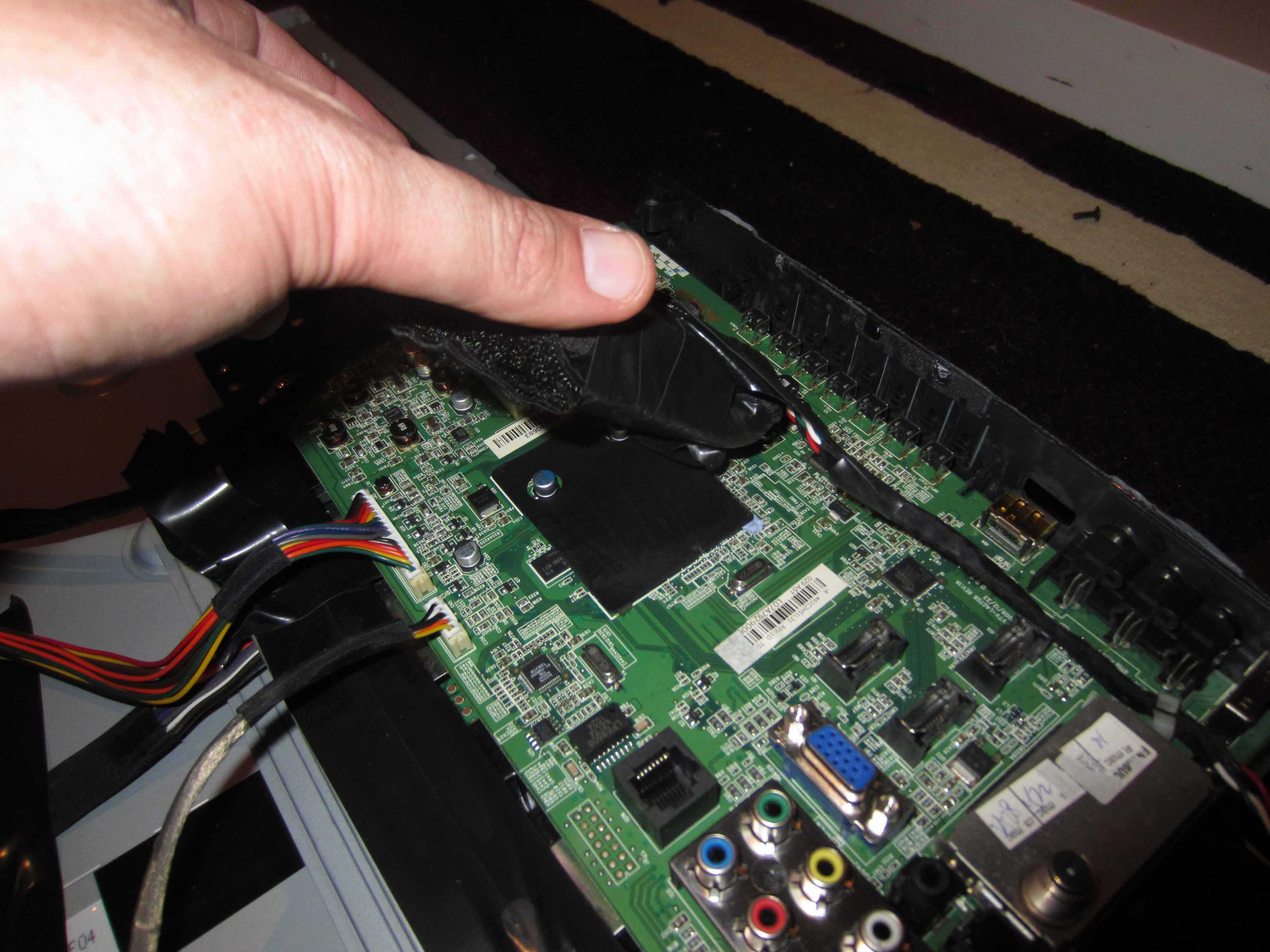

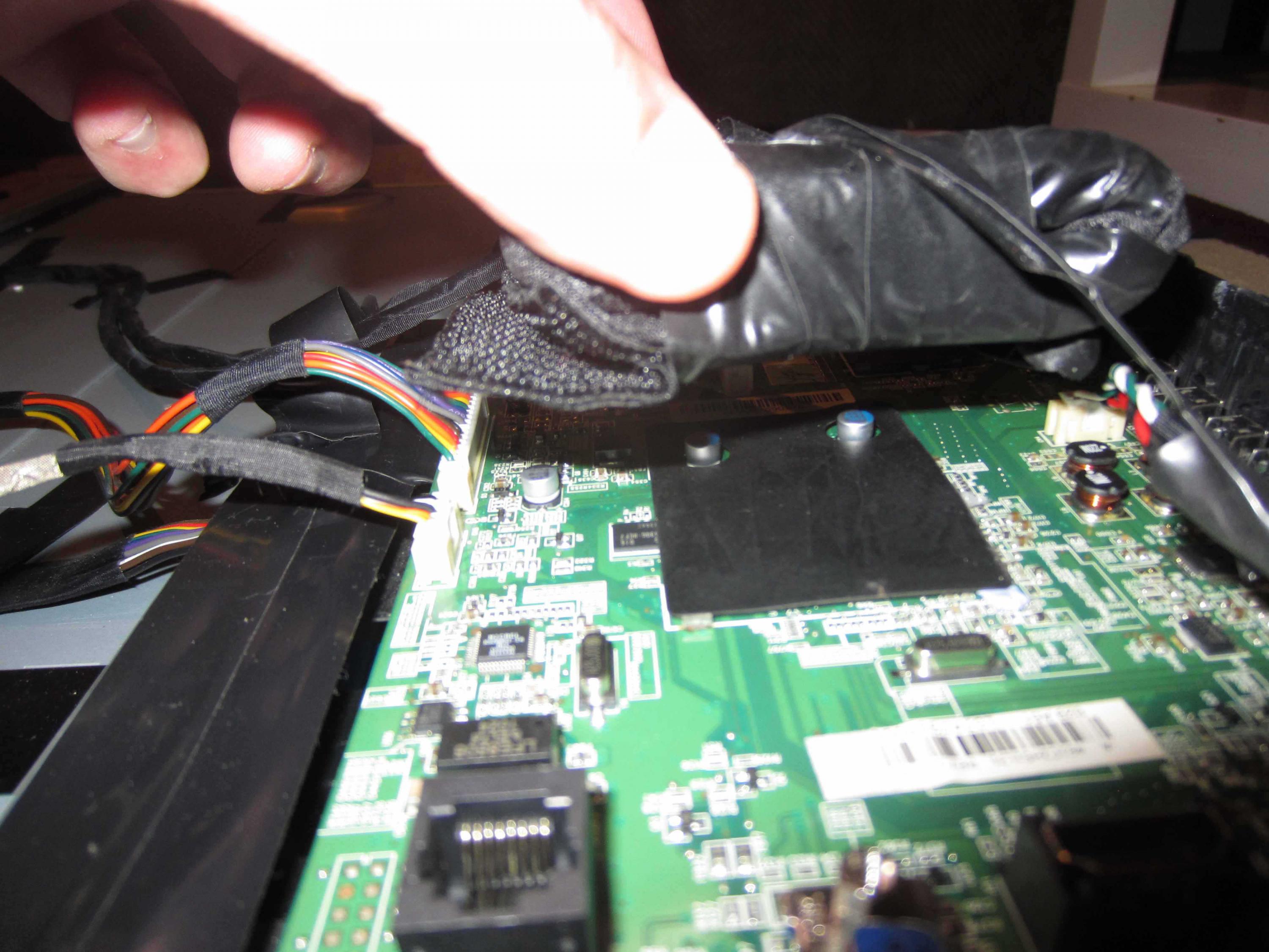

            I also found that this tv has been worked on before. There is a piece of foam that was "secured" with electrical tape on top of the main board (shown on pics 31 through 34)

              Re: Toshiba 55g300u. Picture goes on and off but sounds remains
              Oh dear, it looks like the previous owner has tried to apply pressure to the video processor to keep it from breaking off the board (not physically but the electrical connections) - like similar problem in Xbox360/PS3. The best fix is going to be to replace the main board if that is what is causing the problem; I don't see any obvious burning on the inverter connections.
