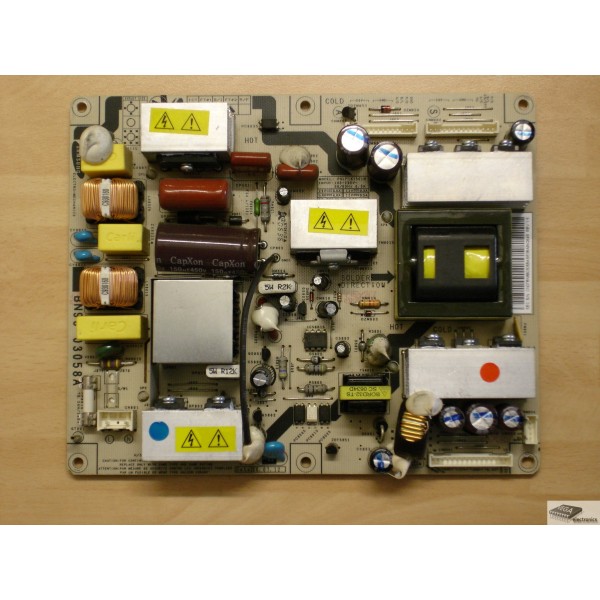

    Power board: BN96-03058A

            Also, check the 12V from PSU, there is a 13V and 12V rail on these I believe and 12V is for audio.

              As I only have my phone with camera its not very good at taking crystal clear photos, I have resorted to hunting down a good photo of the same board.
              Not sure which rail you are talking about. would that be the 4 wire rail?
                Re: Samsung LA26R71WD
                That is the power board, I want the main board, one with video inputs.
                Rail = electronics terminology = basically means voltage source shared by many devices.
                  well tested the 12 volt rail and am only getting 2.5v
                    worked it out the rectifier on the power board was dry soldered.
                    sound works.

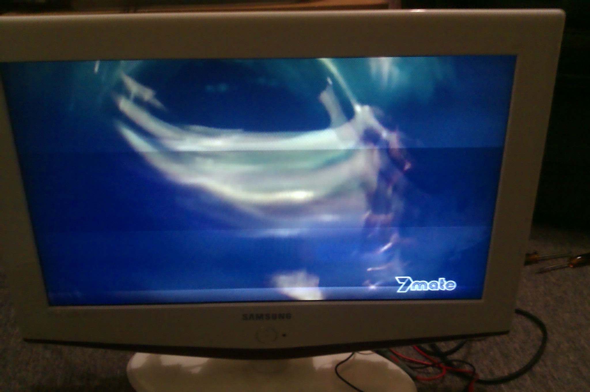

                    Its Horizontal lines when you cold start it up, then it flickers at random for some reason...

                          they are flashing lines bit hard to get a picture of them
                          certain distance apart shading the picture each bar.

                            Got the picture of the tv doing its problem.
                              Looks like it could be panel - possibly tab bonds.
                                Picture does come right after awhile.
                                but when its cold it takes awhile for the symptoms to disappear.
                                how do I inspect these tab bonds?
                                  You take the front plastic off and the metal frame off the panel.
                                  Here is one for top bonds though your fault may be the side bonds.

                                    I don't see how it could be tab bonds being that these are horizontal and them tabs are connected to anything but the LCD panel.
                                    but unless its only a few loose ones that join on tab1 that goes to these horizontal tabs.
                                      Yes, that's me.
                                      There are both tabs on top and side of panel.
                                      Top left bond could possibly cause this fault too.
                                        winner winner chicken dinner lol.
                                        Yes I think you are right just had the panel off for a hour and flexing that top left does recreate problem.
                                        now suggestions on what is a good material to use as a shim.
