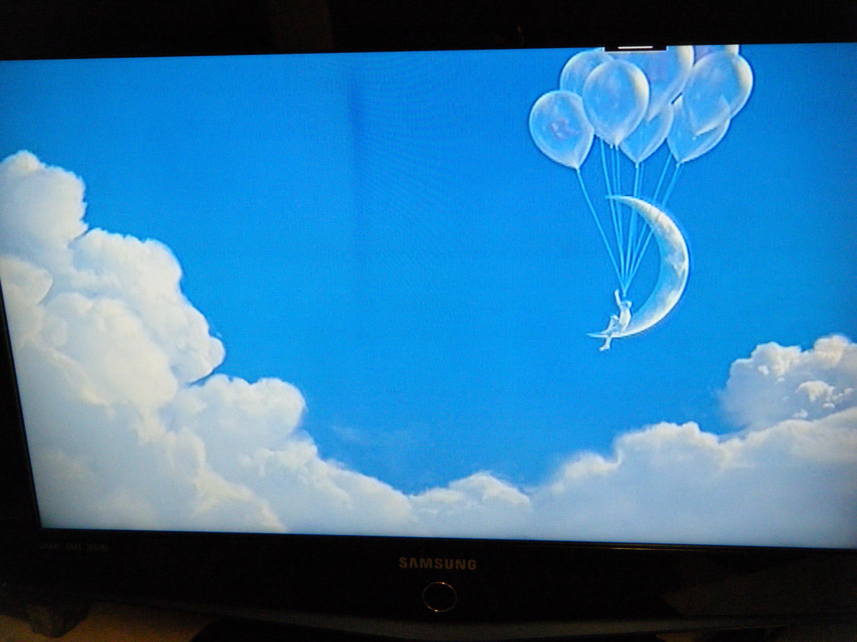

    Hi Guys,
    I have an interesting one on the SAMSUNG LE32R73BD,after a short while a darkish area appears in top half the screen vertically and looks about 1cm across and about 10cm long it is difficult to take a picture of it. It is about third of a way across the screen from the left hand side as you look at the TV
    Any thoughts? do you need a pic of the sets internals?

    Hi Guys,
    Just managed to get an image of the black area

      Bad panel - Mura problem. Maybe cleaning backlight films will work but probably not.
