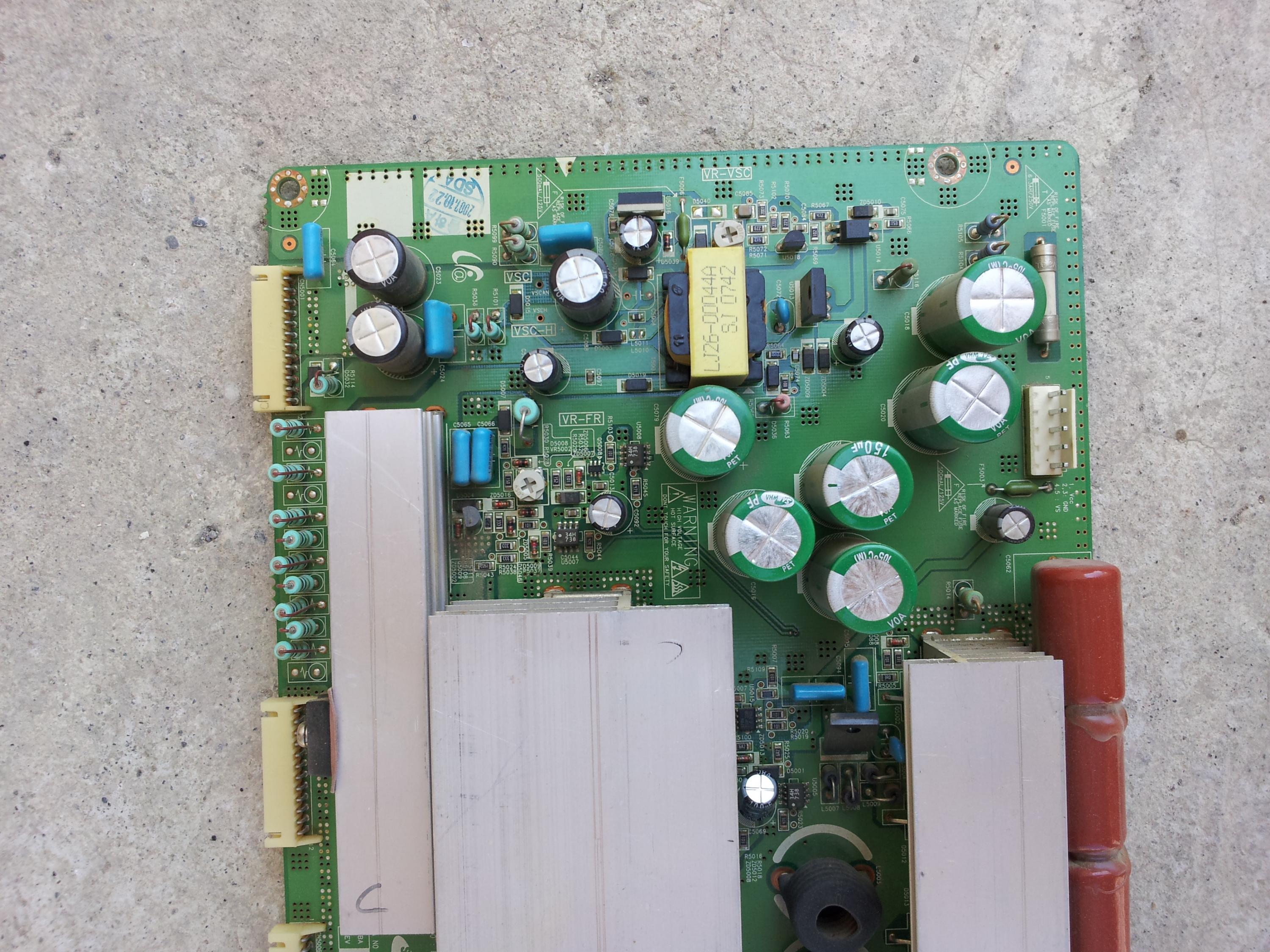

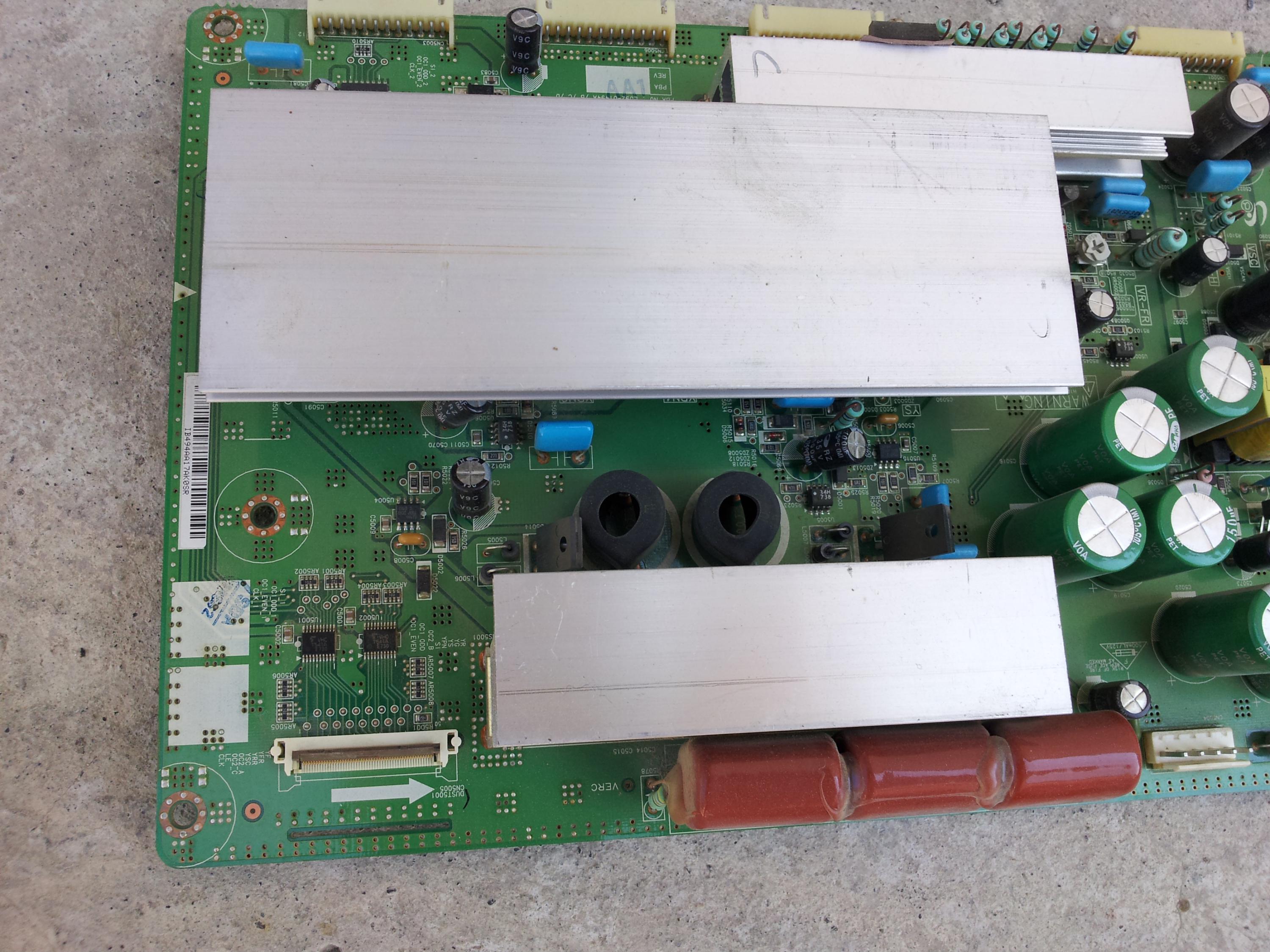

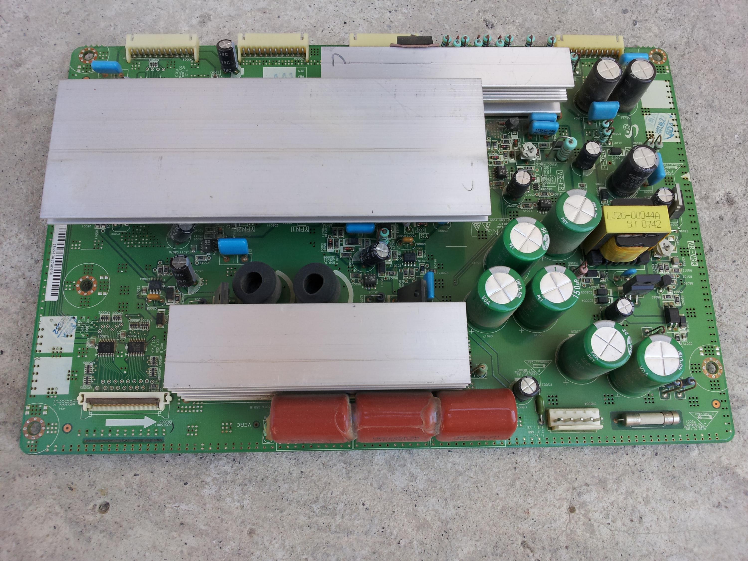

    Hello!
    -this old plasma i am talking about was working very well in the evening and next morning there was no picture, just audio.
    -after opening the case 5-6 caps were visibly bulging. no other visible signs.
    -fuses were ok.
    -bulged caps were in the 5V, 12V and 18V rails. they were replaced hoping that this would be the culprit.
    -the tv acted the same way. after measuring, i realized that:
    Va 63V
    Vs kicked for some milisecs to over 200 and than 3-8V.
    -it acts the same way if you disconnect either Ysus or Zsus.
    where do i start now?
    thanks!

                        Re: Samsung PS42C96HD no glow, Vs=0
                        Make sure Vs is <10V (unplug, maybe discharge with 230V lightbulb) then connect the Y and X boards. If there is still a short, the Vs will not rise above a few volts and should shut off quickly.
                        • senndogg
                          • Dec 2011
                          • 383
                          • Albania
                          Done:
                          the Vs is now 204V across the x and y main, and the screen doesnt give a single sign of life!
                          Which are the next steps? Or the display is simply gone?
                                What is the resistance on the power pins to the Ysus and Zsus? I would expect to see several K ohms across the pins. Some times the Zsus power is from the Ysus board. The board with the lowest resistance should be the culprit. Sometimes each board power is from the SMPS on two different plugs.
                                • senndogg
                                  • Dec 2011
                                  • 383
                                  • Albania
                                  Both drives at the >1 Mega Ohm range.
                                  they are powered from the same rail from the psu on 2 plugs.
                                  but if there is Vs across them, shouldnt the screen glow?
                                    Screen will glow only if priming ramp, -Vsc, Vset and Ve are present. Are they? The priming ramp can only be checked with an oscilloscope and 10X probe.
                                        Do you have a scope?
                                        VSC voltage is marked on board next to test point VSCAN. Expecting around -190V there, exact rating written on plasma panel.
