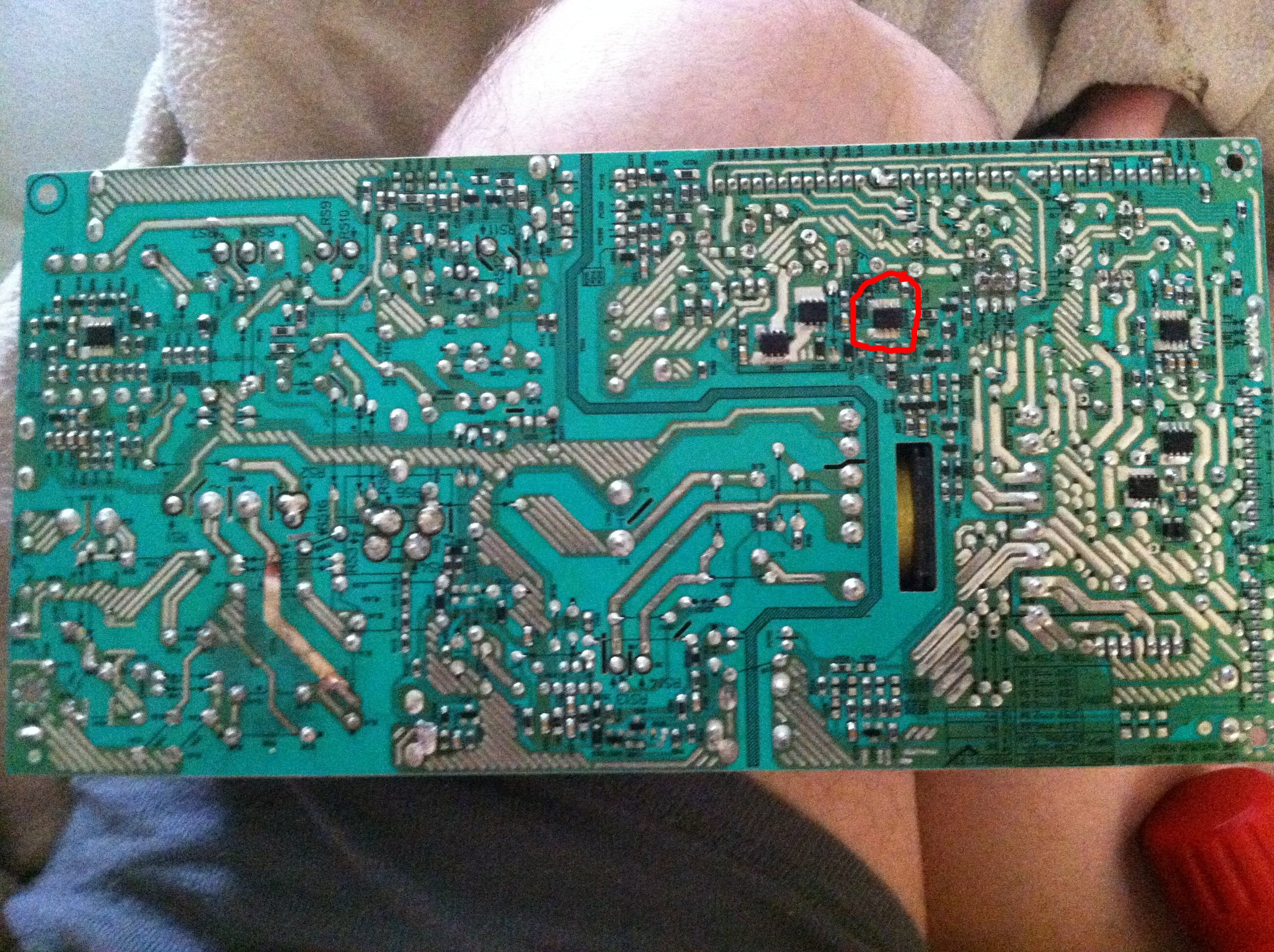

    lg 32lc2d no video
    Hello I have a lg 32lc2d tv no video replaced caps it worked
    A few minutes and no it's doing same thing I'm only getting 1.8
    Volts where it's should be 3.4 all other voltages are about
    A half volt lower then specs any help would be appreciated
    Thanks tony
    Re: lg 32lc2d no video
    This is a common problem on this model. I've never been able to confirm my suspicions (haven't had a second one to work on yet) but I believe it to be the 8 pin buck converter IC on the power board failing. You can replace it, I forget the part number but it is written on the device. Post a picture of your power board if you need help locating it.
      Here's pic of board thanks
              i think the ic tom is on about is on the underside of the board i had this issue on a lg as well .
                Thanks vinceroger69 here's bottom pic
                  It's probably this IC you should replace.
                  If replacing this fixes the issue PLEASE report this back so we know, this problem is so common and it has not yet been determined if this is the actual fix.
                    Tom66 I put a ic out of another board powered it on
                    And it's been working a hour now thanks for your help
                      Great! That is good info. What IC did you use? IRU3037?
                        Took one out of another board with bad circuits
                          Thanks for the info, finally a confirmed fix.
