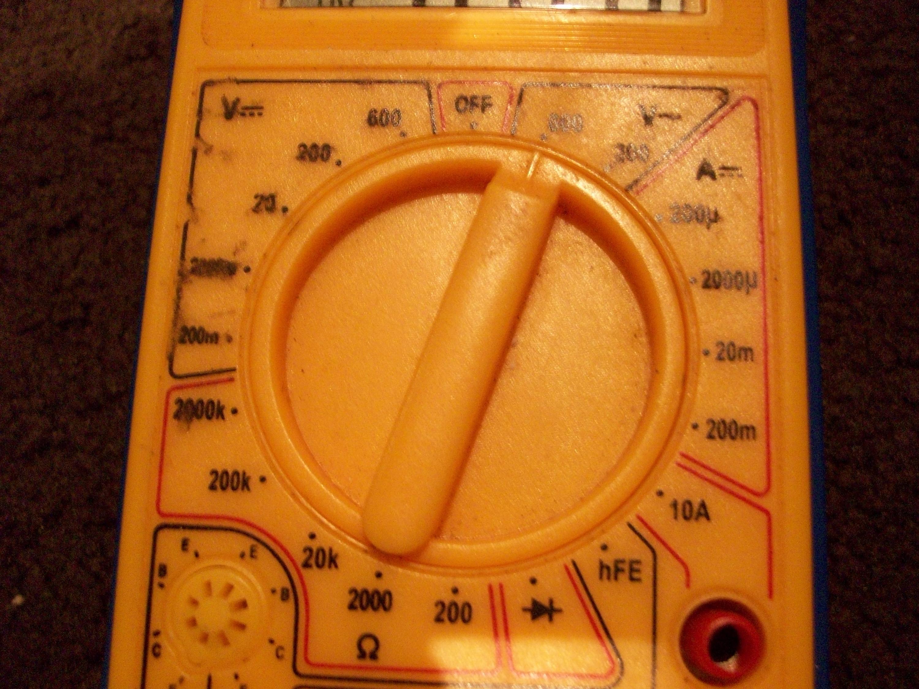

            i,m sure it reading 40v,,, i,ve sent a pic to see if i have the cheap meter reader on the right settings ,,

              Re: samsung ps42q96hd
              here you go
                That's Volts AC. You need to set it to Volts DC, the lefthand scale, and use the 200V range for Va. 40V is much too low.
                  does as you said set it on the 200v on dc , and the va is reading 100.5v way over 63v
                    Replace your multimeter battery with a fresh one. If Va still reads high, the plasma panel has likely been permanently damaged (driver IC massive failure), and this would not be repairable.

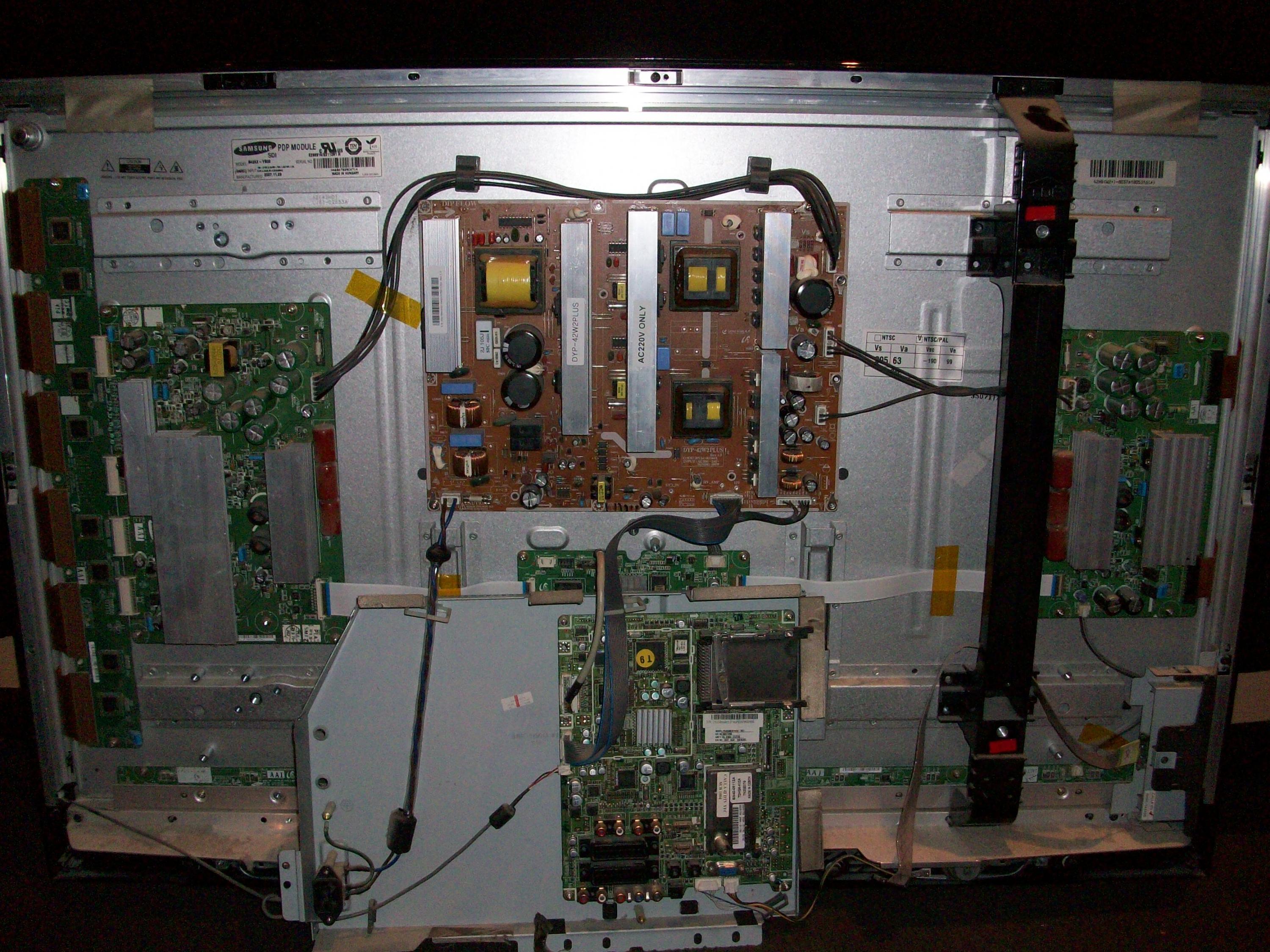

                                  OK, at this point I'll need a picture of the chassis of the set - one of all the boards. Clear and in focus, please.
                                  • pauluk00
                                    • Jul 2013
                                    • 29
                                    • united kingdom
                                    here you go ,, i,ve unpluged the the plug from the logic board to main av board to take the pic ,,
                                      Can you get one of all of the circuit boards in one shot?
                                        yes accept the logic board as that is behind the av board
