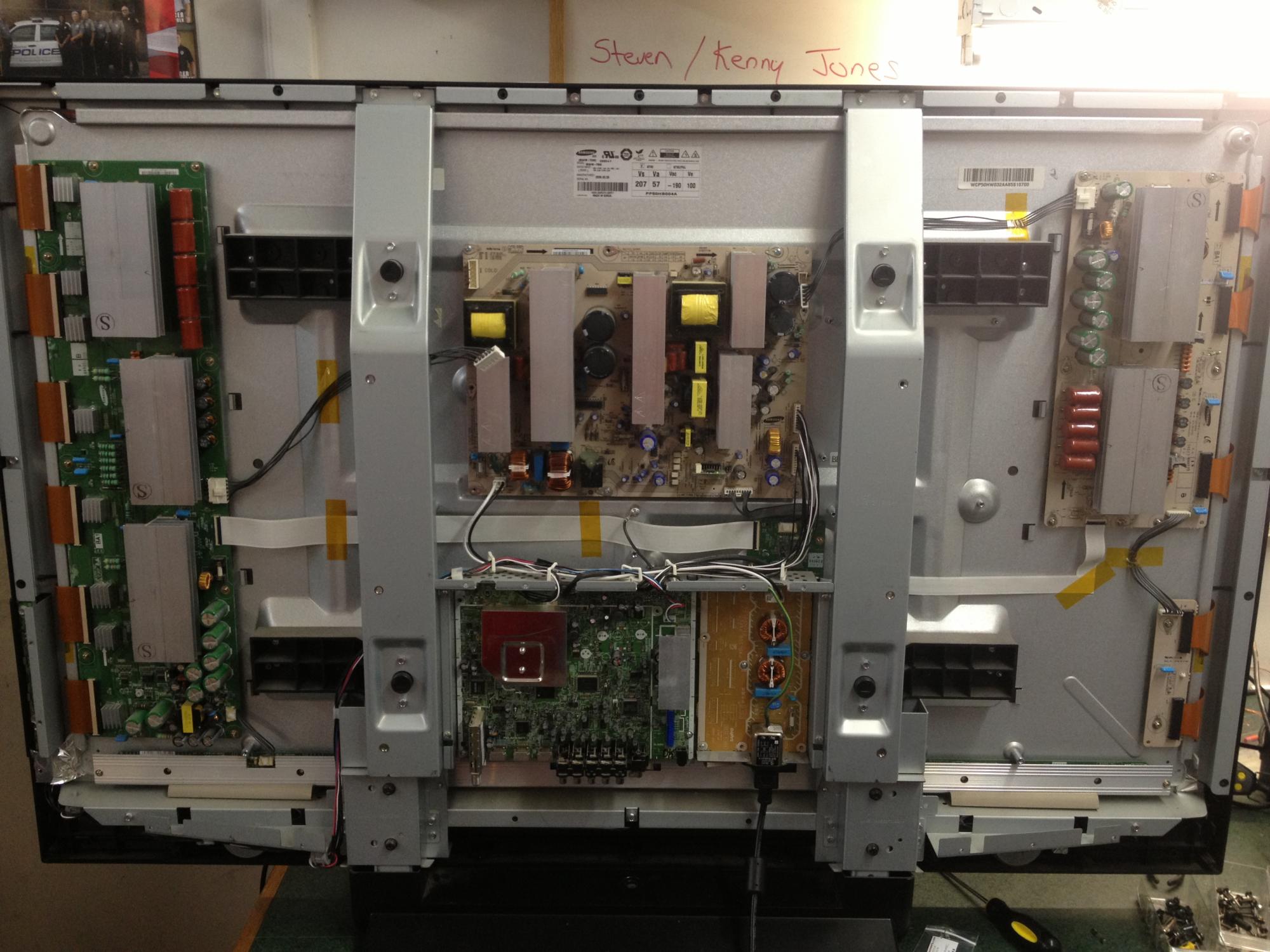

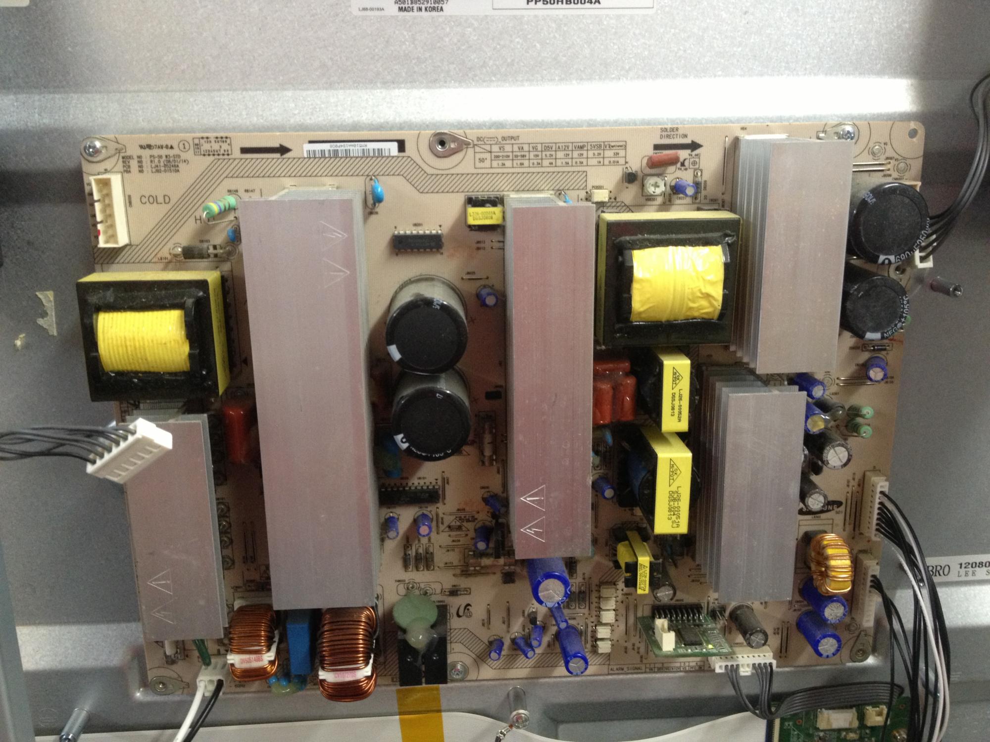

    TV was DEAD, no relays and no led, so I replaced LJ92-01510A Power Board.

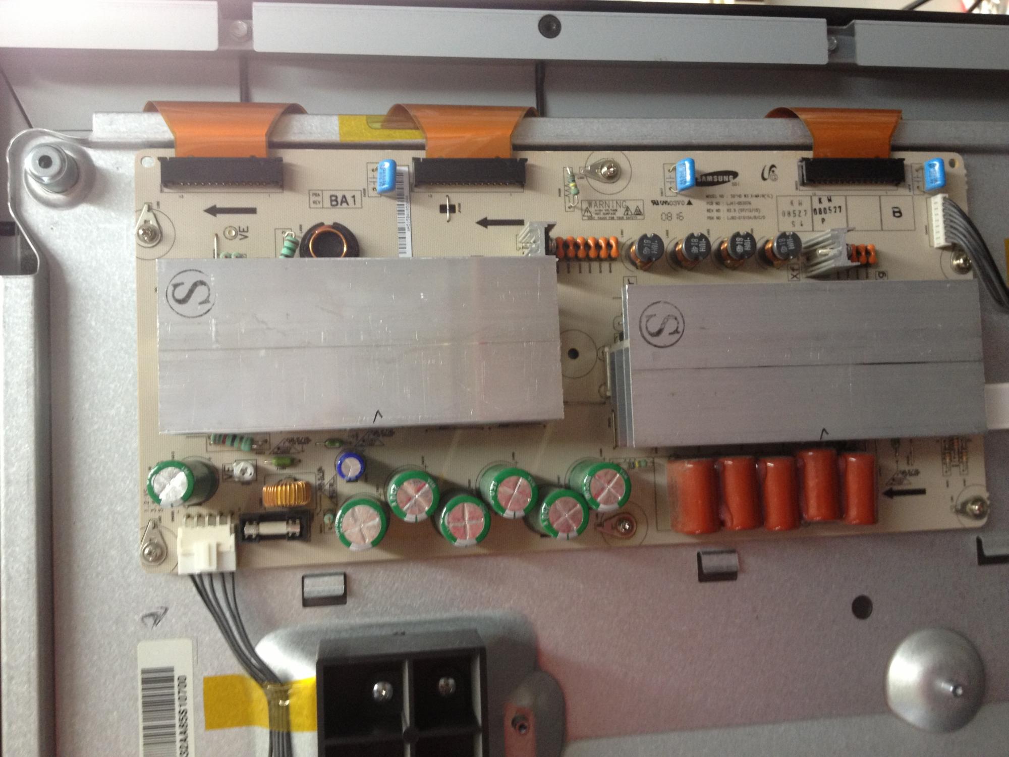

    Now, Relays click and LED comes on for 20 seconds then relays click and LED goes off. Same results with Y or X sus disconnected or with both disconnected. I have no voltage on Vs, Va, or Ve. I believe my replacement board maybe bad? What is everybody's thoughts.

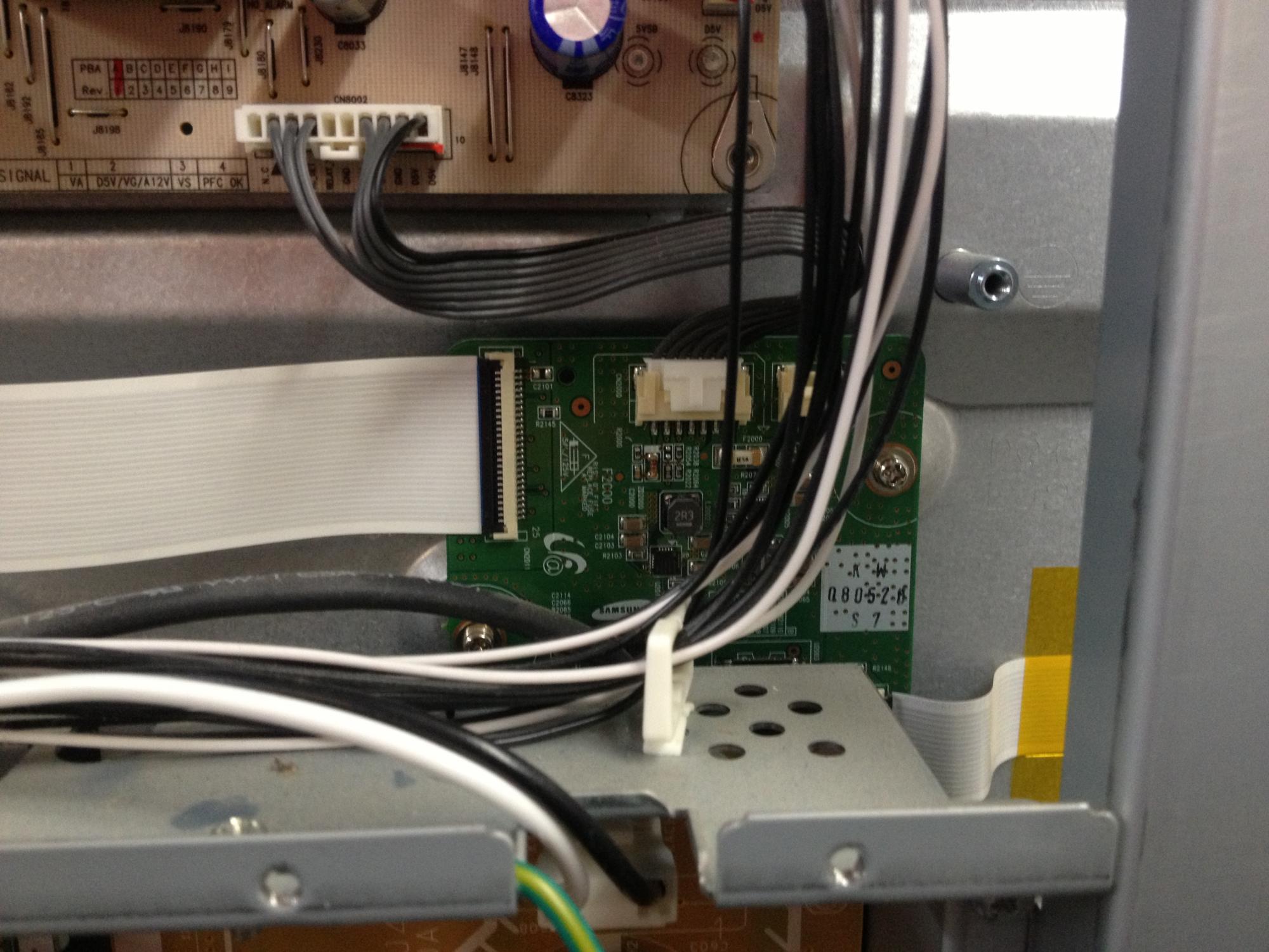

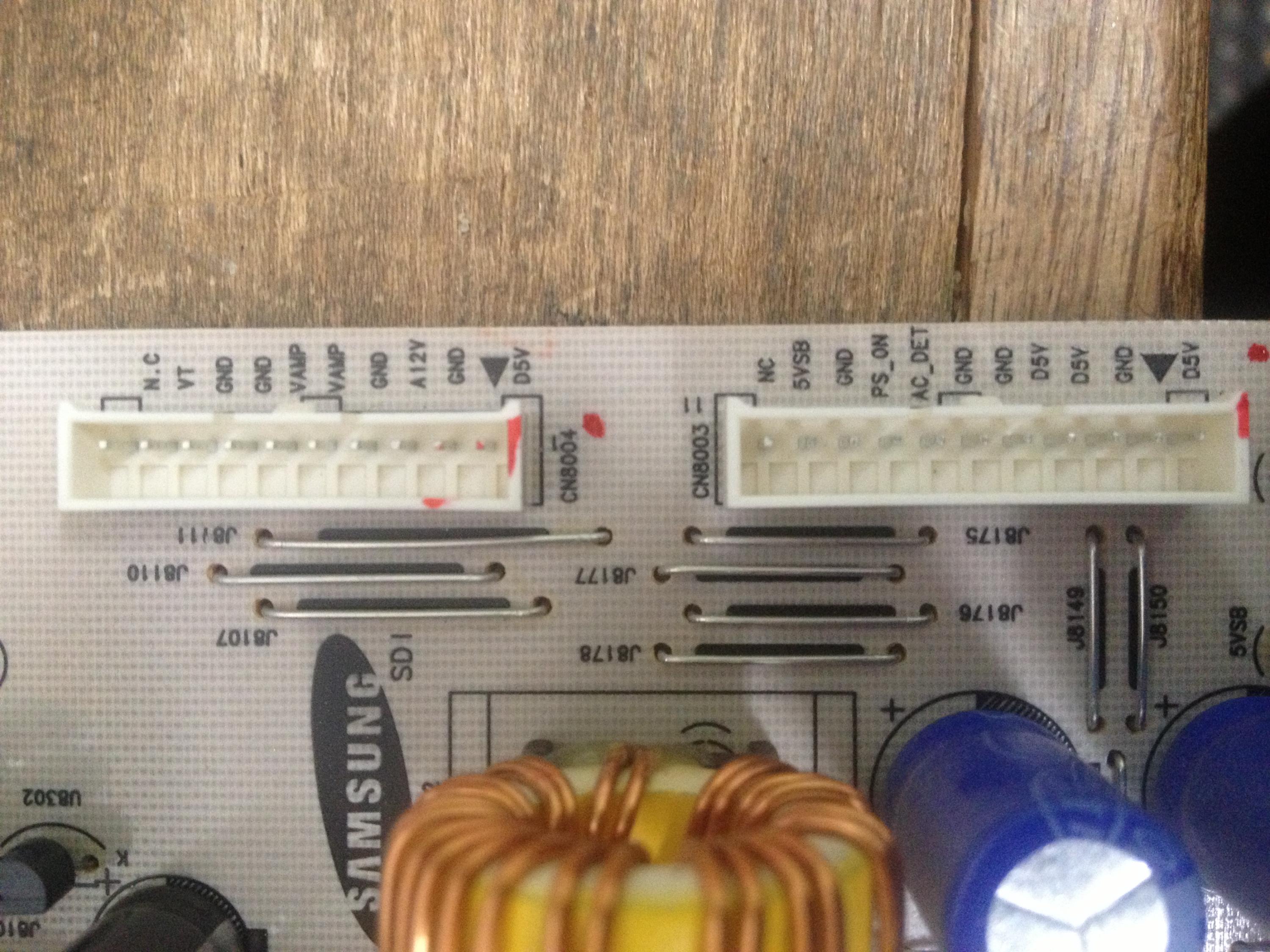

        OK. Are there any labels next to the connectors going from the power supply board to the main board? The main board is the board with the video connectors on it.
        • pc_doc_al
          • Jul 2012
          • 45
          Re: Samsung DP50747 Powers on then off
          Yes they are labeled. I have attached a picture of the connectors.

            OK, please check PS ON and AC DET while the set powers on and the relays click. All connectors/power board to be installed.
            • pc_doc_al
              • Jul 2012
              • 45
              PS ON 4.8v with power plugged in and 28.5 mV after relays click
              AC DET 5.2v with power plugged in and 5.2v after relays click.

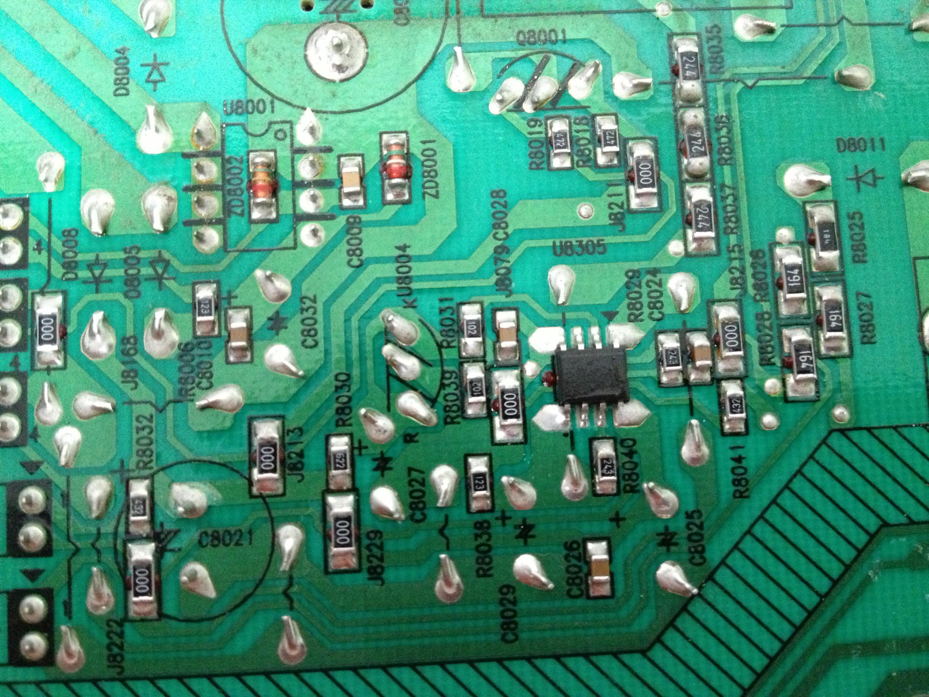

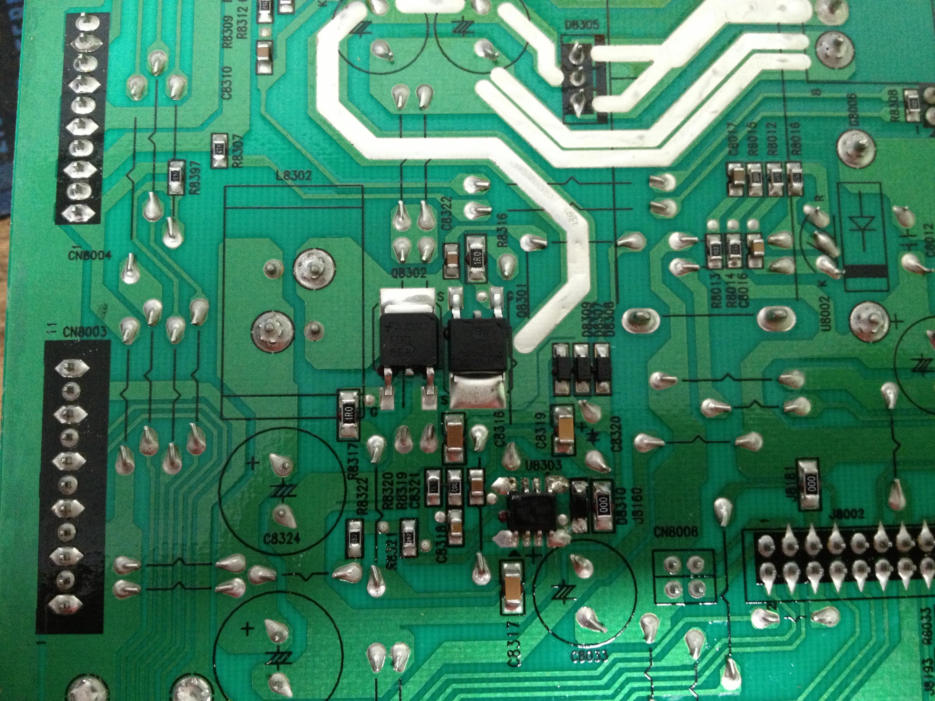

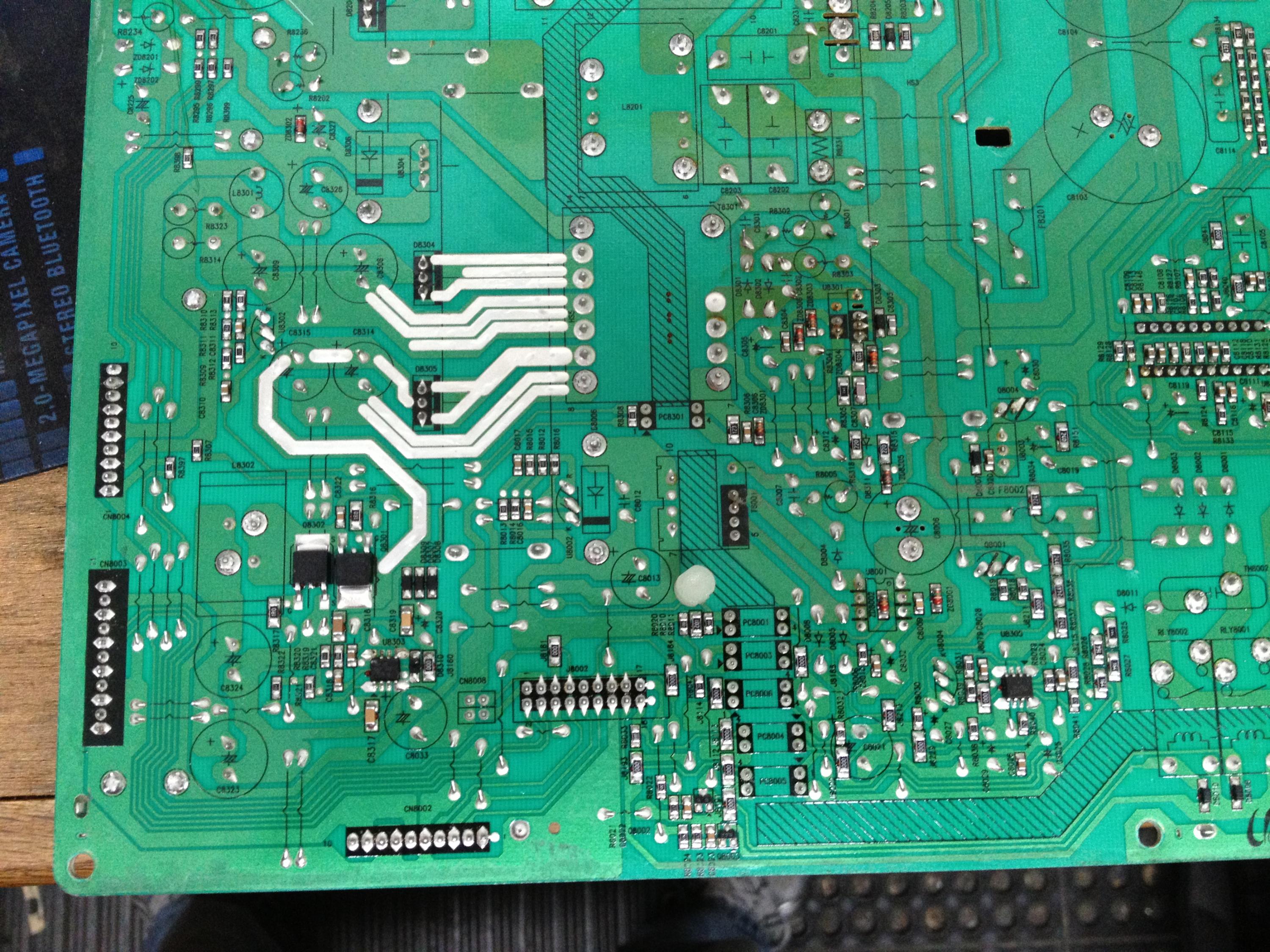

                              That's OK then. The power supply is receiving the signal to turn on, but it is not starting up the main supplies. Check the Vs/Va output for shorted diodes. Also, locate any multi-pin chips near the Vs/Va output on the primary side -- if you find any list their part numbers. Any BN44, BN9x, LJ9x etc numbers on the power supply?
                              • pc_doc_al
                                • Jul 2012
                                • 45
                                Here are the numbers I found.
                                LJ92-01510A
                                LJ41-05246A
                                I see the following:
                                FDD 8880
                                LM393
                                3037cs
                                I believe all the diodes are good.
                                  Any visible on the primary side?
