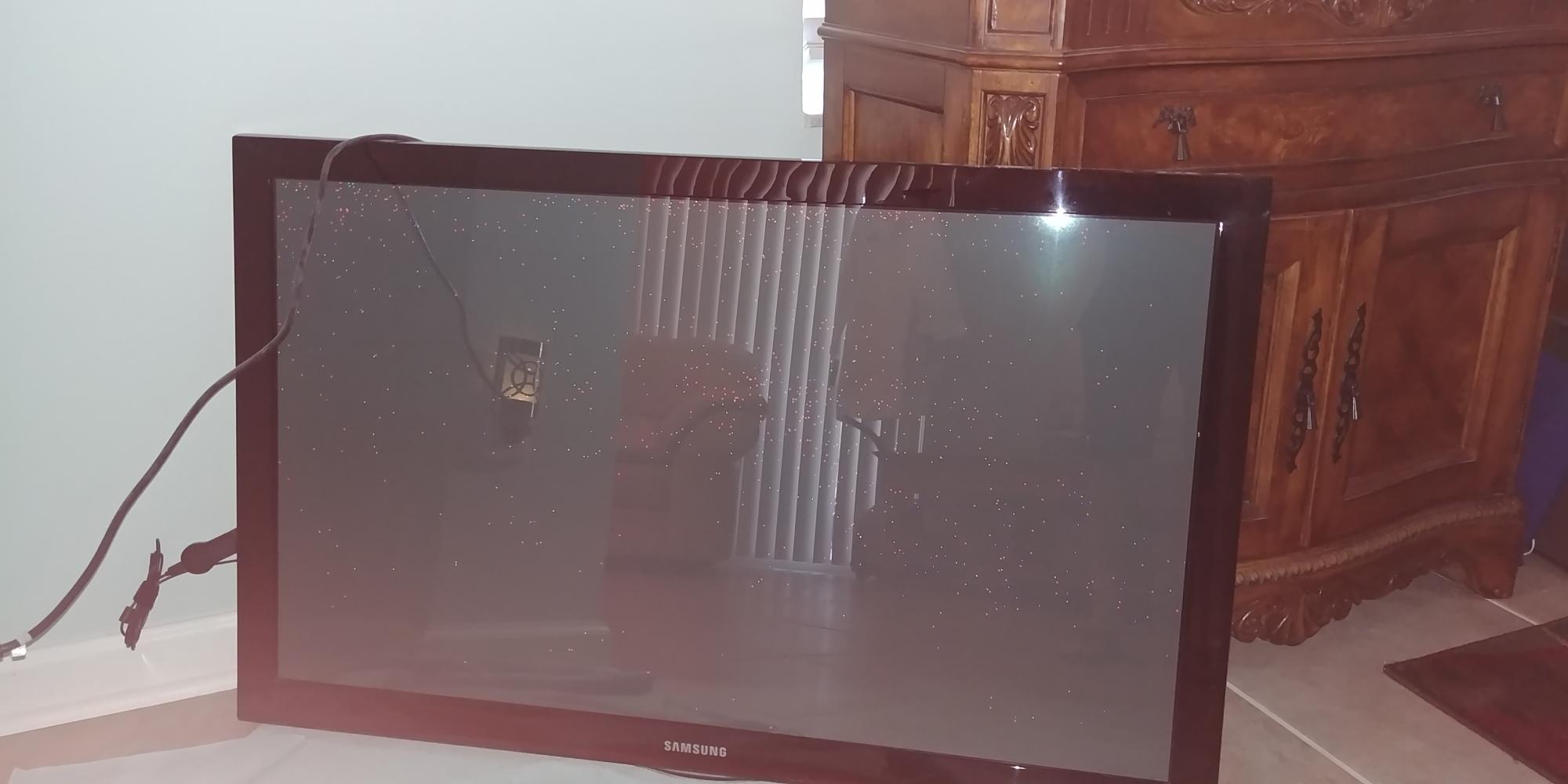

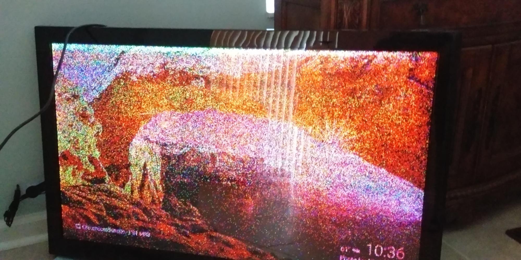

      Resurrecting an existing post (as I have the same model PN42C450BZ, but a slightly different issue). Recently the picture on our set has been having display issues (audio is not impacted). The TV will power on, and the picture looks great, then shortly thereafter (can be minutes, or an hour later), the picture is no longer viewable. Lots of Green/Red pixels. Based on reading through this post, and Tom's link/his quick guide for this model TV, I am still uncertain what to suspect (logic board, main board, or elsewhere). I have already replaced the TV with a newer model LCD/LED, but miss the pleasing picture of the Plasma, and if its not too troublesome/expensive would like to repair this TV.
      Attached are two images of the TV, the first picture (with the most coloration was displayed initially, and then shortly after the second image was present, mainly black with some red/green pixels).
      I welcome any suggestions. Thank you in advance.

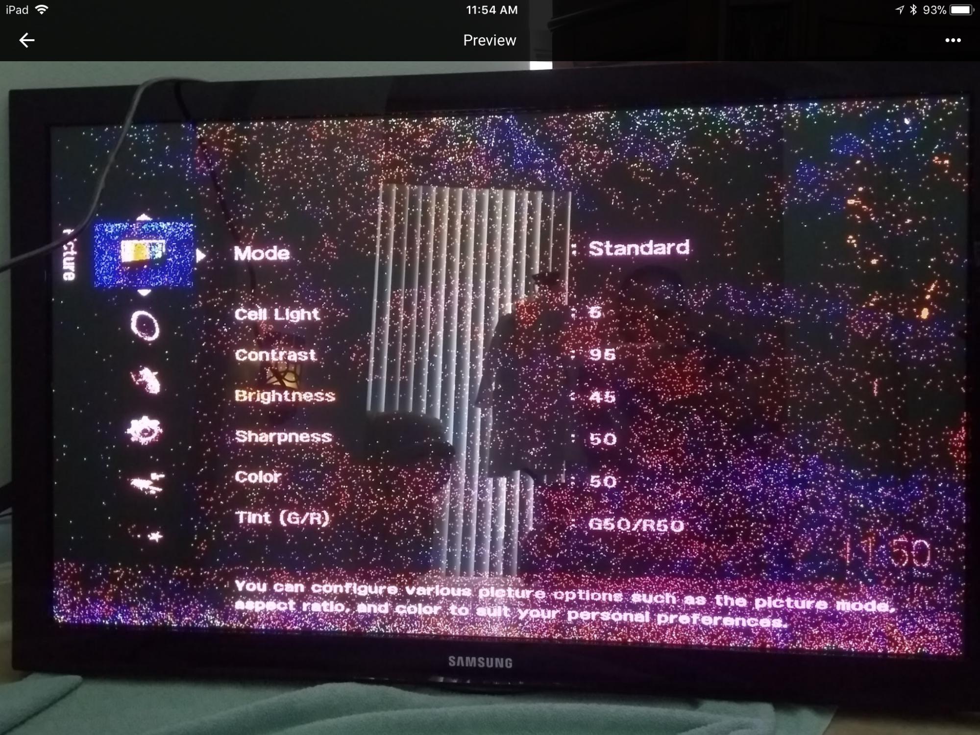

        I forgot to test/share what occurs when I pull up a menu... The TV actually looked great for a moment or two, then the menu was pixelated, eventually unviewable. Sample image attached. (This is with an input displaying content).

          Re: Samsung 42" Plasma PN42C450B1D
          Can you heat/cool area's of the circuit boards to identify which board and what area on that board causes the pixelation.
              Heat up an area of the circuit board with a hair dryer but don't overcook it and see if the fault manifest itself quicker. Basically you are searching for an area of circuit board which heated brings up the fault quicker. Then using freezer spray to cool down the area (or a can of air duster sprayed upside down) to see if the fault disappears.
              Repeat until you narrow down the area and then component(s).
