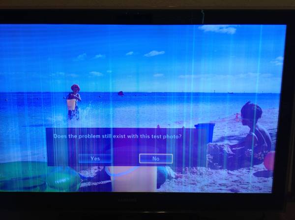

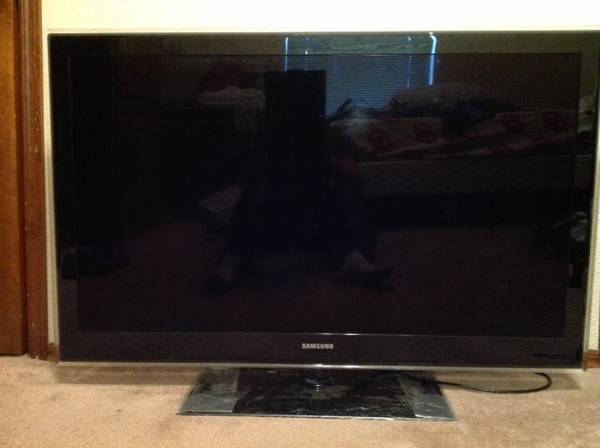

    I'm looking at buying the above model TV. Pictures of the TV from the sellers ad are attached.
    I'm thinking main board, any ideas from the more experienced techs here?
    Thanks.
    Re: Samsung UN46B7100WF LED Possibly to buy
    Defective panel; seen it before.
        We have the same model, same problem. Is it worth replacing the panel? Is it considered the T-con panel.
        • mmartell
          • Oct 2013
          • 3189
          No sir. The panel is the actual display, or screen if you will. The t-con is a board inside the tv which drives the screen.
          When the screen is bad there is no recourse but to part the set out as replacing that part is likely more than purchasing another television.
