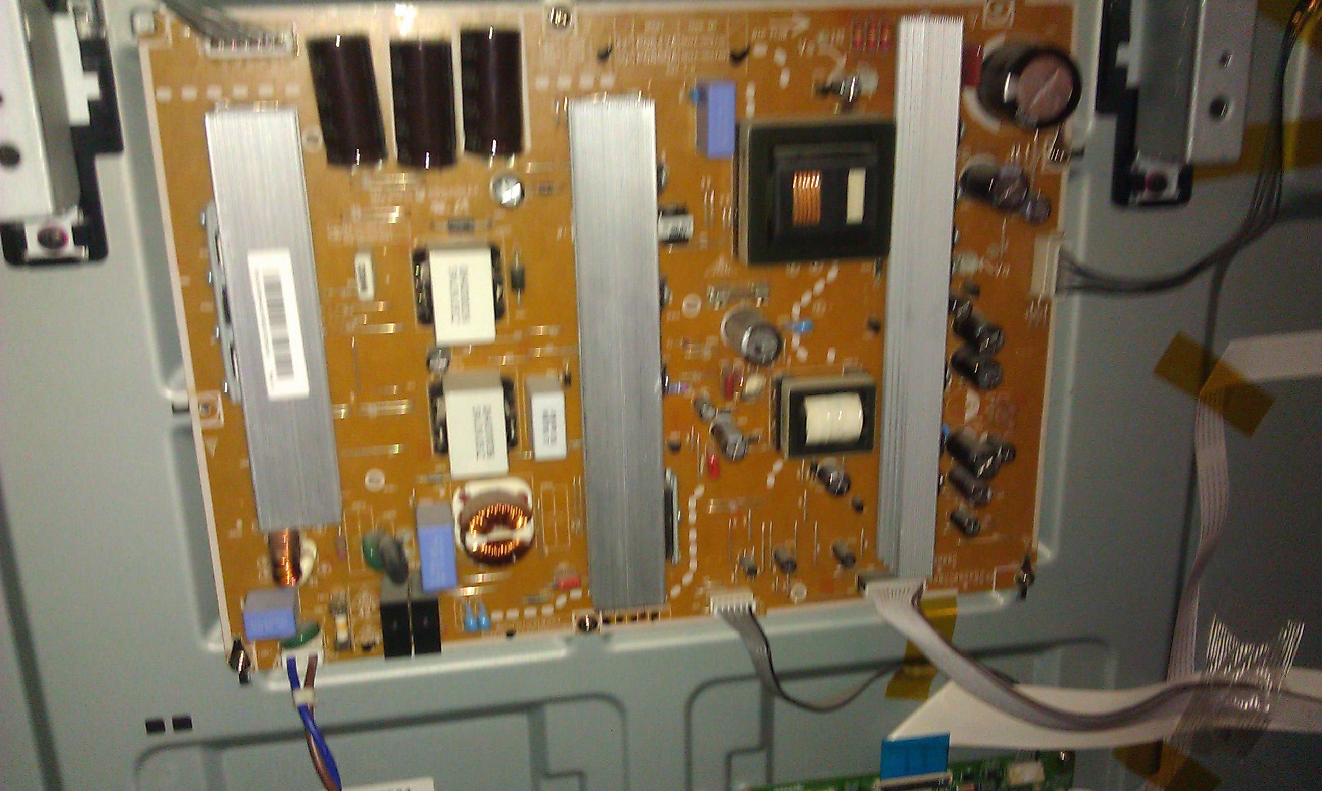

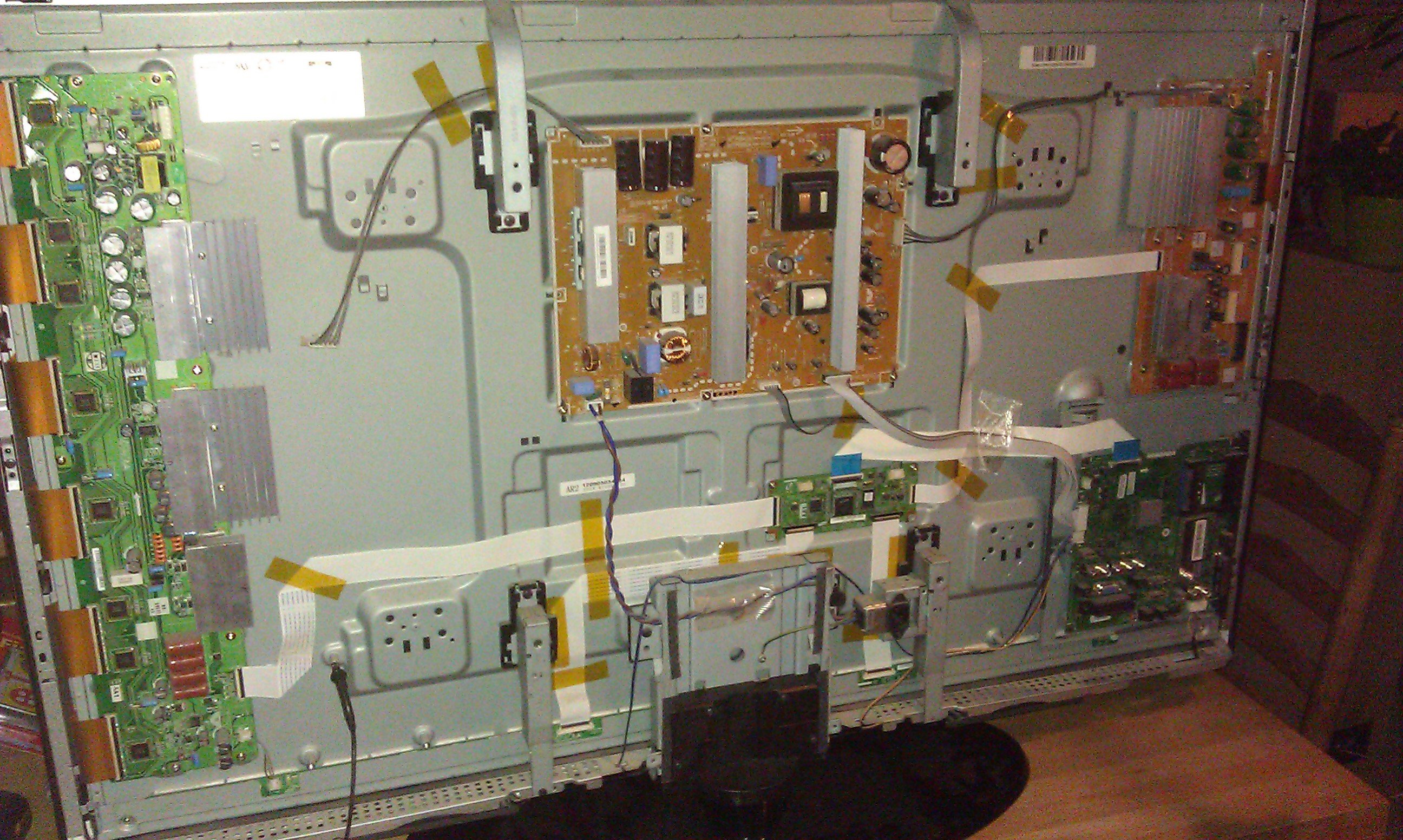

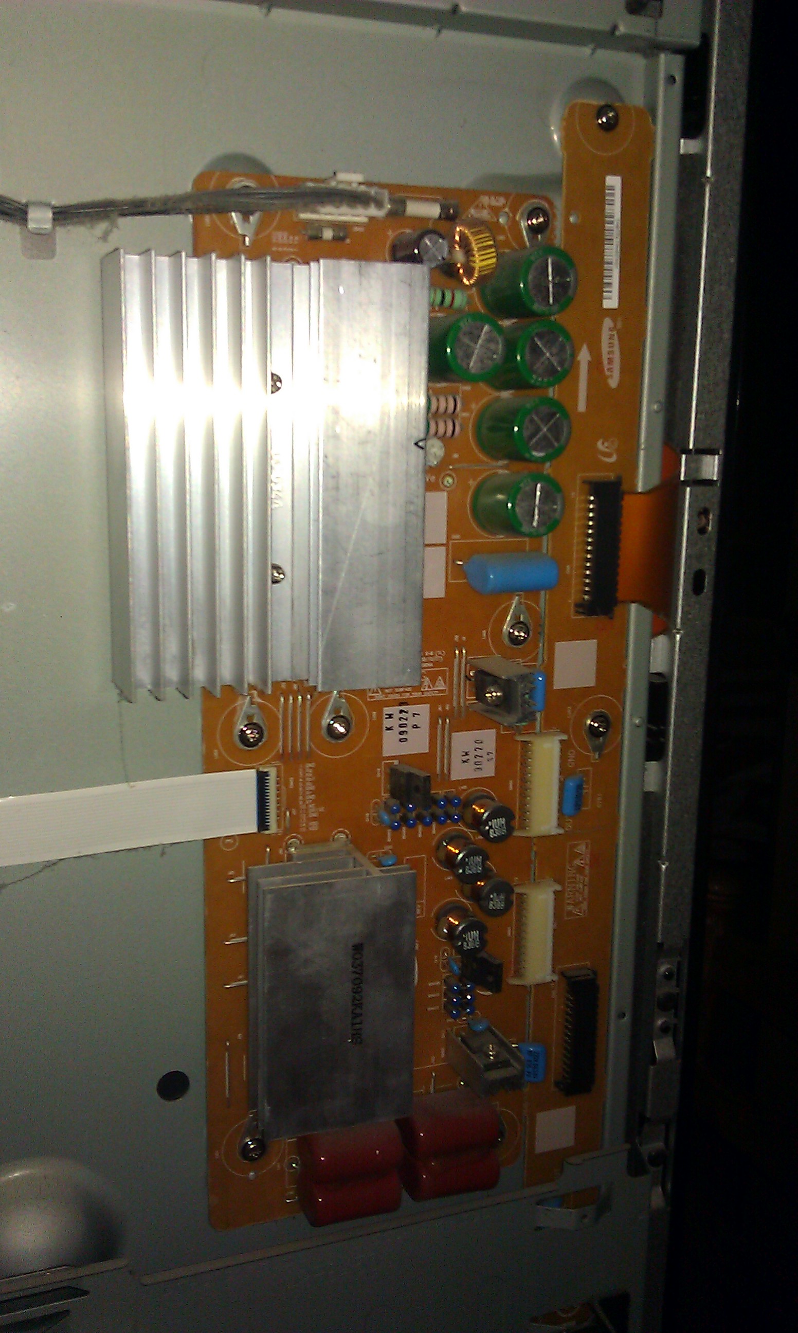

        Re: Samsung PS50B455B1WXXE Plasma died
        Pics of boards and chassis?

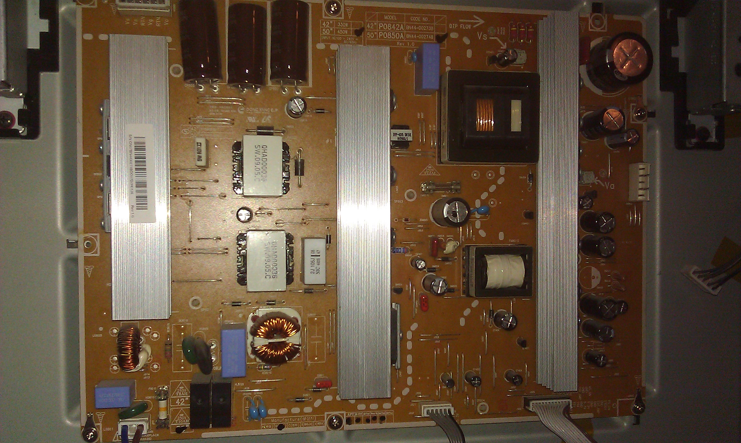

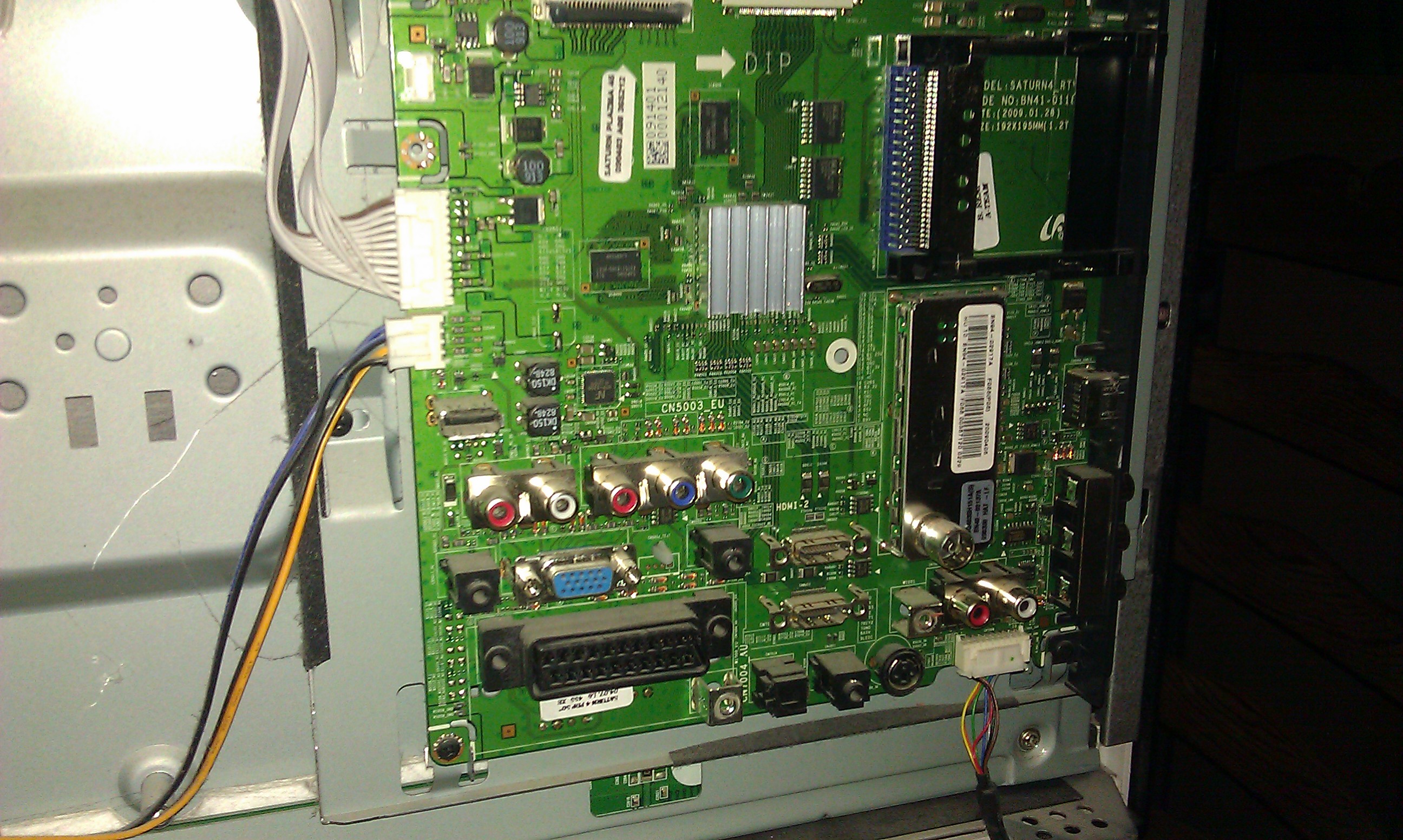

            Pic of the psu is very out of focus, can you reshoot it
            • noki
              Genius wanabe
              • Jul 2011
              • 10
              • Sweden
              Here we go

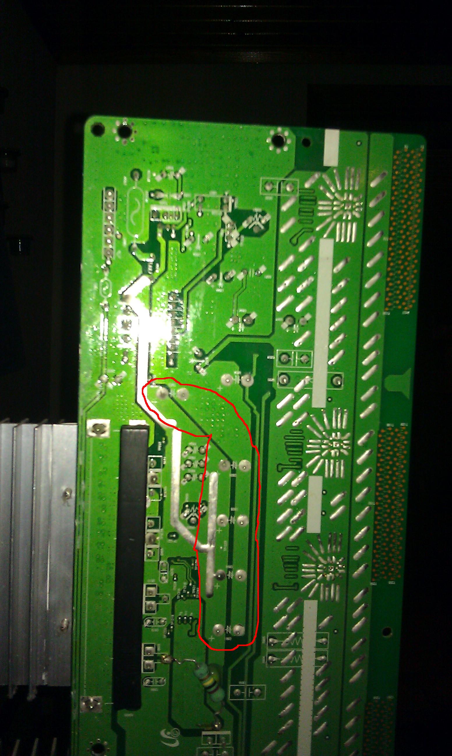

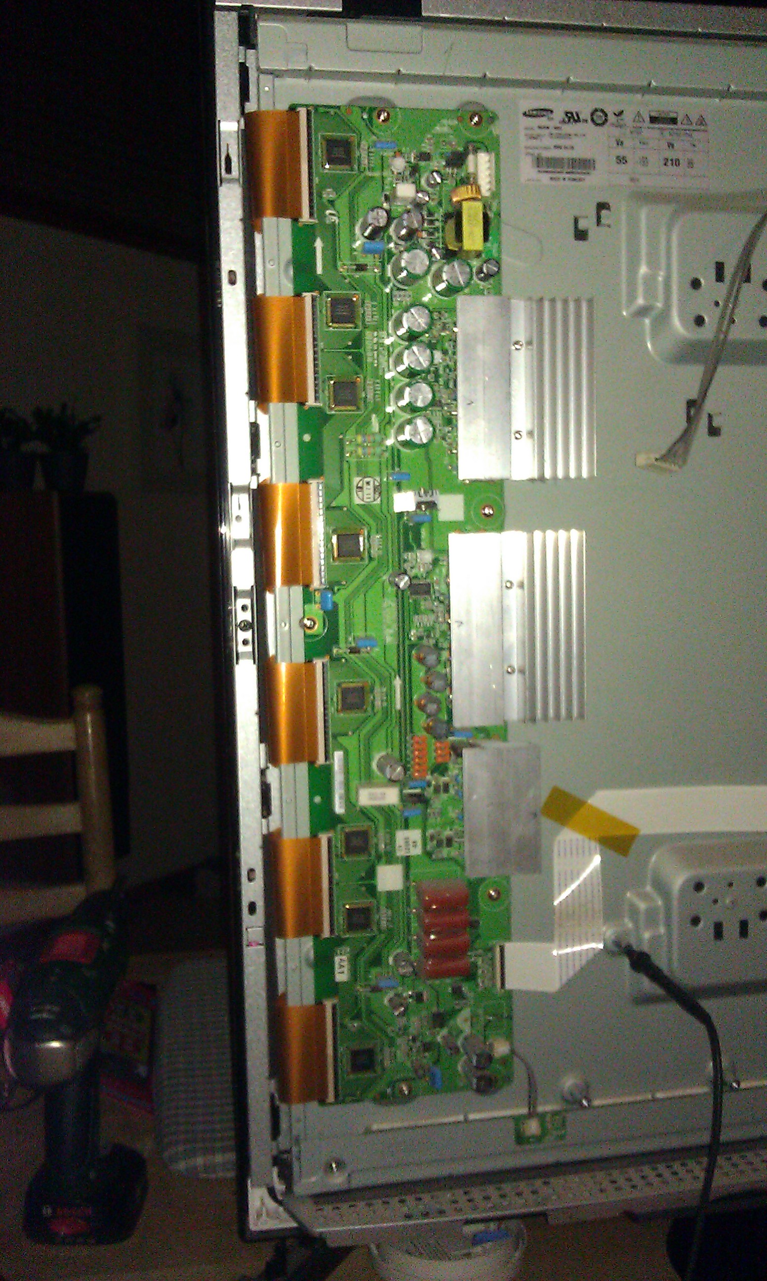

                I have removed the y-m board and ohm measured around the vs path, its mainly 5 capacitors and when i measure over them i get 0 ohms, should i remove them and measure them individualy?

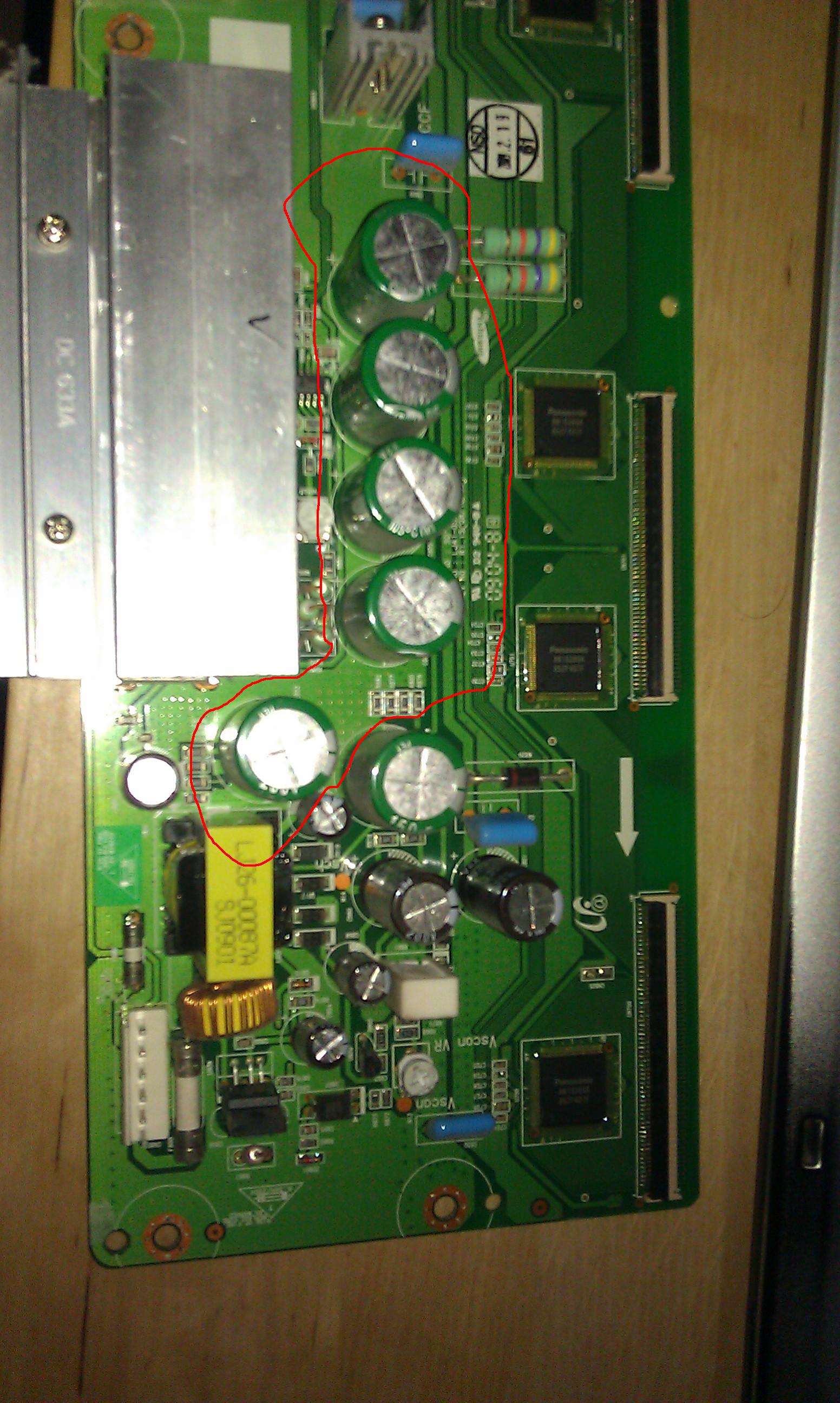

                        Could it be the caps (no visual problems) on the ymain, marked on pic.
                        Have had problems with unstable brightnes for a few months...
                          No, likely a shorted FET somewhere. Bad firmware on the control board puts more stress on sustain boards, which can lead to premature failure. After you replace or repair the Y-main you MUST apply the firmware update to prevent future failures.
