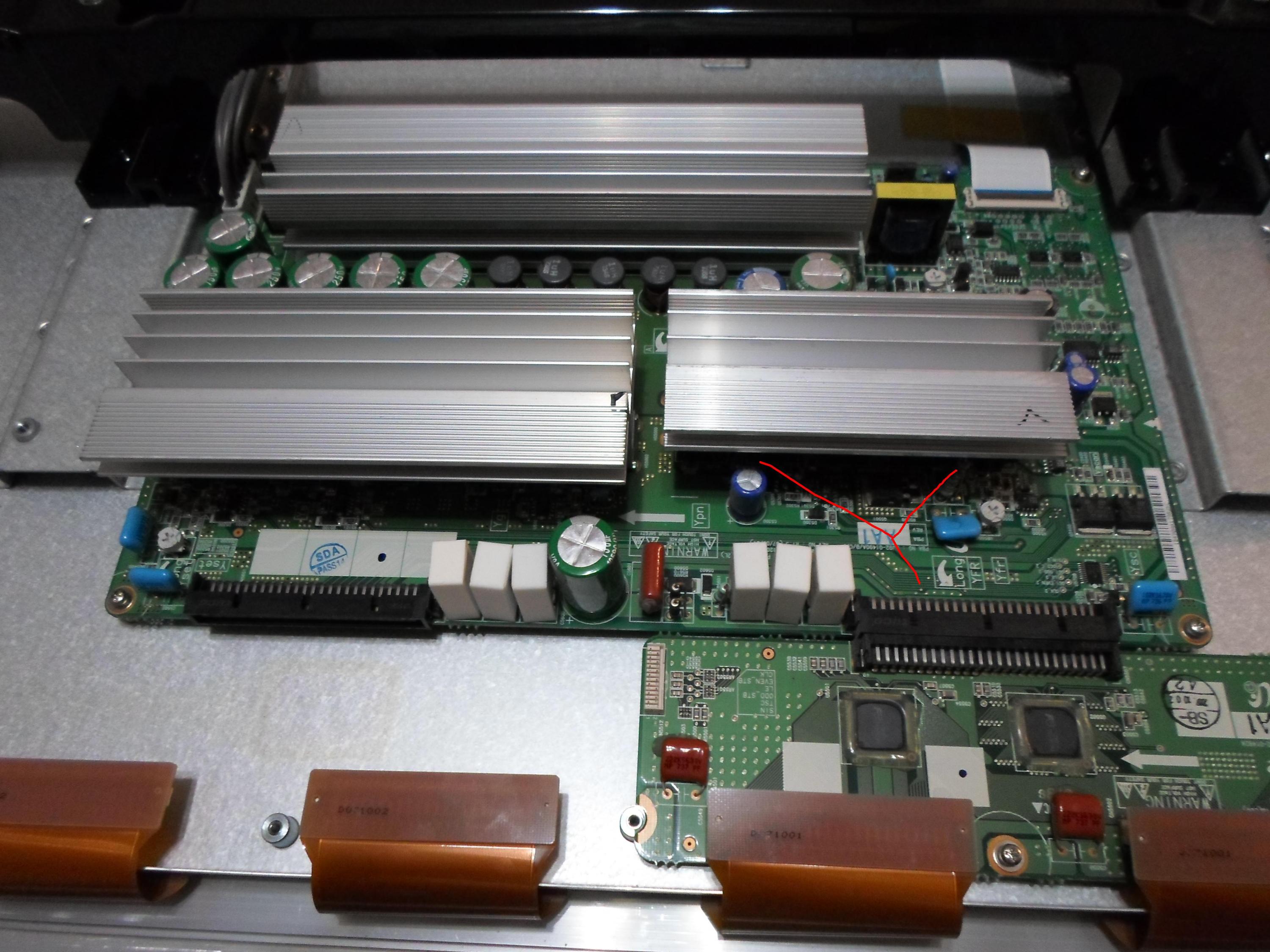

    Samsung HP-T5054 Plasma Y-Sus/Buffer
    No video or glow but has audio.

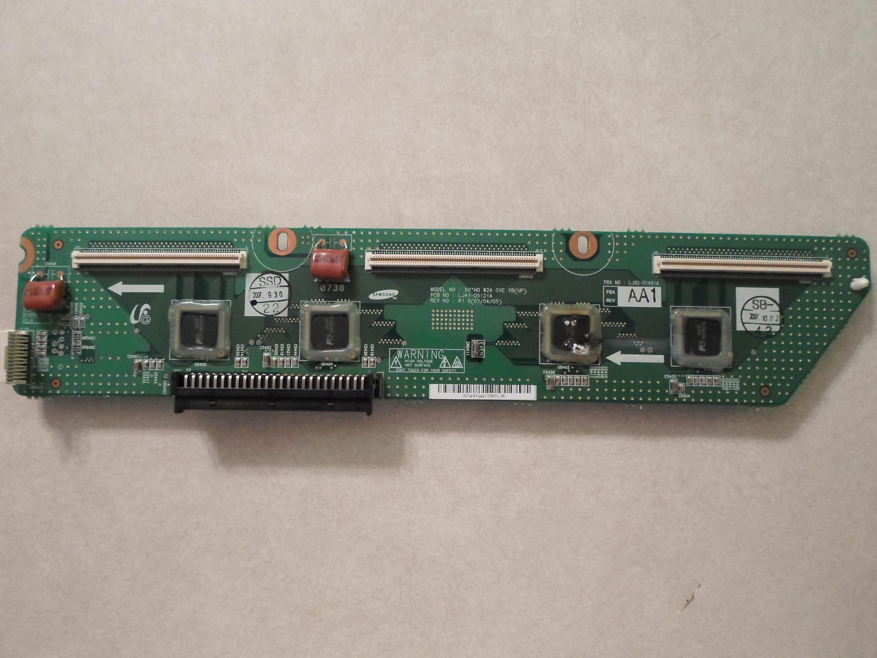

    This one upon opening has a blown IC on upper buffer board, and has 4 FETs on Y-SUS with short from drain to source (Q5302, 5303, 5304, 5306 (88N30W)).
    Will replacing these and the upper buffer board likely repair this?
    I see these buffers are expensive but IC's are cheap, anyone have any luck replacing the IC?

    I just did one about a month ago. It's a pretty delicate procedure to replace the ICs. Also, on occasion, the ICs can blow violently and fry buffer traces, rendering the board useless. The main problem with these Samsungs is that they don't have fans. I don't touch them anymore, unless I get one for free
    One other thing: Be careful where you buy your chips. There are a lot of fakes or recycled chips sold as genuine new.
    Edit: Replace all the FETs on that heat sink, and you may have to replace the B20NK50Z FET, also. Sometimes, other components nearby fail.

      I got lucky, the last one of these models I got was just a bloated cap and fuse on the Y-SUS. So I jumped on this one but now I have a project..
      How many pins on that IC, I have done 100 pins successfully so far..
      BTW on the bottom of the board there are 16 holes under the IC, on the one that is bad there is a ball of solder coming out of one hole.

        I think there are 32 pins per side, but the pitch is fairly fine. Aligning the chip can be challenging, and it's best done under some sort of magnifier with a pick or nudge tool. I normally use a well tip and drag solder the pins - works great.
        Edit: Yes, one of the challenging parts of doing this is removing the IC without tearing the traces. A hot air station is a must. I also use a couple layers of kapton tape to protect the nearby caps and connectors.

                    There's solder under the center portion of the IC that makes it hard to detach the chip. Patience is EXTREMELY important. I usually concentrate on apply heat to the center of the chip, which also tends to liquefy the solder under the legs. I like to CAREFULLY get under a corner of the chip with a pick tool and gradually allow the chip to work itself free. If you nudge too hard, you will tear traces. I don't like to use ChipQuik.
                    I wouldn't mess with not having all chips working. These TVs can be pretty temperamental.

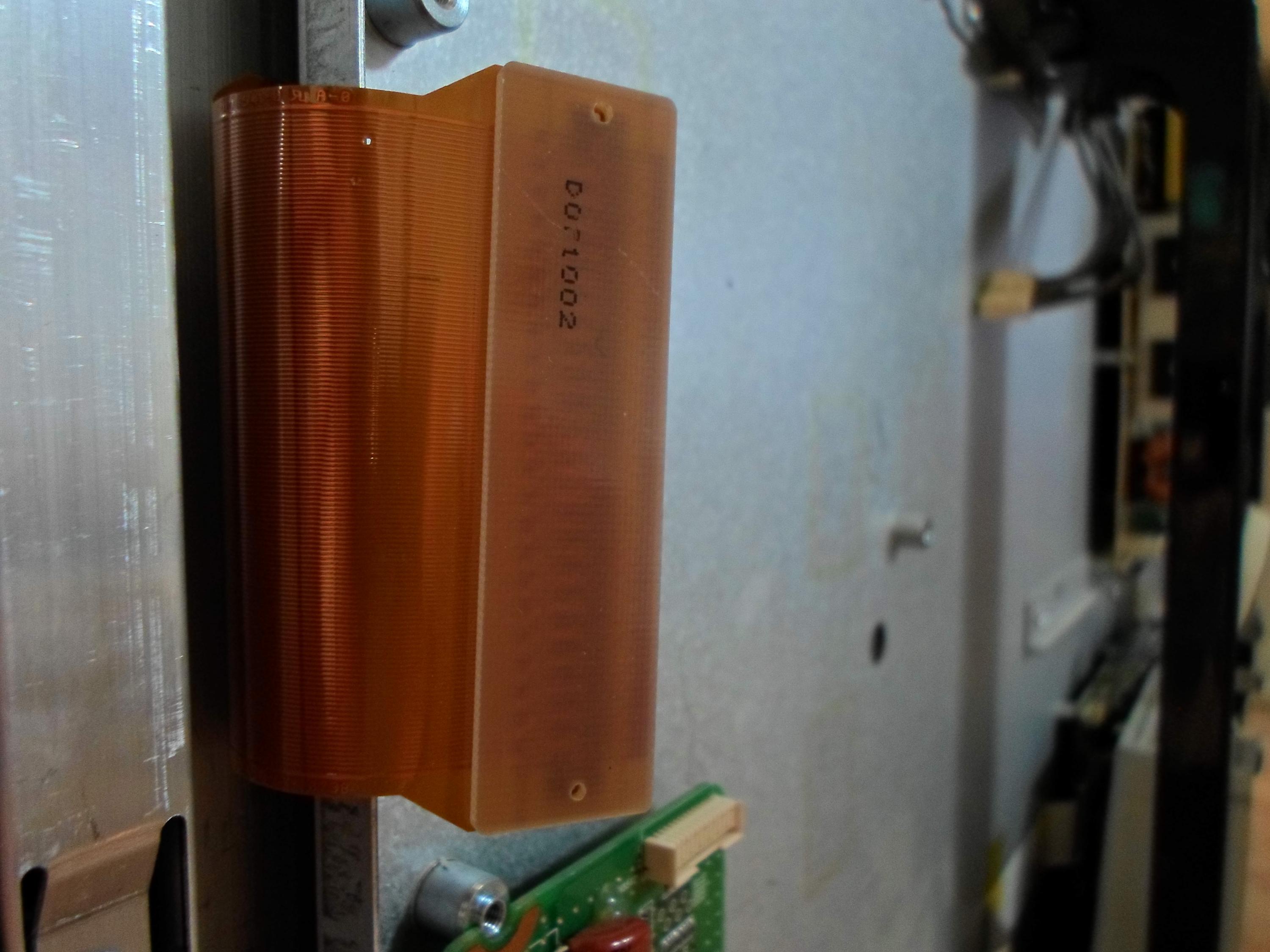

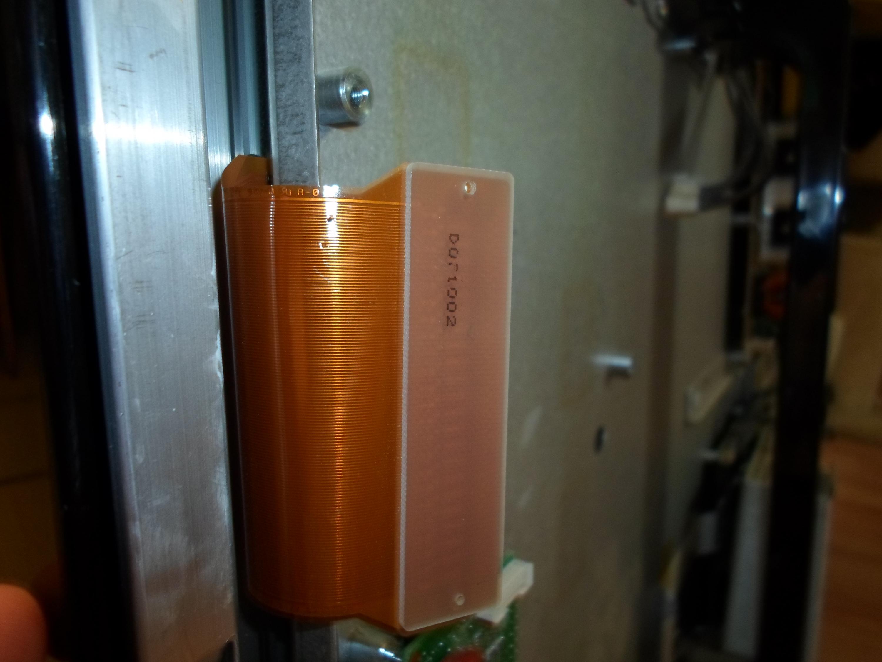

                                      I screwed up here, I was working on Y-Sus and I shoulda moved the damn TV off the table and I noticed afterwards what happened.
                                      Is this panel junk now?? Im afraid to plug in this connector for fear of damaging the new buffer board I have to install.
                                      Will TV work without this one ribbon connected just to test?
                                        Re: Samsung HP-T5054 Plasma Y-Sus/Buffer
                                        It'll work, you'll probably have a horizontal line if you can't fix that.
