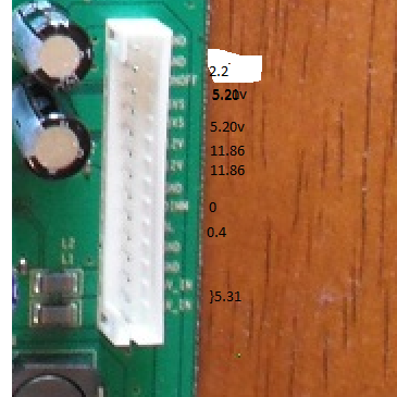

    recapped main, worked till i turned it off. turned it back on to blank screen ! could only turn off by unplugging it! now it will not come out of standby! got another psu gonna try in it in a bit! see what it does!

    put in other psu and same thing! just stuck in standby! so something on main not right! as said just replaced all the caps! yup they good, got them from TC.
    is there a start up cap on the main?
      Re: hisense ltdn46v68us service manual
      Check voltages from PSU & PS-ON.
        the board pin out ya cant see is
        gnd
        gnd
        on/off
        5v
        5v
        12v
        12v
        grn
        dimm
        bl
        gnd
        gnd
        5vin
        5vin
        the on/off looks low, should it not be 3+?
          ON/OFF is probably PSON on this set. Test all voltages along the pins.
            i did, the pic has what was on board. or are you referring to some other row of pins?
              psu - main = actual
              gnd - gnd
              gnd - gnd
              stb - on/off = 2.2
              5v - 5v = 5.2
              5v - 5v = 5.2
              12v - 12v= 11.86
              12v - 12v= 11.86
              gnd - gnd
              br1 - dimm =0
              sw - bl = 0.4
              gnd - gnd
              gnd - gnd
              5vm - 5vin
              5vm - 5vin
                Didn't see them in photo initially. Looks like PSU is good main board is bad.
