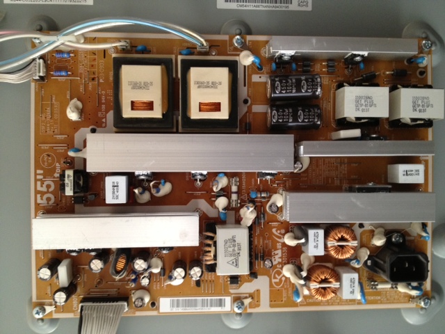

    Pictures of the power board will help us help you. There is a common issue with a diode failing short on the power supplies for these TVs causing no backlight.

        If you get me a picture I'll show you where to disconnect.

          PIC Attached
            Re: No Video on my Samsung 55"
            Bottom left. Just unplug it, then plug the TV power in.

              So just to be clear; unplug the "bottom left cable" plug TV back in then turn it on to see if the panel light up? I will try when I get home and report back tomorrow.
              THANX
                Plug TV in. You won't be able to get it to turn on (with no mainboard power) but the backlight should light up.

                  Well no luck with those steps. I unplugged the "bottom left" cable that cable went to the video board (no back light lighting up). I tried unplugging the cable to the backlight inverter board just to try something else and nothing. I still have the same symptom.

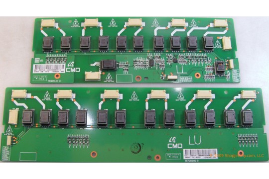

                          There is no "inverter" board on this set -- there is a long thin green board, a balance board, is that what you replaced? If so, can you post a picture of it?
                          • MG36
                            • May 2013
                            • 18
                            Attached is what I replaced twice with no luck.
                              Oh, OK. Those are balancer boards.

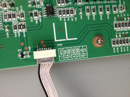

                              Can you get a closer photo of this connector?

                                Funny the Shop Jimmy folks have been calling these the back light inverter boards.

                                  Can you measure the pin voltages on "FB"? The two gold pads directly above can be used. Set your meter on DC volts, 20V scale. Reading >2V is suspect.

                                    I will take the measurement tonight and post. I did take the VCC and it was 12.45V (stand by V I believe). Also, there is FB1 and FB2 do they both require >2V?
                                      Sorry, yes, please check FB1 and FB2.

                                        FB1 and FB2 = 0V
