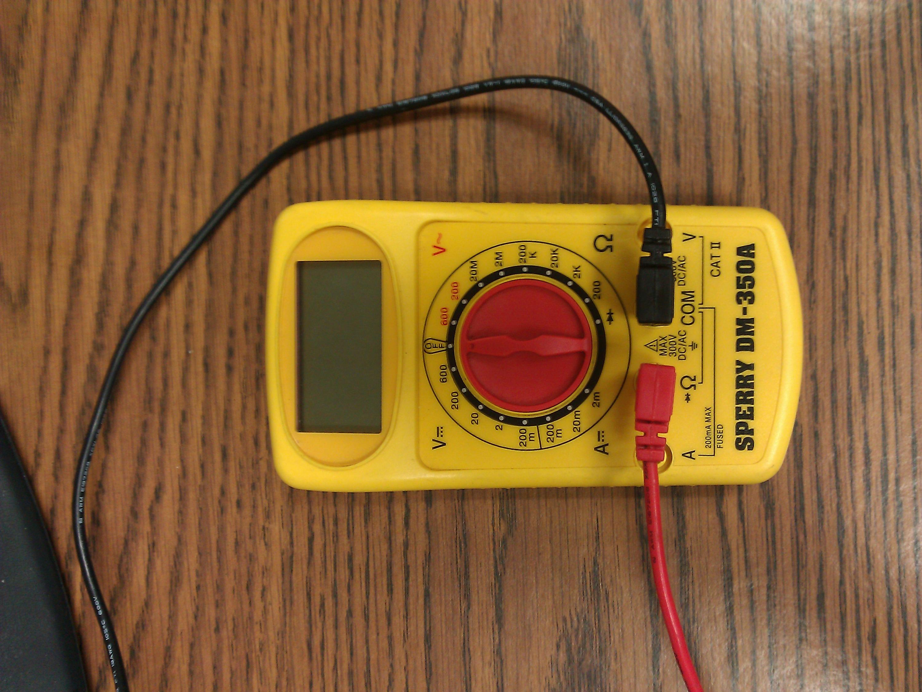

            Re: Samsung UN55D6450UF - Lightning Damaged
            Do you have a digital multimeter?
              I do, but it's an inexpensive one.
                I've used inexpensive ones before... Show us a picture. It can't be that bad...
                  There you go!
                    Nothing wrong with that.
                    For the tests put the RED probe in the "V" jack. Leave the BLACK probe in the COM jack.

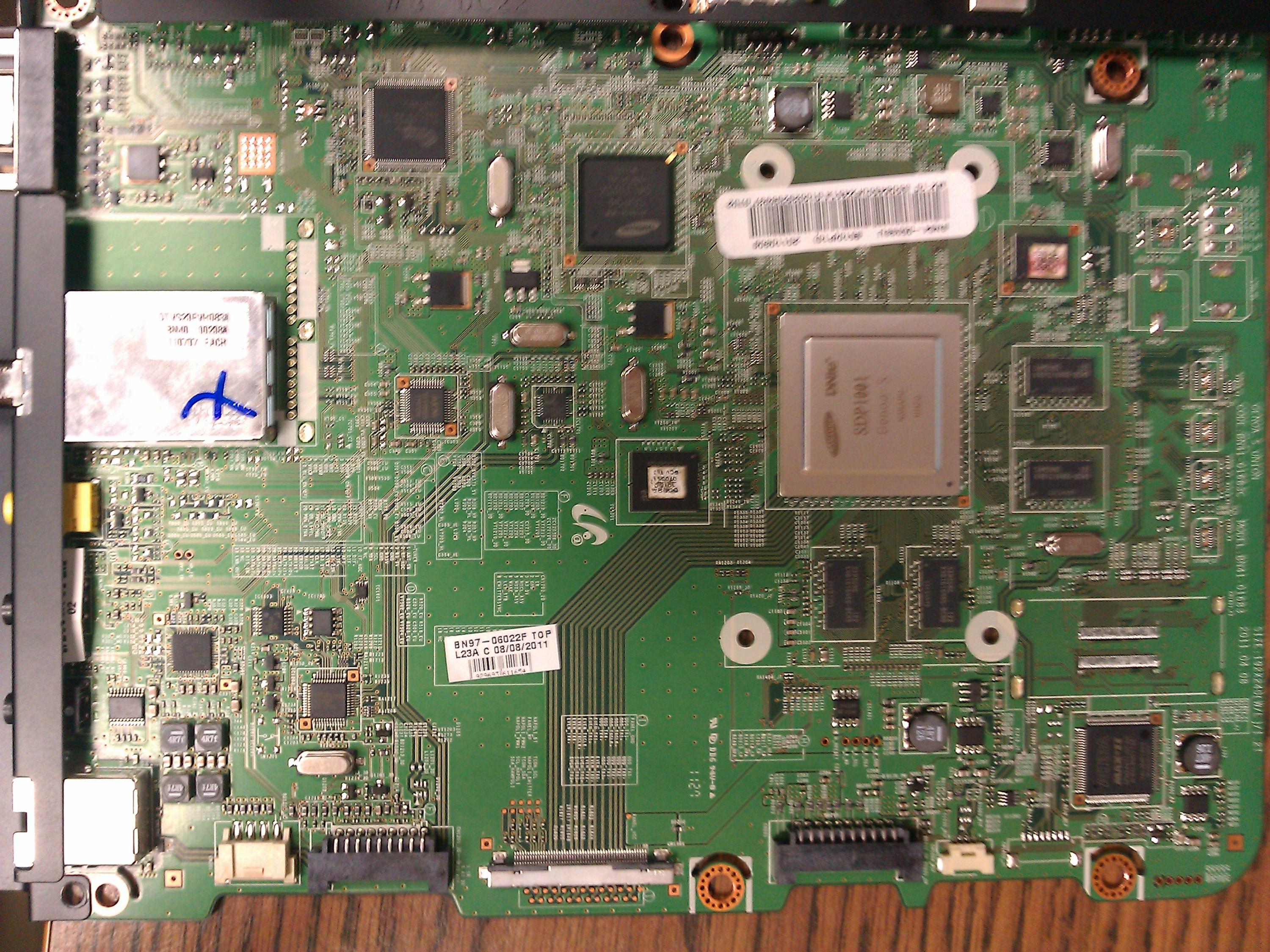

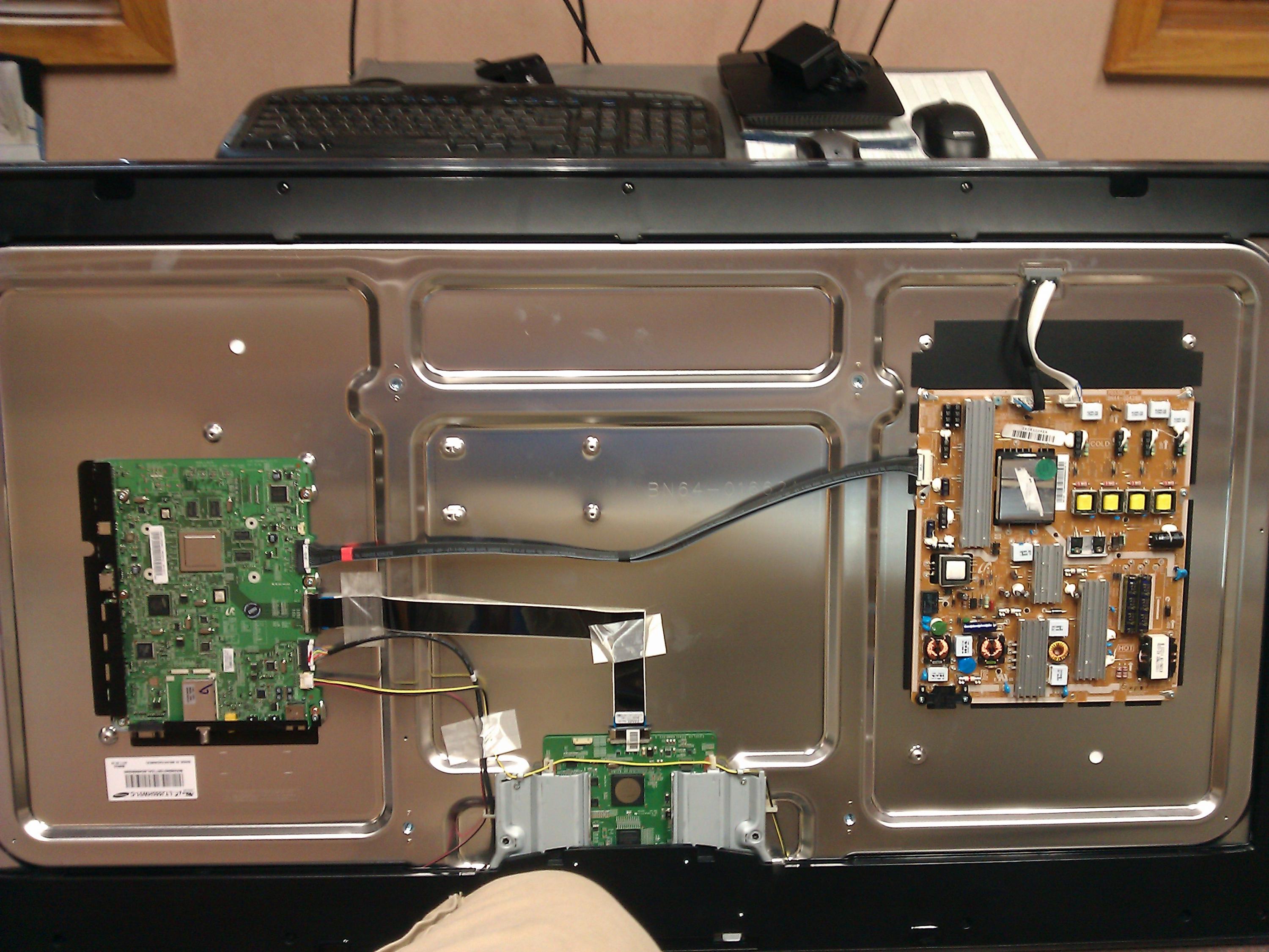

                      This is the whole backside of the TV

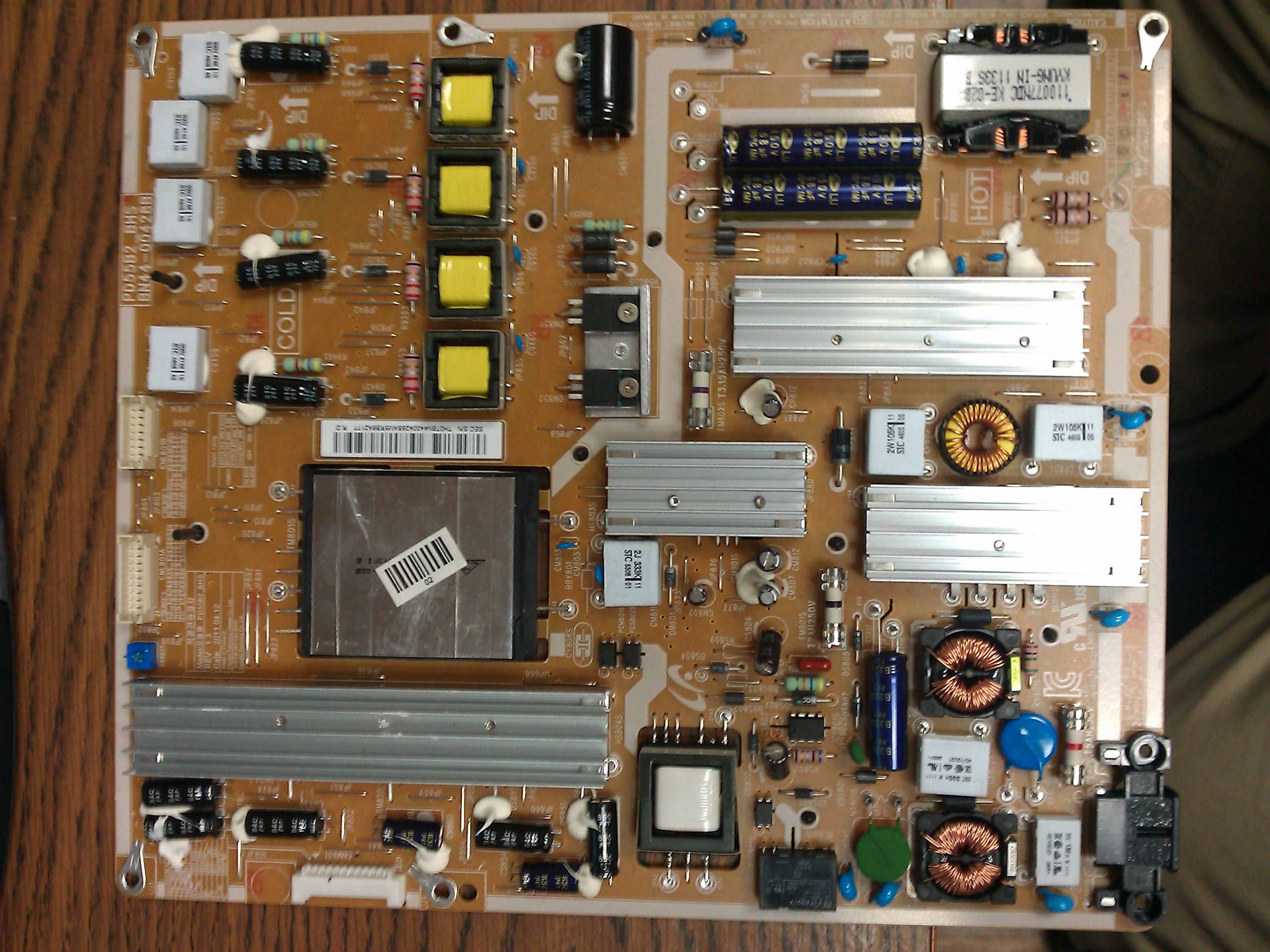

                      This is the input board (cell phone is my only camera here)

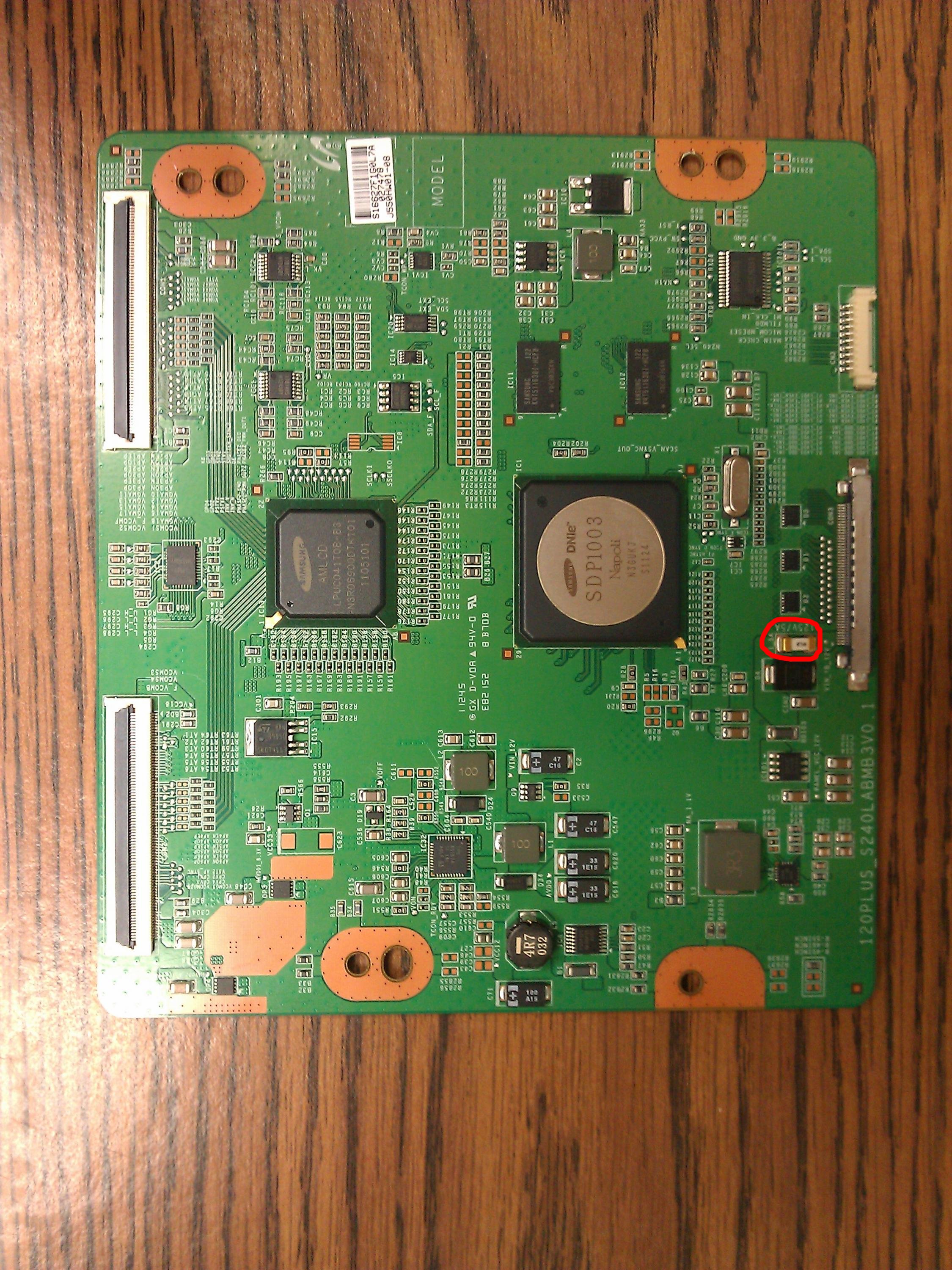

                      This is the T-com board.

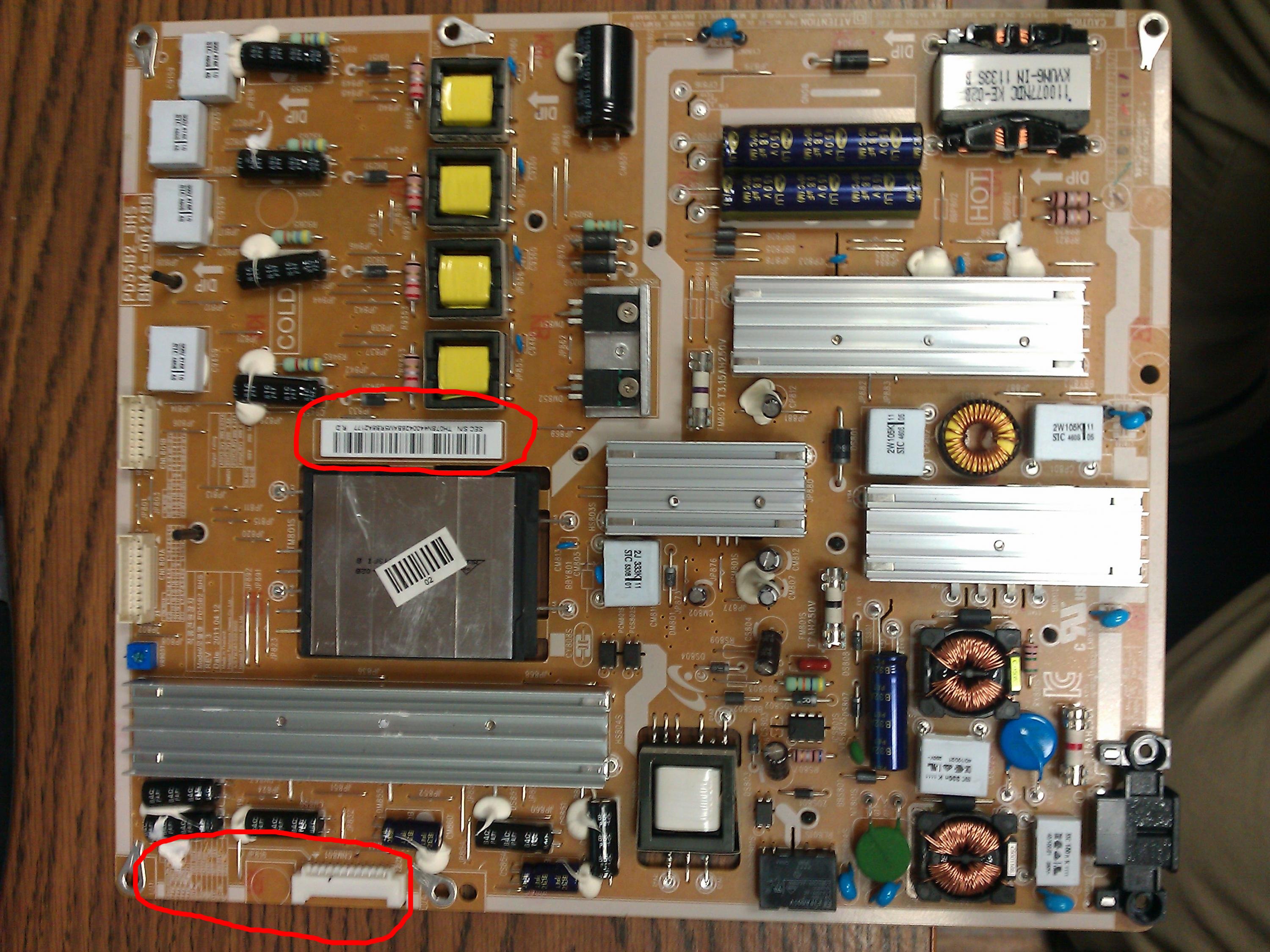

                      And the power board
                        OK, I've highlighted the fuse on the T-con.
                        Set your meter on the DC voltage range, 20V (V=). Put your red probe on one end of the fuse, black probe on the chassis of the TV. Turn the TV on. Then, move the probe to the other end of the fuse. Record and post the reading you get on both ends.
                        (The TV should be switched on and the screen should be glowing.)
                          forgive me, but i don't see where you highlighted it
                            LOL, sorry! Let's try that again...
                              the meter fluctuates for a second, but reads all zeroes. I'm using the tv mount as the ground (the metal part of course)

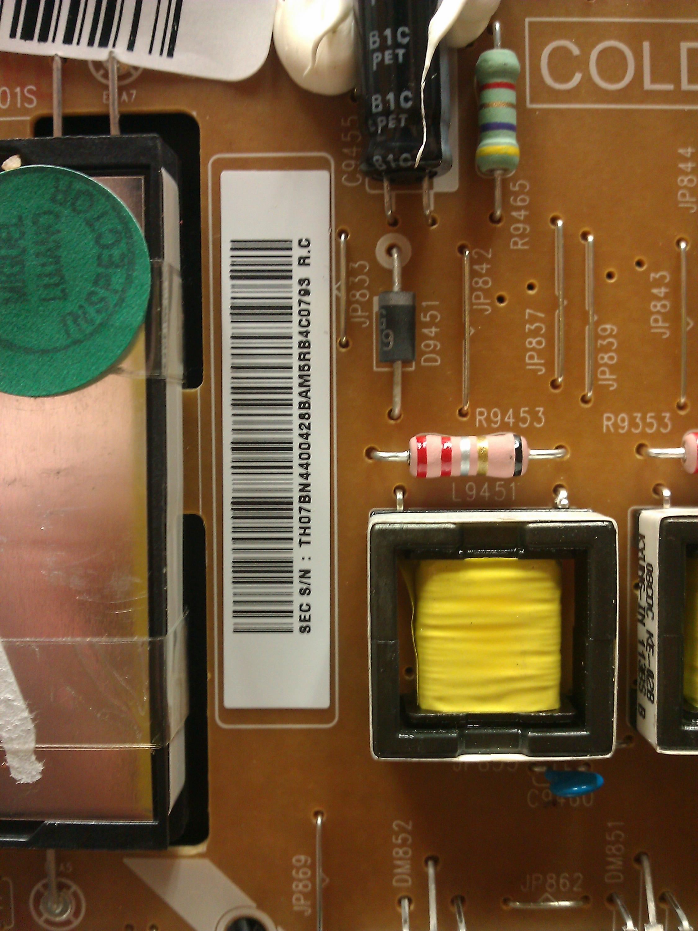

                                    OK, I need a closer picture around these two areas, try to capture at least as much as I have highlighted, but a bit more is fine.
                                    • ndoggfromhell
                                      • May 2010
                                      • 24

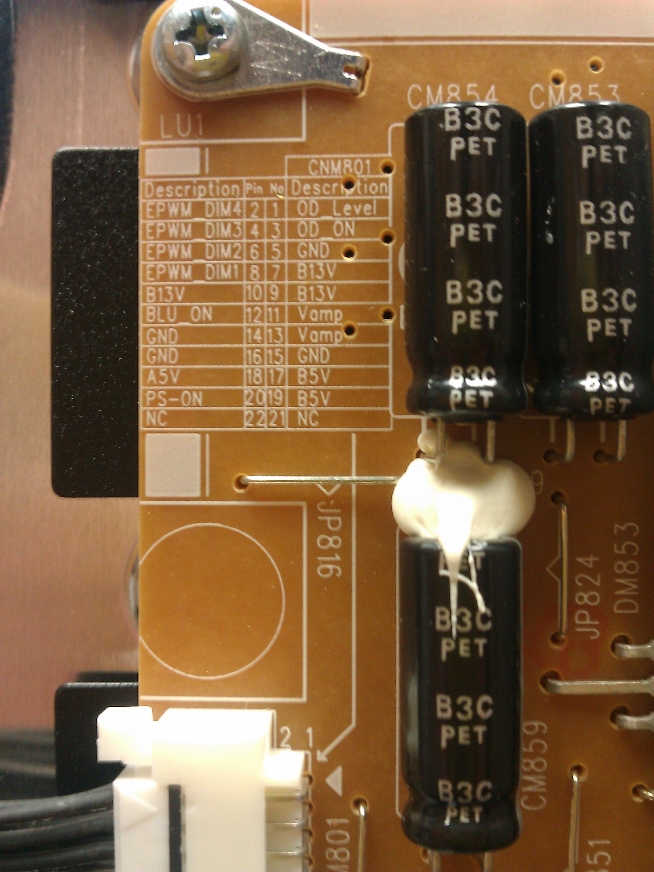

                                      First picture
                                      Second Picture
                                        I was hoping I might have a schematic for the power board, no dice unfortunately...
                                        You can see if the PSU is putting out good supply voltages. You have access to only the top row of pins from the top. Using the same method as for the T-con, black probe on chassis, red probe on each of these pins: pin 9 (#5 from mark "1") and pin 17 (#9 from mark "1"). What do you get?
