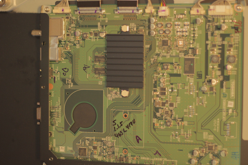

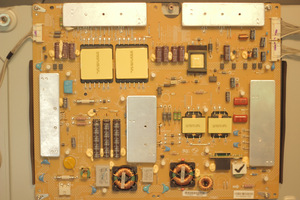

    What does blinking lites mean Toshiba LED tv 46SL417U,no picture , no audio, 3 blinking lites pause then same thing again. power supply looks ok, no visible problems,any ideas,Fuses are ok, caps ck ok.I would like to find what component is bad, rather then changing out all the boards, not cost effective
    Sorry about posting wrong model number in another post, give me another chanceThanks
    Mark
    75022759 Power Supply Board
    Brand: TOSHIBA
    Part number 1: PA-3201-01TS-LF
    Part number 2: V71A00021700

      Yes I have seen this tread, hoping someone would know what part might been bad on that board or what voltages to look for. I have check all the caps and they are ok,checked diodes ok on power supply. Would like to isolate. Thanks

        Re: Toshiba LED tv 46SL417U What does 3 blinking green lites mean
        voltage regulators on main board?
        good pic of your main board here so we can see all parts etc
        http://www.shopjimmy.com/toshiba-750...main-board.htm
          I will ck that board, power off with ohm meter to look for an obvious open or short

              Intimidating board, I have read in another post maybe flashing the card, ram gets corrupted but no sure it was for this unit. Enjoy troubleshooting so not a burden, rather fix it rather than just changing boards. But this board is complicated and I might be fooling myself to repair but would like to isolate to this board only and then purchase it. Don't won't to end up purchasing alot of boards. Thanks for working with me

                    These units seem to have the same boards, google them all, no luck, getting the proper voltage 12,24 and 5 v from the power supply.Sounds like the processor on the main board controls everything. Sound like a common problem but no cures out there on the web,other than replacing the whole board, I wonder what's taking these boards out of service.

                      I talked to a tech he suggested removing the 24v feeding the main/seine board and seeing if the blinkling lights sequence changes.
                        removing the 24v made no different, removing the 5v the tv would not come on, any one have any suggestions
                          Toshiba 75022781 Main Board-seine is the part number
                          Brand: Toshiba
                          Product Code: PE0953A
                          SKU Code: OBC4175
                            I found a main/seine board on line and hopefully it will work. Then I can compare values
                                I finally found this board on ebay about a month. Difficult to find. It is working ok now. I have a UPS on it as I read that the EPROM can get corrupted if the power blips. Have not compare values yet but I'm looking to see if I could reload the software but afraid of damaging my new replaced board. No one seems to be able to get this board. Only if you are lucky to find one on off a cracked tv.
