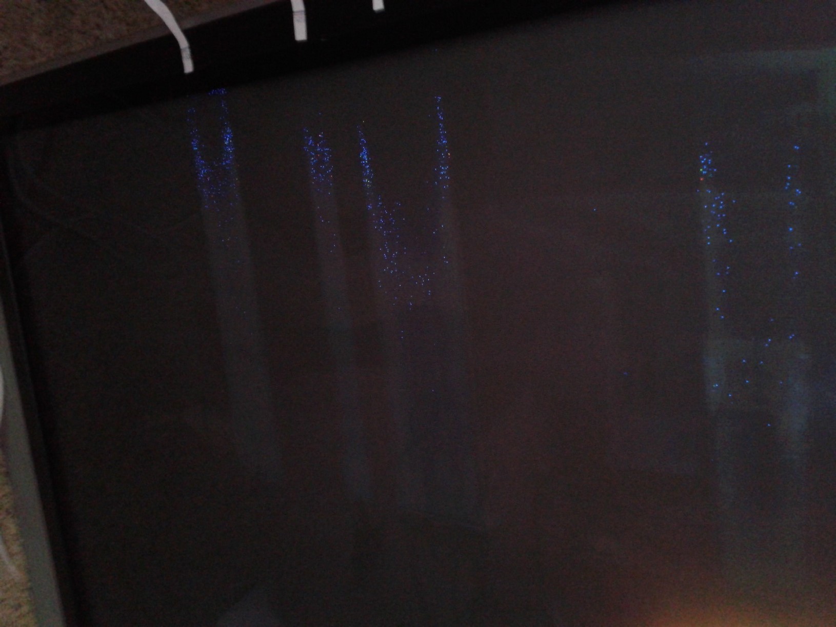

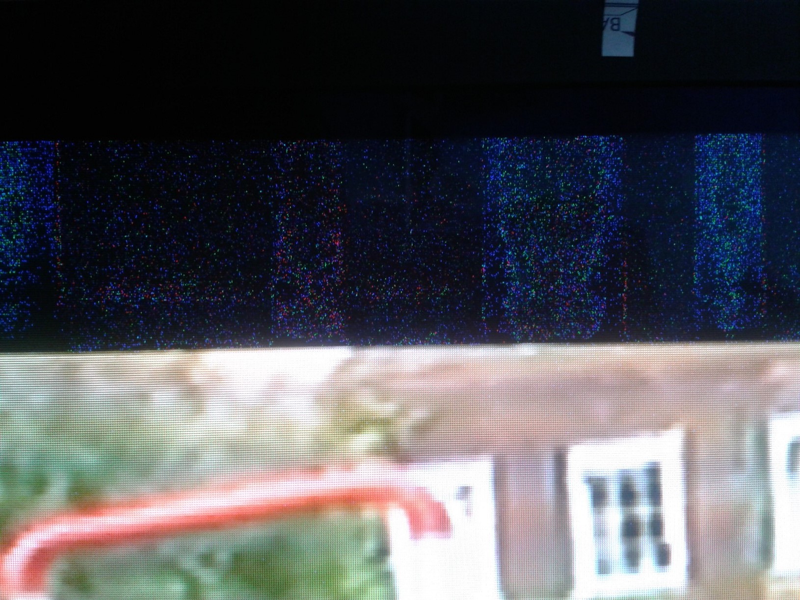

            Re: LG 50PX1D - Black Bars on Top
            We have progress. I went back and re-soldered the effected areas. A couple were not even attached at one end. I touched the solder gun to the resistors and a couple just moved.
            I now have something there (snow) where there was nothing. And it the snow looks ok. However, when the screen is all black, there is some screen burn and still has some blue haze in the effected areas as well as a couple fine red lines as noted in post #3. Any ideas on more improvement? I am working on getting a video source so I can see what video looks like. Pics do not show my current problem.

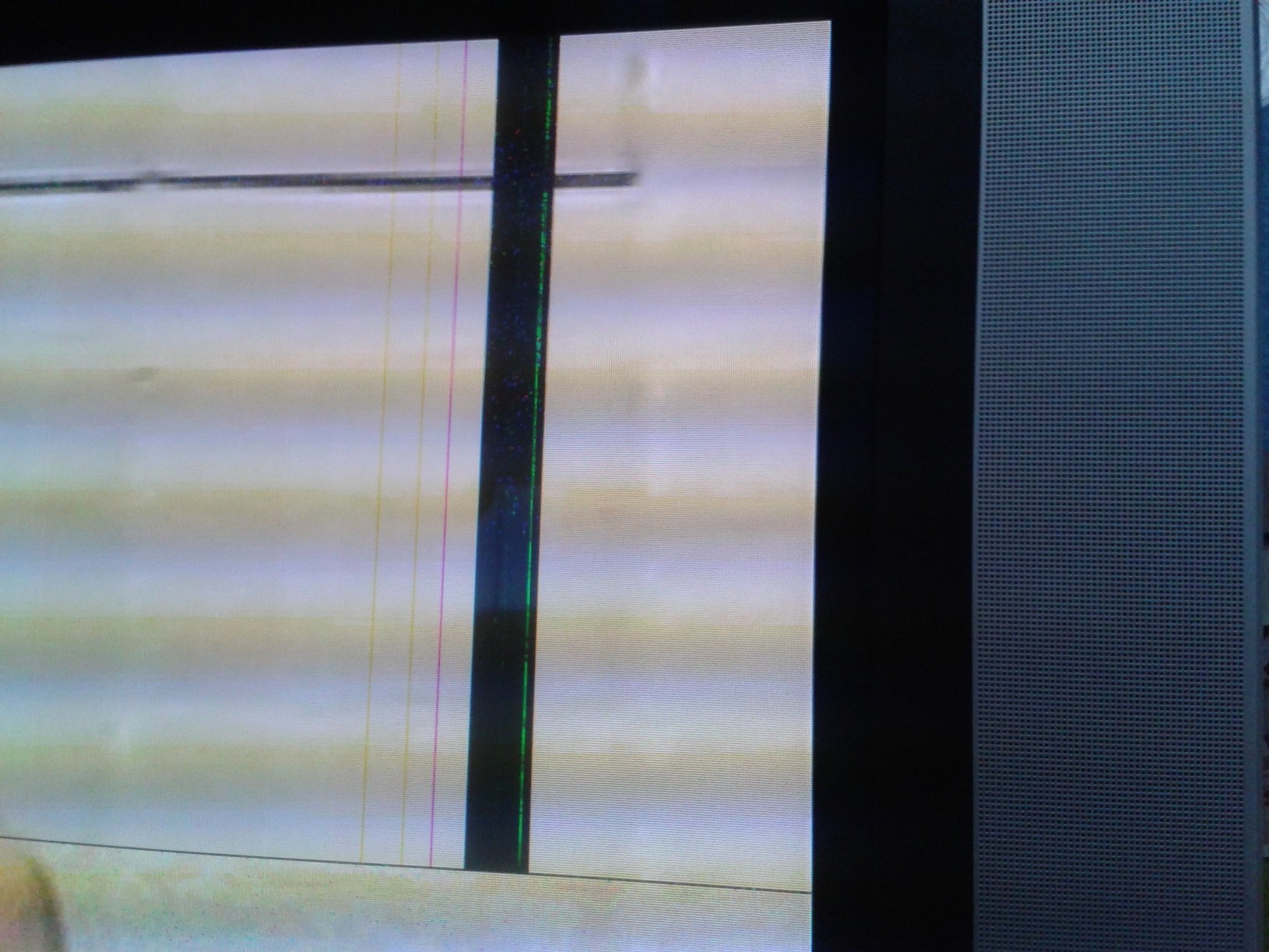

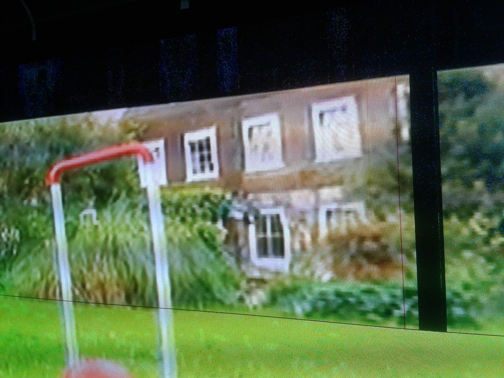

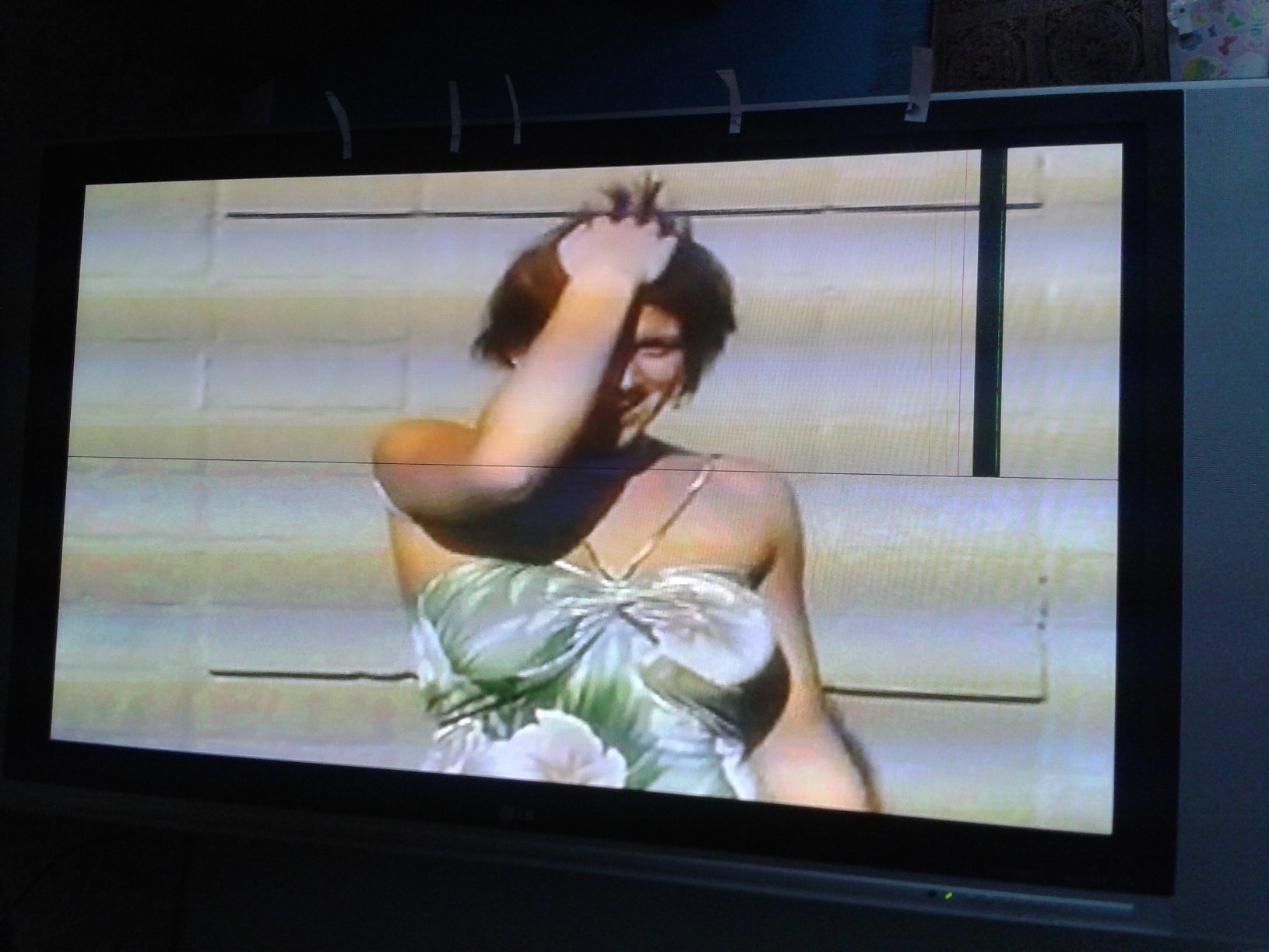

                Ok...
                Apparently I missed a resistor or another came loose. Will fix that shortly.
                Note the horizontal line through the middle.
                Note the vertical red line and two yellow lines on the top half of the screen.
                Lastly, you can see in the fringe the blue in what should be black.
                FWIW, the video is low quality off my ipod.
                      I think the solid pixel lines are bad drivers, which condemns the panel. There's a chance the intermittent solder joint damaged the driver as it is very sensitive to its Va power supply (plugging it in while live can damage the panel for example.)
                              Yeah, you may be able to get $100~$150 for the Y-sus and buffer boards as they are a common failure, I do not like that horizontal black line on the panel though I think it may be a bad buffer board (upper or lower) or loose connector.
                                      But, you have vertical lines too, right? No point in fixing just part of the problem when it's that bad.
