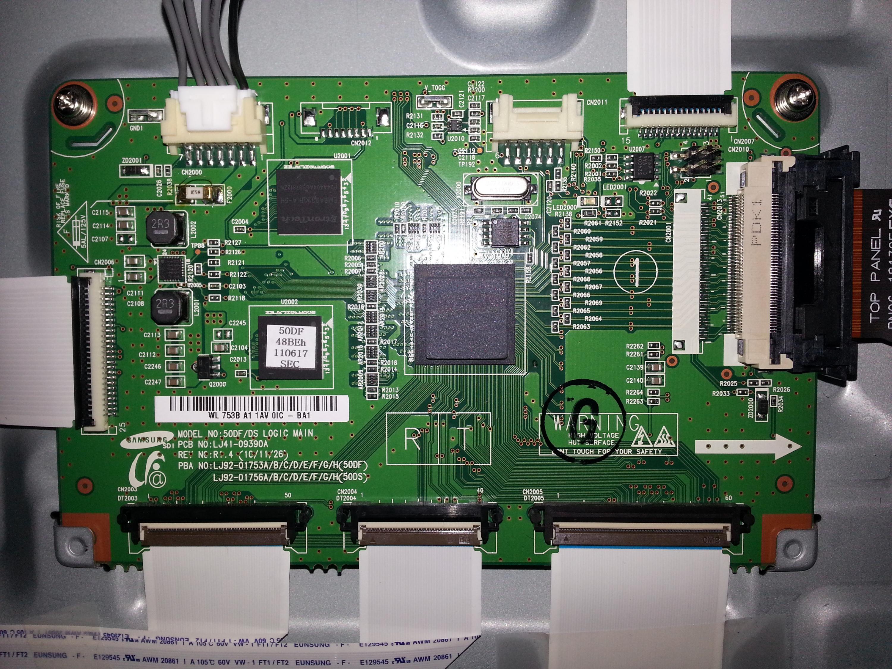

    HI guys
    recently bought a Samsung PN51D550C1XA plasma tv which has no picture or sound just red LED in the front flashing 6 times... Same flashes no matter what boards you disconnect. Found one short transistor on X-Main board (30G124) and blown fuse on main logic board. After replacing the fuse (left X-Main board unplugged - dont have a transistor) relay clicks and red LED flashes constantly (1s interval). Should it be like this or should it power up u reckon? Does anyone knows the replacement for 30G124 as the one I found on ebay is available from China which takes ages to post...
    Regards Tadas

    On a Samsung the blinks mean nothing.
    Have you tried the 3-4 jumper test on the logic board?

        Re: Samsung PN51D550C1XA LED flashes 6 times
        Can you share a pic of your control board?
            http://richtechparts.com/i-4771-30G124.html ?
            CN2010:
            https://www.badcaps.net/forum/attach...3&d=1361389813
            Place jumper between 3 & 4, and unplug the brown connector.
              Do you mean ribbon cable from av board? Same - relay clicks and LED flashes. Don't forget I still have my X-main disconnected ... Thanks for the link. I've seen that before but this is in US so almost same as getting from China
                What do Vs/Va measure before it clicks?
                As far as a part, you will have to either replace them all with the same part, or find the right part... you cannot sub in a similar part as it will cause uneven power dissipation
                  I found X-main on ebay and gona buy it tomorrow I was Just wondering Should it power up with disconnected X-main if everything else is ok? Before when the fuse on logic board was blown Va was 0 and Vs used to rise slowly up ~10V let me check now... No Va, Vs ~4-5V
                  It starts clicking as soon as I plug it in...
                    all sorted now... one transistor on X-main and ribbon cable shorted from logic to ysus which was blowing the fuse on logic board.... tanks everyone who was trying to help me...
