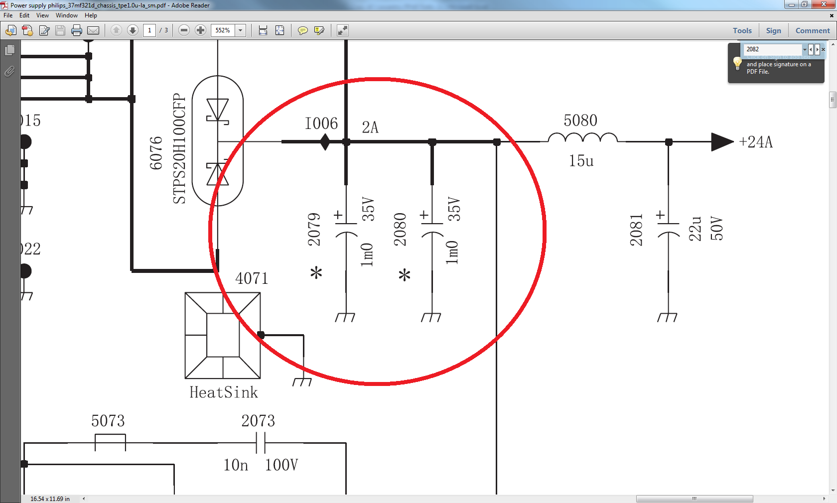

    I picked up a few older TVs today. One of them, a Magnavox/Phillips 32MF23ID/37, supposedly would eventually turn on if you played with it long enough. I suspected bulged caps in the PSU. When I got it opened up, there were two 1600uf 35V caps that were badly bulged. I didn't have any of the same size so I put in two 1000uf 35V caps just to test. I plan on picking up the correct ones tomorrow. It will now turn on, but will not turn back off all the way. When I hold the power button in, the set turns off but restarts as soon as I let go off the button. Would undersized caps do this or am I probably looking at a faulty power button?

      Well, I won't power it up anymore until I get the correct caps in. Thanks for the heads up. Just to answer the original question, it was a sticky power button.

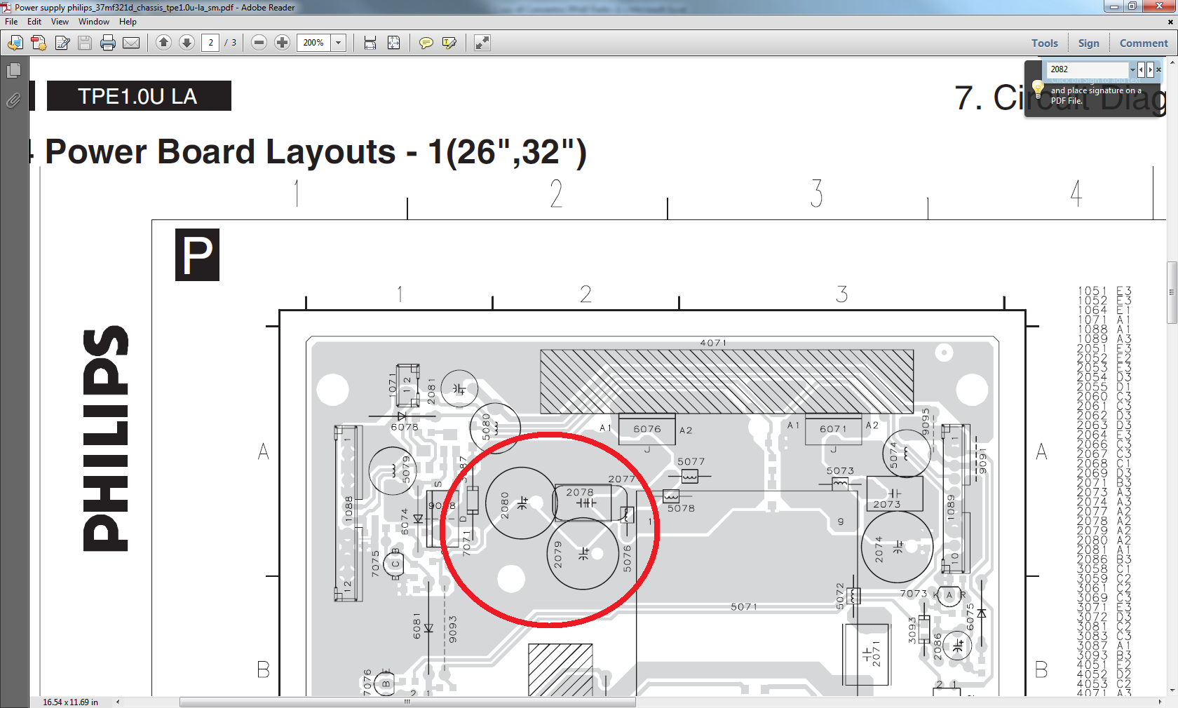

          Now that I mention it, I've been reading posts regarding this PSU this morning. I've seen one post that said that the poster's PSU had 1200uf caps there. I've seen one post that said 1500uf. I've even got the schematic and it shows 1mf (1000uf). It's looking like they may have just thrown in whatever was available. Is there a way to confirm that the 1000uf 35V caps I have in there now are OK to run?
                  I believe I do have a 2200uf cap in my spare parts bin. I also found two 1500uf locally. I'm going to double check the old caps first. It would be no surprise to me if I read the cases wrong. I don't hava a lot of experience but I have never seen caps with markings like this in any other TV I've opened. What do you make of my question regarding the schematic in post #5?

                    They would appear to be 1000uF caps, so replace them as such.

                        Original caps were 1200uf, not 1600uf.
                          Re: Would undersized startup caps keep a unit from shutting off?
                          I'd advise 1200uF replacements then.
