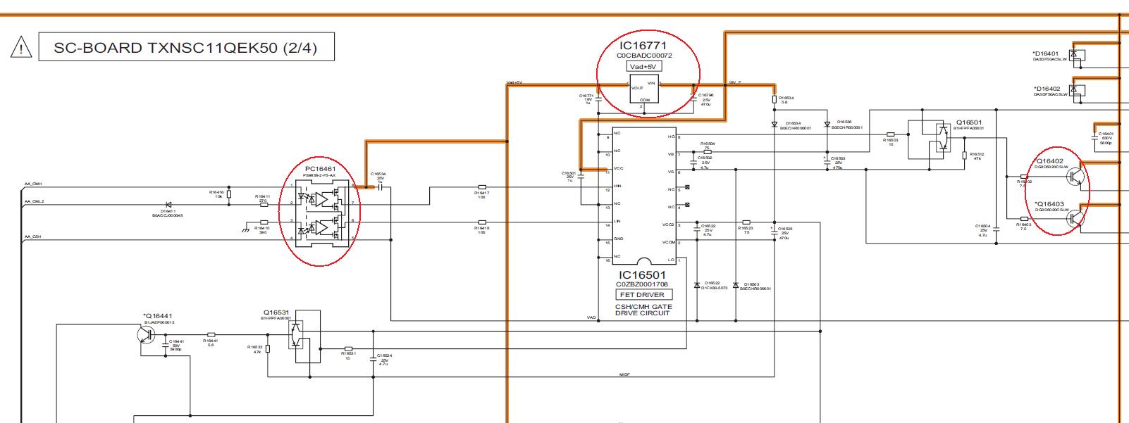

            I removed the IC773 and IC771 and still get 26ohm b/n Vout and Com (where IC771 should be) ?!?!?????
            Thank you in advance

              I'll have to have a look at the schematic and see what else hangs of the 5v supply from that regulator. I know that there were several other items i removed first before finding the inverter was shorted.
              the fact you only did the IGBTs means power would have been applied to a shorted cct so further items have most likely failed which is how i ended up with such a job with the first board I attempted(last one fixed)
                Re: Panasonic sc tnpa5081 rebuild
                Actually i'm getting my 5v lines mixed up, it was the P5v at SC20 I had to remove a lot to find the short.
                IC771 Vad +5V supplies, PC16461 (OPTO), IC773(inverter), Q16649 (also connects to the NAND )
                Look at post #120, pay close attention to circled items, maybe remove the opto first and see if any change, check all those other transistors for shorts, check resistors and diodes.
                I'd consider straight out rebuilding that inverter cct, was IC773 gnd-vcc low ohms out of cct?
                In cct on a good board about 6k ohms com-Vout on IC771, must check reg out of cct, in case it's bad , k ohms on input, M ohms on out ( from memory)
                What resistances did you get on the removed 5v reg pins?

                    Pity about IC773, I was just curious to compare if it had failed, most likely has, every other one had so far.
                    I'd attack this one section at a time, it's a balance between repair cost against risk. You could replace everything or try and work it out. Fixing it first go though is a lot cheaper.
                    The list at least points you to what can fail.
                    IC16521 could be good or more than likely bad, IC16501 so far I have not struck that failed yet.
                    I would check every part around IC16521, They're all circled on that board shot what I replaced. Only on the last board I messed up did I have to replace more than IC16521 there which you may also be in the same situation.
                    Measuring the P15v line in will possibly give a clue but I have had one which was ok there but pins 7 & 8 were open cct but that was on the one I kept blowing. usually the Vcc - gnd goes low on the failed ones I had. Straight out replacing that is a safer option and to test pins 7 & 8 it is better removed to test so you might as well put a new chip in and the best option for that.
                    Q771 will show low as will anything else on that 5V line until you find the short, I would not throw anything out yet unless you're happy spending the money on parts some of which you may have to get from a Panasonic stockist like Sears or CCE etc.

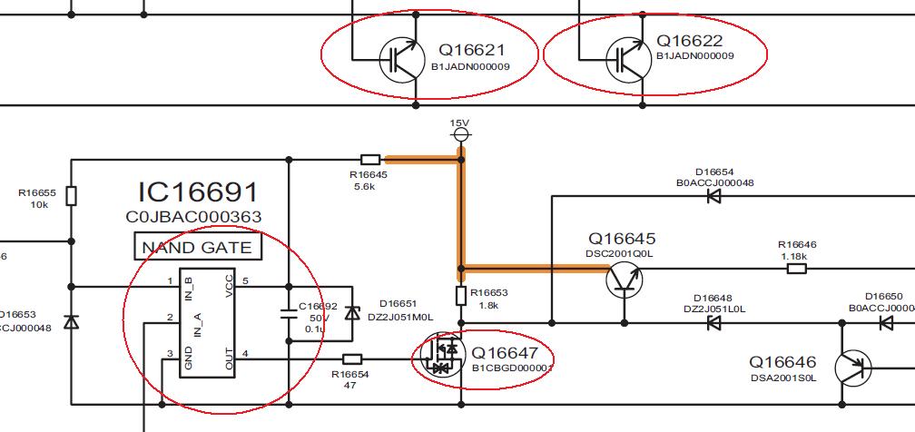

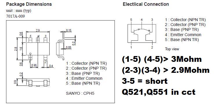

                                          I've highlighted ones here which stuffed me up trying to test in cct.
                                          D16451 B0ECKP000055 DIODE 1 ROHM , RF101L4S 400V 1A SHORT
                                          D16482 B0FACP000003 DIODE 1 RFN25TM4SWSHORT
                                          Q16452 B1JAEP000012 TRANSISTOR 1 GT45G128SHORT

                                          IC16691 C0JBAC000363 IC 1 TC7SH00FU(TE85L,J

                                          Q16521 B1HFPFA00001 TRANSISTOR 1 CPH5524-TL-E
                                          Q16551 B1HFPFA00001 TRANSISTOR 1 CPH5524-TL-E

                                          Q16647 B1CBGD000001 FET 1 2SK3018T106,2n7002
