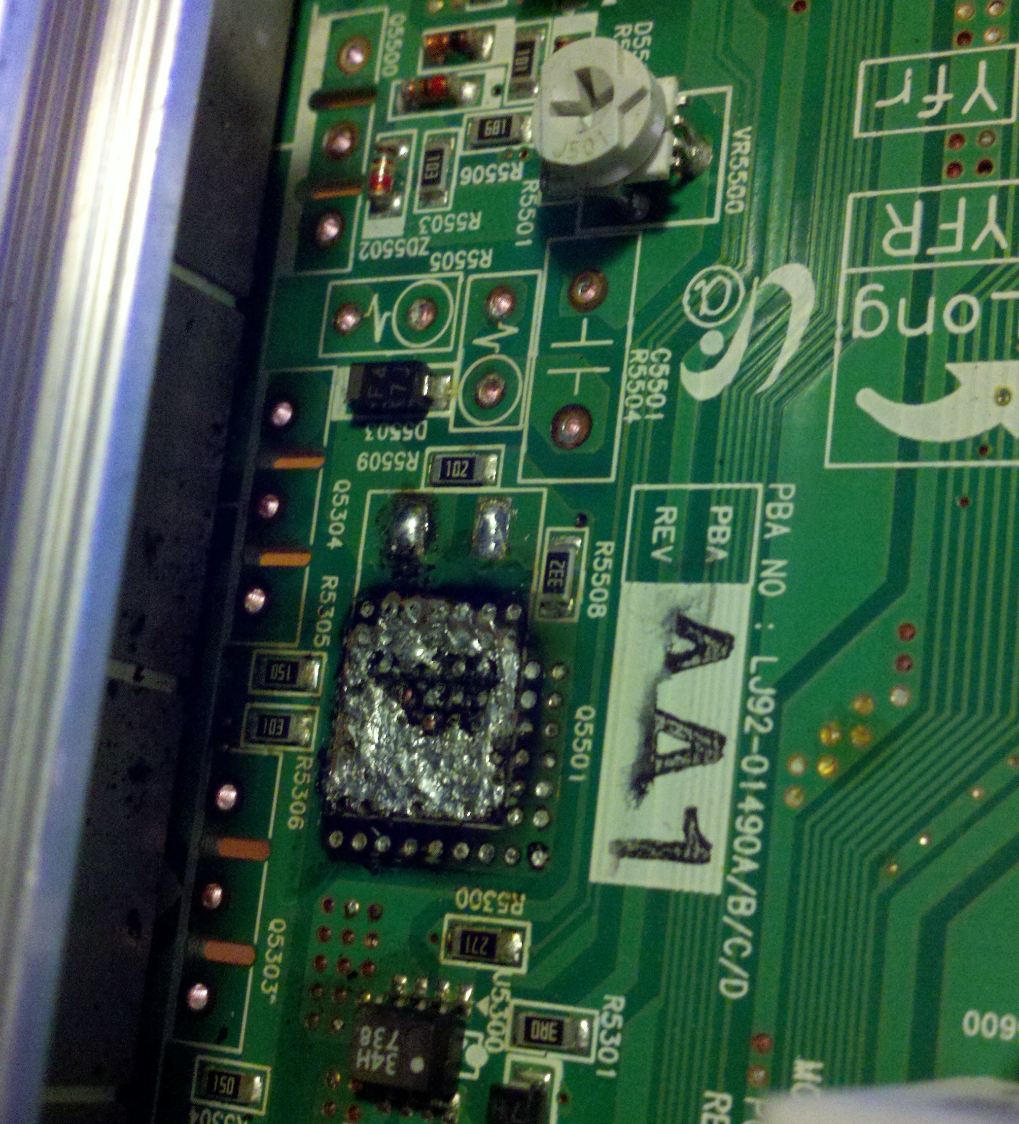

                          The more I examined it, the portion in the middle of the pad is burned through a good deal of the PCB. I scraped some of it away, but I didn't want to go too deep. I'm a little concerned about a burning odor being given off when the TV is operational. I did solder on a new mosfet after cleaning the pad with alcohol, but I can redo it if necessary.
                          I saw this PCB repair procedure online, but I'm not sure I need to go this extreme: http://electriciantraining.tpub.com/.../14186_128.htm

                            It's only going to burn if it's got a fuel source. If that is just contamination it'll just make the MOSFET run hotter.

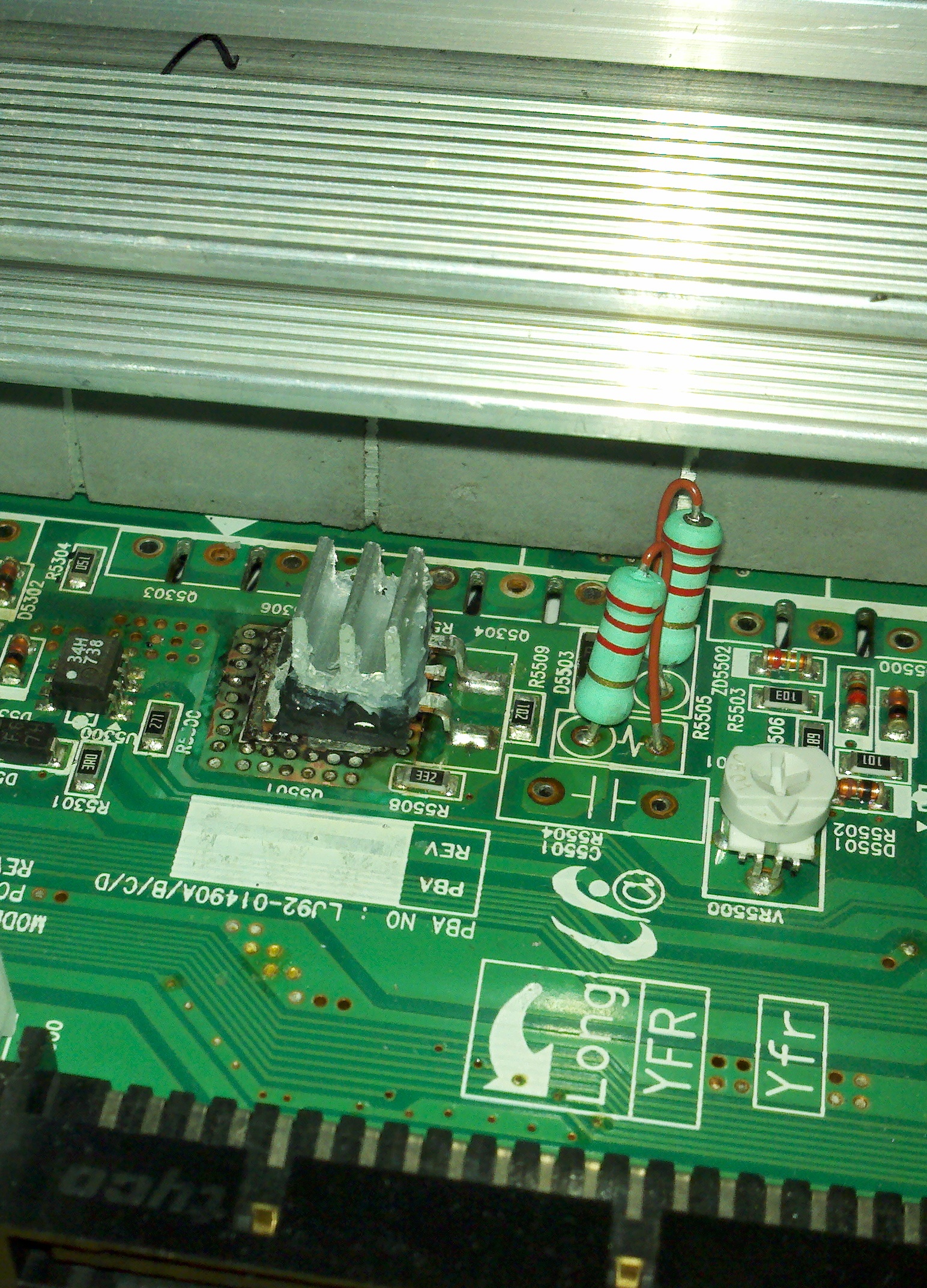

                              Ok. I'll just leave it as-is for now and see how it performs. Would a small heat sink help? I'm not sure I can find one that small or if it would make that much of a difference.

                                Probably not going to work that well... then again I have seen Panasonic do it on their new thin plasmas (1" thin, all SMD) so maybe it could work.

                                          I attached a heat sink to the mosfet using some compound and Momentive RTV. I'm letting the RTV cure overnight. I also used some 2000-grit sandpaper to gently clean up the burn marks on the PCB. I scraped away as much of the burned PCB underneath the mosfet as I could without making a hole through the board. Thoughts?
