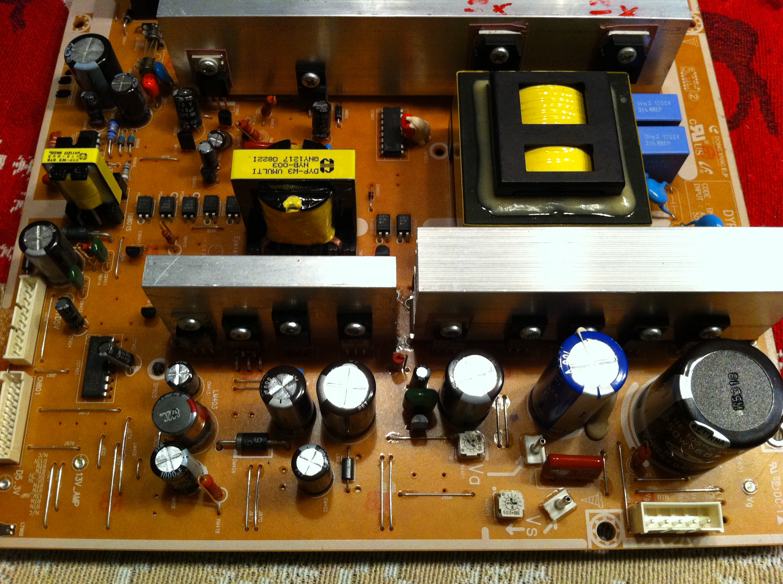

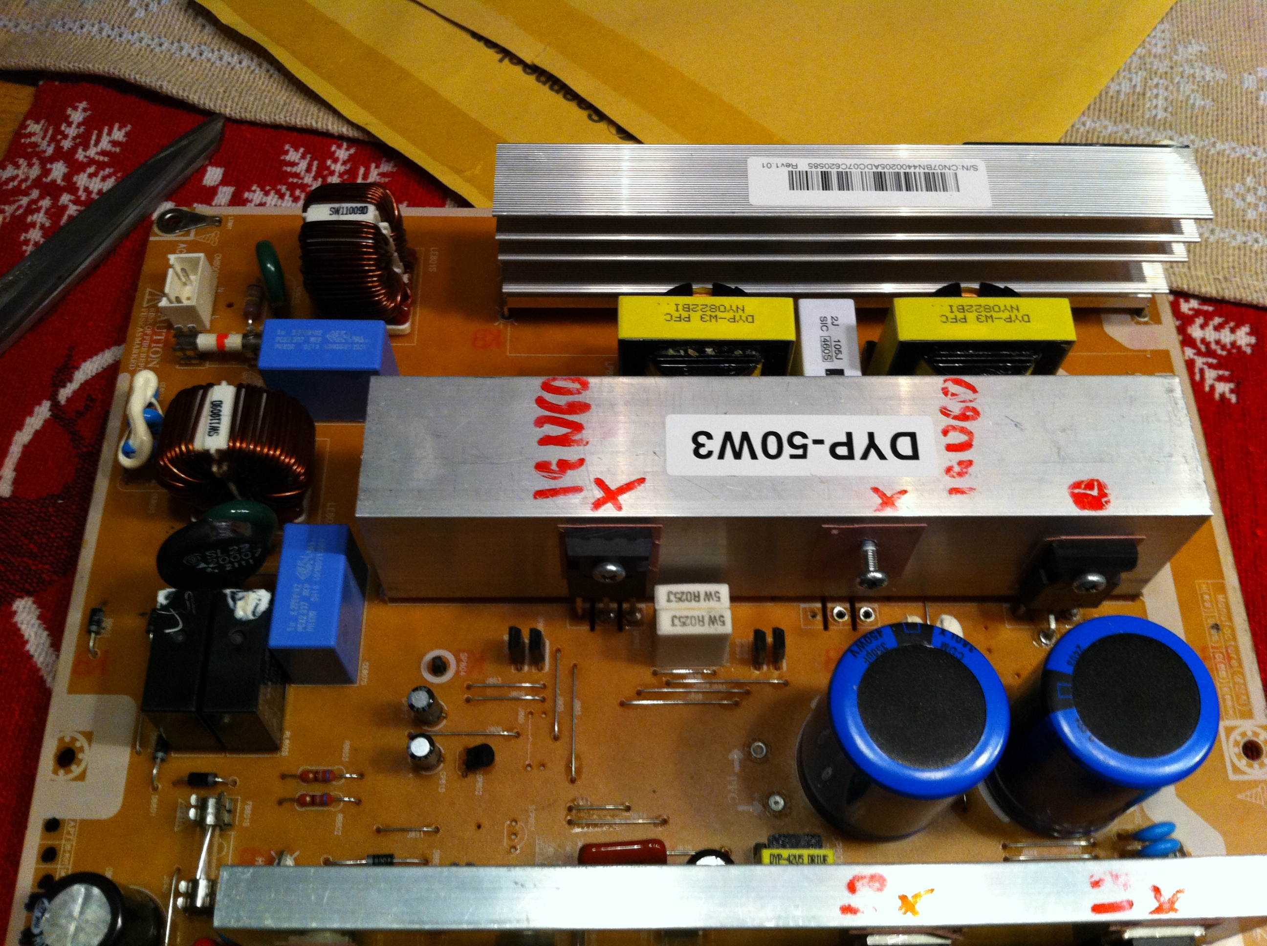

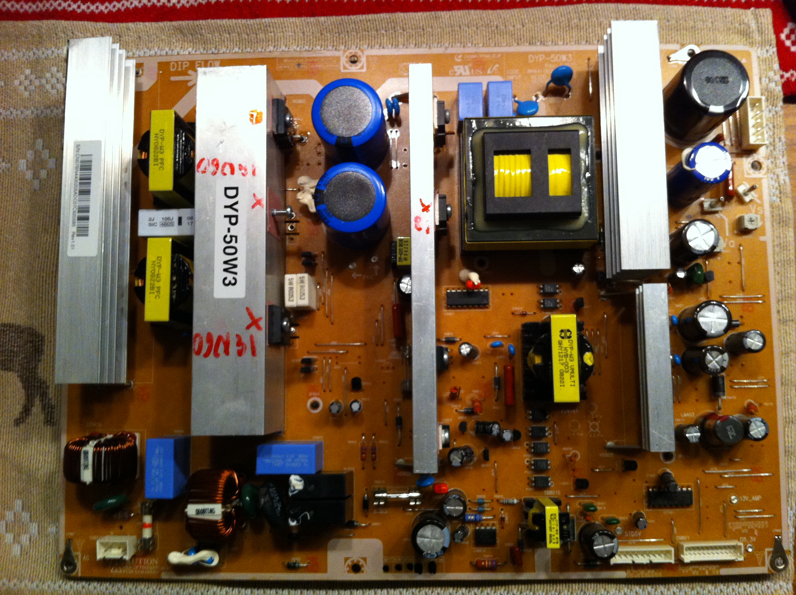

    I need you help to repair a Samsung PS50A410.
    The Power Supply (DYP-50W3) has only Stand-by power.
    I have changes the Caps (CP805 and CP806), the bridge rectifier (BP802) and checked all diodes.
    In Stand-by-mode no reaction. After I had turned on the Power
    I had a small bang and short-cut between all pins from QP801 (19N60).
    I can't find the reason for the short-cut...
    Here is the shematic:
    http://dc307.4shared.com/doc/owK8ThvU/preview.html
    Has anyone an idea for the troubleshooting?

    Clear pictures are important, can you post some? Could have been the fuse that popped too
    • Okuma
      • Dec 2012
      • 2
      Re: Samsung PS50A410 - big bang and no idea!
      There are some pictures.
      The fuses are okay, the varistor has 0 ohm and will be replaced when I had found the defect part(s).
