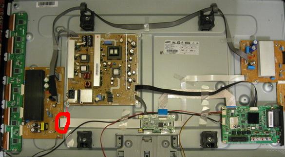

    In this set , clicking relay noise from tv when turn on. some times led blinks 5 times.
    I found a IGBT TRA. (3 nos. ) on Y-Drive board.
    My question is , do i have to check or replace anything before i replaced new IGBT TRA.??

    The blinking LED is normal for any Samsung when powering up.
    The most common failure on this set is the X-main. Try unplugging that and seeing if the set powers on. It should work but have a dim barely lit screen with some picture visible.

      i found 3 IGBT Transistors short on Y-DRIVE Board.
      Before i replaced new Transistors , what should i have to check.
      Even if i disconnect a cable from Y-DRIVE BOARD ,ANOTHER END GOES TO POWER SUPPLY,, Still i have clicking noise. But as i said ,i found shorted transistors on Y-DRIVE BOARD.

        Oh OK. The Y-main can also fail on this chassis, I have not seen it before though.
        You should check the buffers for shorts. If you post a picture I can show you where to test.

          Here is the attach. of my chassis

            I really need a closer shot of the green board on the left hand side, in focus, at least 1280x1024 pixels, better if bigger.
