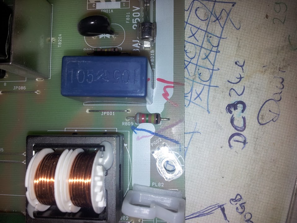

    just troubleshooting this monitor,
    The Power Supply is a Toshiba - PE0620 Version: V28A000841A1
    i found the resistor r809 to be open.
    i expect it should be at 3.7k ohm. now i wonder if this is correct.
    Re: Toshiba Regza - 42RV555D
    It is normal for that resistor to appear open, it is usually around a few meg-ohms, it is a safety resistor.
    What is the fault with the TV?

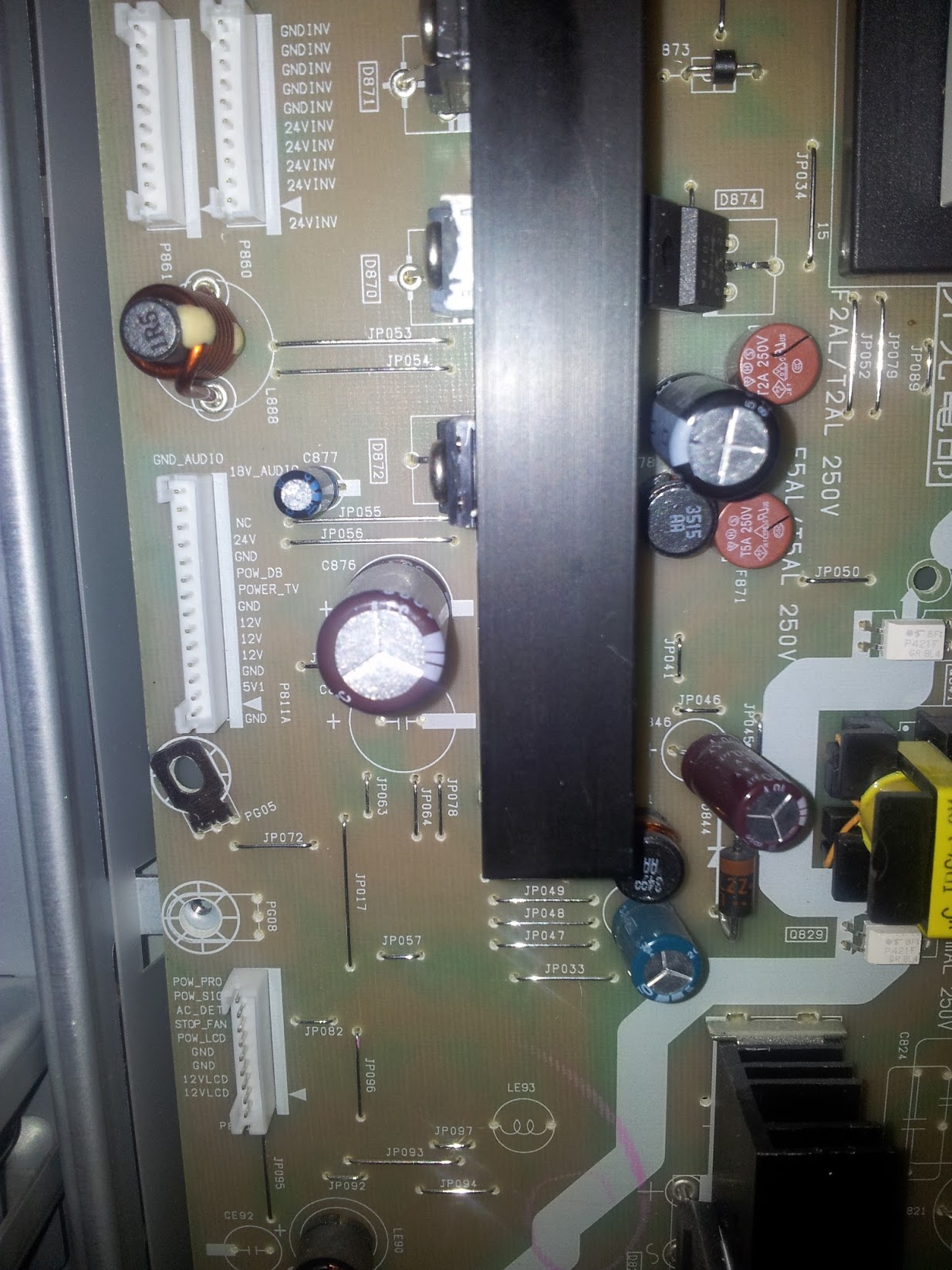

          Update on this one,
          the powerboard has ~ -3 V on POW_PRO and ~ - 4.9V on AC_DET of the lower connector.
          And there is -5 V on POWER_TV. which should turn on the main power supply i guess, but there is no other voltage comming up.
          Can you give me some hin on what else should be jumpered? i attached an picture of the power board connectors but iam not really shure where to put the 3v / or i guess -3 V on this tv.
          Another sympthom:
          I hear a high frequent sound comming from the powerboard which dissapears when i press the power button.
            When you press the power button, does POWER_TV change at all?
                    Since the power on voltage does not change, I suspect the main board is at fault here. Using a 470 ohm resistor, you can change the power on voltage and check all the power supply outputs come to the right voltage. You need to connect from POWER ON to GROUND, then you can test the 24V, if it then comes to 23.5 - 24.5V the PSU is most likely OK. But if it doesn't, I would suspect the main board is attempting a self-test of PSU (it is common with Toshiba) and this is failing.
