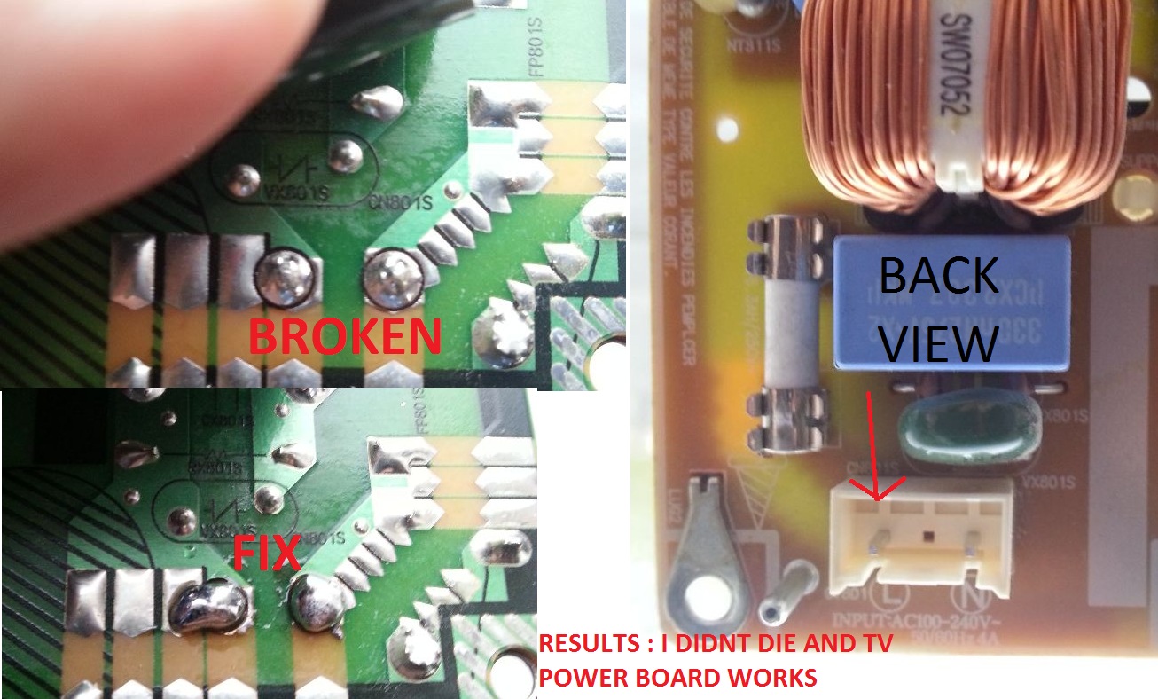

    Hi, I have just recently ordered some capacitors of this site, now they are the correct ratings, 1000uF 35v ZLH 12.5mm 20mm but the wrong size. Would this actually matter ? As I want to replace all the capacitors on my power board, I have heard bigger capacitors have a lower esr, does this just mean they are less likely to overheat ? Anyway, here is a pic of a capacitor on my powerboard. that I will replace, as you can see they are much bigger than the ones I have ordered.
    Thanks for your help

                    Dam it, my tv did it again.
                    Only this time, its not as freqyuent, I need to buy another 4 caps.
                    Should of replaced them all, oh well will order next week.
                      Re: Samsung TV
                      Maybe a cold solder joint instead. Very common with Samsung TVs.

                        Re: Samsung TV
                        Not sure, there is still around another 5 Samwha caps left, it could still be there is another
                        faulty cap on there. So far the problem rarely happens now, it use to occur after 1 hours of use, now that's about 6/7. When I used to turn the tv off, id have to wait 5 mins, and this would give me another 40 mins of tv time. Now I can turn it off for a minute, then I'll have another 5++ hours before it happens again. There also used to be an electrical discharge sound, kina like a crackle, as far as I can tell this has gone too. Since the swap it happens very rarely now, if at all. But the problem still occours.
                        Still buzzing that it's almost fixed.

                          Just an update really and posting so it may help others, my tv still had the same problem of randomly shutting of my display, while still playing sound. So I took my tv apart and checked the circuit board for dry dry solder joint, it turns out, I have two faulty joint which happened to power the main control board of my tv. So it works now, I was a bit worried that id blow something when I fixed it, but it works fine now. I have included a pic for reference.
