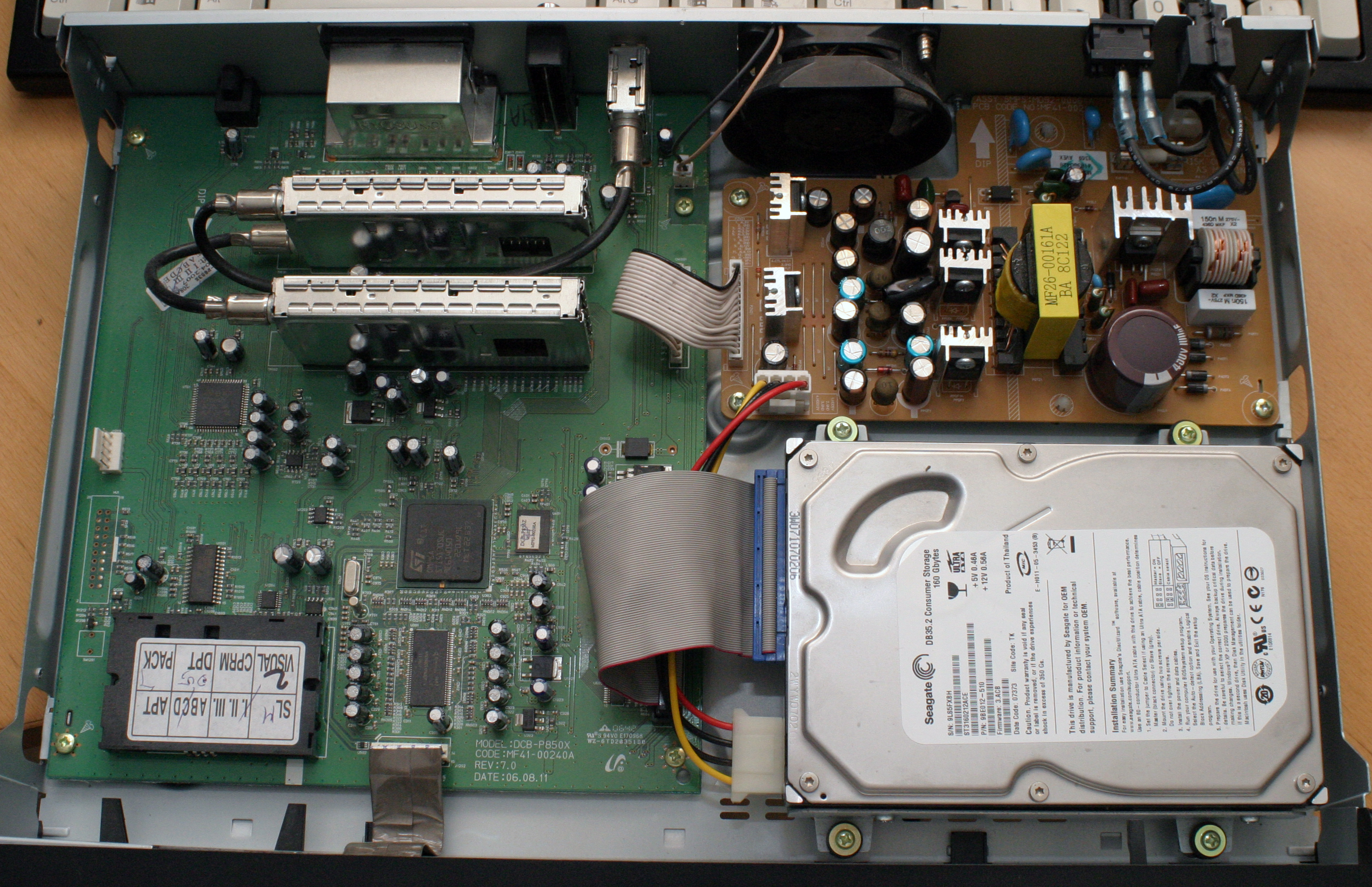

    Hello all the experts here in the badcaps!

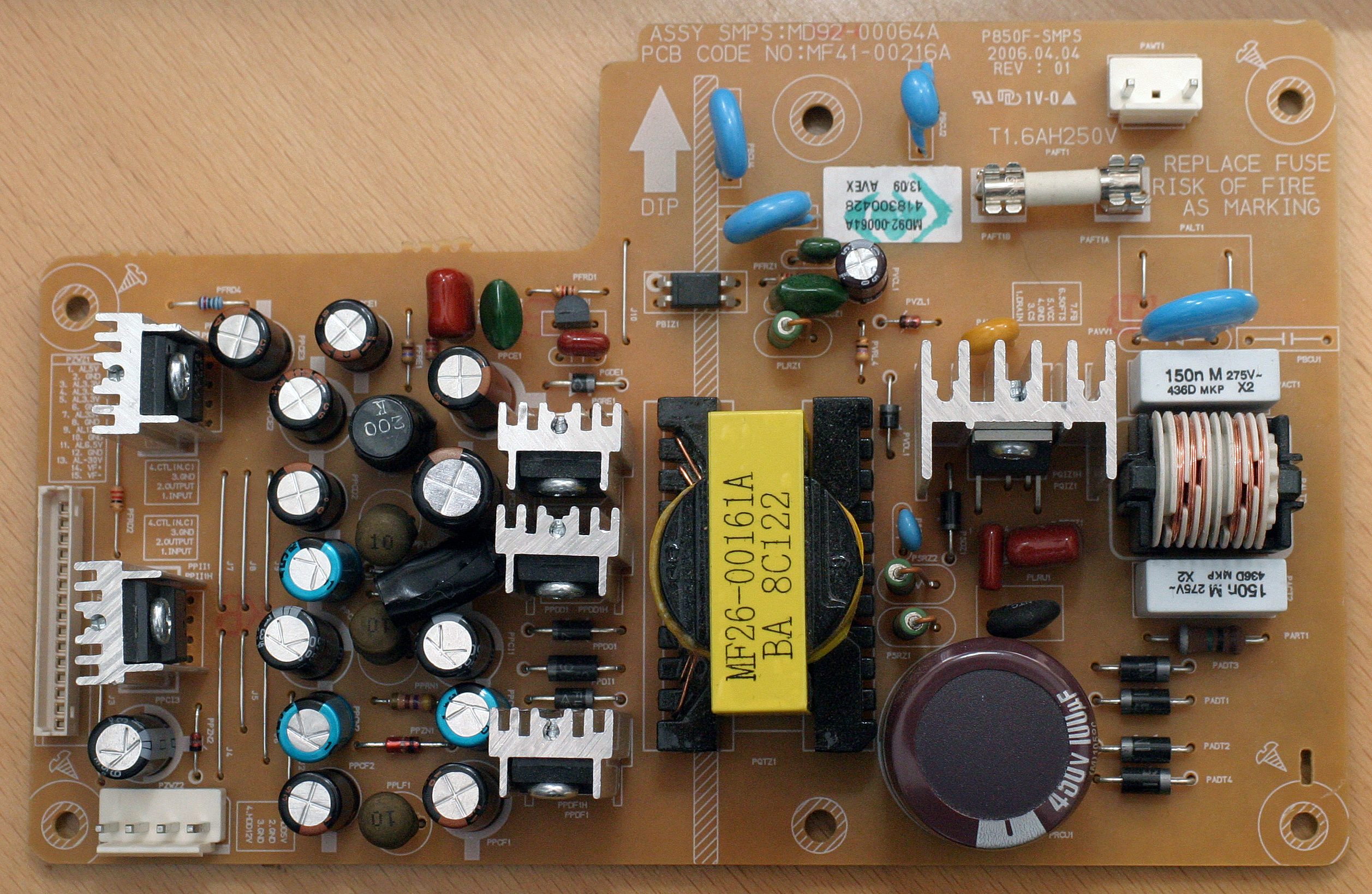

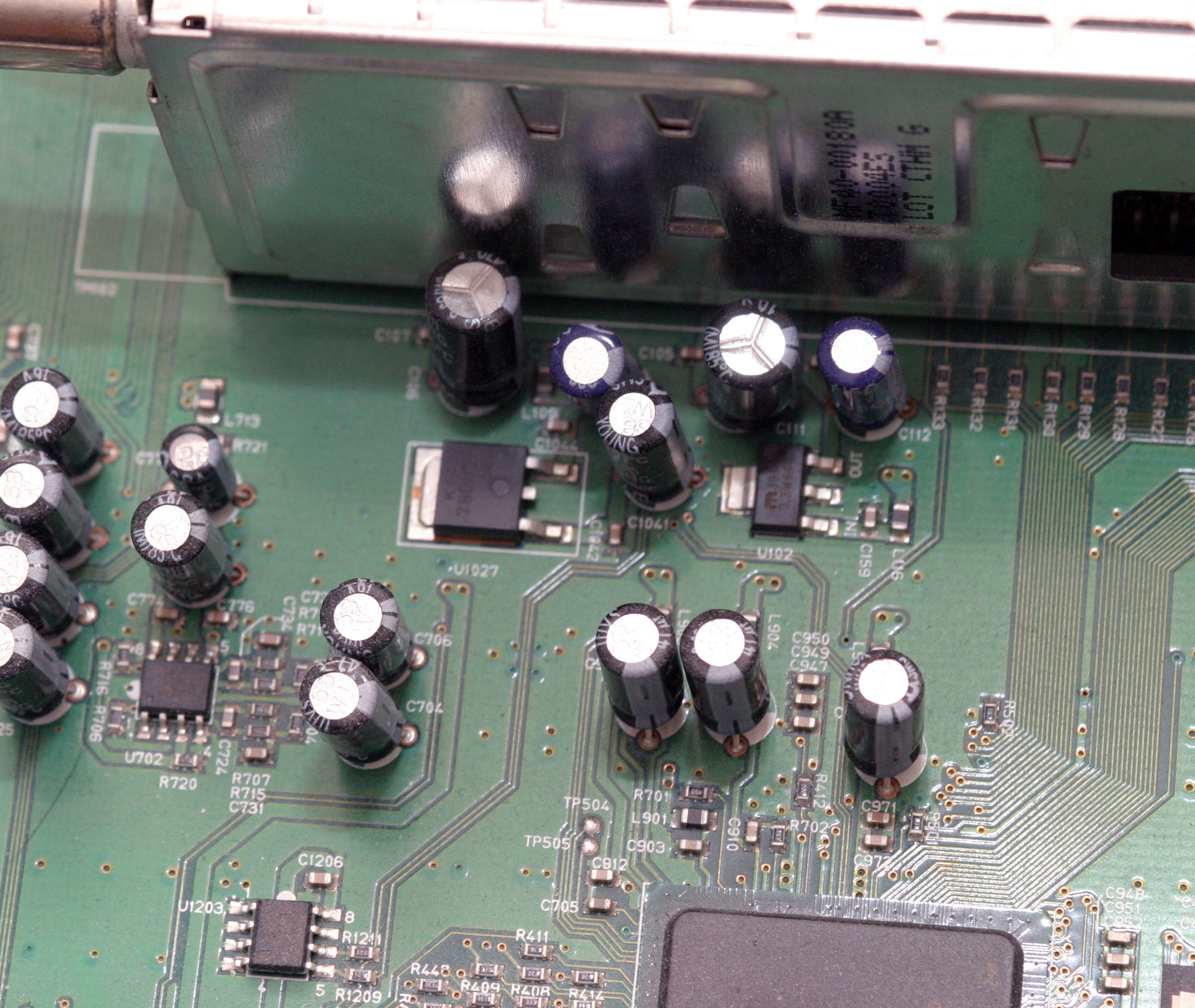

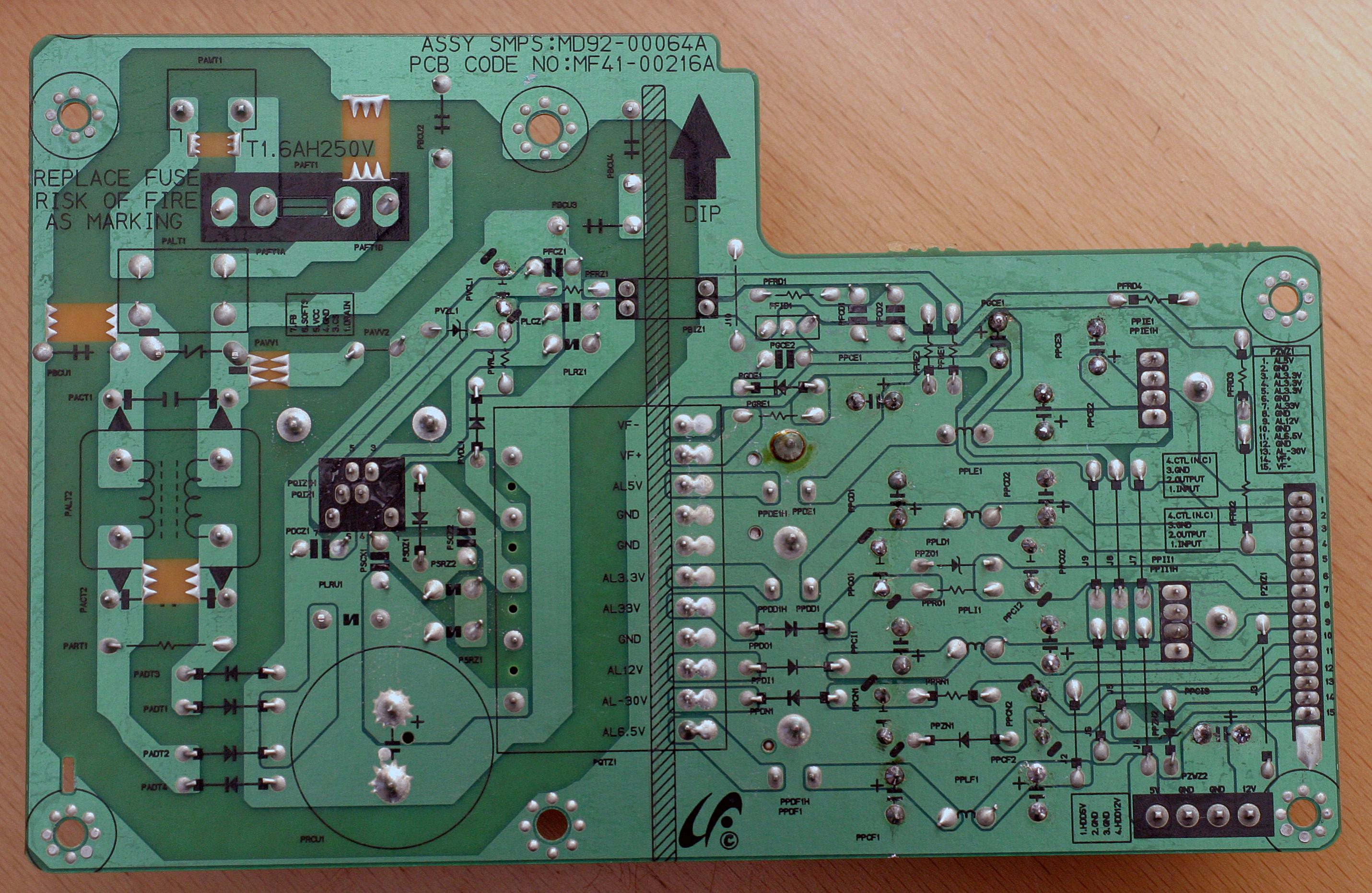

    I've got myself a broken DVB recorder by samsung. The unit wasn't powering on and all that, so I changed all of the caps in the psu, besides the 450V one. This fixed the powering on issue.
    Next thing after this is that the device could boot up just fine and work too. Or it would be stuck on boot with all the red lights just on. In this state, it doesn't do anything by pressing on the power or any other button. Hard resetting it from the back switch may or may not get it working again for a period of time. After a working period, it could just hang or boot again. When it works and you switch it off from the front panel, the fan may stay on even though the other components power off.

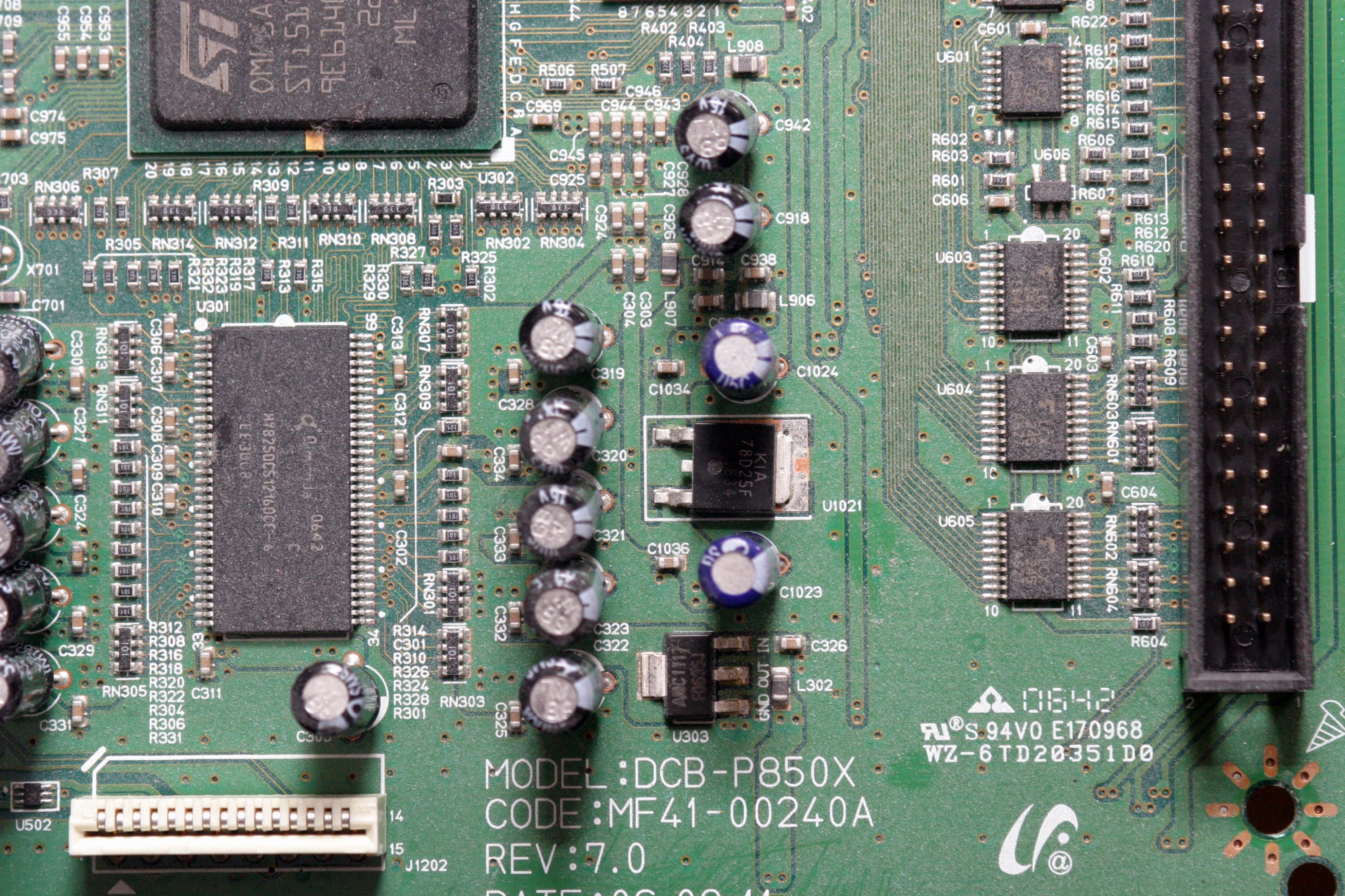

    There are few regulators on the motherboard, here's what I've measured.:
    U303
    AMC 1117 (sot-223) = it doesn't have prefix (1.8-5.0) so accounting to the datasheet, it's variable output regulator.
    big tap = 1.241V
    GND = 0.001V
    OUT = 1.241V
    IN = .OL
    U1021
    KIA 78D25F (TO-252) = 2.5V fixed.
    big tap = 0.001V
    pin 1 = .OL
    cut pin = 0.001V
    pin 3 = .OL

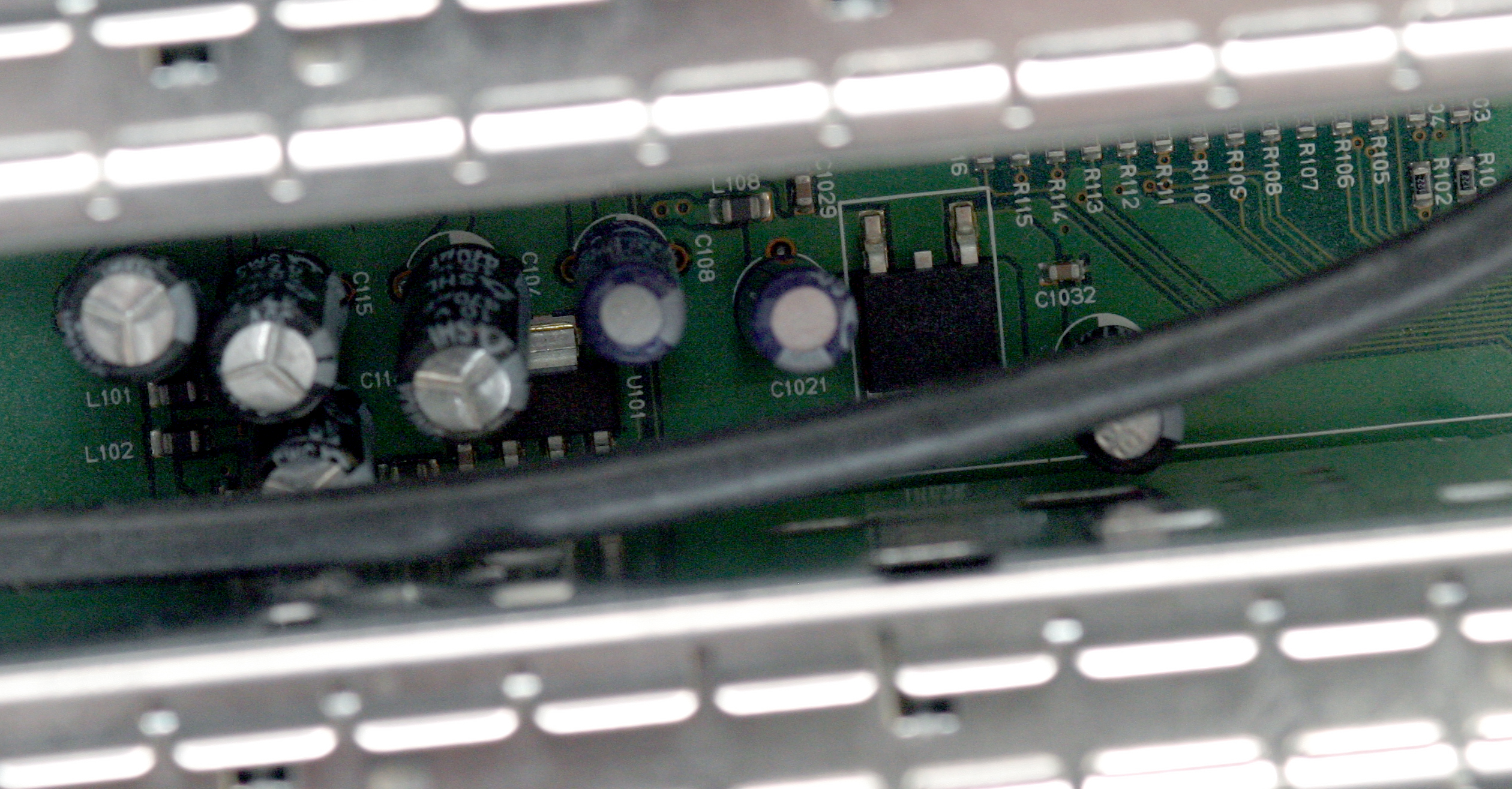

    U1027 & [U1025]
    KIA 78D05F (TO-252) = 5.0V fixed. There are two, one between the tuners and a pain in the ass to measure.
    big tap = 0.001V
    pin 1 = .OL
    cut pin = 0.001V
    pin 3 = .OL
    U102 & [U101]
    M39100 (sot-223) = 3.3V fixed. There are two, one between the tuners and a pain in the ass to measure.
    big tap = 0.001V
    in = .OL
    center = 0.001V
    out = .OL

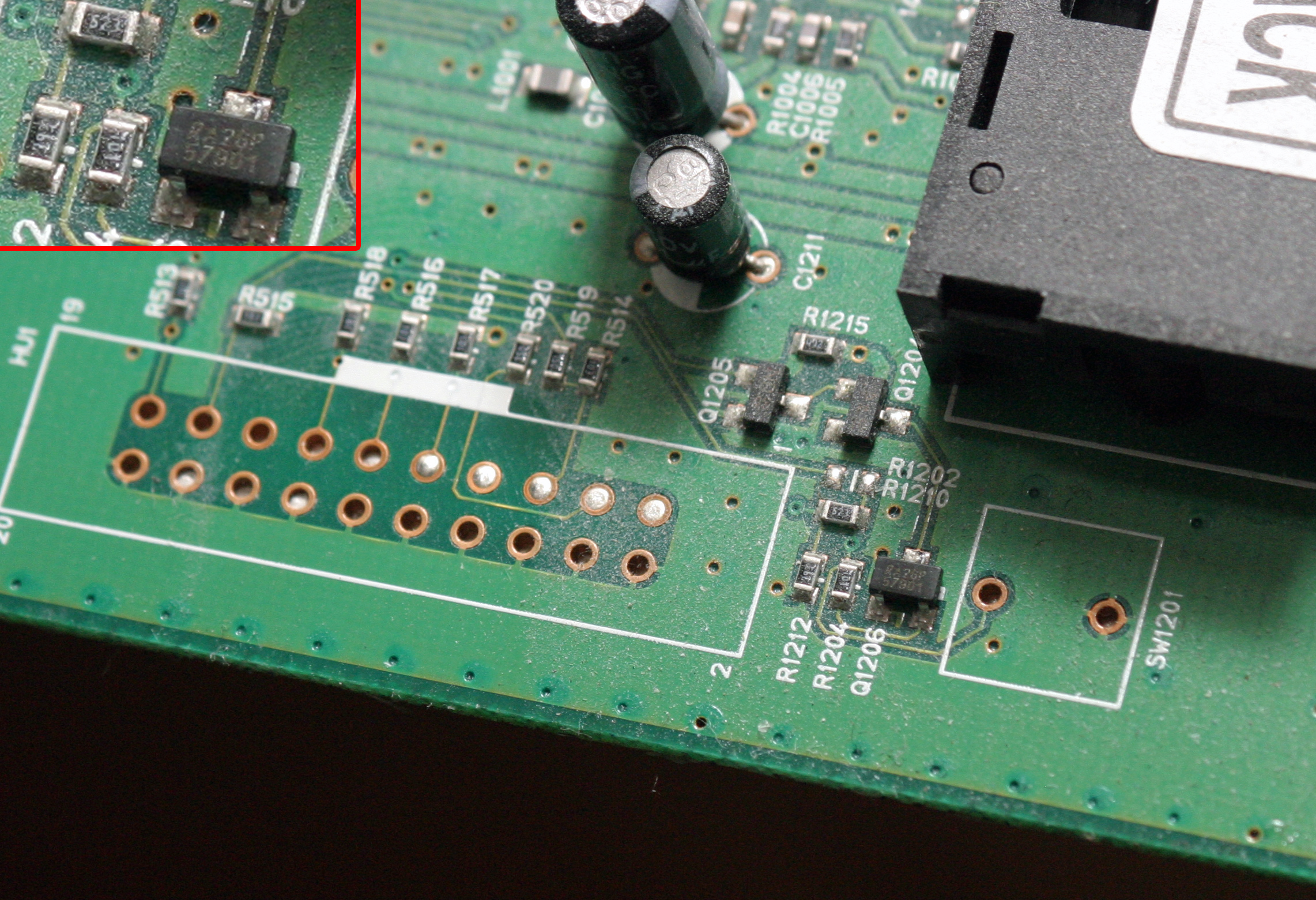

    Q1206
    Not sure what else it could be, could be the reset thing RA26P (sot-23).
    Gives .OL and 0.001V too.
    What else I should measure here, help is greatly appreciated!!

      • ComputerGeek
        • Oct 2011
        • 262
        Re: Samsung DCB-P853Z (DVB tuner/recorder)
        OK this is just an idea but have you checked the Hard drive in anyway? If it is going bad I could see it causing this problem. Just an idea it might not be a Component.
        • OniJon
          Computer Expert
          • Jun 2012
          • 82
          • Finland
          Yes, actually I took it out and it had few bad sectors which are fixed now in my computer by seatools.
          Ok. I changed the multimeter to my work one. The market one showed whatever it wanted at given time and it's hard to set to measure anything.
          U303
          AMC 1117 (sot-223)
          big tap = 1.23V
          GND = 0.00V
          OUT = 1.23V
          IN = 3.23V
          U1021
          KIA 78D25F (TO-252)
          big tap = 0.00V
          pin 1 = 2.51V
          cut pin = 0.00V
          pin 3 = 3.22V
          U1027 & [U1025]
          KIA 78D05F (TO-252)
          big tap = 0.00V
          pin 1 = 5.39V
          cut pin = 0.00V
          pin 3 = 5.04V
          U102 & [U101]
          M39100 (sot-223)
          big tap = 0.00V
          in = 4.92V
          center = 0.00V
          out = 3.27V
          Q1206
          RA26P (sot-23)
          pin 1 = 3.23V
          pin 2 = 3.23V
          pin 3 = 0.00V
          These measurements look just fine to me?

          • retiredcaps
            • Apr 2010
            • 9271
            As ComputerGeek suggested, your problem may have been the hard drive. You may want to reformat and reinitialize the complete system if the OS allows it.
            I agree.
