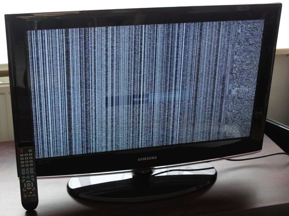

    Hi
    I have a chance to buy this cheap any idea what the fault could be?
    Garry
    Re: Samsung LE32B450 Fault
    Main board fault probably (seen it before here)... some of the boards for these tellies are made of unobtanium so take that into account. Could be T-con too.
      Thanks Tom
      Unless he halves his price I'll leave it alone.
          I thought £25 but he's now saying £50
            Not worth it just for a 720p 32". I would only be able to sell that for about £100 anyway. When you add main board or t-con cost there's not much profit. There are plenty more though.
