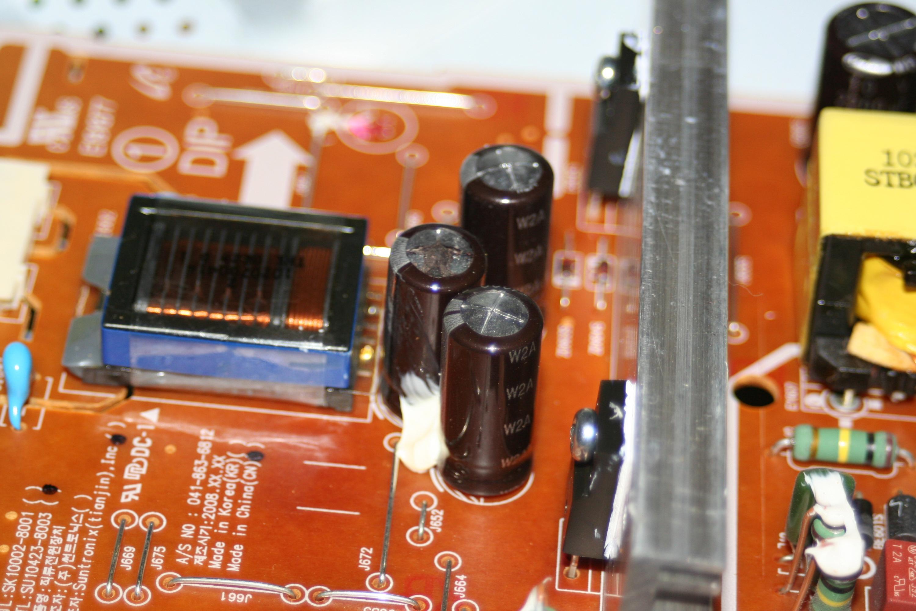

    Hello!
    Stumbled onto this forum and have been loving the information available.

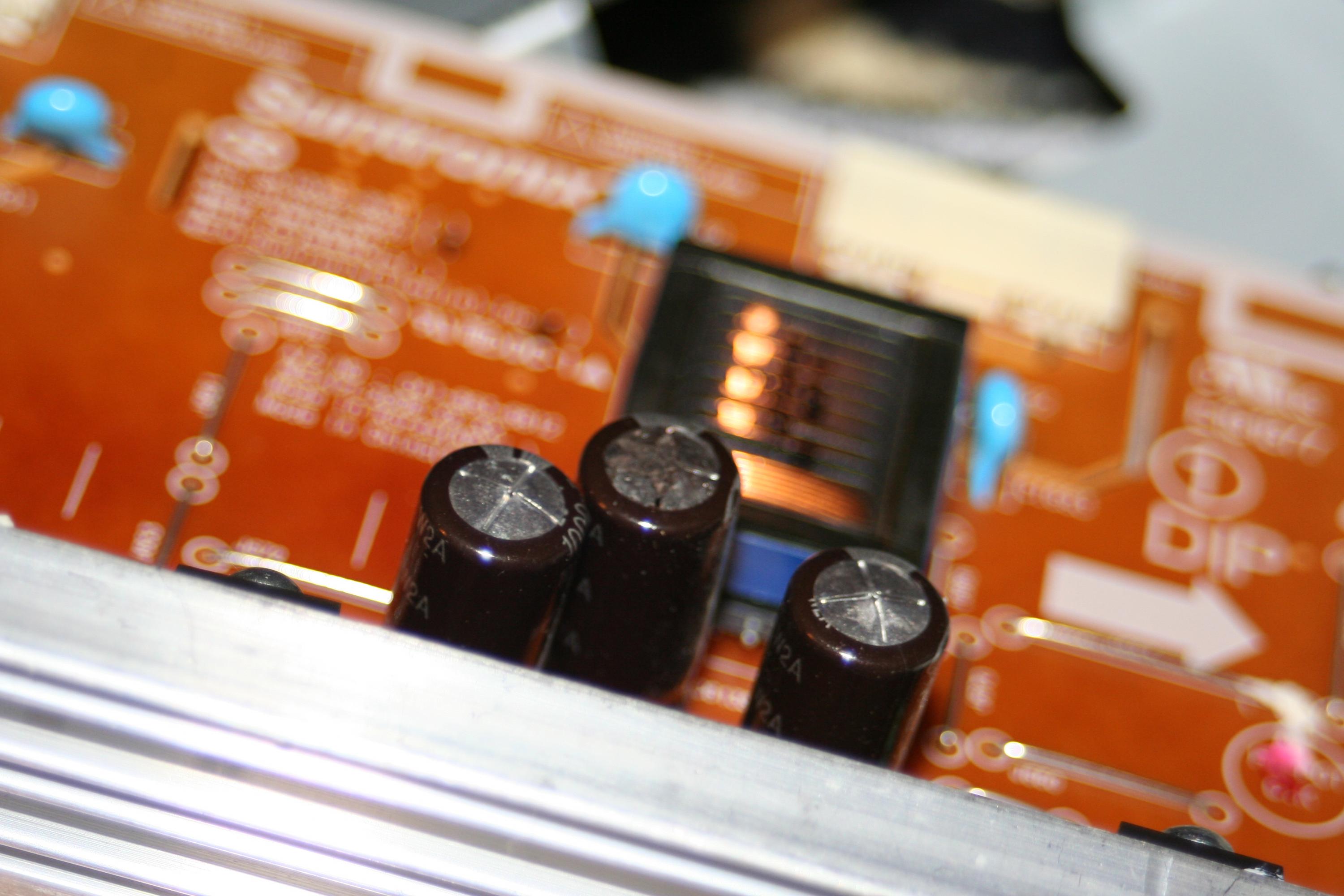

    I had a 40" Samsung needing to be recapped last summer and I completed it successfully. It got me hooked.

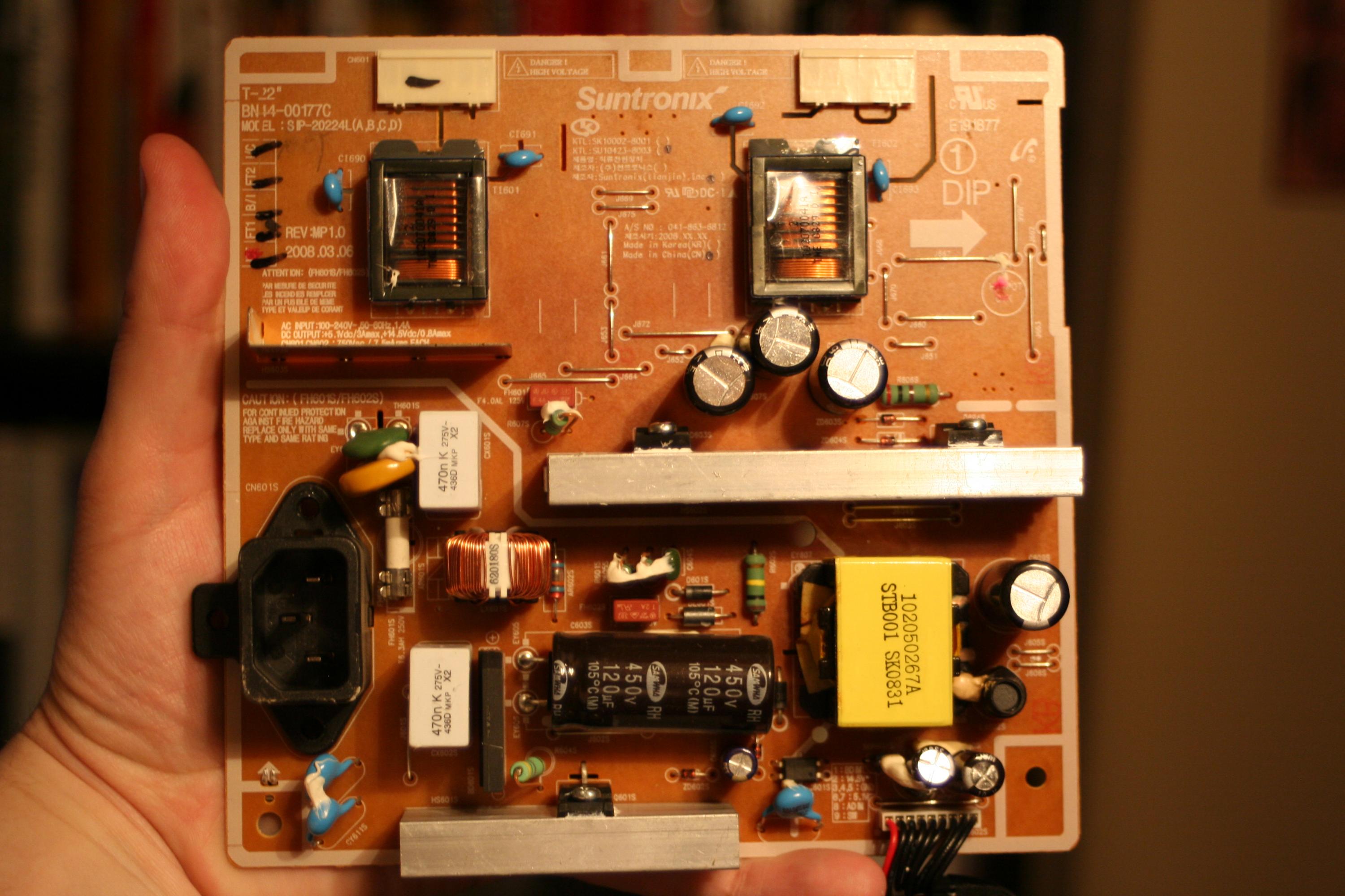

    I now have a T220HD that for sure needed to be recapped because I saw bulging caps on the power board. I replaced the group of three 1000uf caps and the one 2200uf with caps that had a slight increase in voltage. After replacing, it still behaves like it did before, which is that it powers on but the screen remains dark. It DID flicker my PC's desktop very clearly for a half second, which gives me hope.
    I will post pictures tonight, but I thought maybe someone might have some insight before then.
    Thanks for any help!
    -Keith
  • brillman
    • Sep 2012
    • 22
    Re: Samsung T220HD Recap

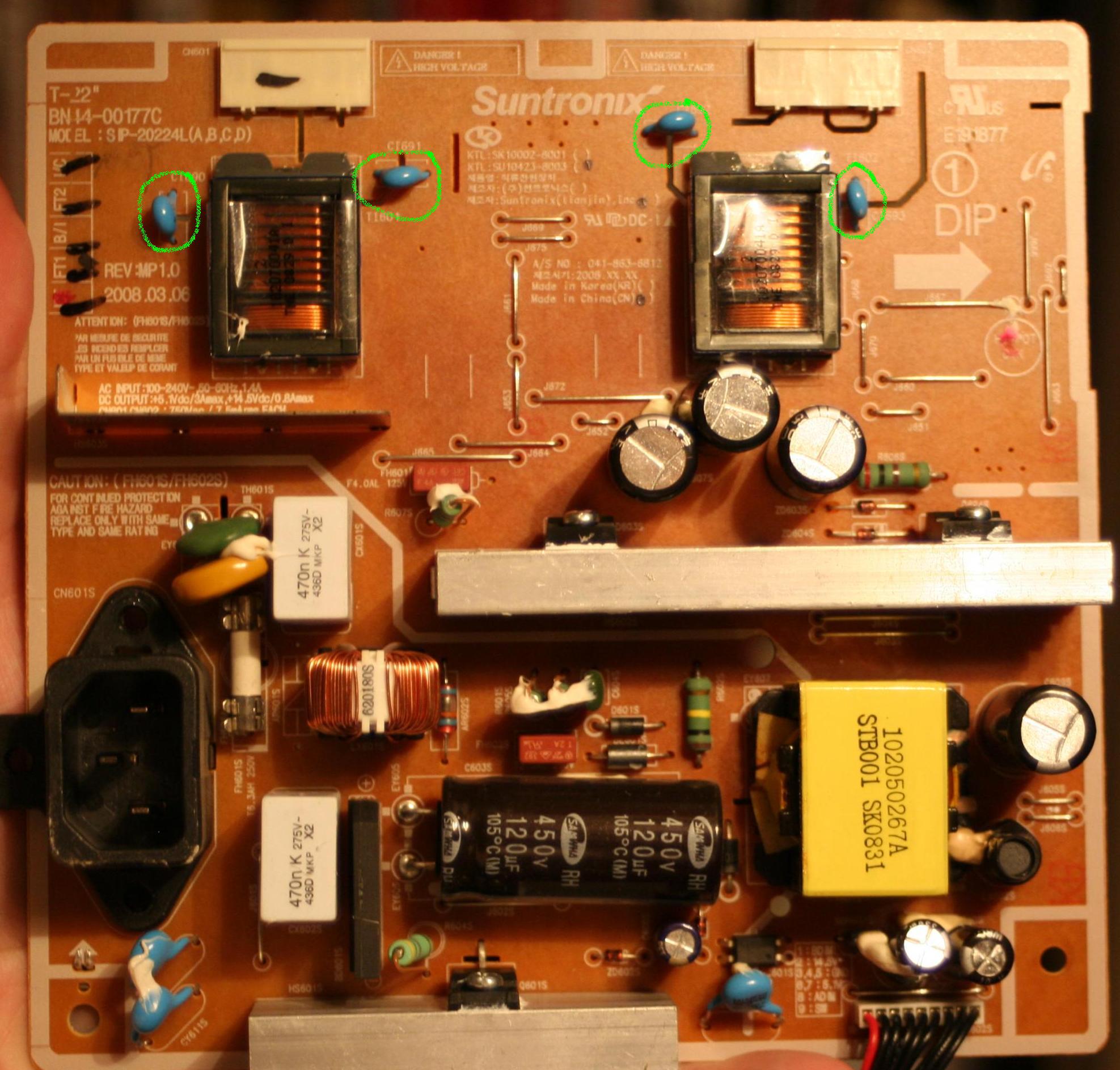

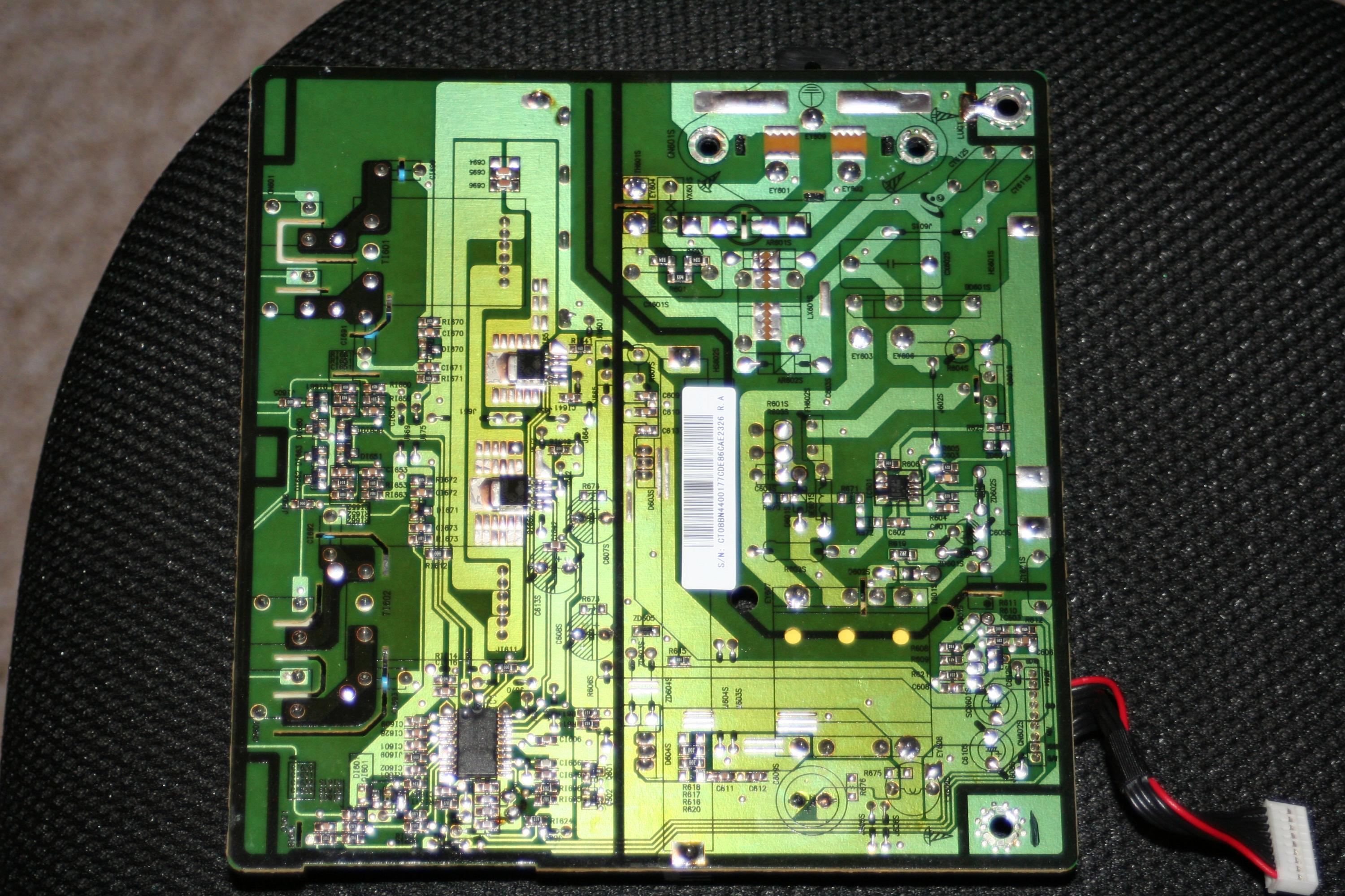

    As promised, pictures.
    Turns on, power led lights, but no picture. Image 3 and 4 are before I replaced the caps.

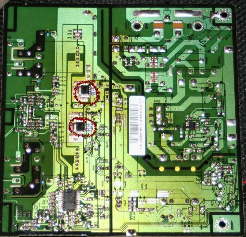

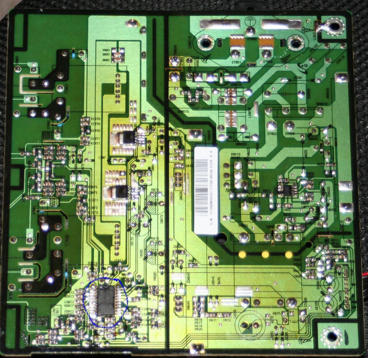

          If there is a brief flicker all the time, then I would see if the mosfets are shorted (circled in red).

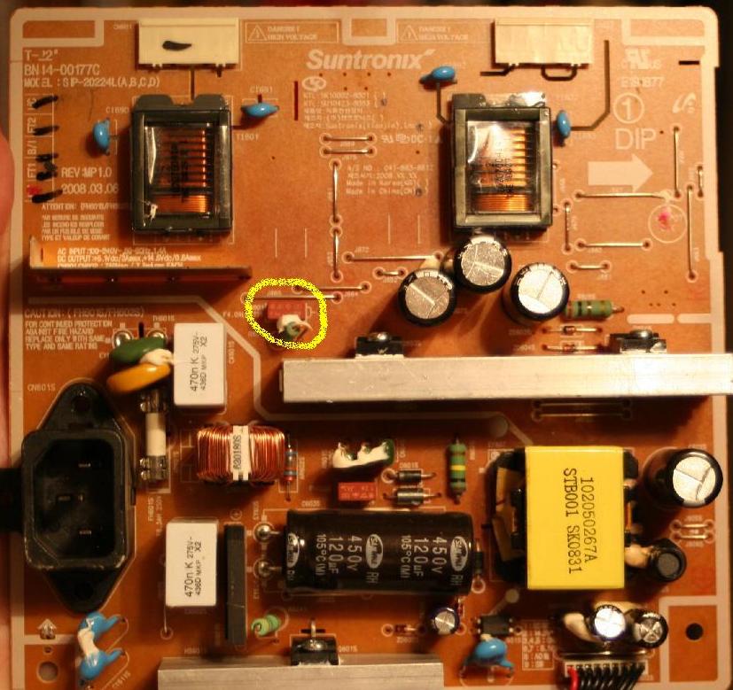

          If there was a brief flicker and nothing at all now, then check the fuse (circled in yellow).
            I am a beginner with these types of things. I assume using a multimeter to test, just on the continuity setting? And would I have to take it off the board to test it? Thanks for your help!
            EDIT: I tested it on the board and got a tone when testing.

              Recheck your fuse and additionally test the mosfet. Instructions in the appropriate section at

                Firstly, my multimeter is this model:
                http://www.iequus.com/Product/3310/H...MM-(10-MegOhm)
                Secondly, I think this is the datasheet for the MOSFET's in question:
                http://www.datasheetdir.com/AP4506GEH+download
                Finally:
                Fuse = 0.4 ohms (steady)
                MOSFET = 1 on far left side for all connections. Is this right?

                  1) Both the above readings suggest the components are good.

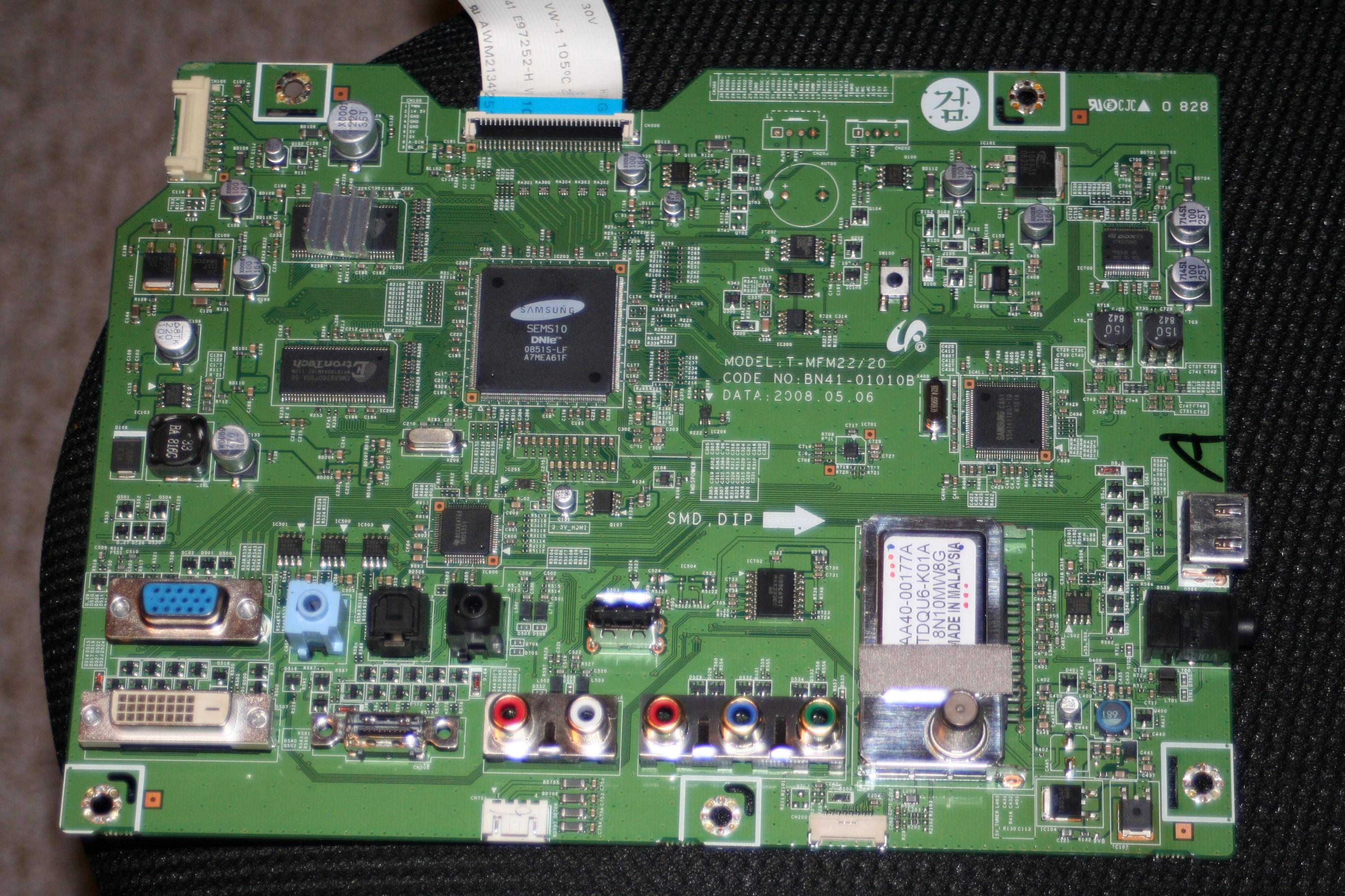

                    Again, because I'm new to this, how do I go about turning on the power board without reassembling the monitor? Or is there something I'm not getting about this procedure? Thanks for your help.
                    • retiredcaps
                      • Apr 2010
                      • 9271
                      Reassemble and connect all the boards. Just don't put the back cover on. Hit power button and take measurements.

                            Next tests.

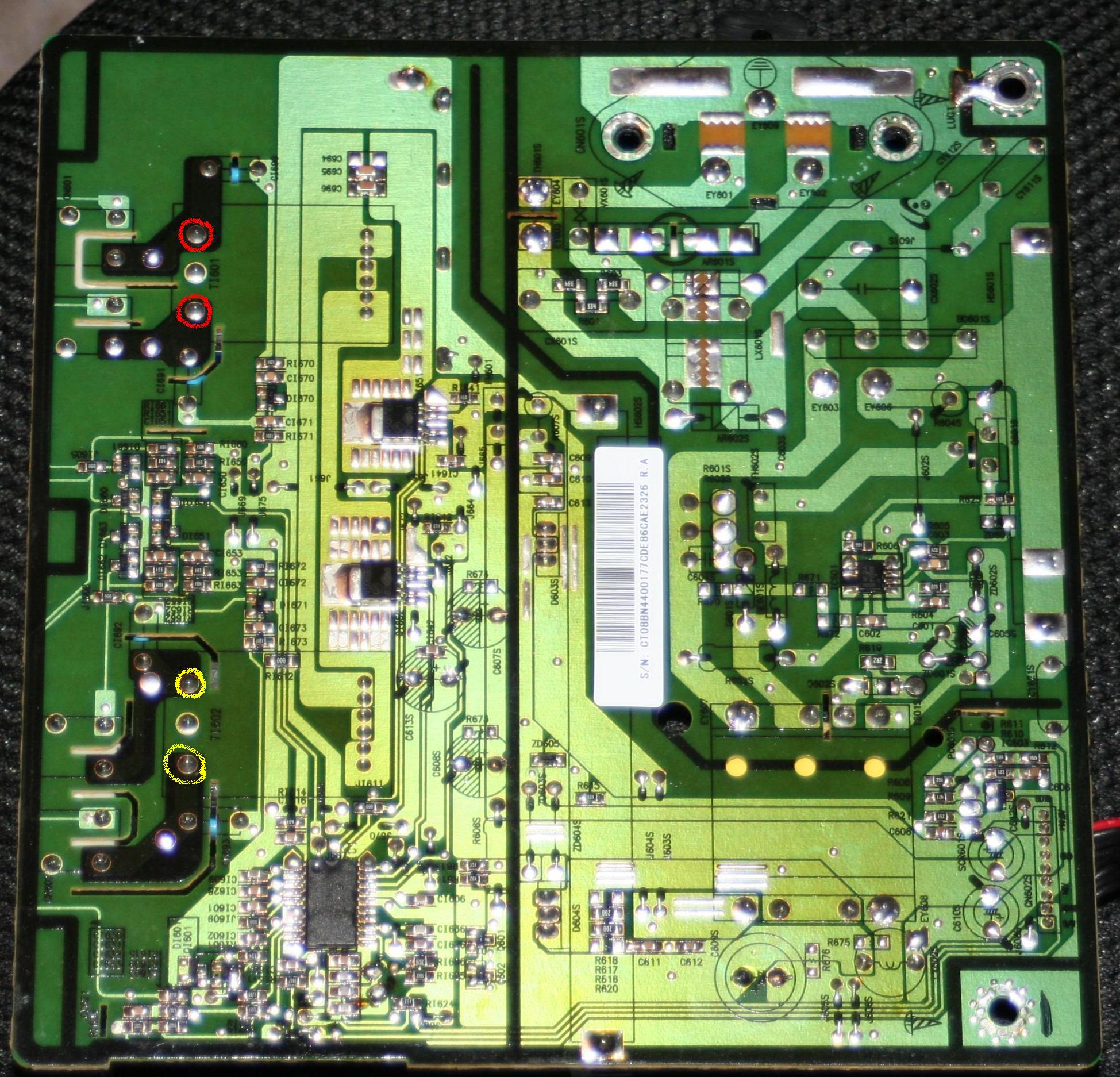

                            1) Power off and unplug lcd. Wait 5 minutes.
                            2) Put your multimeter to 2K ohms.
                            3) Measure the resistance between the 2 yellow dots. Report reading.
                            4) Do the same for the 2 red dots. Report reading.
                            5) Put your multimeter to 20M ohms.
                            6) Measure the resistance of the blue circled caps. The blue caps will have 2 legs each. Measure the resistance between those 2 legs. You should have 4 readings, one for each blue cap.
                            --- begin sig file ---
                            --- end sig file ---

                              Red Dots: 1.120
                              Yellow Dots: 1.124
                              All 4 blue caps read "1" on my multimeter at 20M.

                                1) What is the part number of the mosfet?
                                2) Can you list out the pin combinations that you tested?
                                3) What is the part number of the blue circled IC?

                                  Both the above readings suggest the components are good. The first test was the inverter secondary windings. The second test was the blue tuning caps.
                                    1. I read two numbers, but I believe this is the part number: 4506GEH (other number is 820038)
                                    2. S1,G1 | S1,D1 | G1,D1 | S2,G2 | S2,D2 | G2,D2 -- the one thing that was weird was that it appears the D1 and D2 were one large combined contact. There was no distinction between the two that I could tell.
                                    3. FAN7311
                                      Refer to
                                      for Fan7311 pinout.
                                      Report the DC voltage for pins 1-20. Since this IC is closely packed together, have a steady hand and sharp probe to avoid slippage and shorting out the IC. Use a ground screw for ground (black probe).
