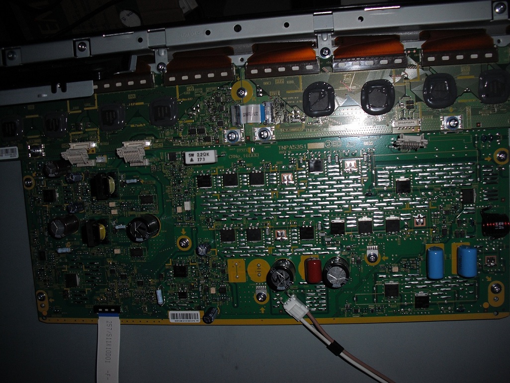

        her pic of board. sorry took so long, flakey camera!
          Re: panasonic TC-P50S30 50 inch
          Test for a short on the SC across where the brown and white wires would go, with the connector unplugged from the SC.
          Note buffers may get power thru those screws, seen it a few times!

            thanks tom will get pawnshop to bring it back over an give it a test! with the loop enabled an all other boards disconnected it still flashed error! been reading service manual on it! of course they say it not repairable!
              Surprising for Panasonic to say that, but I have heard of the plasma panel going short circuit between lines. Unplug buffers to confirm.

                    they ordered an installed an sc board an still same flashes! except this time when i isolate it from the su/sd boards i don't get blinking led! so last sc board was bad! so any way to test an isolate what is wrong on the sd/su boards or easier to just replace?
                    an they was no short at that point tom, will ask for old board so i can test it too!
                      You can run it with one SU or SD, then jump SC50, for half a picture.

                          tested both an still get 7 blinks! will have them order both sd an su boards! thanks tom

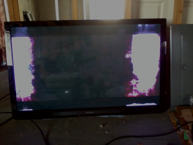

                            Got the same TV and found the SC board was shorted. I replaced and TV powers up but picture is funky. I'm sure I'm not the first, so should be easy for you guys to point me to what now needs replacing. I have attached a picture. Basically pinkish blue on both sides with a dark ghost image in the middle. Thanks in advance.
