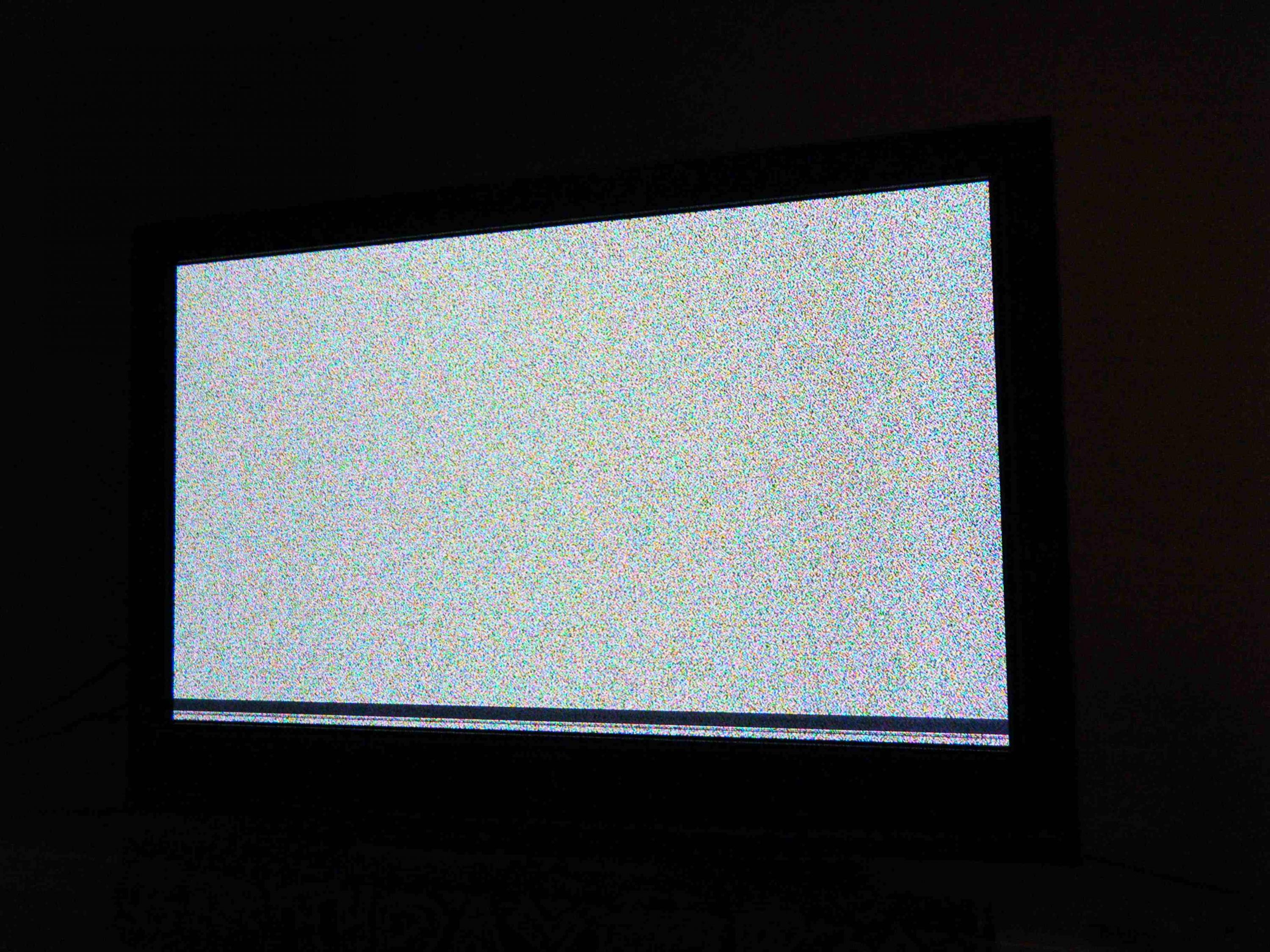

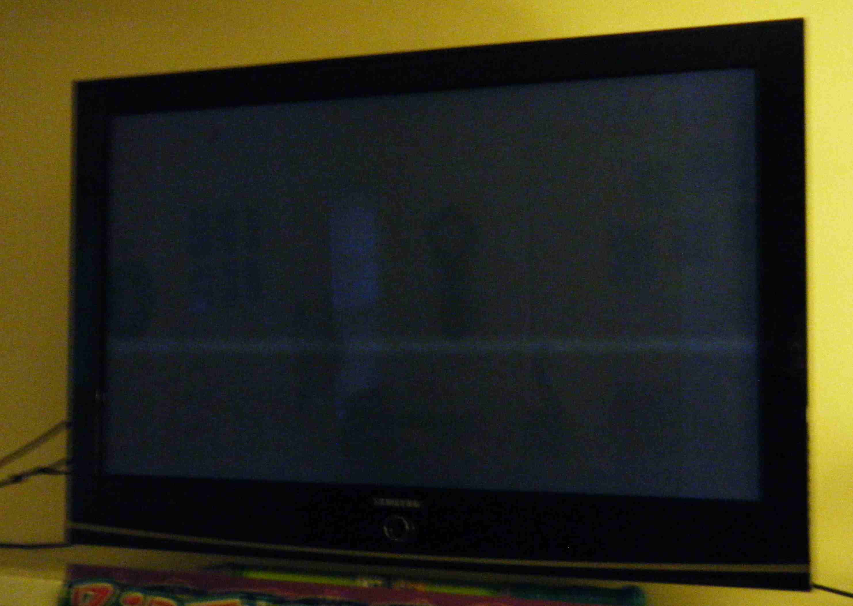

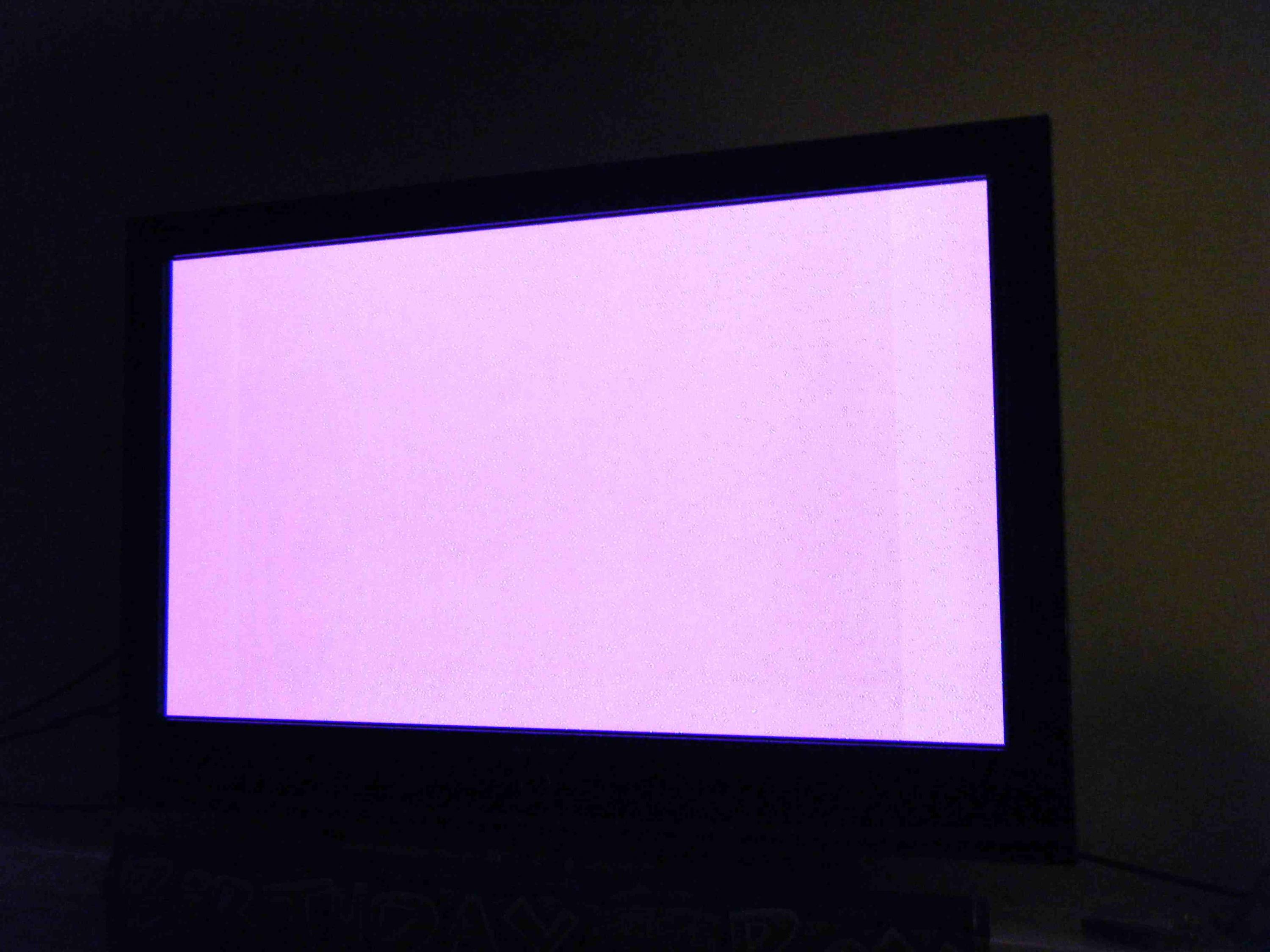

        Ok, here are some pics.
        I managed to pause a show in between the commercials, so the screen was black. You can see the white fuzzy stripe, and it just slowly climbs upwards.
        I took two pics of the HDMI issue, one when the screen flashed pink, and another when it showed some random garbage.
        Its almost like the video processor is crashing, and then showing junk on the screen.
        Also note the burn-in on both sides of the screen
        Sorry if the pics are a bit blurry, our living-room doesn't have much lighting in it, and its dark outside now. And to make it worse, the TV is very bright, so the camera has a hard time focusing.

          Looks almost like a Y-buffer problem, but possibly bad caps too.

                        The reason I said it looks like a Y-buffer issue is that graphical glitches such as repeating patterns can sometimes be caused by a bad Y-buffer. A Y-buffer is responsible for driving the whole line and with correct timing; if it gets confused you will get noise on the screen.

                            Probably bad caps then or some other video controller issue.
