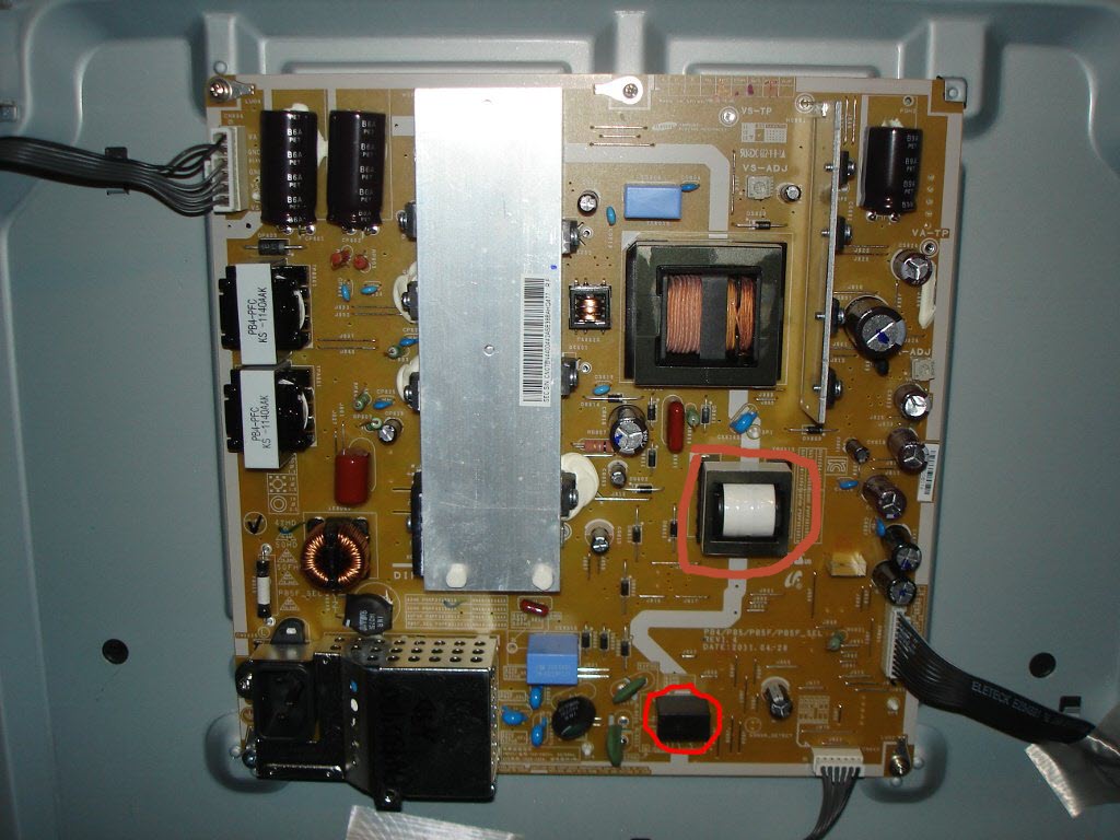

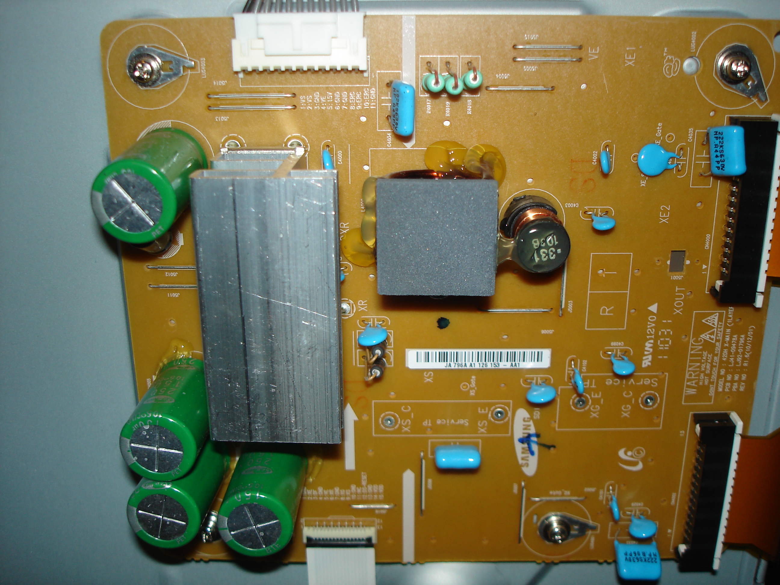

    I am working with a Samsung Plasma PN43D450A2D, which was given to me by a friend. One night he was hit with a surge that took out this TV, the Comcast STB connected to it (via HDMI), and 2 other Comcast boxes in the home - a pretty bad surge!
    The TV has no sign of life (red indicator, etc.). With the back removed, I could hear a humming/clicking coming from the power supply - on a hunch I purchased a new power supply/board, however that did not correct the problem. When applying AC power, it will still make the humming/clicking noise, but that's it.
    I'm defintely a novice when it comes to TVs, and I was unable to find a wiring schematic or any information for repairing this TV.

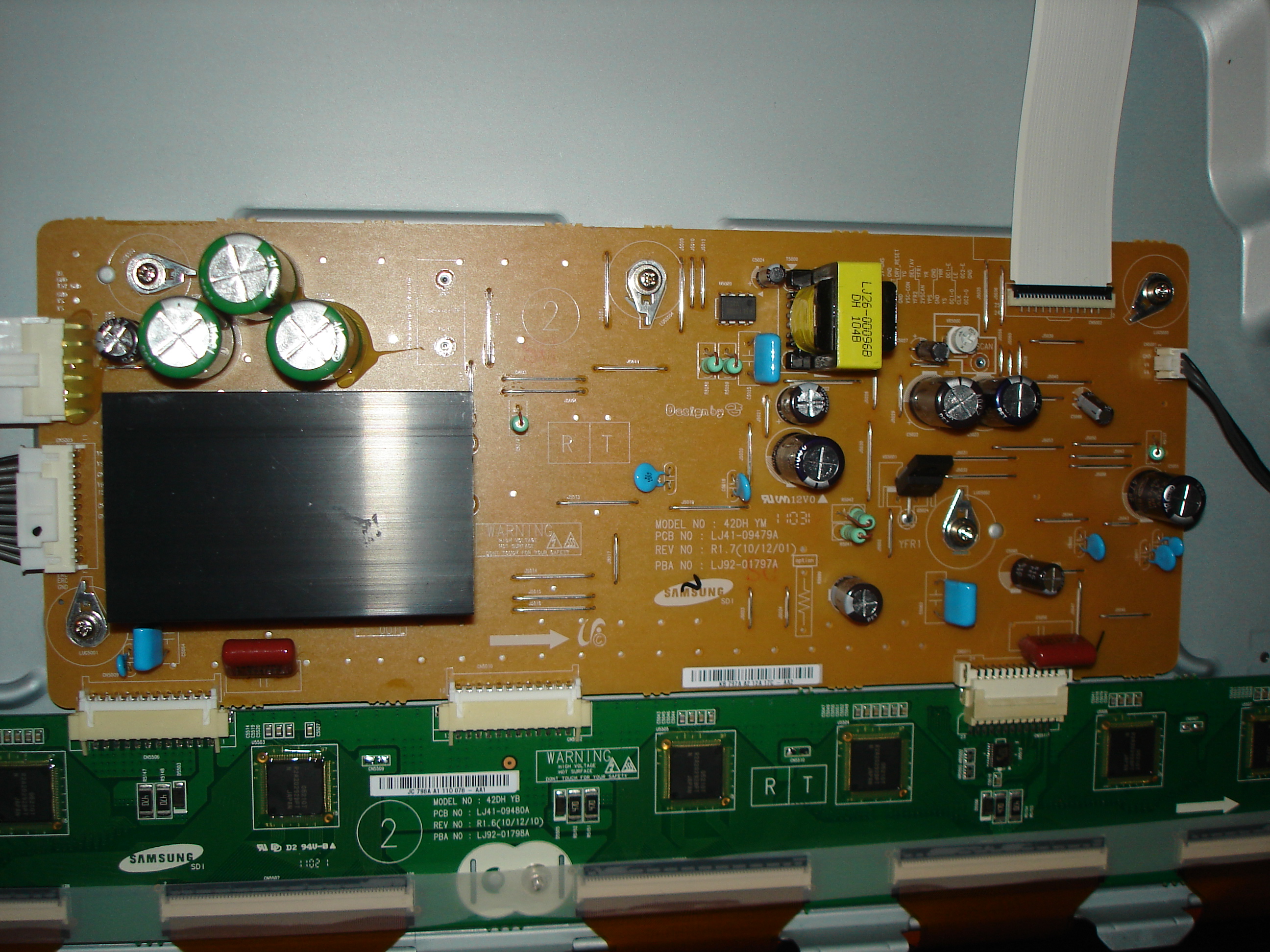

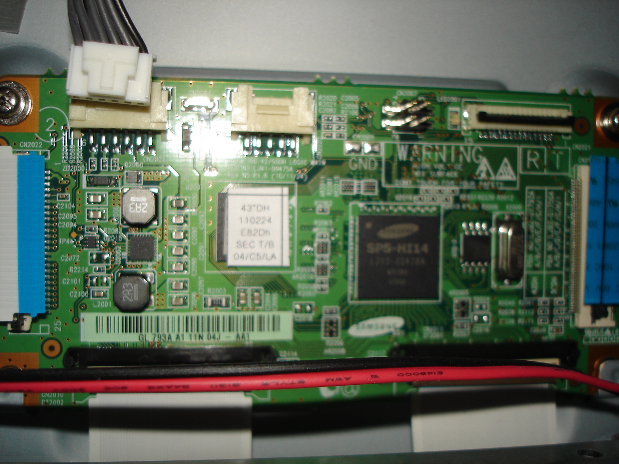

    For reference in the pics, SUS1 is the main SUS that is connected to the power supply. From there, SUS1 daisy chains to SUS2 to provide power to that SUS. There is no direct connection from SUS2 to the power.
    Sorry, I know they are considered YSUS and XSUS, but I honestly don't know what that means or which is which
    I'm pretty handy with a multimeter, and my father is very good with them and basic electronics repair, so I can troubleshoot whatever is required. Additional/more detailed pictures can be taken if needed

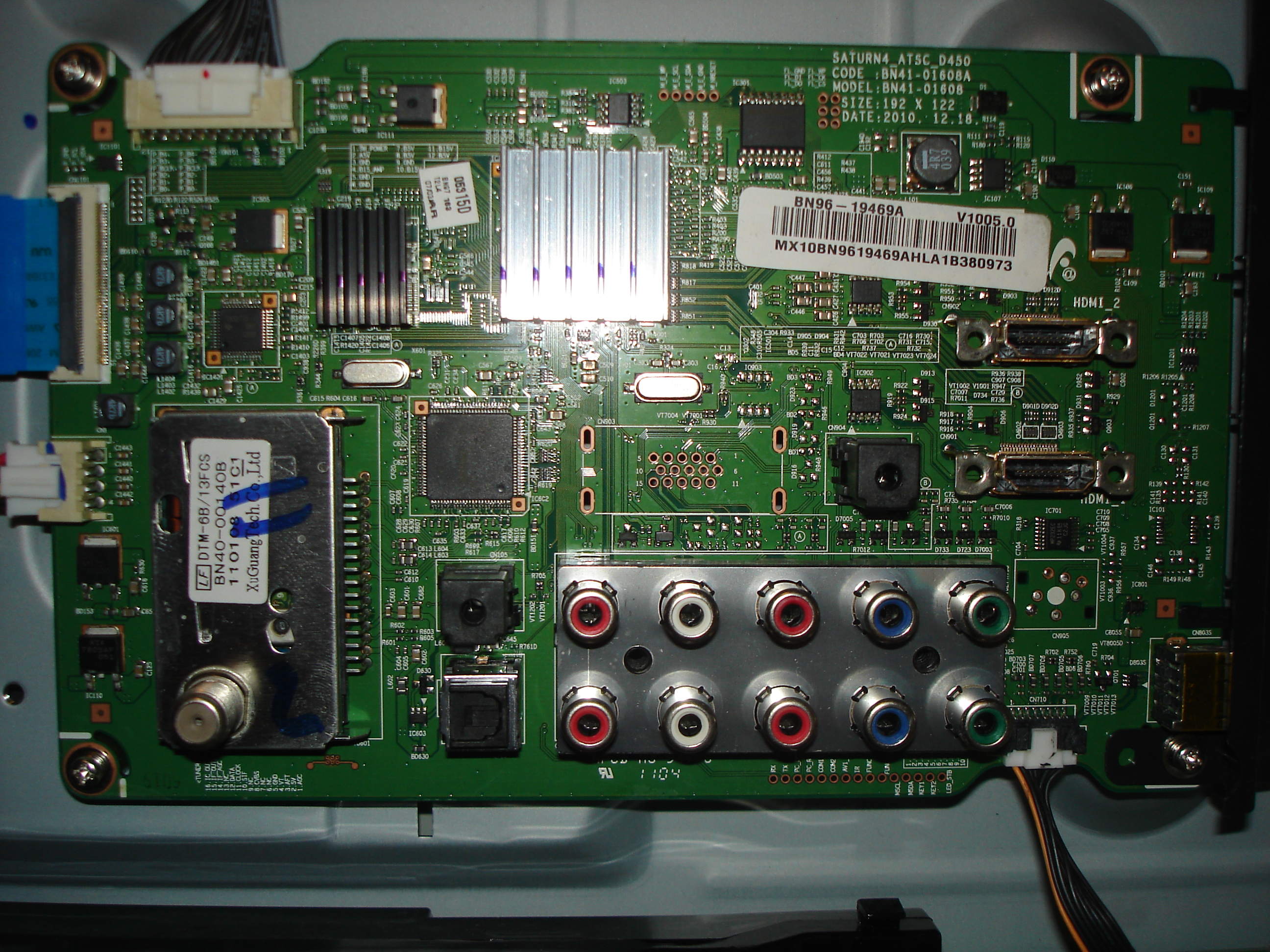

    note: I know on the mainboard a few connectors are disconnected - I did that during troubleshooting (making sure all were tight) and didn't reconnect prior to this picture.
    Any assistance will be greatly appreciated!!
    Re: Samsung PN43D450A2D

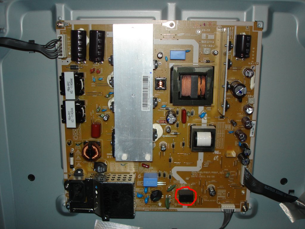

    Does a clicking sound come from here?
    A common issue is unrelated to surge damage. The two transistors under the large heatsink on the power supply can get cold solder joints.

      I listened to both the new power supply, and the one that I presumed was defective. The component making the buzzing noise (on both of them) is the white transformer marked in the picture.
      This transformer will only make the noise when the AV "input board" is connected to the PSU. The noise isn't present when any other components and/or none are connected to the PSU.
        That's the standby transformer. Buzzing can come from some transformers if they are working.

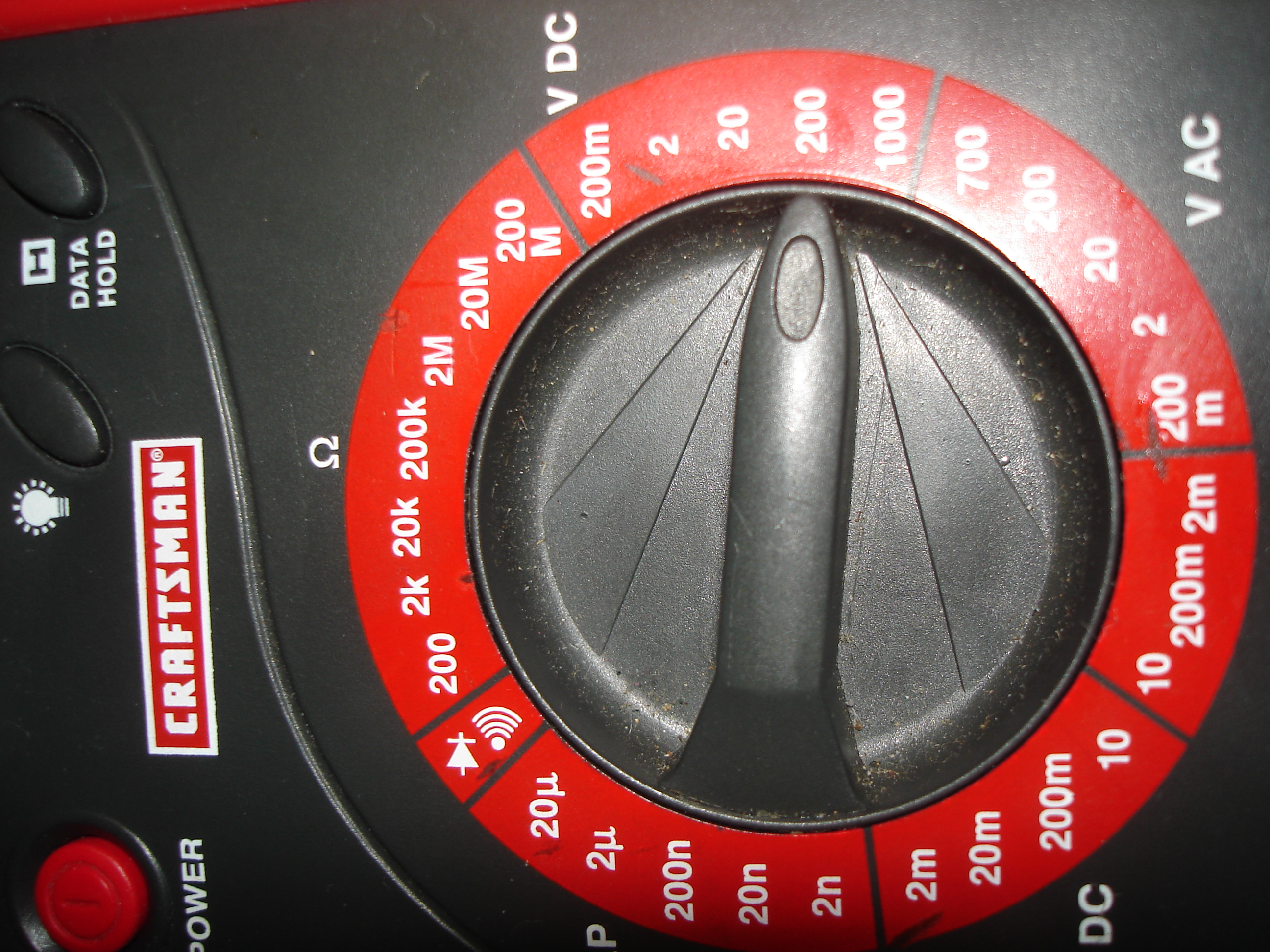

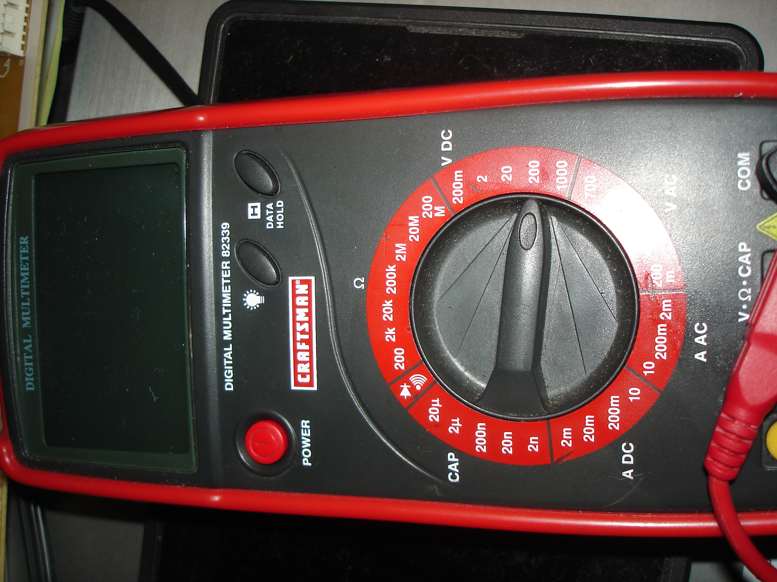

          I do - here is pictures of the DMM I have - from reading, I know you all like pictures
          If this one isn't sufficient, I can swing by a store and pickup one based on your recommendation.
            That's a good multimeter, no need to get a new one.

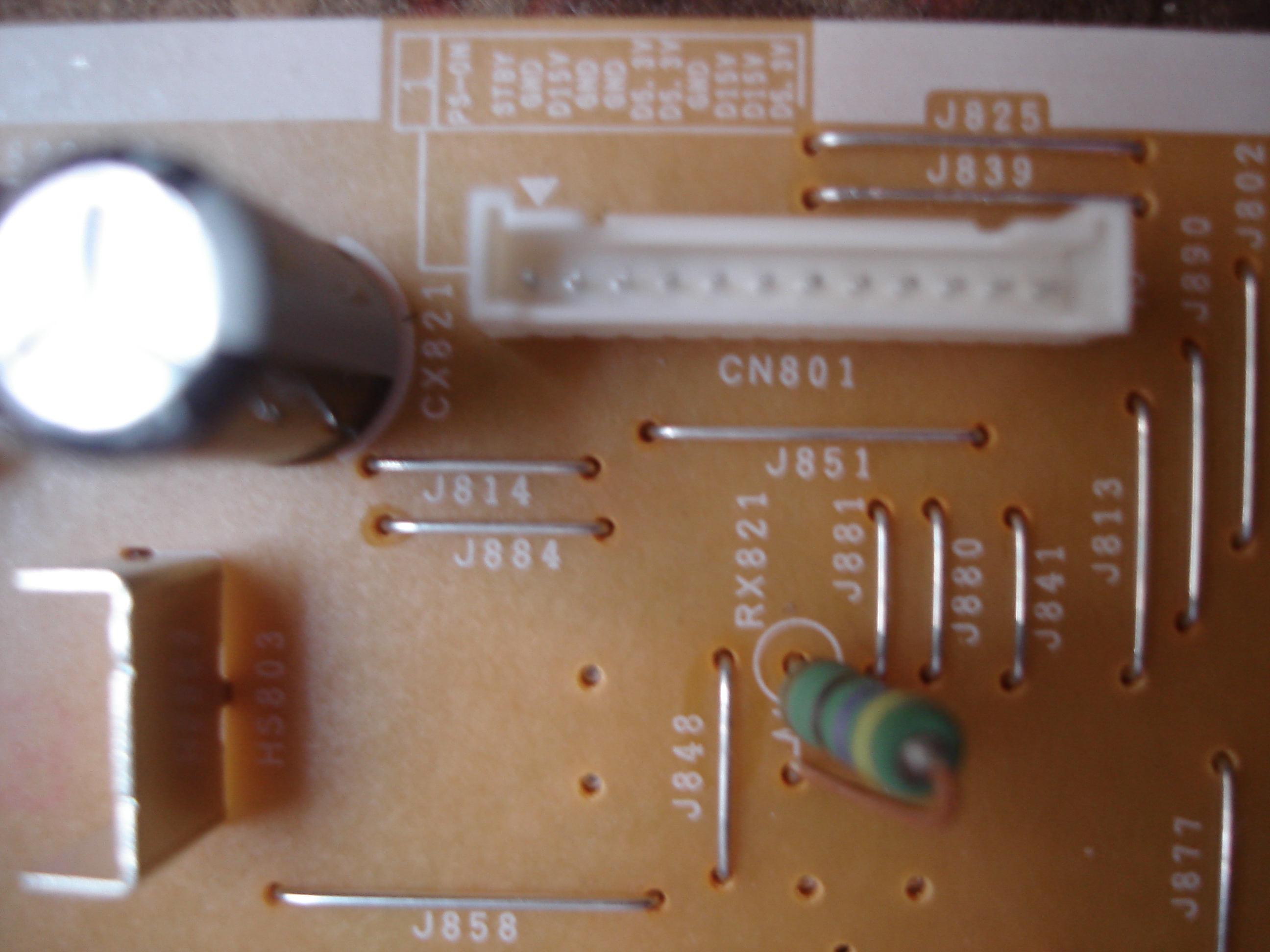

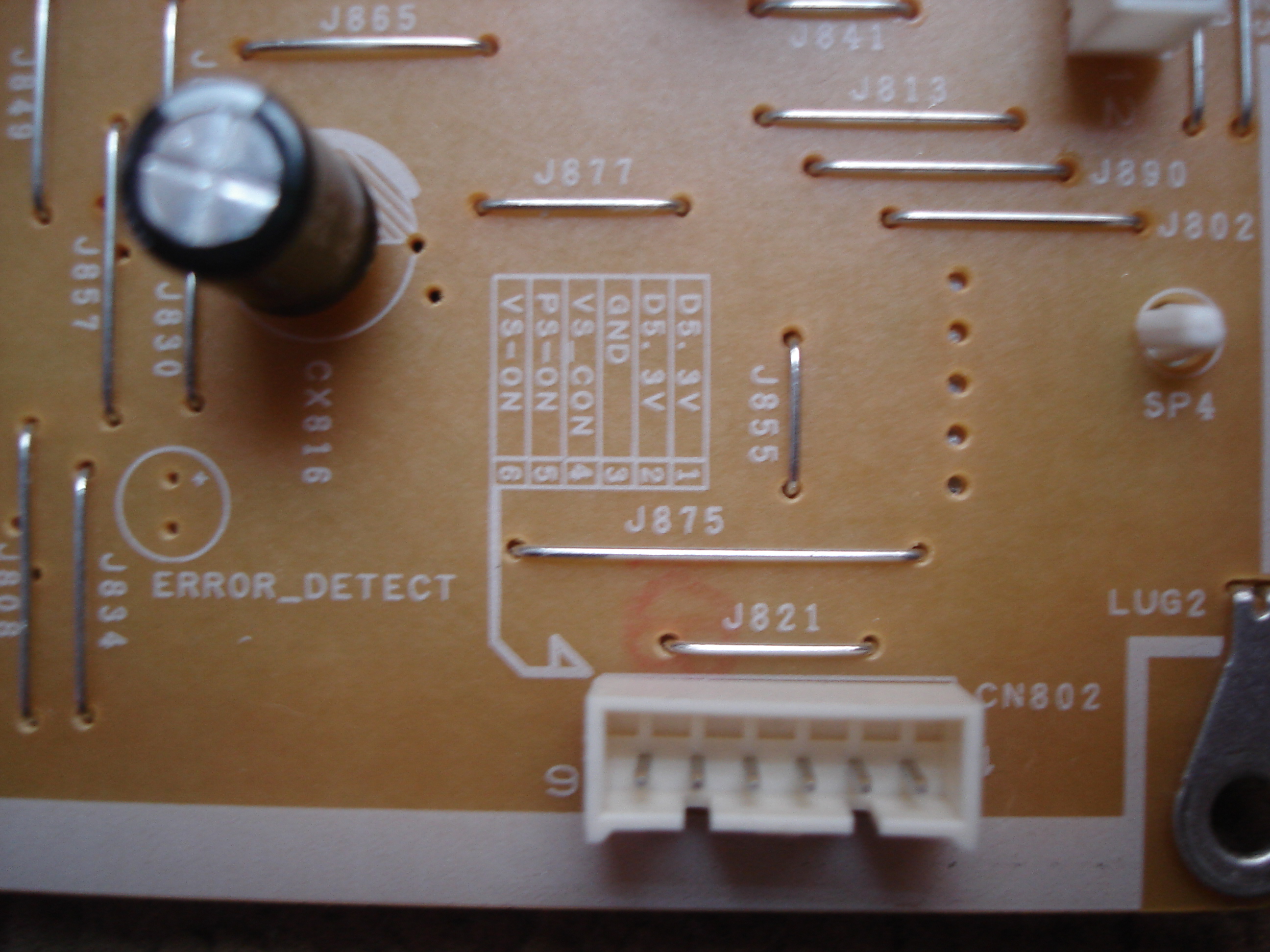

            Can you post a closer picture of the connector going from the power supply to the main board - there are some labels next to it which indicate what pin does what.
            • crashp3
              • Mar 2011
              • 81
              Glad to hear it's a decent DMM - Craftsman quality has seemed to go down in years.
              Attached are (3) pictures.

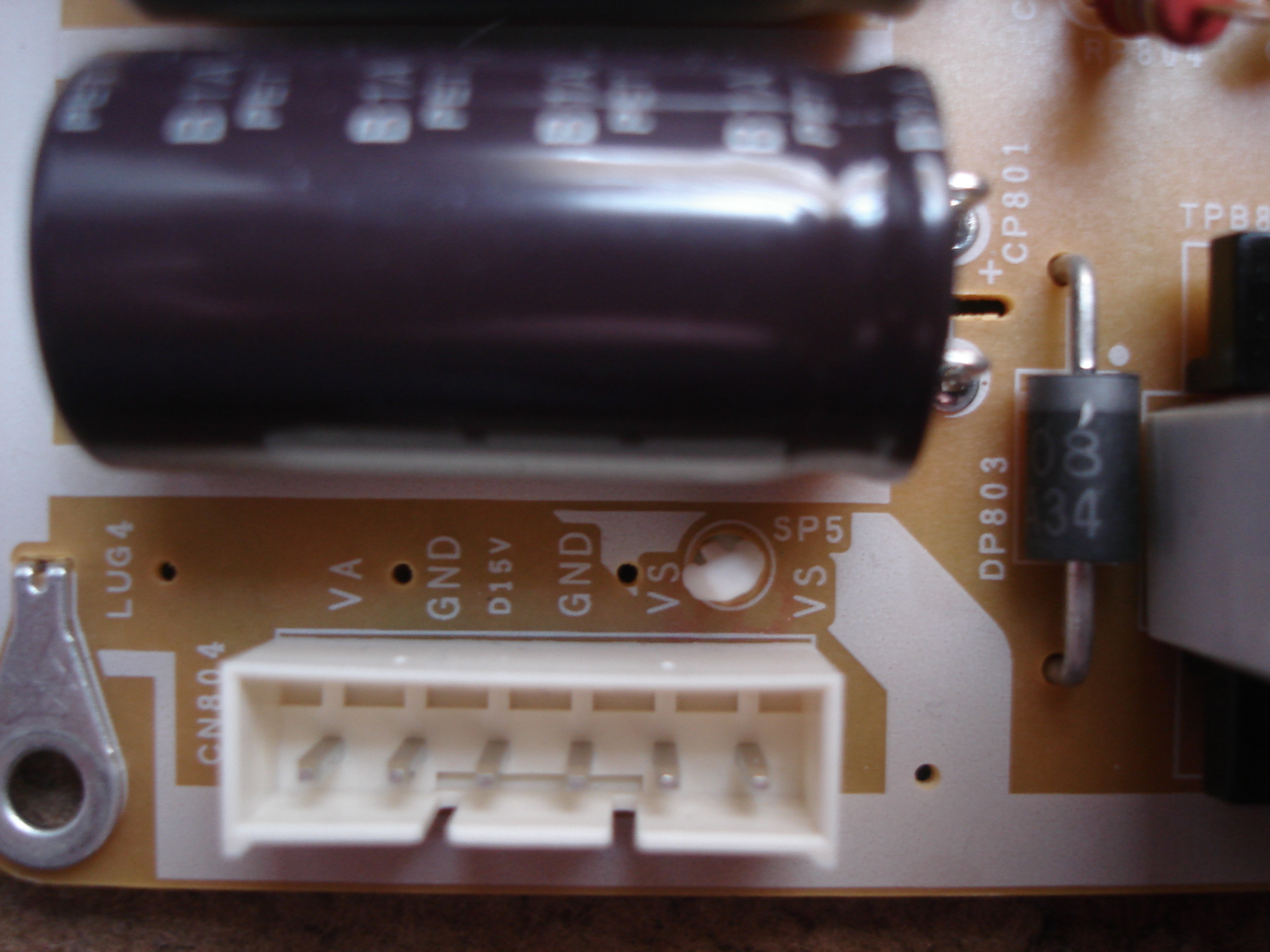

              CN801 -> Connector to the "av input" board
              CN802 -> Connector to the board labeled "main board" in my original post (2nd picture)
              CN804 -> Connector to SUS1
              CN801 didn't turn out very clear, so here is the pinheader silk-screen information, going from left (pin1) to right:
              1- PS-ON
              2- STBY
              3- GND
              4- D15V
              5- GND
              6- GND
              7- D5.3v
              8- D5.3v
              9-GND
              10-D15V
              11-D15V
              12- D5.3v
              Please let me know if the pictures aren't clear enough. It's overcast today and getting good macro shots is tough without good sunlight - for me atleast.
                Okay, check the STBY pin.
                - Multimeter on DC 20V
                - Black probe in frame of TV (spare screw hole, wall bracket, etc.)
                - Red probe on metal part of STBY pin
                Voltage should be around 5V.

                          Does the TV power on if the main board is plugged in but the PDP T-con is disconnected? (The PDP T-con is the small board which interfaces with the main, Y sustain and Z sustain boards, as well as the X buffers.)
