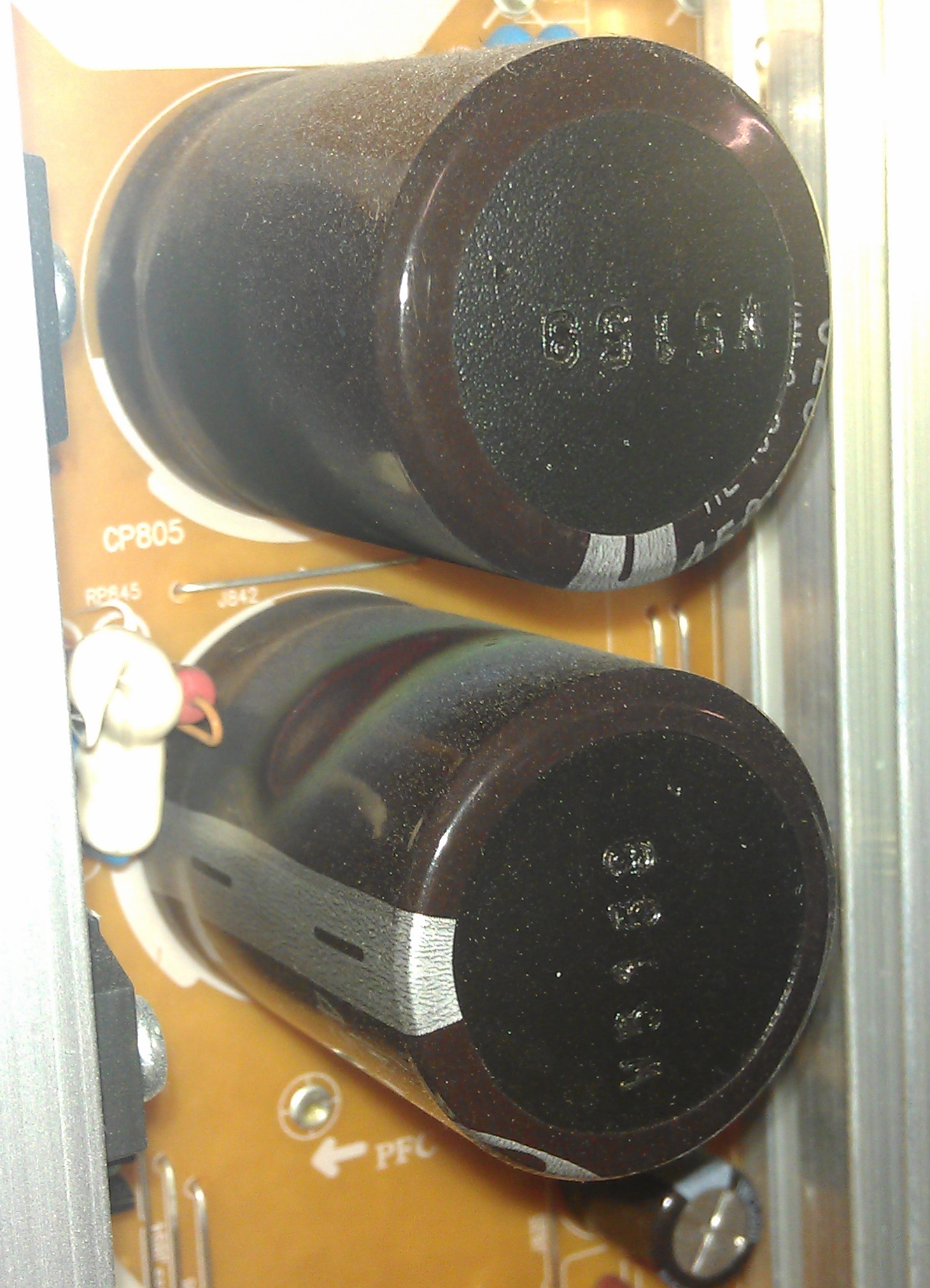

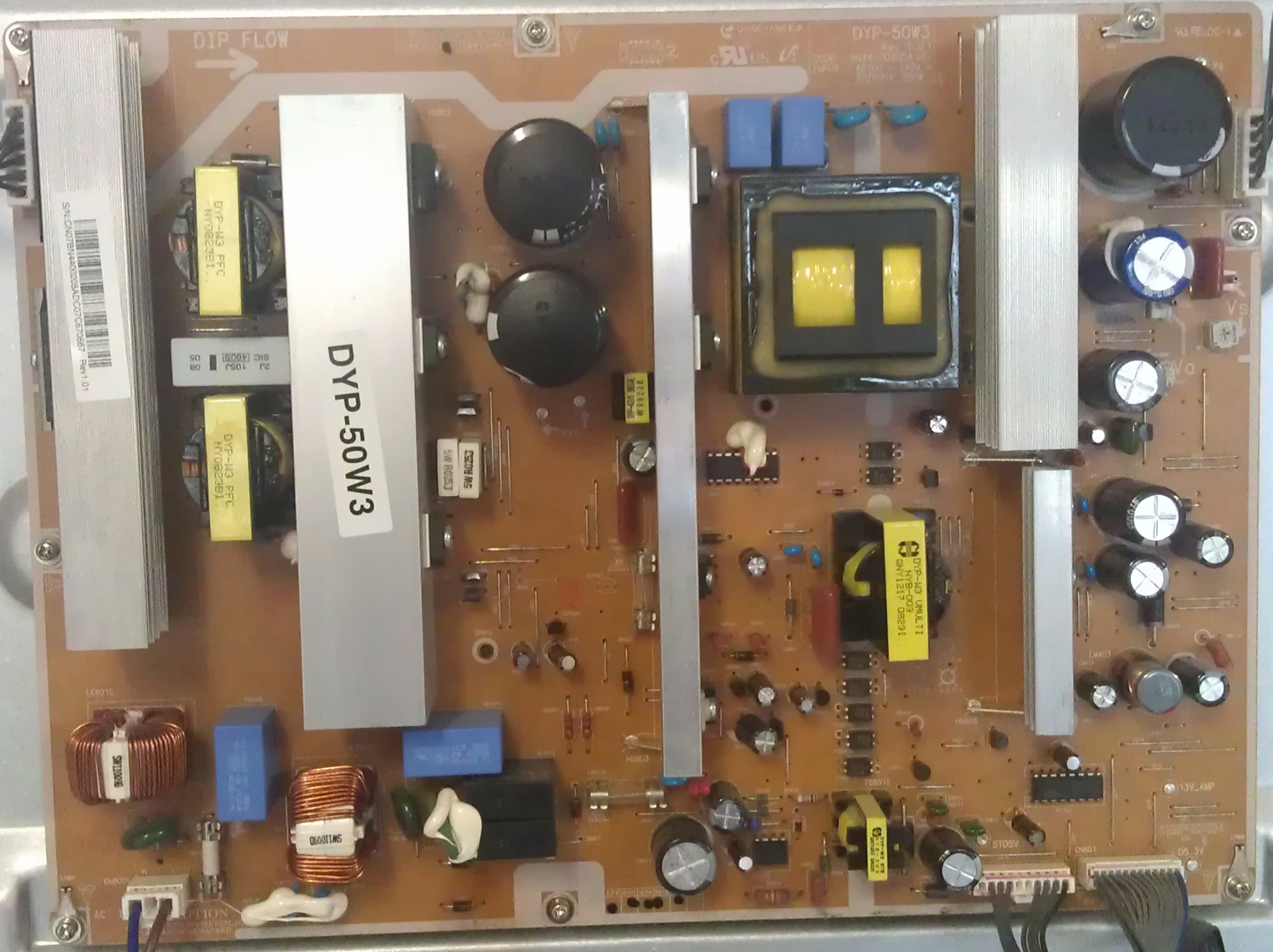

    Hi all. Trying to put to use my electronics diploma (which has sat idle for 10 years). Thought I would try my hand at fixing some plasma's.
    To get to the point I have picked up a Samsung PS50A410C1D. On 1st inspection the main fuse on the power supply is blown and the 2 larger capacitors on the board are clearly fried.
    I plan to replace the fuse and capacitors and see how I go. Any recommendations to a TV repair novice?

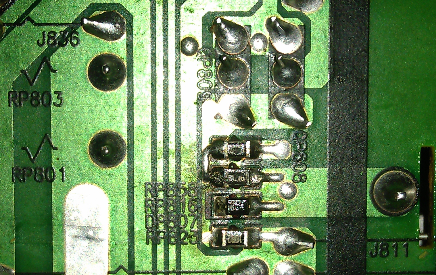

      Update: On the bottom of the board found a bit of burning on some surface mount components. I'll add that to the other items to check and replace.
        Re: Samsung PS50a410
        It is normal for the capacitors with a plastic disc on them to have the disc pop up after time. If you remove the disc to reveal the vent, does the capacitor still appear bulged?

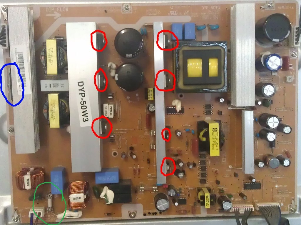

        See attached.
        The blue circled device is the bridge rectifier. Mentally number the pins 1 to 4. Check continuity between each pin. In general, no reading should show under 0.5V except across the two outer pins, if a device further down the line is shorted.
        The red circled devices are power MOSFETs probably (although one or two may be the PFC diodes.) If they have three legs, check between each and every pin both ways for shorts (<0.2V on diode test.) If it is a two legged device, just check both ways (>0.5V on diode test.)
        I see there are several fuses on the board. Which one of these blew?
            Thanks Tom. That should help me substantially. The caps are definitely gone. There is visible burning on the side of at least one of them.
            I am still hunting down a circuit diagram so I can identify what the components were that burned.
            The only fuse that went was next to ac input. (circled in green) Other fuses show continuity.

                The burning on the caps, is it potentially from a nearby component blowing up? (not uncommon with power electronics!)

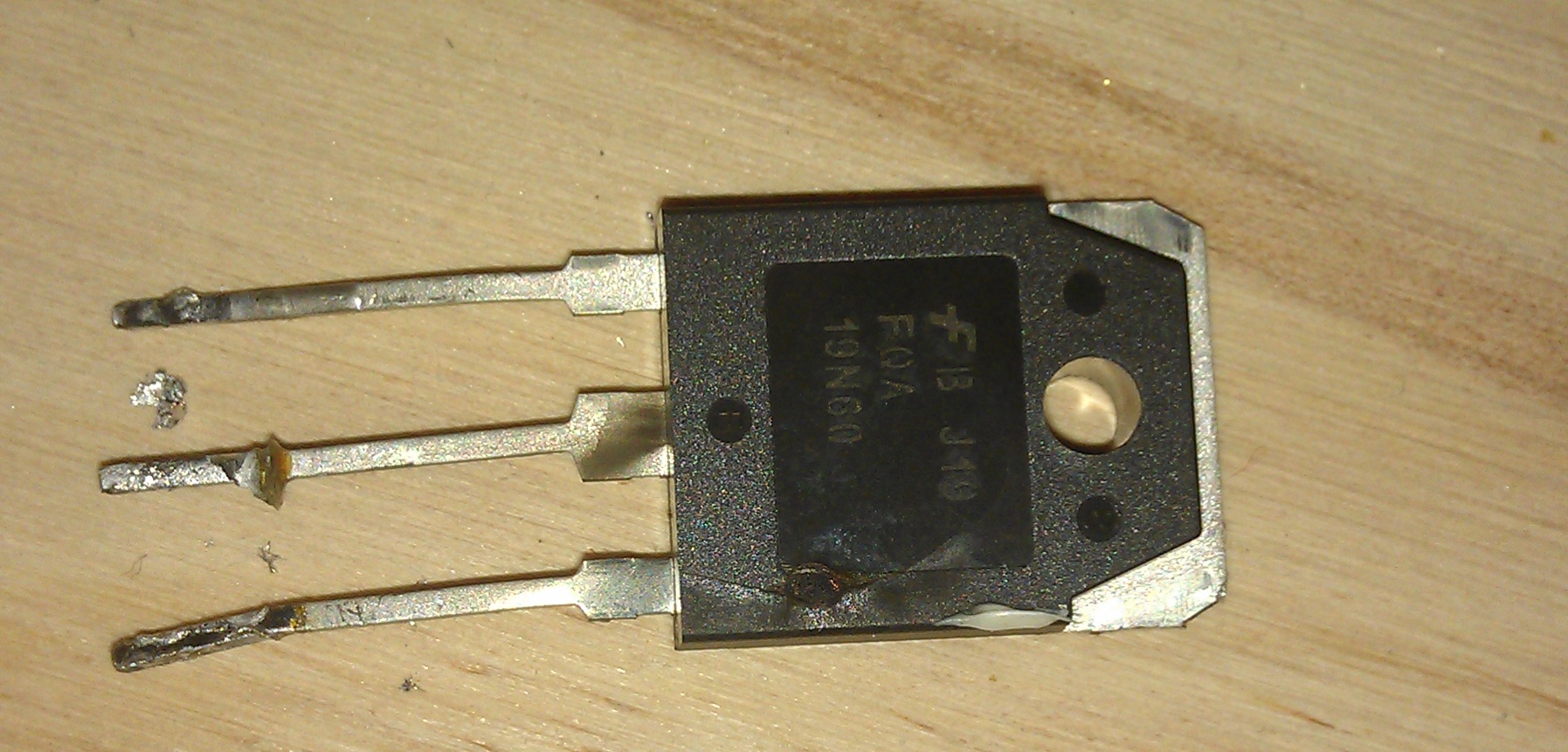

                            On closer inspection qp801 looks damaged. I'll remove it and do some measurements.

                              Found the culprit. Had to remove the burnt looking capacitor to get to it. Short on pins 2 to 3. Pin 1 is open. It also linked directly to the surface mount resistors that are looking burnt.
                              And you were right Tom. The burnt capacitor looks like it might be fine.

                                  A MOSFET is more tricky, because some other components are often damaged when it goes short circuit (usually the gate resistors). However, you do have a schematic, which is very useful when repairing these, so it shouldn't be too difficult... Can you post a picture of the damage? I suspect the PWM/PFC IC will also have been damaged by this.

                                    I posted a photo of the burned resistors in my 2nd post. It shows damage to rp858 and rp816. Let me know if a better picture will help.

                                      I couldn't find a 19N60 in stock at digikey, but I found an equivalent part.
                                      MOSFET: http://search.digikey.com/us/en/prod...63-5-ND/654637 (20N60, handles higher current)
