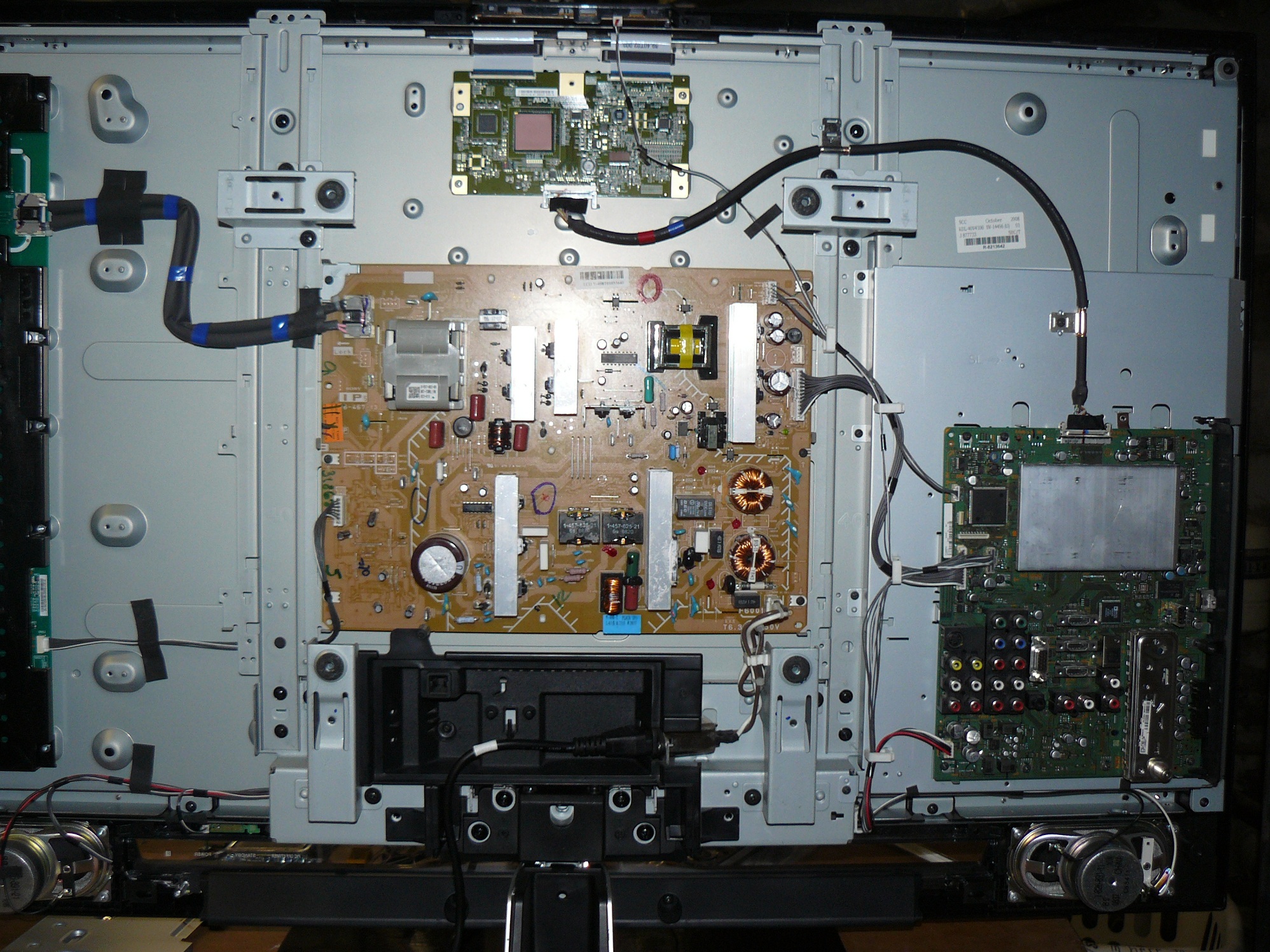

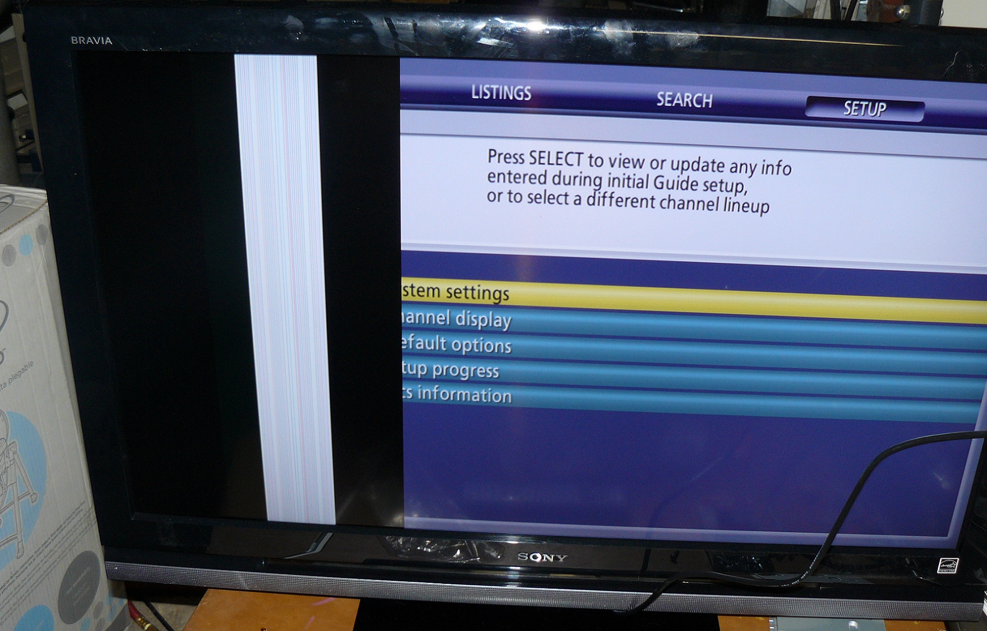

    This is a co-workers tv. When i first turned it on about 3-4 inches on the far left side was black with a few multicolored lines in it kinda like a bar code. If i pressed the menu button you could see some of the menu box, atleast what stuck out beyond the black. I wiggled the tcon cable as suggested in budm's sony tcon pdf to see if a change in the screen would happen.
    But here is the odd thing. When i wiggled the cable to get a reaction (which it did), the whole tv just shut off and then turned back on (rebooted). I had a wtf moment and now i am not getting any display at all. Audio is still present. I checked the fuses on the mainboard and they all test ok. The fuse on the tcon board is good too. BUT, i am not getting 12v to the tcon from the mainboard.
    So, in a nutshell is the tv even worth looking into considering it had the black on the left side. I remember reading a couple posts that this is a common failure among these tvs (lcd panel).
    The voltages coming from the power supply are all spot on. If anyone has had any expierences with the KDL tvs please post your story.

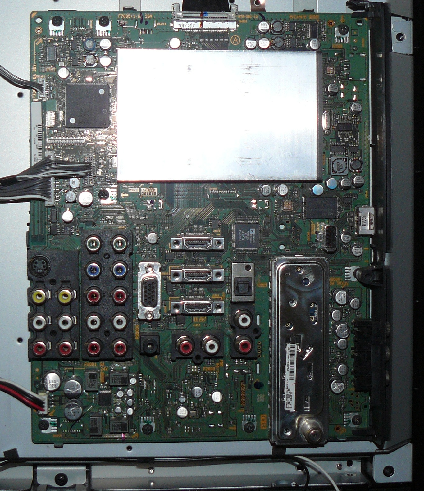

      I double checked all the fuses front and back of the main board and they are all reading good. Can you explain the resistor and wire trick?

          Well i rechecked the fuses and i missed one
          Put a blob of solder over it and i'm atleast back to square one. I'll look into the wire and resistor fix. Does this seem like a candidate for it?

              Re: Sony KDL-40V4100 no display
              The 32" is the most common model that gets the ghosting / darkness issue that is fixable by the 10ohm resistor method. Im the first person to ever try it on a 40" and it worked to fix my kdl-40s5100 (made in 2009).
              The symptoms are ghosting across the whole screen and a darker picture then normal (but this is hard to tell as many of these sonys have issues with the dyanmic contrast enhancer)
              One thing ive noticed is if you ground any of the voltages created by the tcon it will shut off. So most likely your twisting the tcon grounded a voltage.
              Getting lines on the screen could occur from a bad tab bond (similar issue to the one the resistor fixes), but it could also be other things like too much pressure being applied to the screen / bad tcon). I think usually lines from a bad tcon have a pattern (see budms pfd on common tcon failures).
              Yours is missing such a huge portion on that side that id say your whole tab on that side is disconected. Do you know if anyone else took the tv appart to look at that tab? though heat can loosen one compleatly by itself. You dont risk much taking the tv completly appart except your time. Its a fairly light 40" tv too, so hopefully wont break your back taking it appart.

                I disassembled the whole screen this morning and the tabs are all connected. Pushing on the tabs does nothing.
                The tcon is:
                T400HW01 V5
                40T02-C06
                The panel itself is a AU Optronics. Took me almost 35 minutes to find one that the seller actually had one in stock ($49.95 ) I am hoping but i'm not holding my breath.

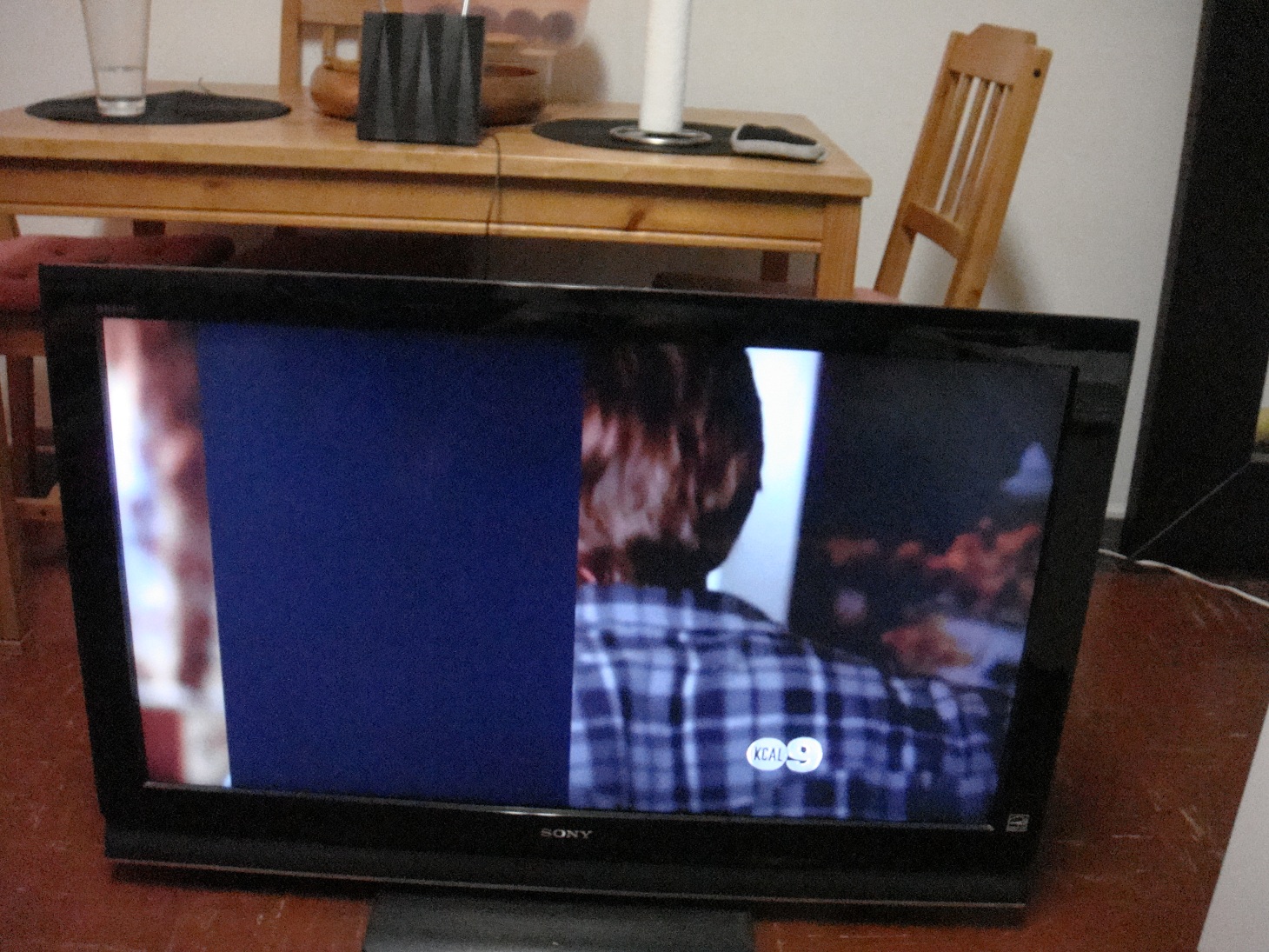

                  That Sony that I have started asking about a while back(same model as yours), reappeared on craigslist with a 8" wide solid black line close to the middle of the screen.
                  I would like to know myself what is this to know if it's fixable. Not sure to pick it up or just let it go.

                    The person sent the picture:

                      I had a chungwa or samsung panel as far as i could tell, deffinetly not an AUO. AUO is pretty high quality and isnt responsible for either of the faulty tab bonding issues common with sonys.
                      I think these ones with the large stripes missing might have bad resistors on the tabs, ive never had to do that repair, but theres a common repair like that. Ill try to find a video or more info on that when im home.

                        it almost looks like when do you disconnect one of the ribbon cables, but doesn't go out half of the screen. It can't come from the T-con?
                        • cashkennedy
                          • Aug 2011
                          • 668
                          Im not 100% sure, but if you look at budms learn about tcons page (and its pdf from sony on detecting tcon failures) there is a picture of what happens if one of the tcons drive output fails (you get a stripe every inch or so (probably every 100 pixels or so, so around 19 of these thin 1 pixel stripes) This makes me believe that the tcon output channels handle the data for every 20th column and not a whole chunk in the middle.
                          And as i said these failures with huge stripes missing are almost always are from a part on the thin boards along the edge of the lcd, or a part mounted on the tabs.
