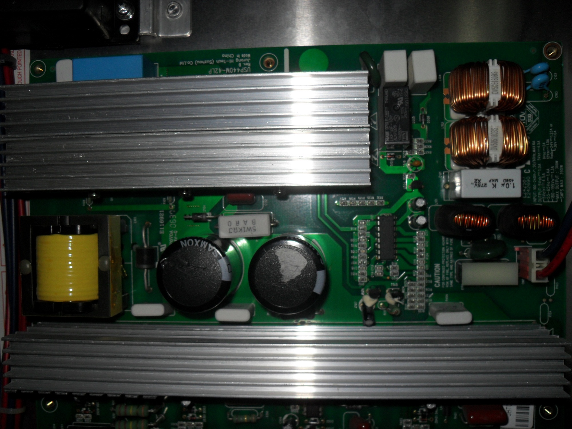

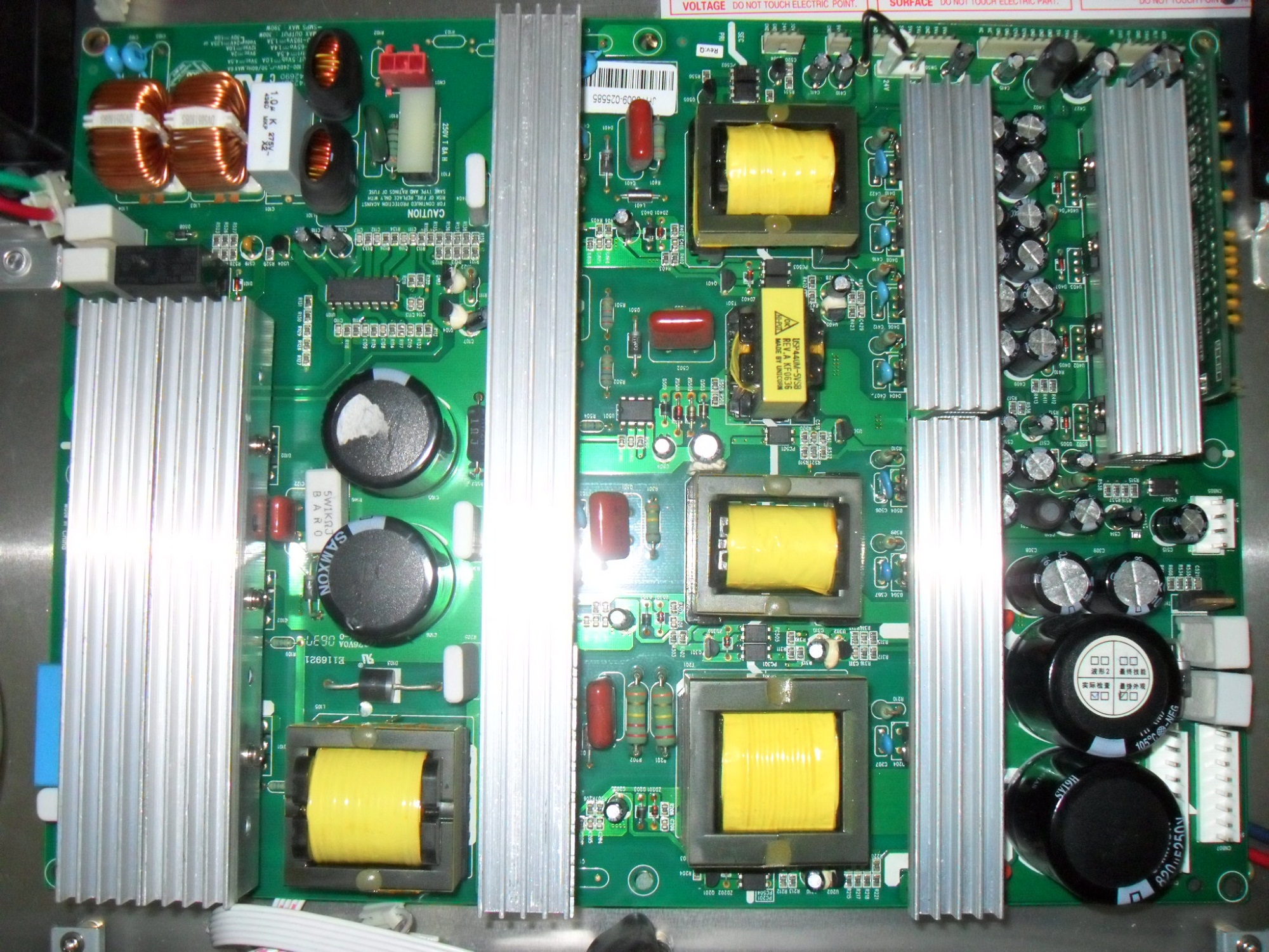

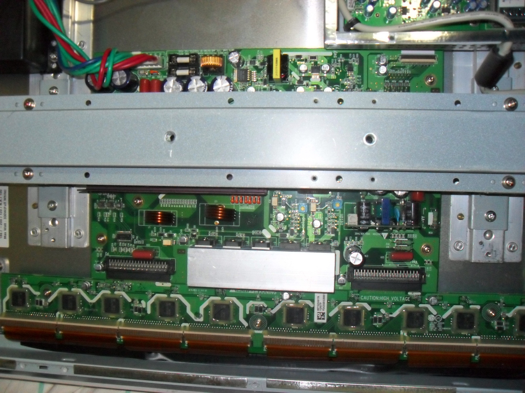

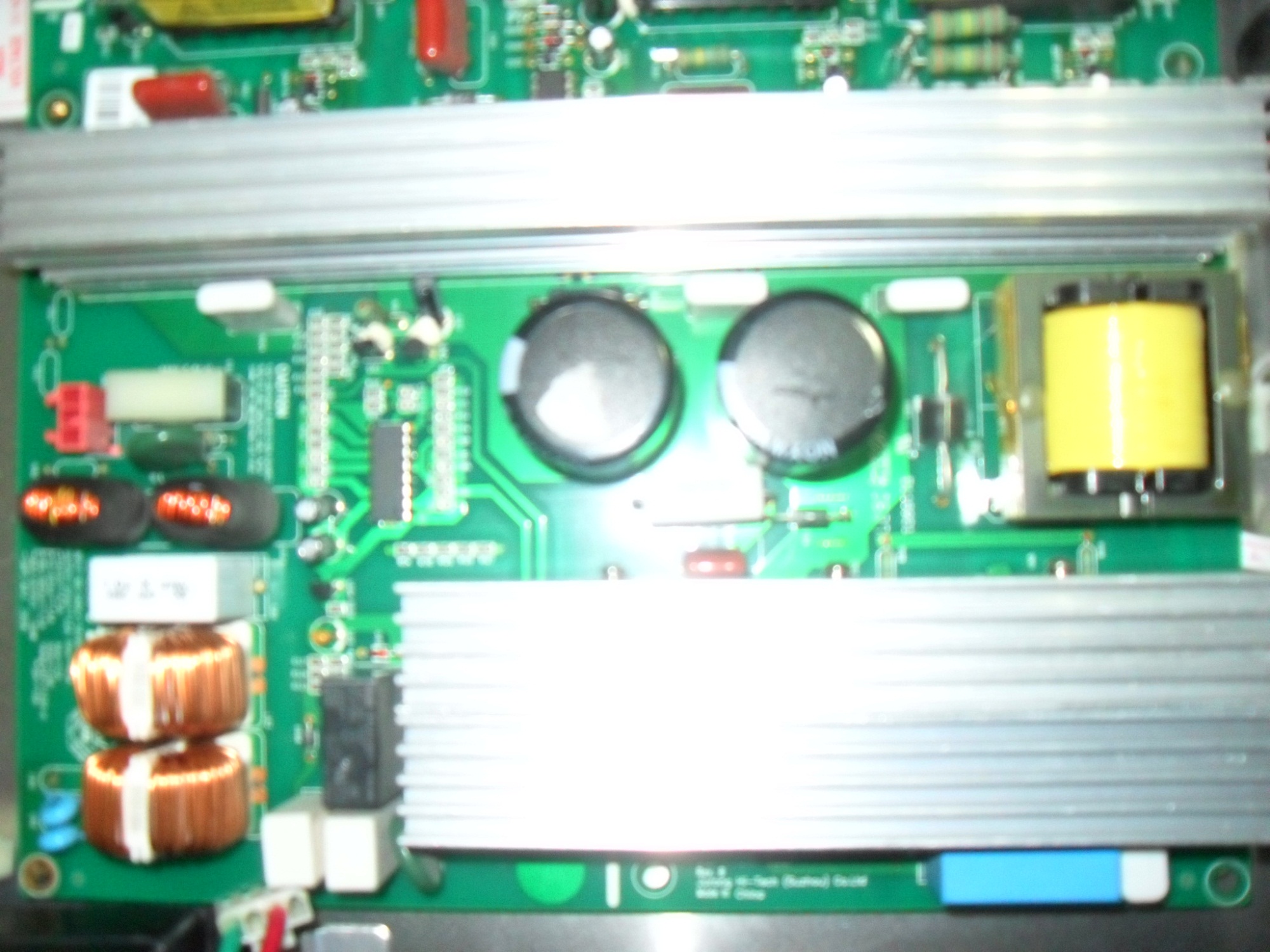

    Okay, TV wouldn't power on at all found a cap that was done for replaced it, now the power supply will come on with a clicking sound around
    C105
    C106

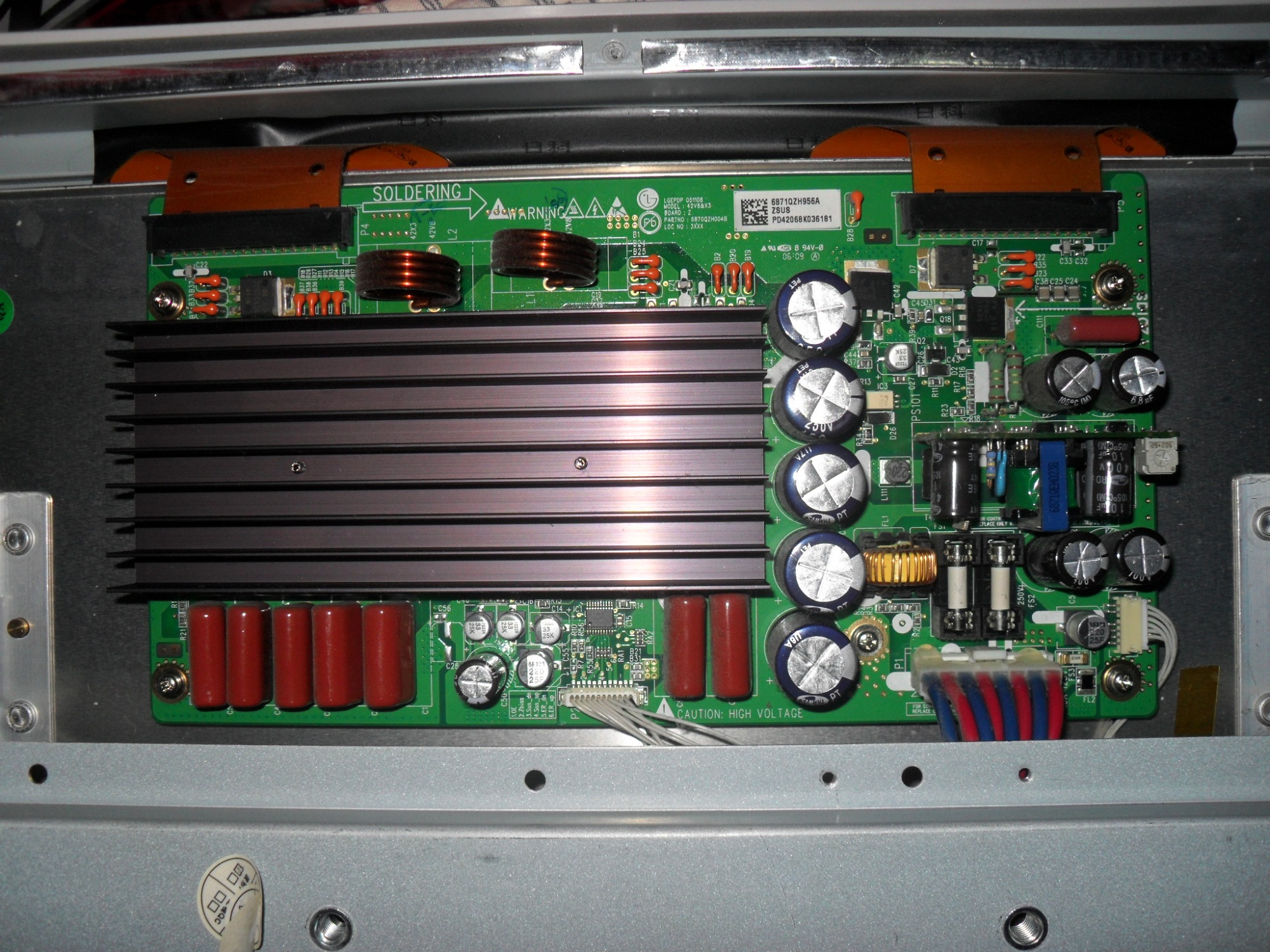

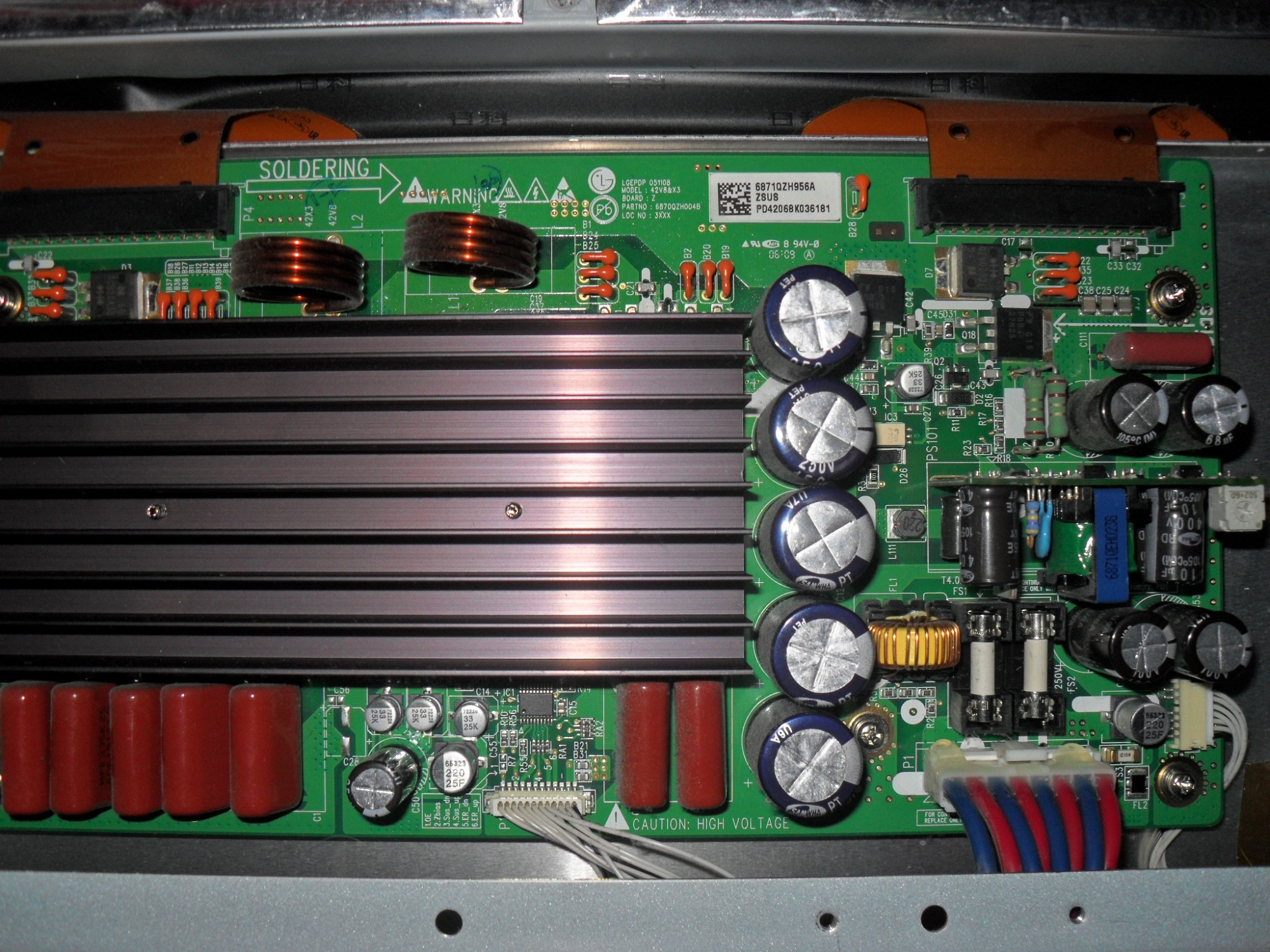

    Now that the power supply was coming on, the z sus board has a bad fuse in it replaced it now the power supply comes on for about 4 secs then powers down all the way, Fuse doesn't blow or anything. if i unhook the z sus board the power supply powers up and stays on.

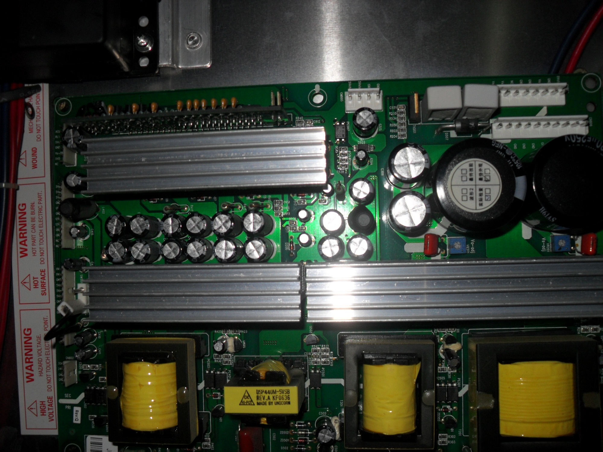

    Now, D507 Diode is around that area where that connector is and it has current going both ways. Clicking in the power supply still remains.
    Re: Viore Plasma Model PDP42V18HA Year 2006
    The Z-sustain is your problem - but the clicking is probably caused by a failed AC detect circuit (VERY common with LG).
    Check the AC detect pin on the connector. (Might be labelled ACD.)

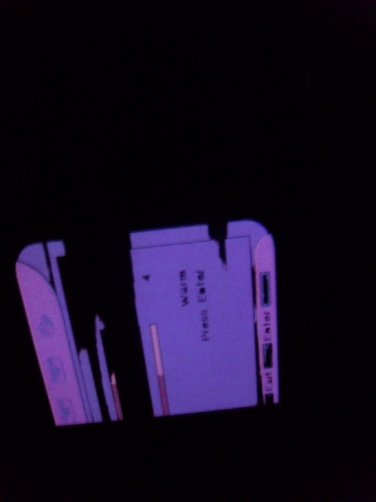

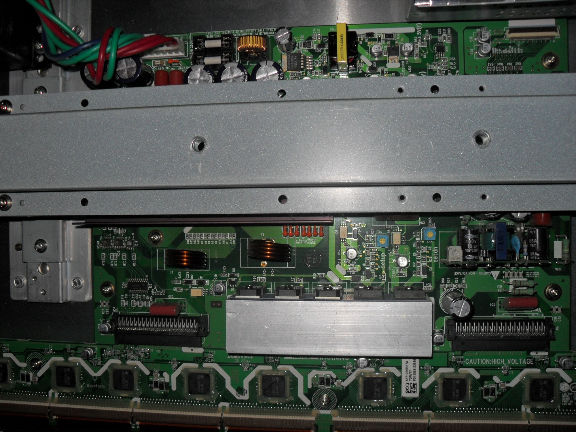

          Well, this is what i got with the z-sustain unhooked. is that diode by the Z-sus connection bad or are they suppose to be Open like that? also noticed that pressing input didn't change the display 40% of the time.

            Yep, that's a classic Z-sustain failure.
            The most likely problem is the IPM, not the diode. If you check the resistance from either end of the fuse to the metal case (with board & power unplugged) what do you read?

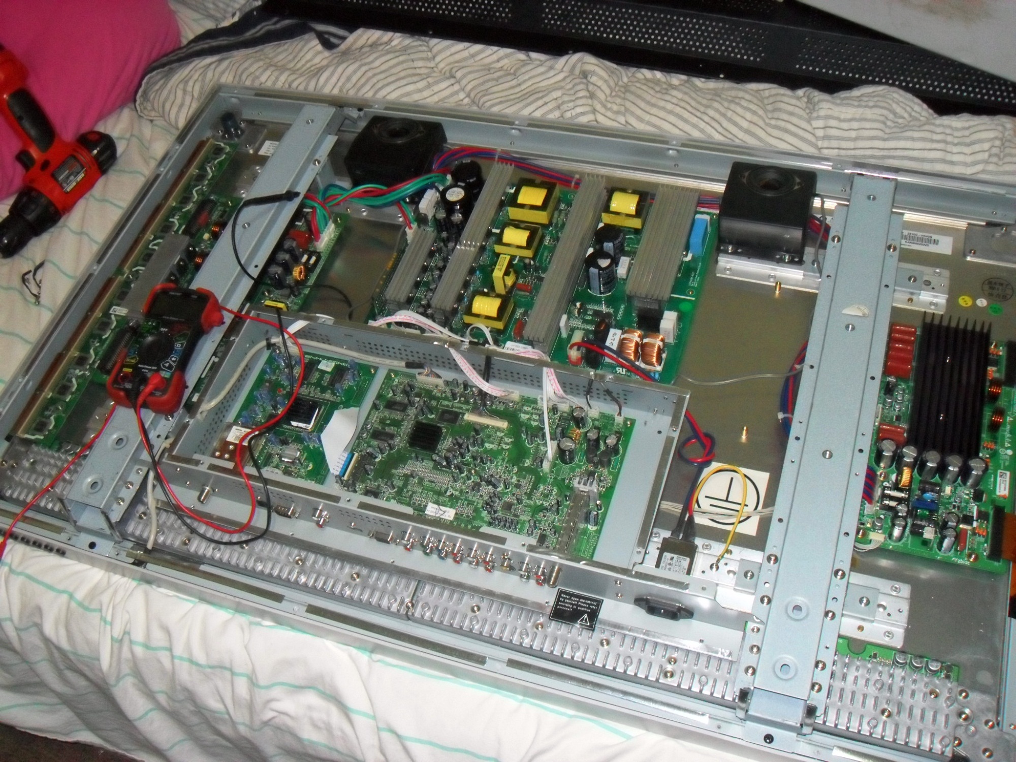

                    After messing with the TV once again when my cable went off tonight i check the voltages while the tv was on and the z-sustain board was disconnected.
                    i don't know if those voltages are within range or not but here they are..
                    VS / 184.0V
                    VA / 59.7V
                    Also even with the Z-sustain unhooked, i have to press vol bots and input over and over to even get a slight picture on any part of the screen.

                      LG 6871QZH956A ZSUS Board has been ordered from shopjimmy should know more Wednesday!
                      • Vizor
                        • Nov 2011
                        • 215
                        zsus board came today and put that sucker in and the tv just Lit up like nothing had happened thanks for the help.
