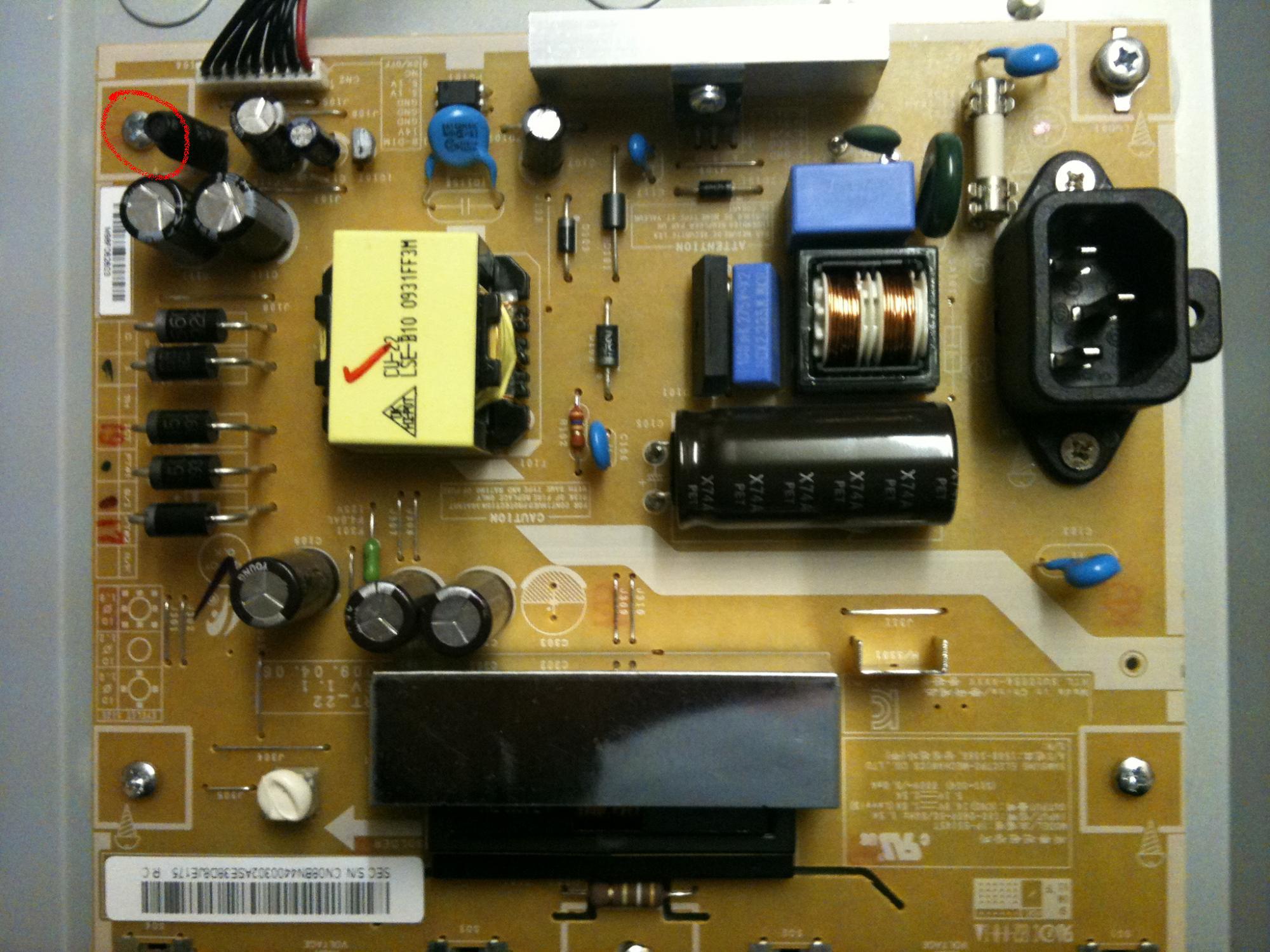

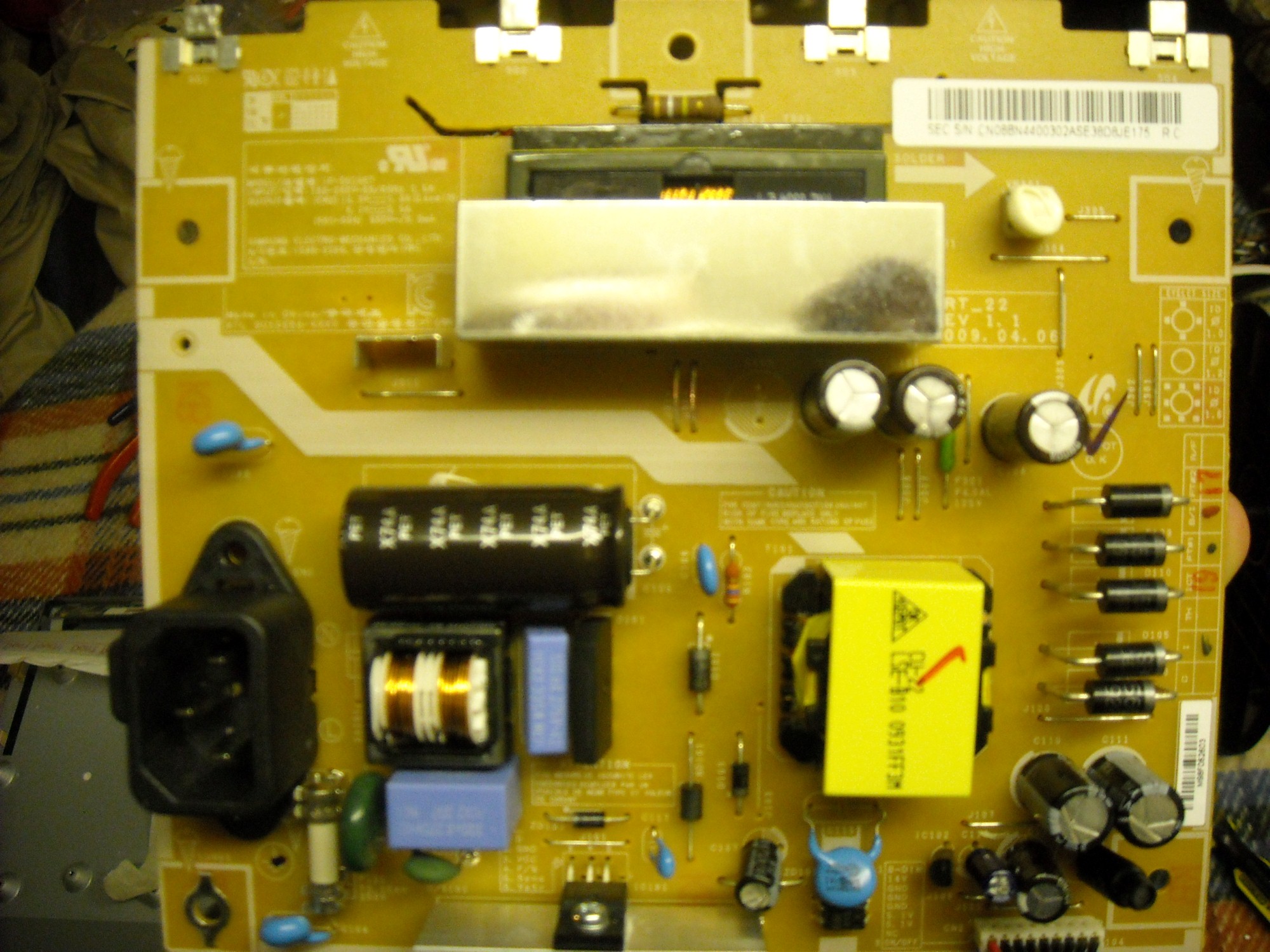

    Sure enough, removed the PSU board (labelled ip-55145t) I could see the board was populated with some new caps, and whoever fitted them must have been using an arc-welder, the soldering was terrible.
    I thought ok I'll start at the beginning as I don't know the state of these caps, so I removed all and tested ESR was 0.0 Ohms - 0.2 Ohms on the large ones, 2.9 Ohms on the little 4.7uf
    All measured fine for capacitance, cant recall now the figures but they were within 5% or less
    Quickly for the sake of it while I was there I took a quick run over the diodes to check for shorts, none found.

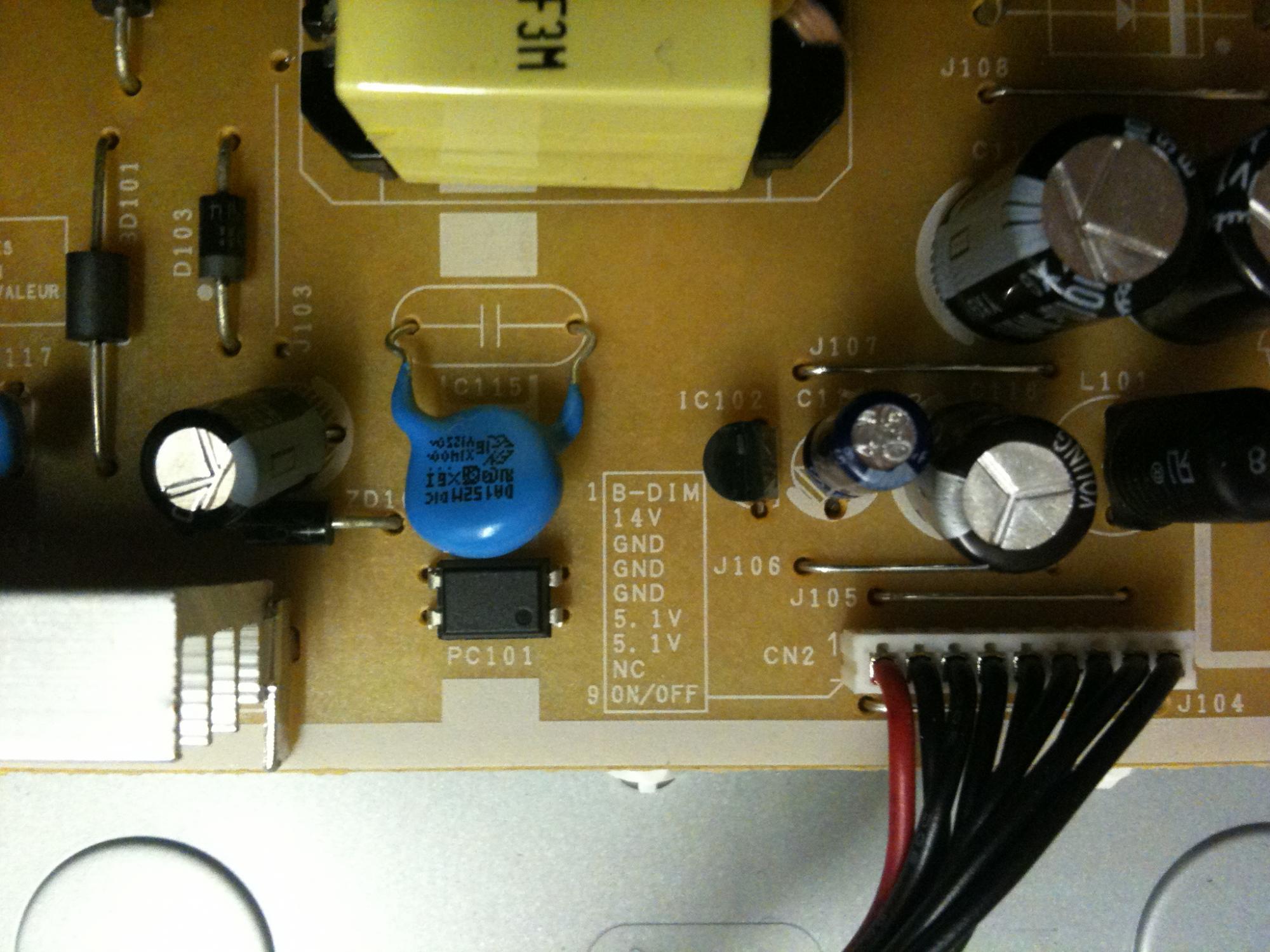

    Voltage checks taken during the power up procedure (See connector in photo below)
    Pin1 4.4mv in standby, goes to 12.7mv then up to 10.53V then quickly down to 4.68V
    Pin2 41mv in standby, goes to .799V on switch on
    Pin3 gnd
    Pin4 gnd
    Pin5 gnd
    Pin6 -4mV
    Pin7 -4mV
    Pin8 NC
    Pin9 2.195v jumps then to 2.987v before switching off

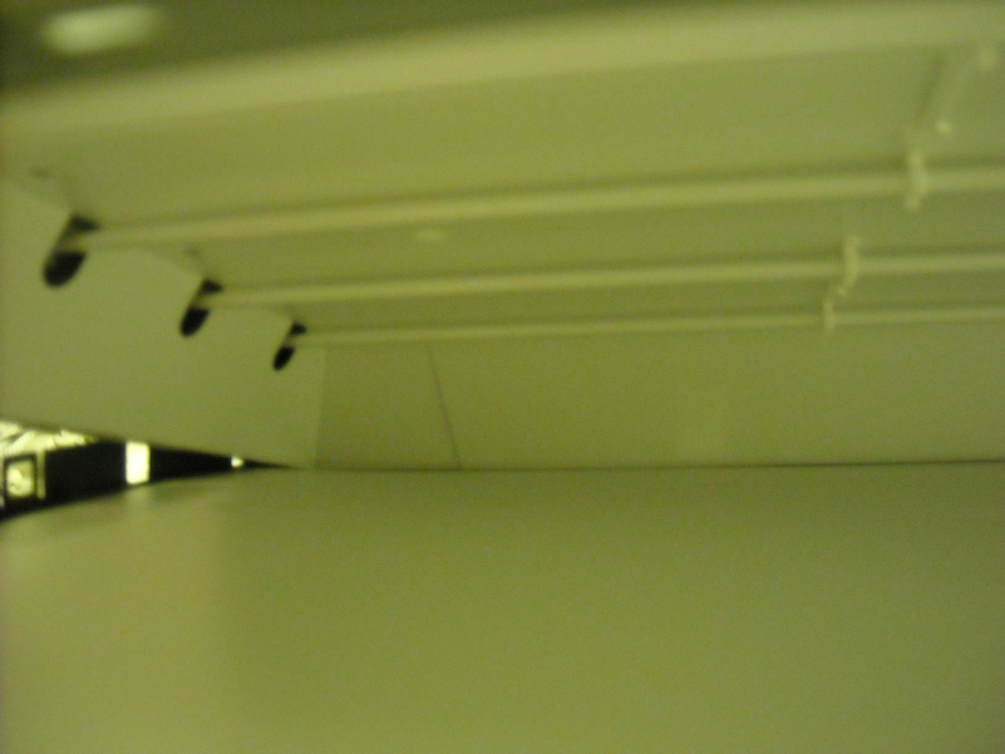

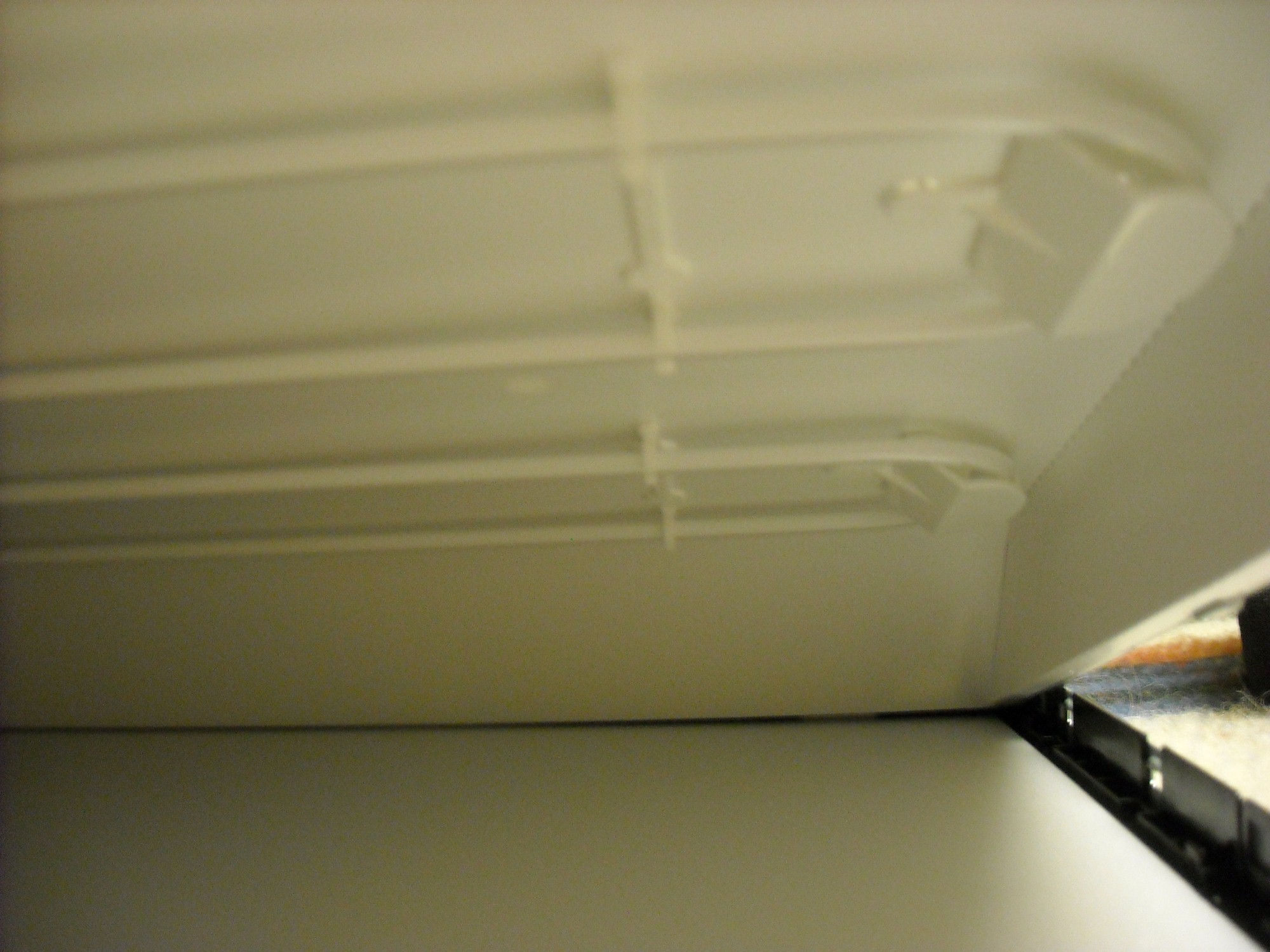

                                Ok, forgive my wooly explanation in my last post! Yes, I tried both tubes on both outputs (it's a single transformer on the board and the output is split before the connectors. Now is a good time to test my new (to me) camera. Photos coming right up..
                                I opened the panel to have a look in (not fully, dont want to get dust or dirt in) and there is two tubes, they are a U shape only they run horizontal. So in effect there is 4 horizontal tubes.
                                I have a feeling they are directly connected to the terminals that the pcb connects to. There is no wire visible between the pcb and the tubes.
