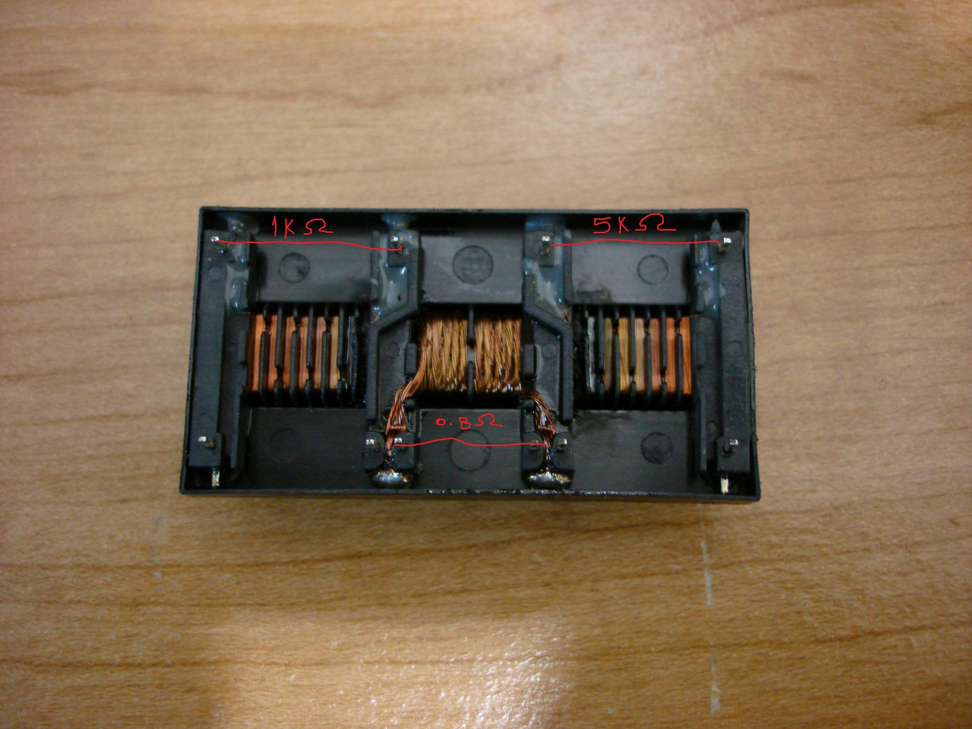

    Hi, I have Monitor samsung T260 problem. I need help, I`m not sure T301 is good or not I have picture. U202 is shorted, F301 4A is opened. Any good store that I can buy 4506https://www.badcaps.net/forum/attachment.php?attachmentid=33131&stc=1&d=1324304635GEH (U202). Thanks

    2) If those are the correct secondary inverter pins, the one that measures 5k ohms is likely bad. Look for parts on ebay.com or try
