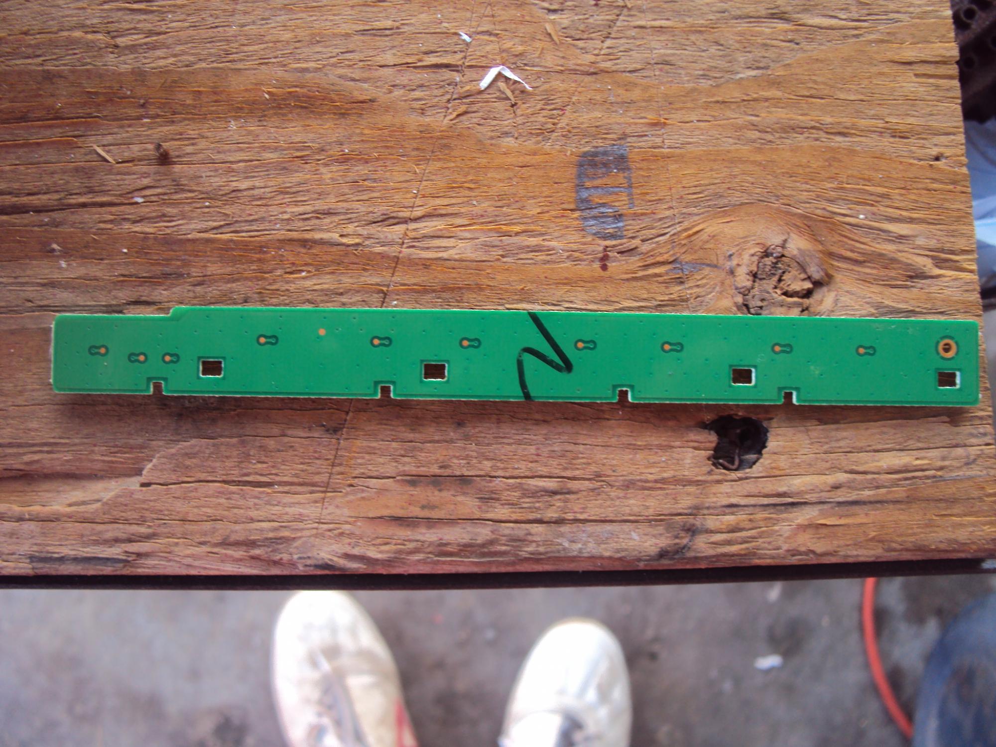

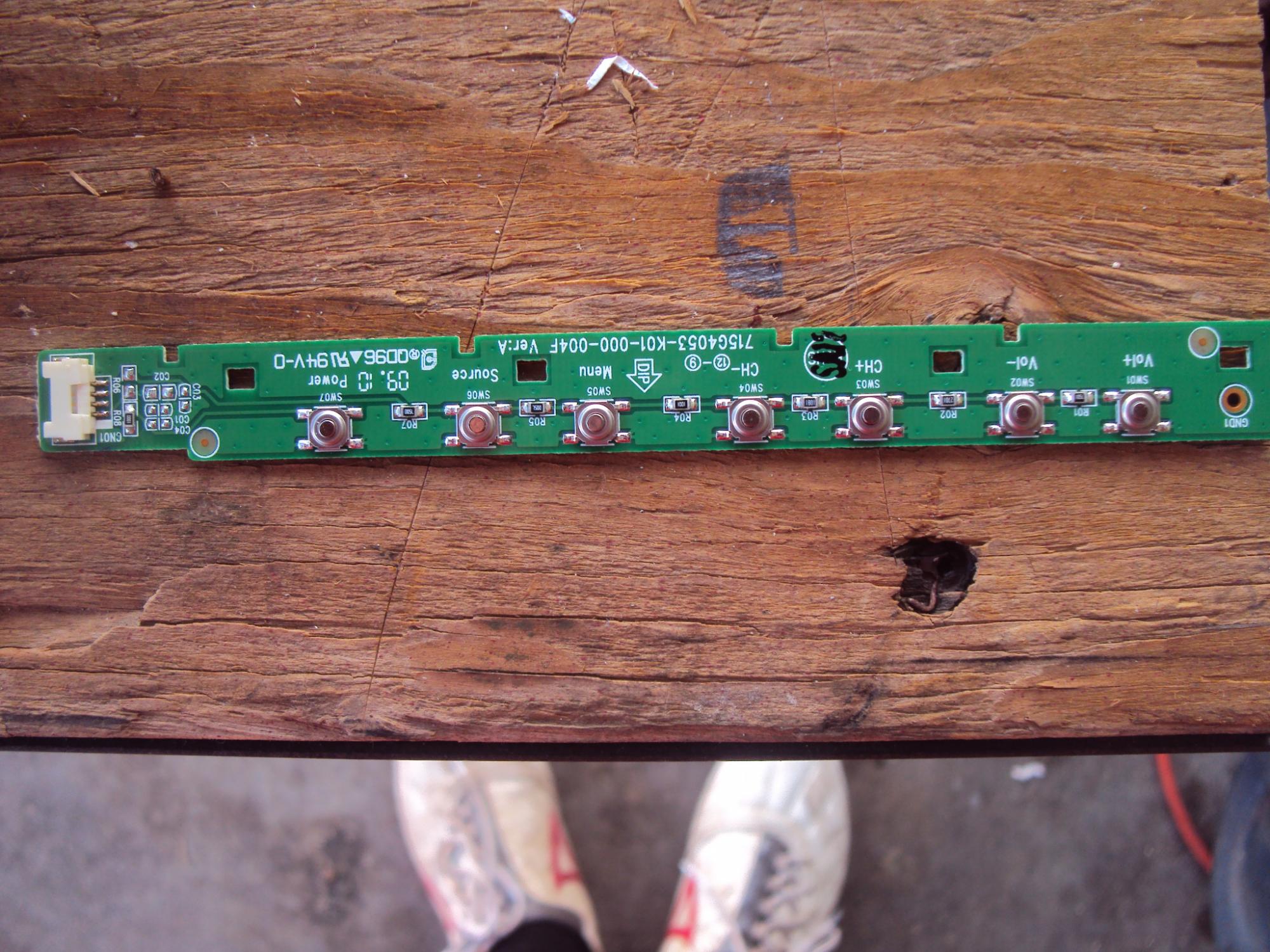

        Re: AOC Envision LE24H067 Wont turn on at all
        OK hear is the pic of the switch board
        i did a little test i disconnected the switch board and tried using the remote to turn on the tv. i measured the voltage on the IR pin and the voltage varies everytime i press any key on the controller. the voltage varies even hen i press the the power button. the voltage on IR pin reads 3.3v

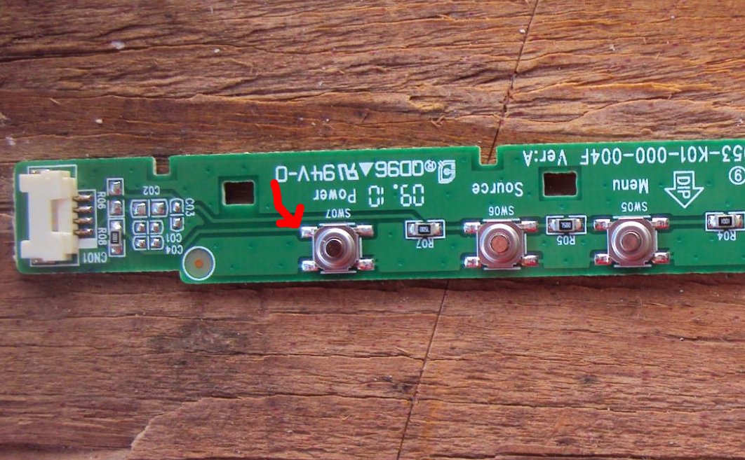

          Okay thanks for the pic.
          Interesting that they would go for a surface mount design... is a bit more expensive than a through hole button board.
          Anyway - To test the POWER button. Just try pressing it. Compare it to the others. Does it feel different? Does it get stuck down?
          If the button feels good, another test is necessary. Using your multimeter, check the continuity of the pin I have highlighted to ground, both when depressed and when not. You may need an assistant. There is a hole called GND1, which you could use to put the black probe, then you would need a red probe on the pin highlighted and a finger to press the switch. The board *should not* be plugged in during this test. If you don't know how to test for continuity, make sure to ask first... post a picture of your multimeter too so we can see what setting to put it on.
          If the value changes, then the button board can be ruled out for now.
            I tested for continuity and yes the power button should be fine I used the diode tester mode on my multimeter I head sound everytime i pressed the pwr switch . i also tested the othe switches and they are all fine. What should be my next step please Thank you

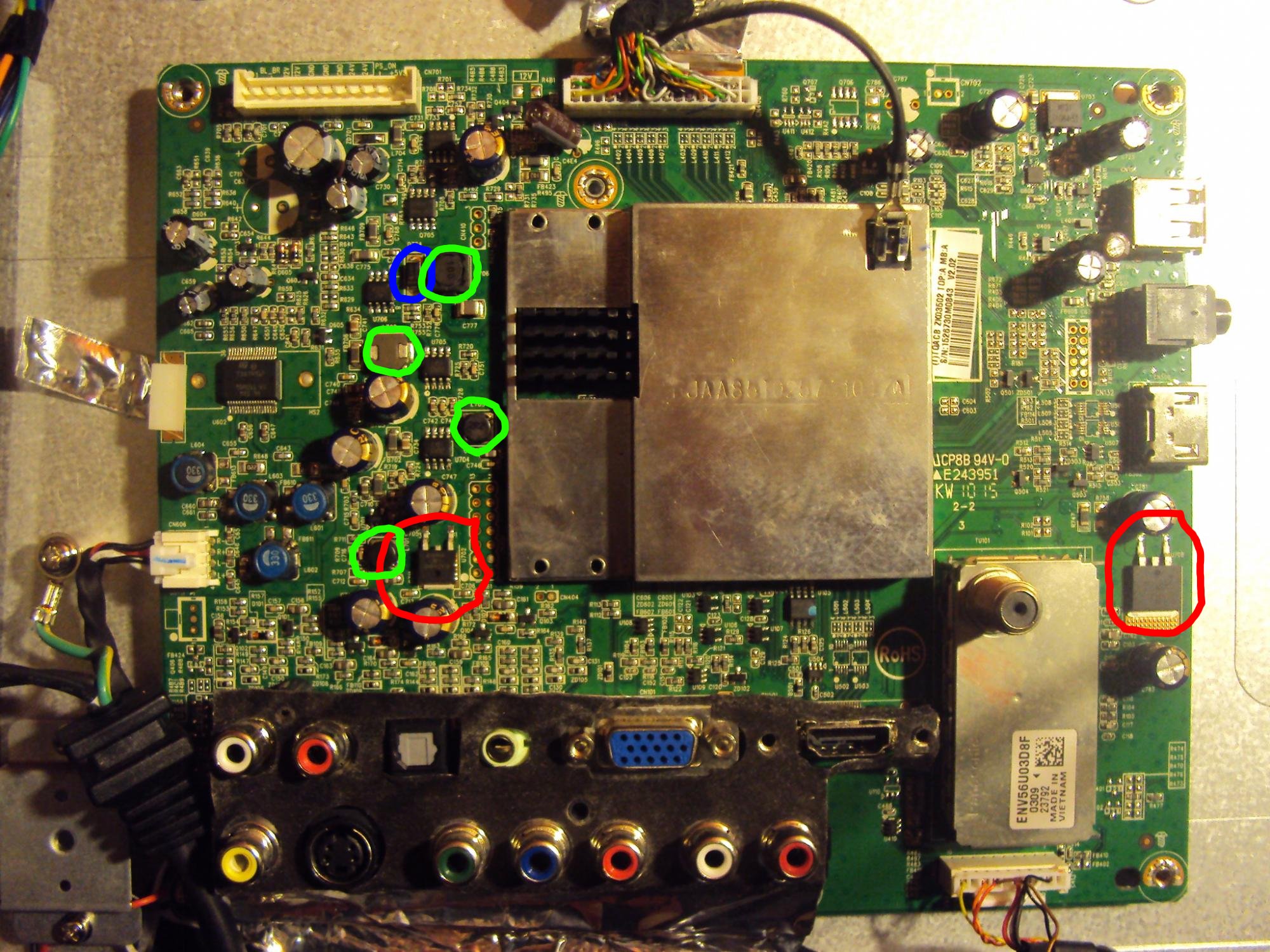

                  Next, some components on the main board need testing.
                  For each red component: I suspect these are LDOs or voltage regulators. Attach the black lead of the meter to an exposed metal portion of the case, excluding any heatsinks on the power supply. While the power is applied to the TV, test each pin and note down the voltage. There is usually a designator next to each component, such as U702; use this to refer to each component. There is no need to test the middle pin which is cut off. Note the part number e.g. "AP1117-33" which is on the LDO.
                  Confirm whether the component on the top right of the board which looks similar to the left red circled component has a designator beginning with "U". If so, that will need testing too.
                  For the blue circled diode: With the set *OFF*, use the diode test on your multimeter. Test both ways. You should get about 150 - 500 one way (or 0.150-0.500, depending on how your meter displays it) and 0L or "1." (or open) the other way. If not the diode is dud.
                  For each green component. These are inductors. First, with the TV unplugged, test for continuity (only necessary to test one way.) You should get a beep or dead short, or very low resistance. Next, with the TV plugged in, test the voltage on each exposed pin of each inductor. One end will measure 0V or some random value. The other end should measure a fixed, low and stable voltage. Note the voltage here. There is probably an identifier like "L123" next to each of these; use this.
                  Good night and happy testing...!
                  If any of these shows bad, you have a choice. You can replace it, but it will require a skilled hand at soldering. Or, you can replace the main board, *if* you can find a replacement.

                      Ok i tested the diode you circuled blue and i get a reading of 158 one way and 1974 the other way around so acording to my understanding this diode is shorted?
                        #31
                        It's probably okay; most likely the circuit is interfering with the measurement. Shorted is a reading less than about 50, and the same both ways.
                          ok the inductor have a voltage on both pins
                          the diode is fine as you said
                          the voltage regulators only the leg #3 of each regulator carries voltage

                            U708 carries 9.1v
                            U703 carries 5v
                            U702 carries 3.3v

                              Hello testing the inductors i get voltage both ways.
                              the 2 small ones have a low voltage like 2.3 and 3v and 5v and 4 on both sides
                              the biger inductor on the very top has a kind of high voltahe of aroun 9v one pin and 10v the other pin.
                              the gray inductor has a voltage of like 1.3 one pin and the other pin has like 2v
                              is this normal? you stated one side should have 0v on the inductors
                                The values you are seeing are not what I expect but I am probably incorrect in assuming how this design works. If there's a voltage it's probably okay.
                                I don't really know what to suggest any more - is there a part number on the board? Some replacement boards are cheap. Others are expensive, it depends on the board. Then again a 24" LED TV is not a bad find, even if the board is £50 or so to replace.
