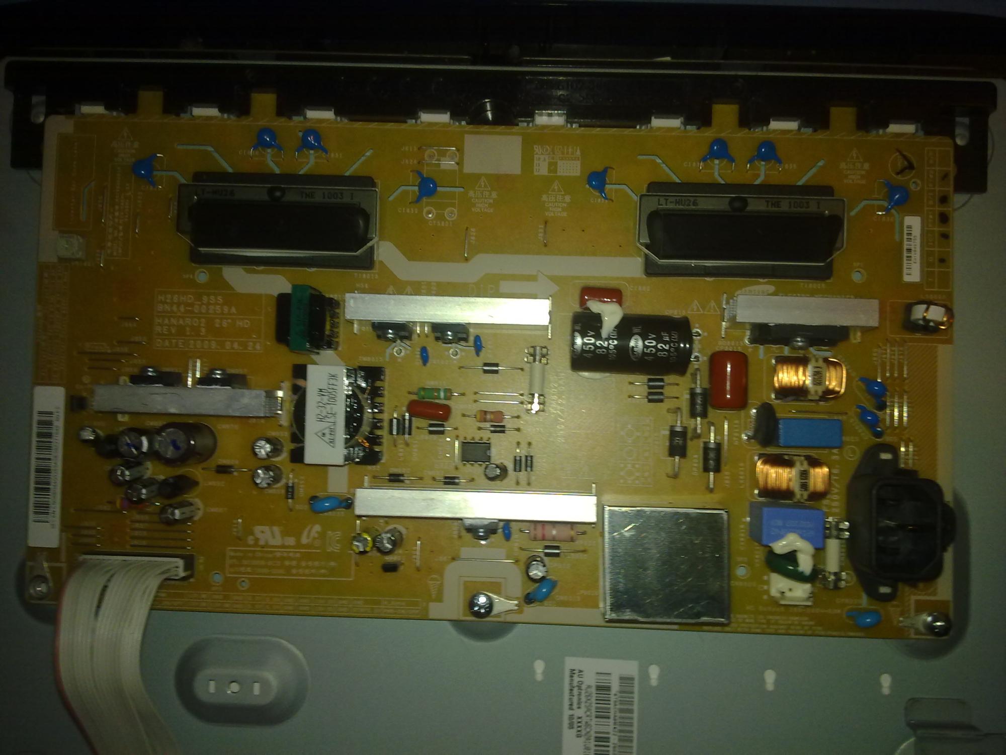

                          Post a picture of your power board. There may be diodes on the power board that are failing you. That has been know to happen on these models as well.
                          • zedexnz
                            • Jul 2011
                            • 13
                            Re: Samsung PSU low voltage.
                            pic as attached. Checked all the main diodes as per Wizards post. They are fine. Tried force starting with the 5v -->power on via a resistor on the power board, nothing. From the panel connector its definatly switching, but dont get a power on from the logic board. to the powerboard though. The power on/ stays at 0.7v doesnt seem to switch.
                            Looking more like the logic board....
