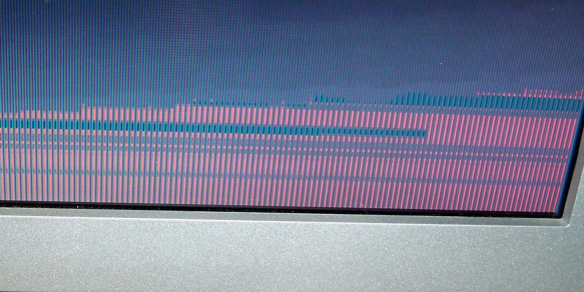

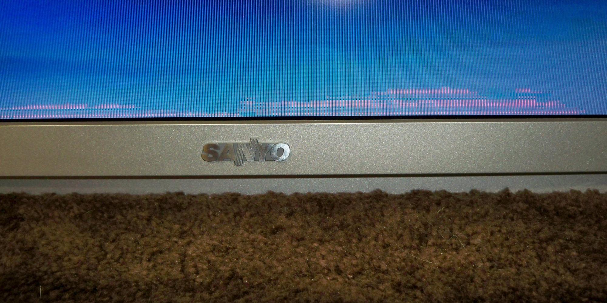

    sanyo clt2054 intermittent grainy image
    i will try to get a pic of thos issue but dont know if i will be able to catch it.
    THis is a set i took in on trade twoards a larger set i had. Supposedly worked perfect.
    well after failing a burn test after only about 20 mins im not too happy.
    Ive tried different cables and different video sources, and this issue happens wether im using yellow composite video or red green and blue component video inputs.
    Sometimes the set looks great, other times the screen gets alot of horizontal lines/noise kinda like red sparklies like you would see on a bad plasma almost. this is an lcd though. basically it looks as if i have a bad video cable or something, but i do not.
    Sounds like bad panel to me but im still going to tear it apart and make sure i dont have bad caps or a loose tcon cable or something. BTW this has an external 12v supply, is it possible its got ripple and causing my issue.

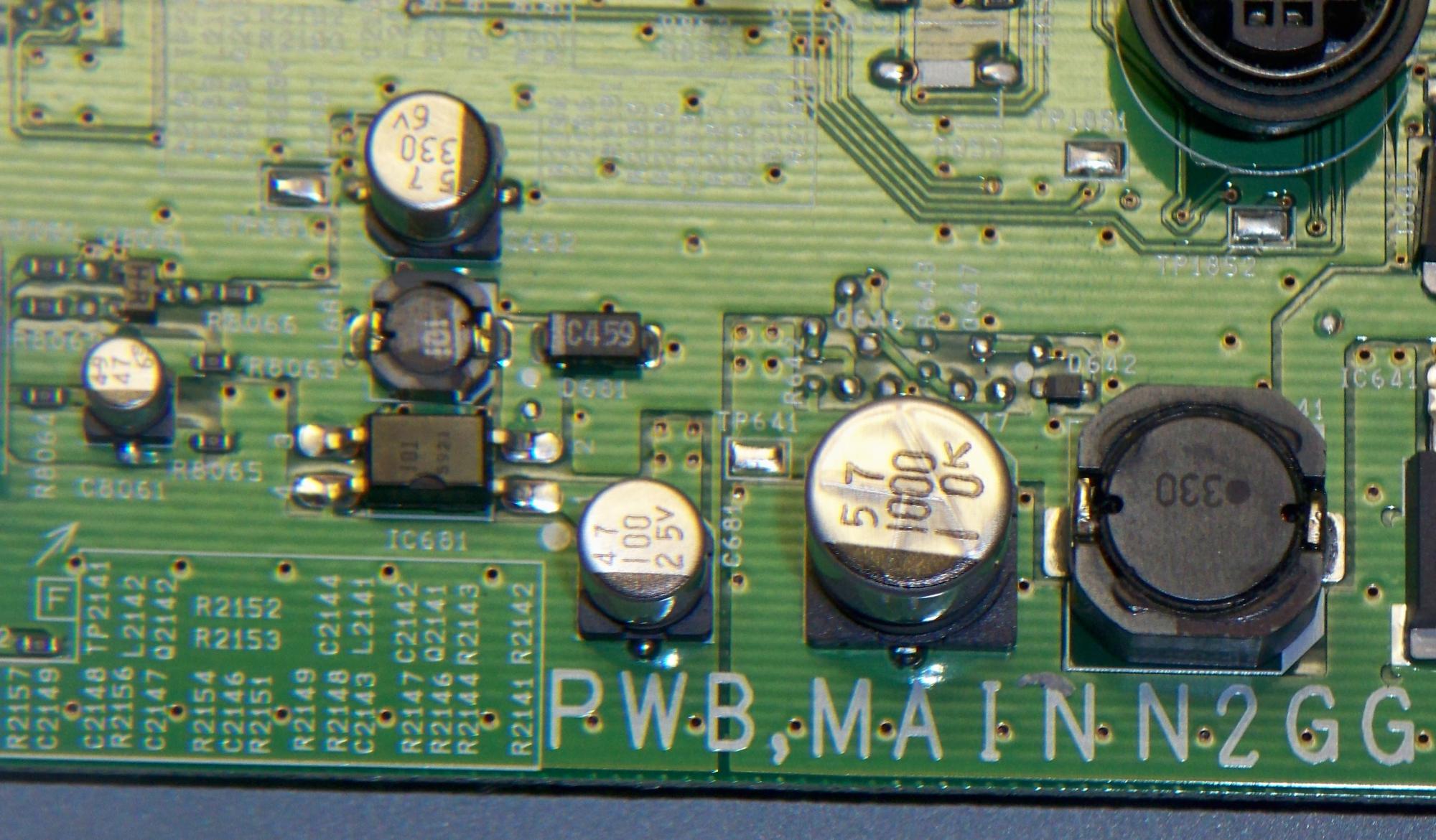

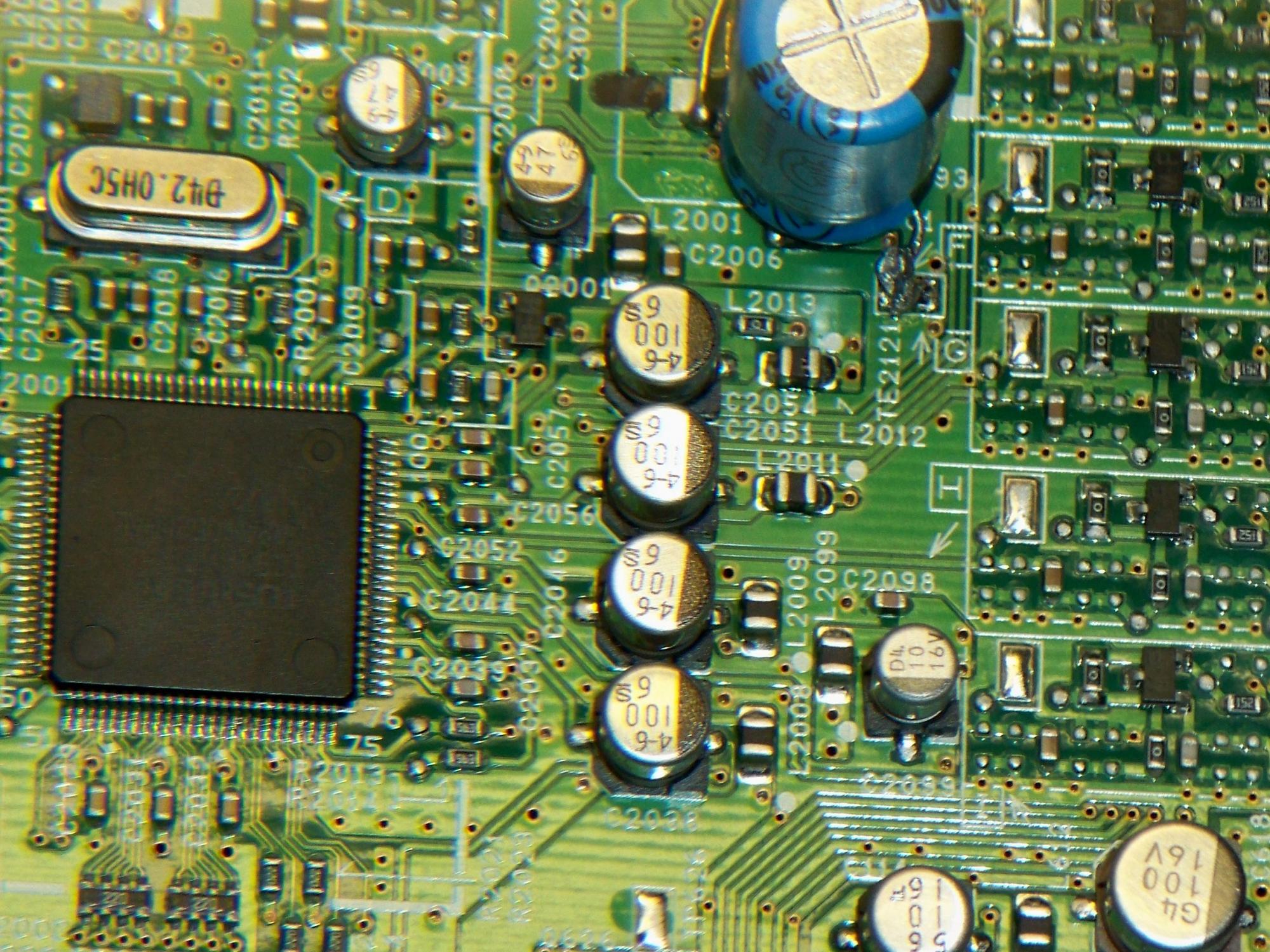

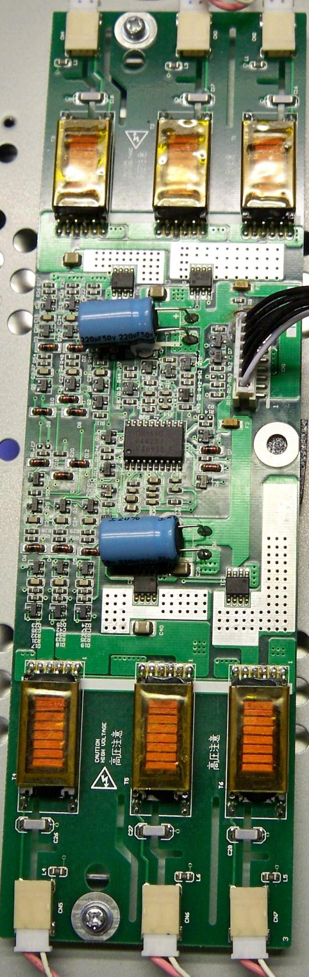

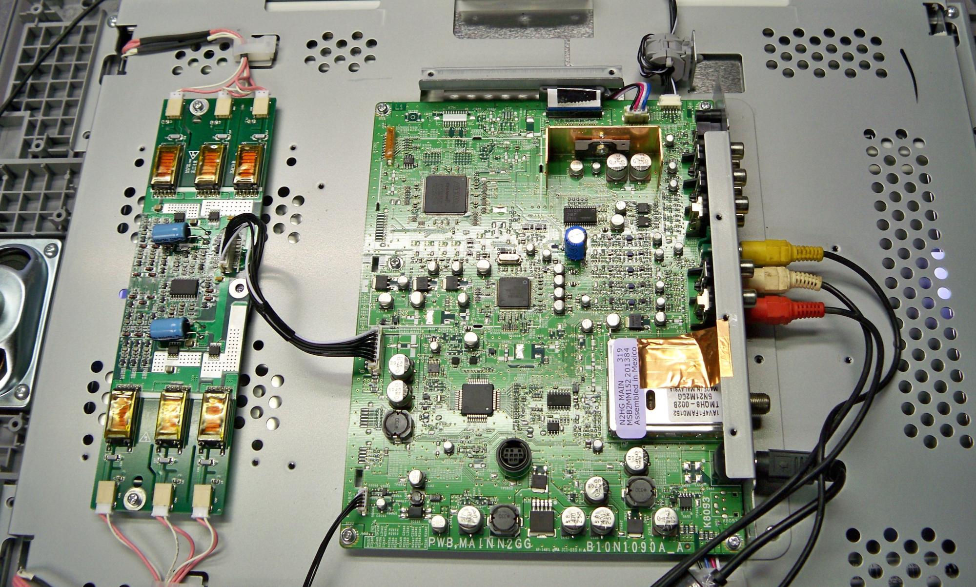

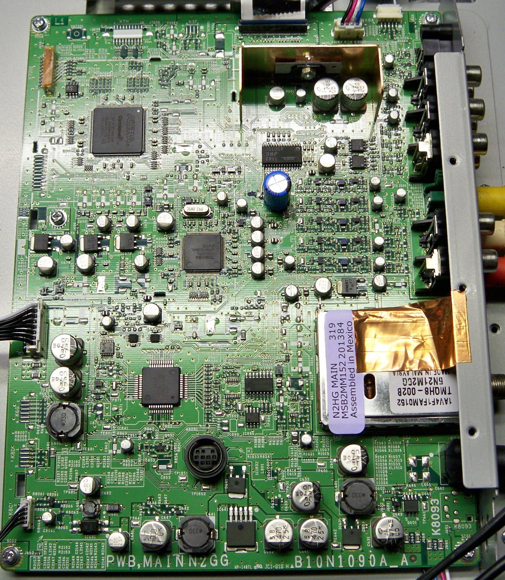

    heres some pics. Ive shotgunned a couple caps, 2 on the inverter has too much ripple, one on the mainboard looked slightly domed. Of course those didnt fix a thing.
    the weired part about this is all osds look perfect, remove input then the screen looks perfect as well. wish i had an alternate means to drive the panel to make suire thats not my issue.

            What's with the strange black paint cracking on the 470uF SMD caps? Every one of them has it, none of the other values do. Maybe from heating and the sleeve moving under the ink/paint.
            Prime suspects if you have an ESR meter.
            That replacement cap on the signal board is 85 degrees and looks off-brand.

                    I'm channeling wizard at this point. Noisy LDO regulator feeding the input section. The clue is OSD is perfect.

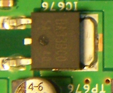

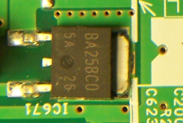

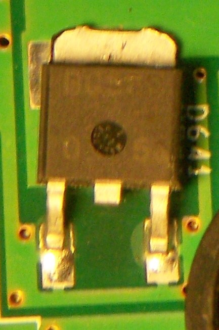

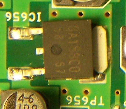

                        I'll circle some regulators on some closeups, but I don't even want to think about the power supply this week.

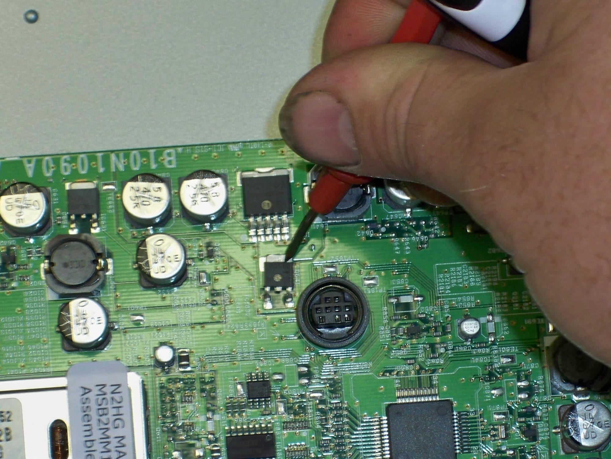

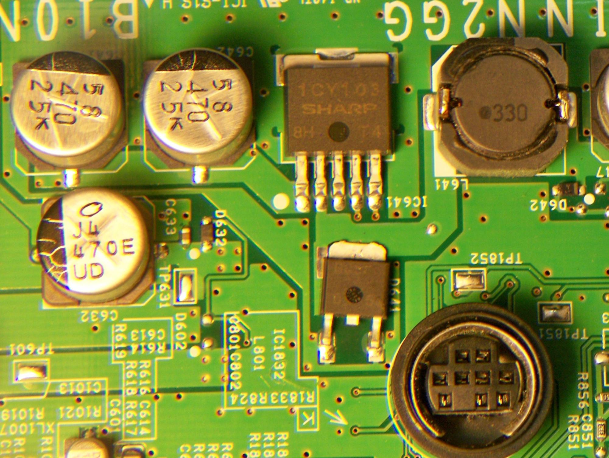

                          i mean , ideally, i shouldnt be seeing any ac on this thing right?
                          one smd ic marked as a diode im getting like 0.100 vac on the tab, seems kinda sketch to me but then again i am an idiot. I marvel at you guys who can just look at this and go oh heres the processing ic, heres the regulator, etc it amazes me.

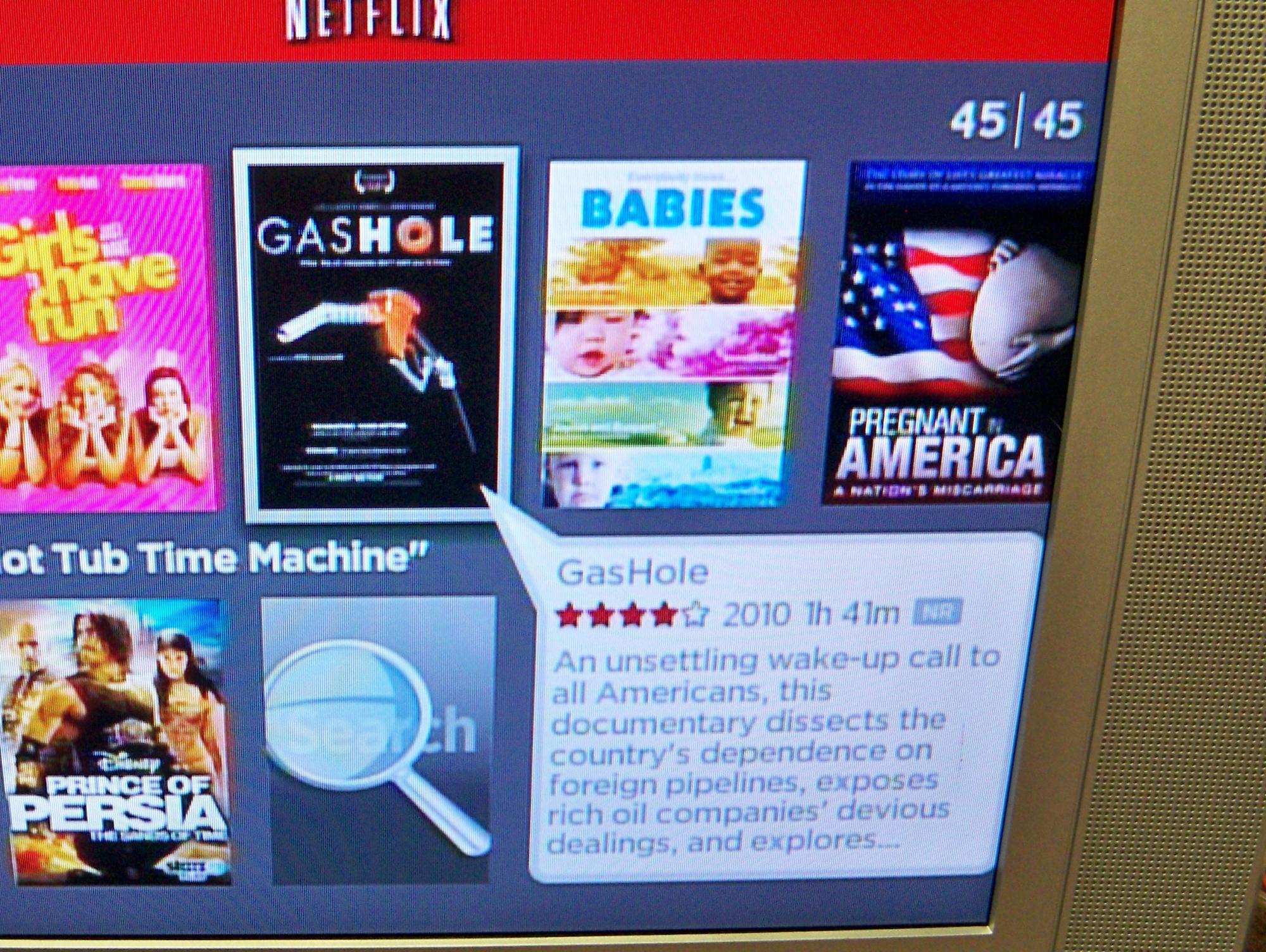

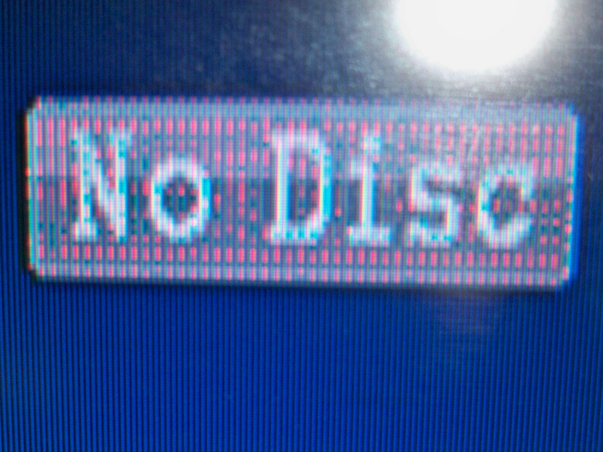

                          edit: heres some pics... get this: after poking around every suspect ic checking +5 and +3.3 etc, now i have a good image again...
                          mabye cold solder on one of these regulators?????????????
                          there was barely any solder on the legs of these things.
                          i went ahead and reflowed them all. My slight remining noise shown in the pic below is gone, pic is perfect. No ammount of flexing or tapping will make this former issue reappear.
                          I will run this set a couple hours tommorow then put it back togther to make sure, but again thanks to bill, i believe we have found this issue.
