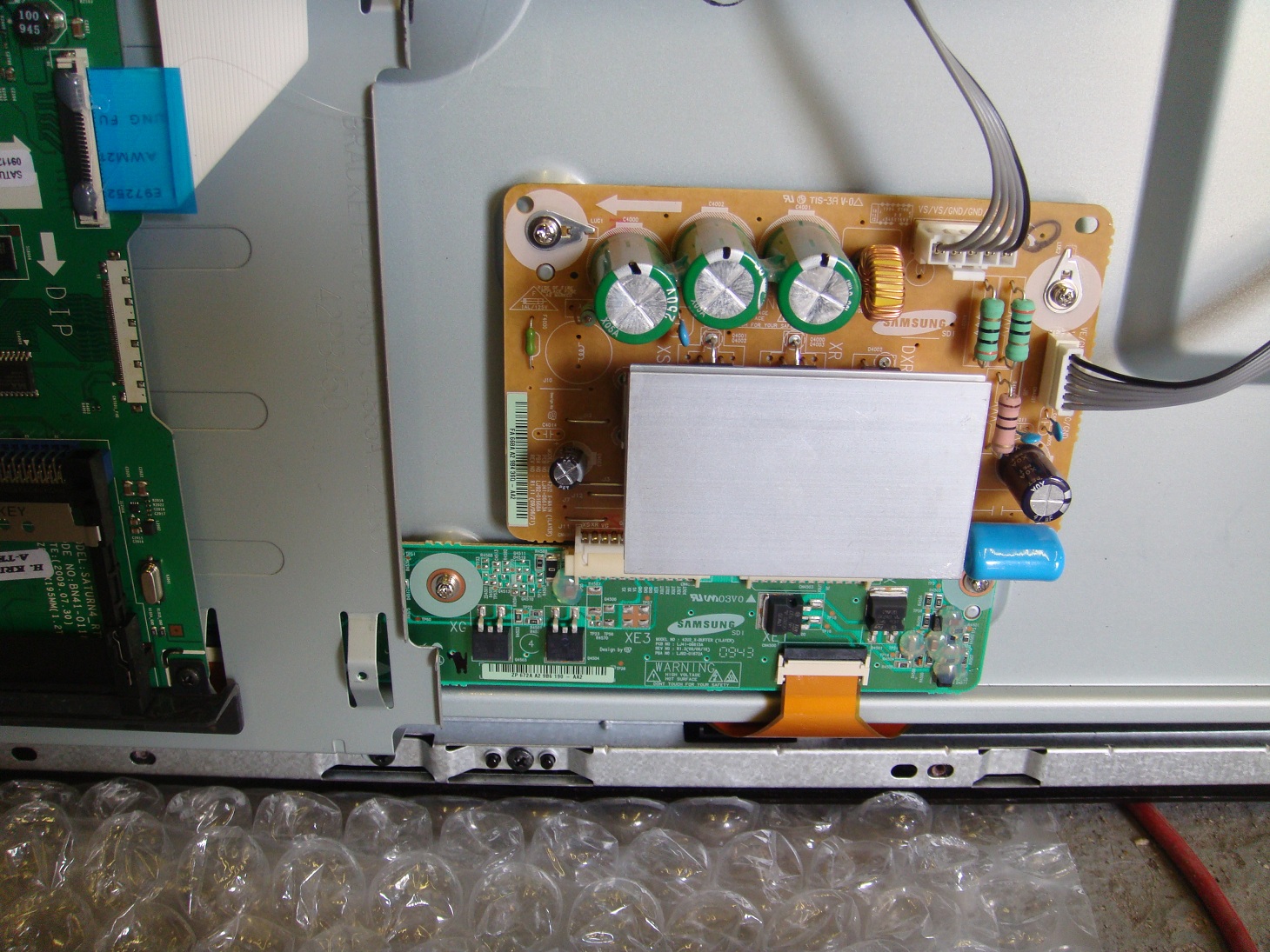

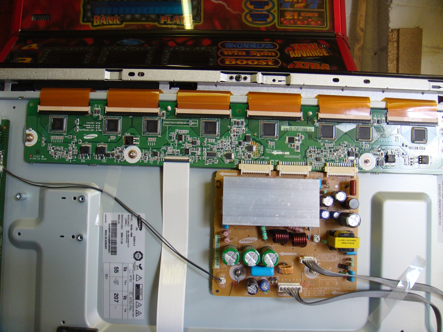

    have this samsung plasma getting a loud buzzing coming from the buffer board side of the screen near the top I think? I thought might be cracked screen but it looks ok? anybody advise where to start with this?

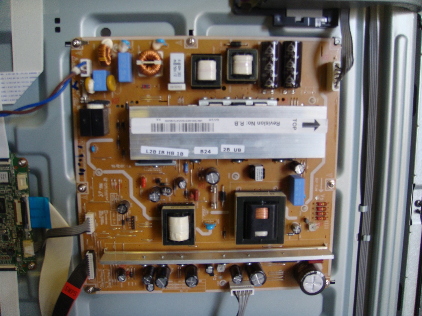

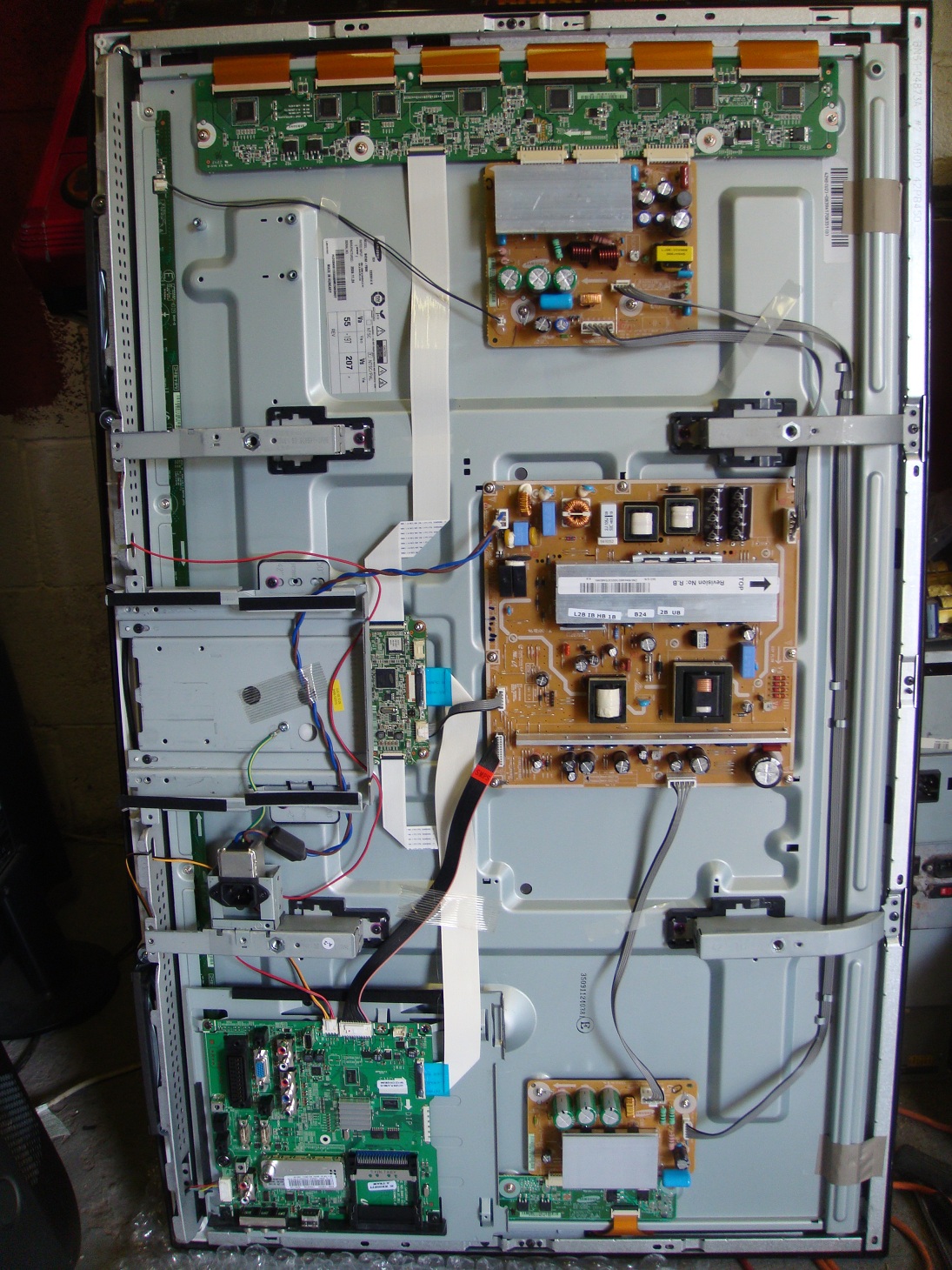

      Yes you are right PlainBill! I did not think it thru, lol, ok pictures uploaded, seems the vs va vg votages are ok, the manual looks slightly diffrent from the boards in my set?

        If it is emitting a loud buzz then it is a broken panel. It is probably broken in the vacuum tube in the top corner above the buffers or along the edge of the panel near the buffers.

          thanks for that, I suspected it might be the panel, will look further and report back
