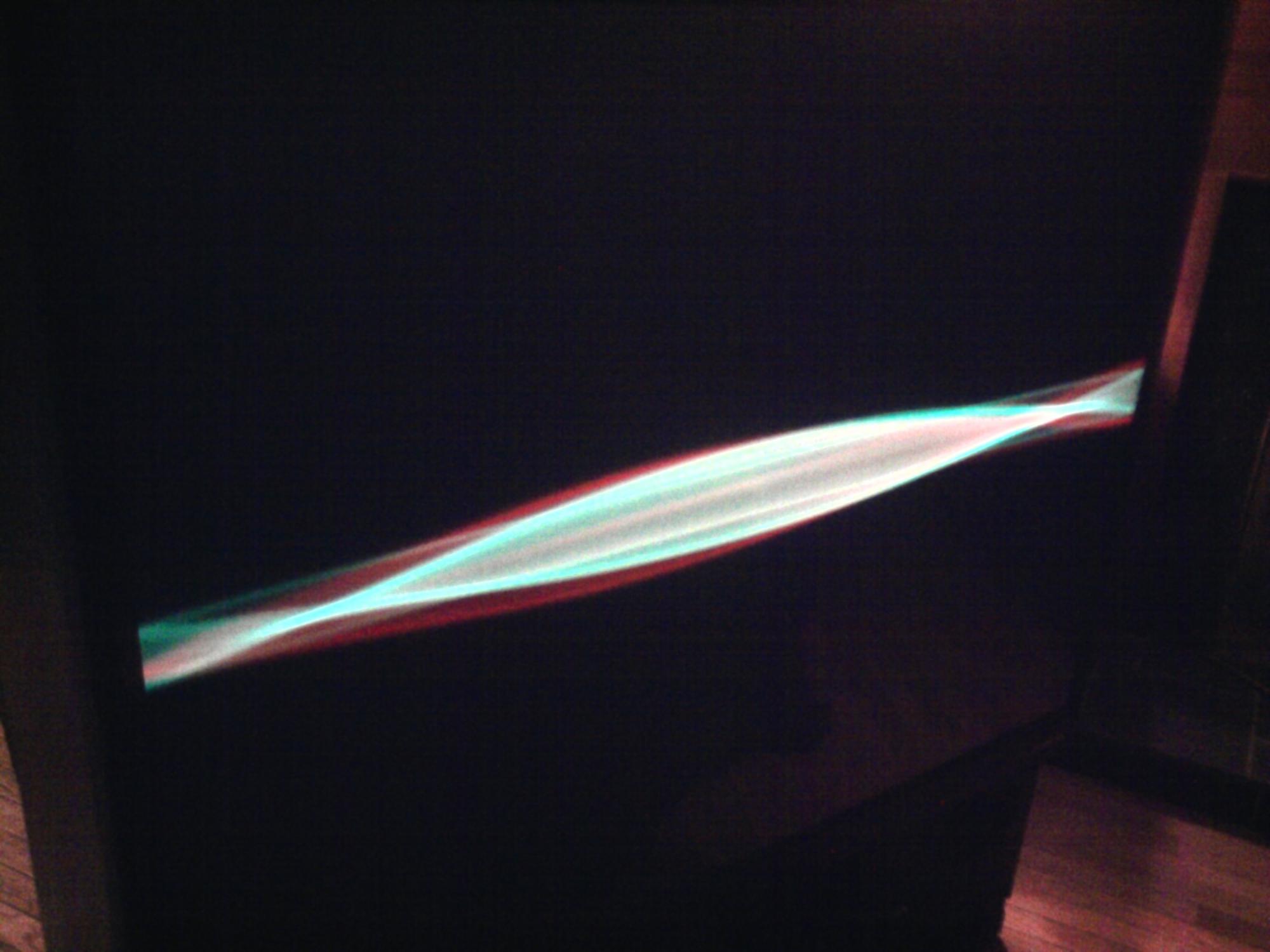

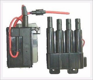

    I have a Toshiba projection TV and when i turn it on it will stay on for about 10 seconds and then literally click's off and blink's a red light(no code). Also it has odd horizontal lines in all 3 colors. The problem it hard to explain in text so I made a YouTube video that tells a great deal more about my problem.
    http://www.youtube.com/watch?v=wpnuwK1mbT0
    I also just some relevant pictures
    >same FLYBACK thats i have.

    I saw your video. If the fly were bad it would not light. Leaving the line across the screen had probably burned the face of the CRT's by now and convergence IC's never "look bad".

        You have practically no vertical deflection most TVs shut themselves down when the vertical IC goes to prevent burn in.
        Check the vertical output IC and the caps around it on the signal board for starters.
