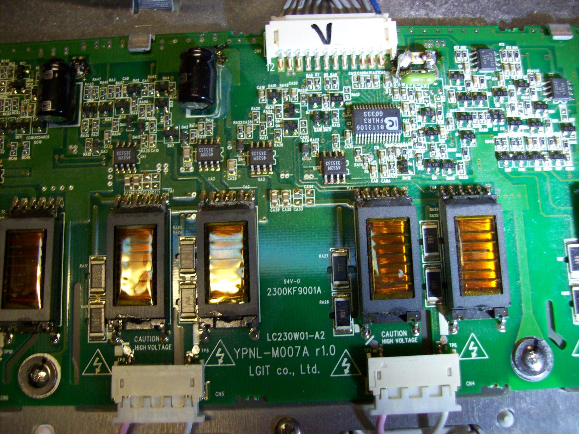

    Hello, I have a small 23" LG TV that keeps blowing the 4 amp fuse located on the inverter board. I have replaced the fuse a couple times but as soon as I turn on the TV it blows again. Here is a photo of its location. I do not want to buy an inverter board if it is something else. The sound and tuner are still working it is just that the screen is black.

        I did have a look at the screen to see if there is any image but the fuse blows as soon as the unit is turned on. A fellow on ebay was selling the power supply board and I thought it could be sending over-voltage to the inverter because the fuse is located right next to the connection ribbon coming from the supply board. Upon inspecting the inverter board when I first got the TV it looked like all the capacitors were replaced on it. I held a flashlight to the screen to see if there was any activity within the LCD panel and I could not see any. It was also mentioned that a bad bulb could have caused the inverter to fail, would that be possible?

          I would say the problem is the inverter itself. The design of these inverters included over-current protection of the outputs. That would eliminate any chance that the CCFLs were responsible. You could verify this by unplugging all CCFLs and trying again. (solder a #1157 taillight across the fuse location). Also, the chance that over voltage from the power supply is causing the fuse to blow is quite remote. You SHOULD be able to check the output voltage of the power supply; most supplies have the output voltages labeled.
          In my opinion, the two most likely causes of the fuse blowing are a shorted driver IC or a reversed cap (assuming the caps had been changed).
          The closest analogy I can come up with is this: You have a small electronic device - a cd player. One day you discover it isn't working, the circuit breaker has tripped. You reset the breaker and it trips immediately. You unplug the cd player, and try resetting the breaker. It stays on - until you plug in the CD player.
          Do you 1. Assume the line voltage must be too high? 2. Wonder if the CD in the player is defective? or 3. Assume the CD player is defective? 4. Check the CD player by plugging it into an outlet on a different breaker?

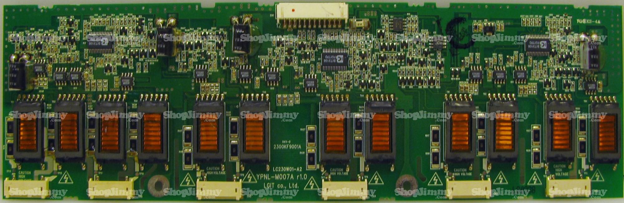

            I would assume the CD is defective in your analogy. I'm posting a photo from the shopjimmy site until I can take more photos. I would really appreciate it if you could look at my other post on the 42" Visio that I got recently, I hope I did not mess anything up and cause more problems with it. Thanks

              what do I check after soldering an 1157 across the fuse contacts bill?

                Actually, you can test the driver ICs using nothing more than a DMM. Set it on the 200 ohm range. If you look at the first picture you posted, there are a number of 8 pin 'ICs' with the number 4532M. One corner of each IC has a dot, that indicates pin 1. Pins are numbered counterclockwise. For extra credit, explain why. Measure the resistance from pin 1 to pin 2, from pin 2 to pin 8, and from pin 8 to pin 1. Also measure from pin 3 to pin 4, from pin 4 to pin 5, and from pin 5 to pin 3. A 'good' reading would be over 200 ohms, a definite 'bad' would be under 5 ohms. Do this for all of the drivers. You will probably find one that tests bad.
                The IC is actually a SI4532. The original is obsolete, the 'new, improved' version is available for $.80 each at Digikey. They only have 56,040 available.
                When you have replaced all shorted drivers, try powering the board up with the 1157 lamp in place instead of the fuse. When the backlights come on you can pat yourself on the back, then replace the lamp with a fuse.

                      pin 1 to pin 2 = 1.3
                      pin 2 to pin 8 = 2.2
                      pin 8 to pin 1 = 1.2
                      pin 3 to pin 4 = 48.3
                      pin 4 to pin 5 = 48.3
                      pin 5 to pin 3 = .4
                      2nd chip pin1 to pin2 = 5.8
                      all other pins and all other DIP chips showed nothing, there are 12 DIP chips
                      I tested them still connected to the board with the entire board removed from the set.
                      I guess its off to digikey

                        Good work, that certainly looks like you found the problem.
                        If you don't already have it, get a Chip-Quik kit. It makes removing a SMD chip easy. Solder Wick makes clean-up easy.
